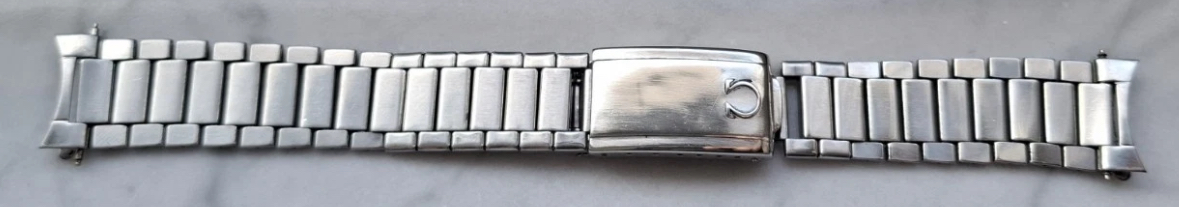

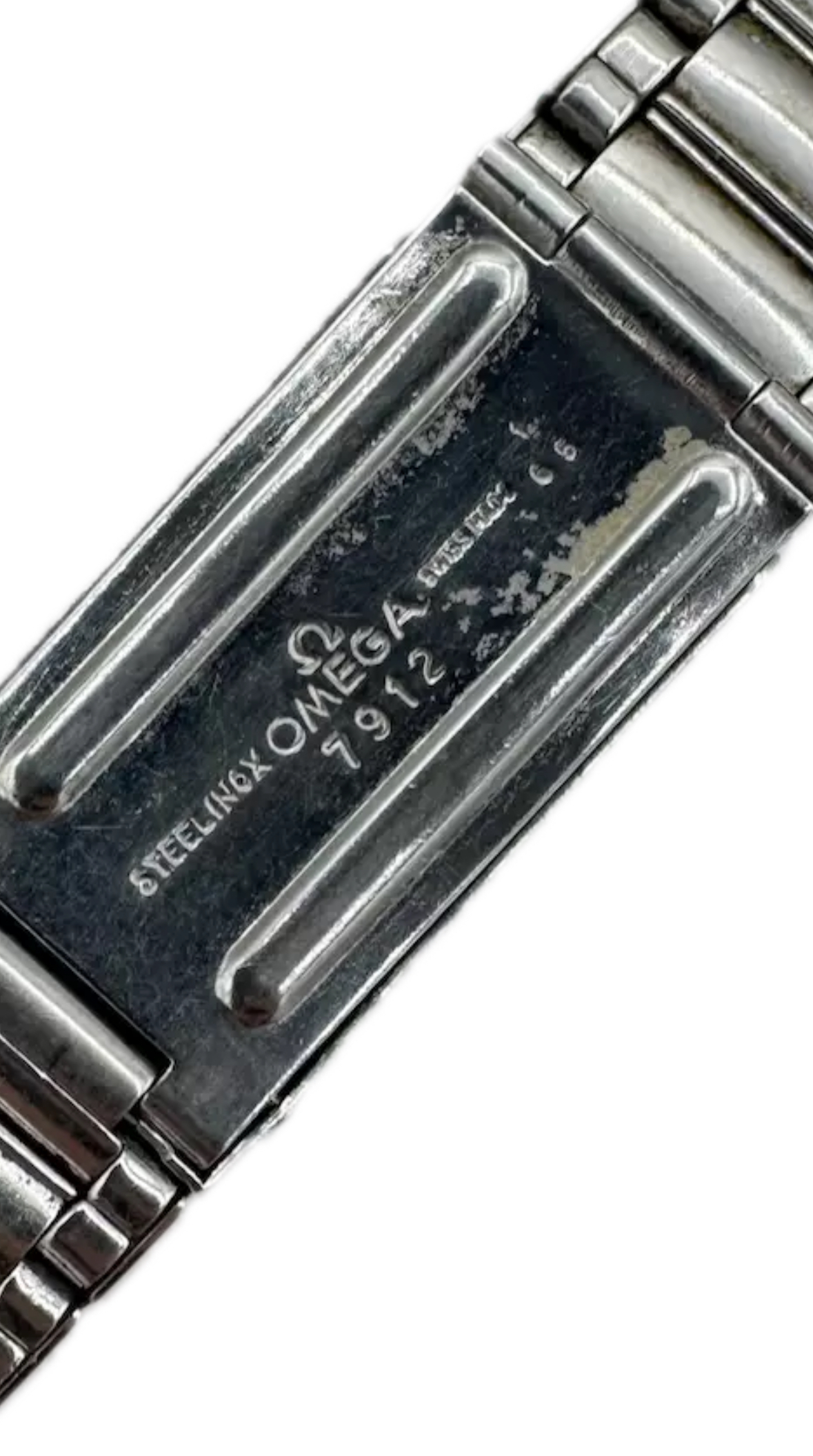

I’ve been looking for a reasonably priced 1966 dated 7912 bracelet. There’s a seller telling me his 1/66 bracelet is correct, but in looking at bracelet after bracelet, I haven’t seen that clasp. Is that some variation of a 7912 or is it a Franken?
Thanks

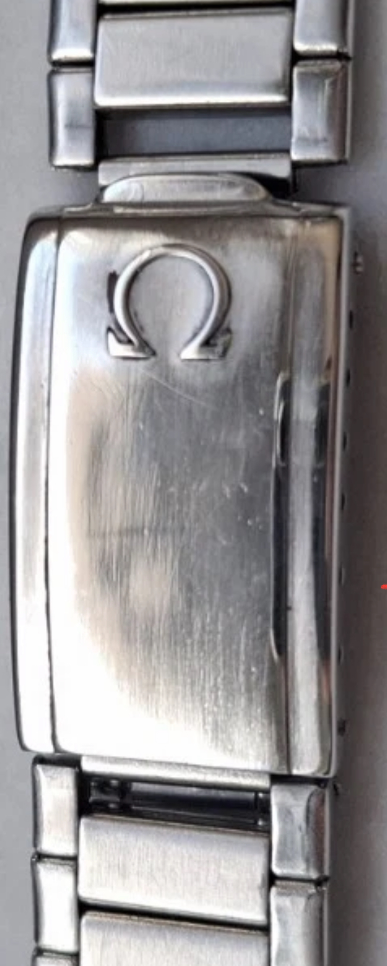

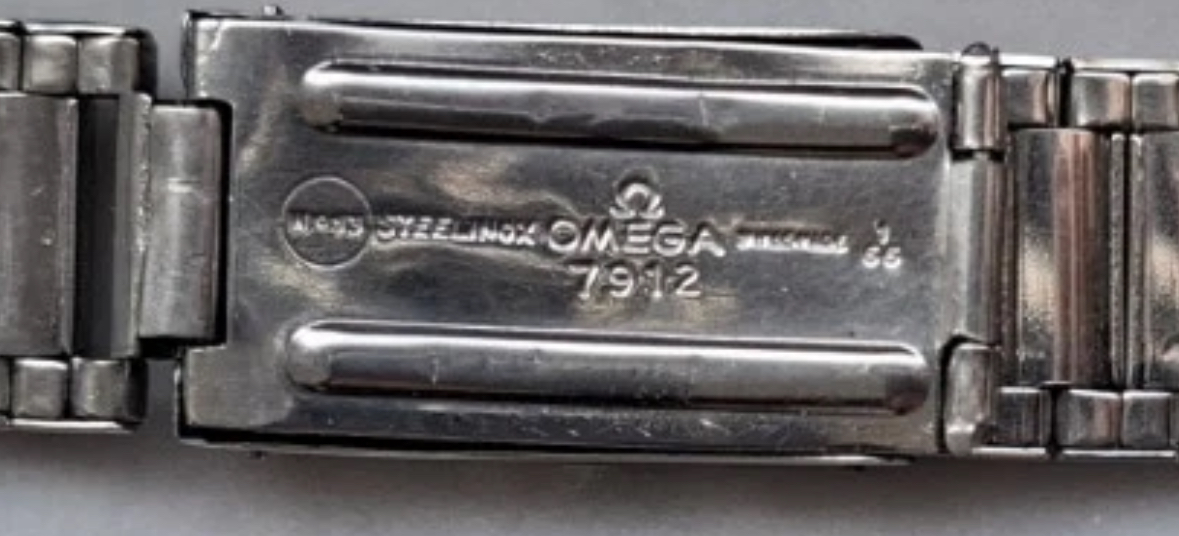

Looks like someone combined the clasp cover from a 1035 or 1039 bracelet with the inner clasp pieces off a 7912 bracelet to get it ready for sale to me. The parts are mostly interchangeable and compatible so its pretty easy to franken something together, 7912 clasp covers have the old style Omega logo sort of hanging off the edge as I’m sure you’re thinking of

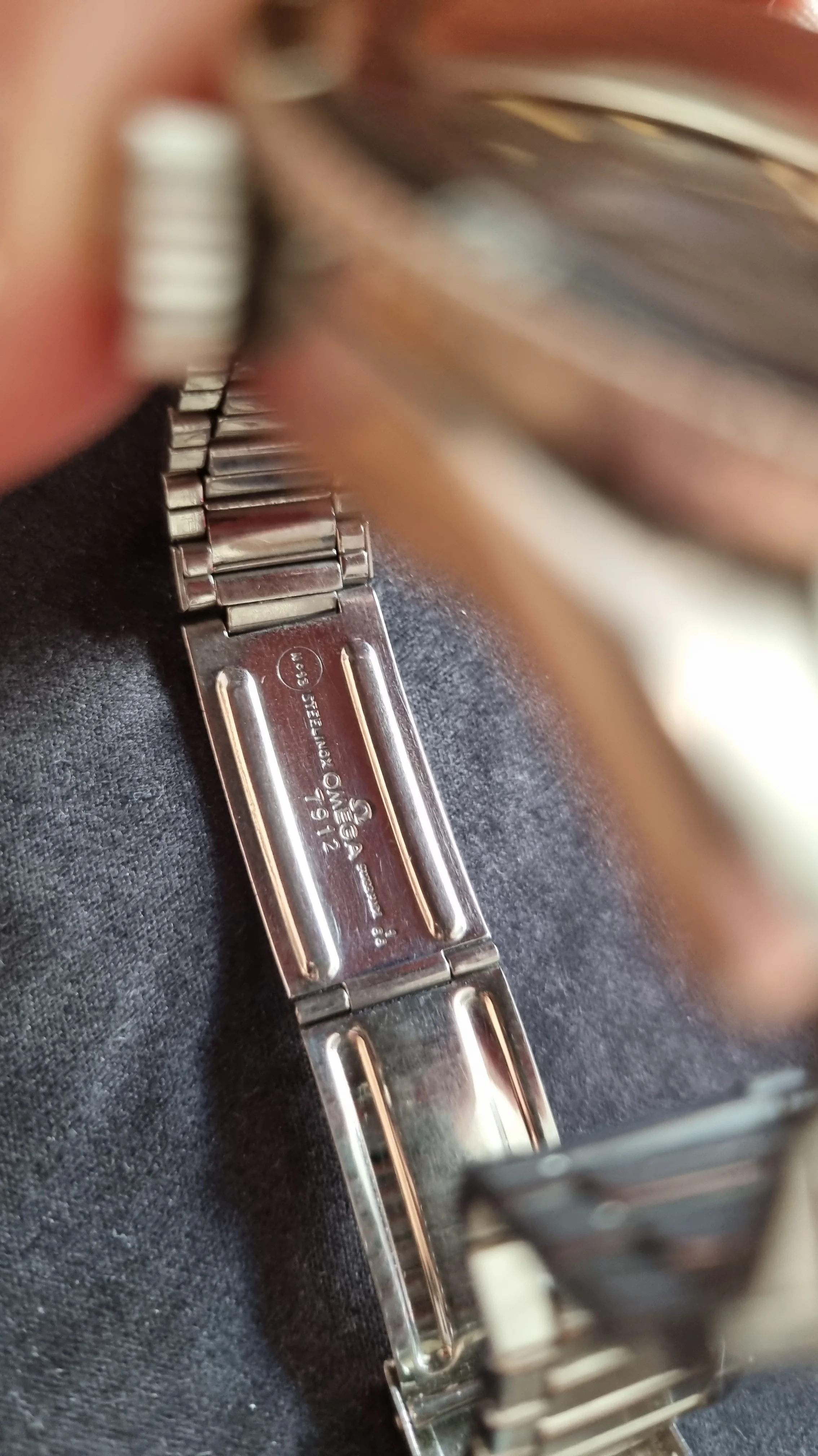

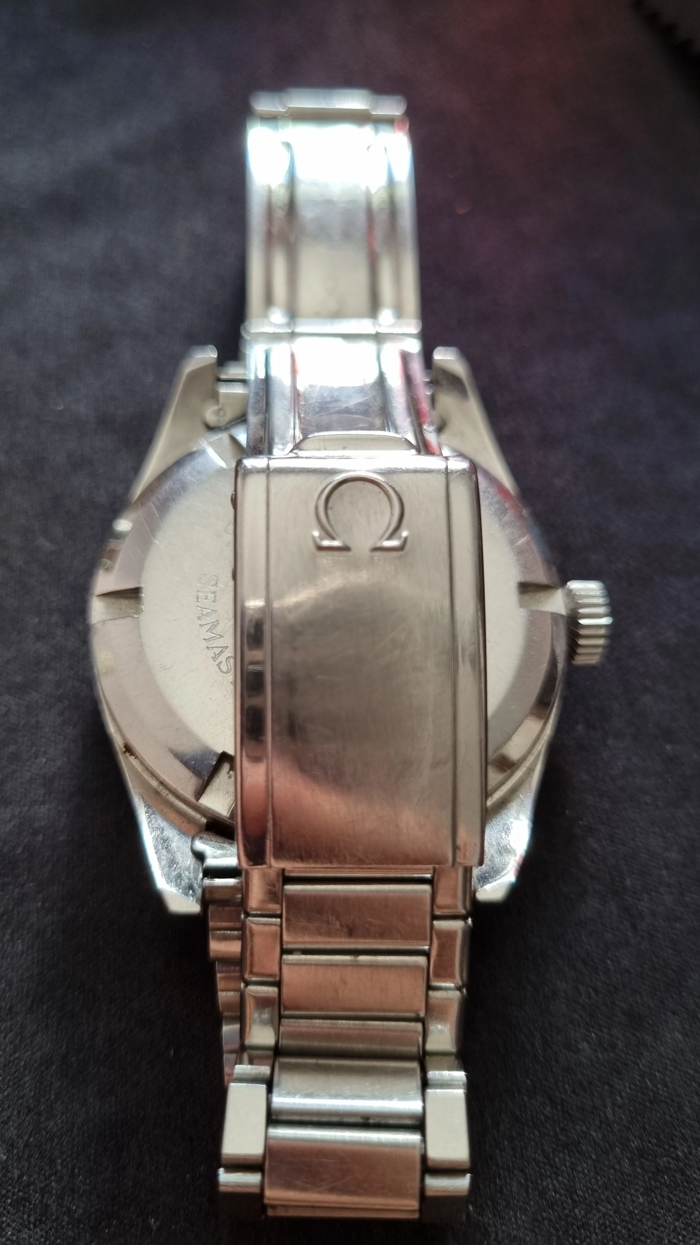

I have the same bracelet, on a Seamaster 300 ref 165.014, also stamped 1/66:

I wonder if it could be something that was commonly done at service on damaged 7912s, that updated Omega symbol wasn’t in use to my knowledge in 66 so it would be hard to imagine how it could be on a bracelet from that year originally. The 7912 clasp covers are somewhat fragile being a thin stamped part and probably did need replacement even in their early years from time to time

I guess that's possible, but the rest of the bracelet's in fairly good condition (as is the watch that's attached to it).
Anyway, I posted it to say the one in the OP isn't the only one out there.

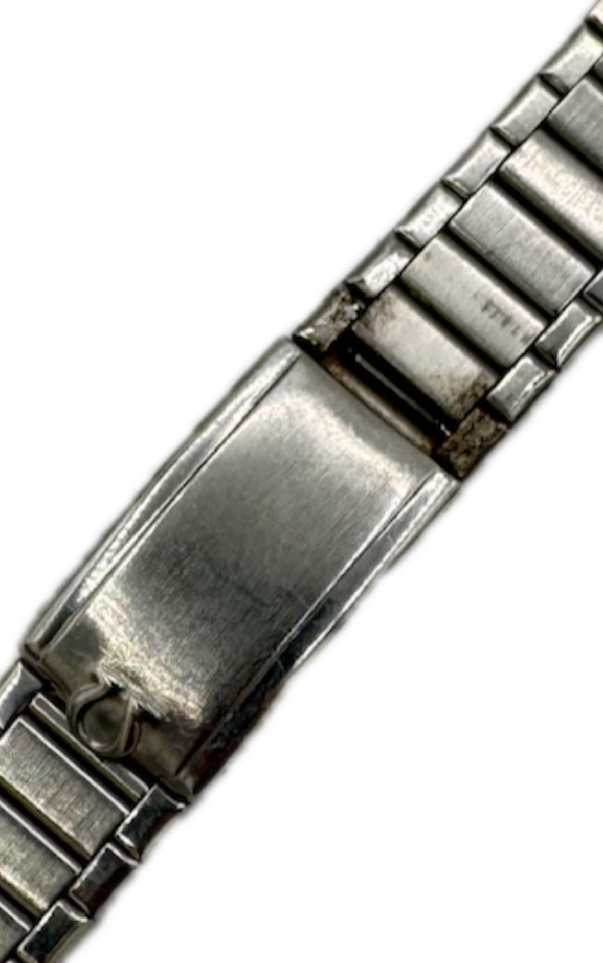

Here’s a 1/66 dated 7912 (currently with #7 end links). Is the damage to the clasp and link area irreparable?
