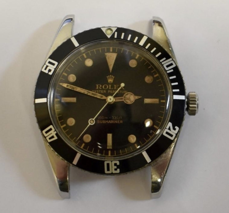

Good evening boys and girls,
I have been doing a bit of research on this watch, dial and hands look correct to my limited knowledge......but that bezel just looks wrong, something about the 50 mark.
Or is it just a slight variant as it seems a lot of changes were made on this watch series?
Appreciate any input.

Probably not even a Rolex insert. Owner just threw something in there.

Apart from the terrible insert......what’s the opinions on the dial and hands???

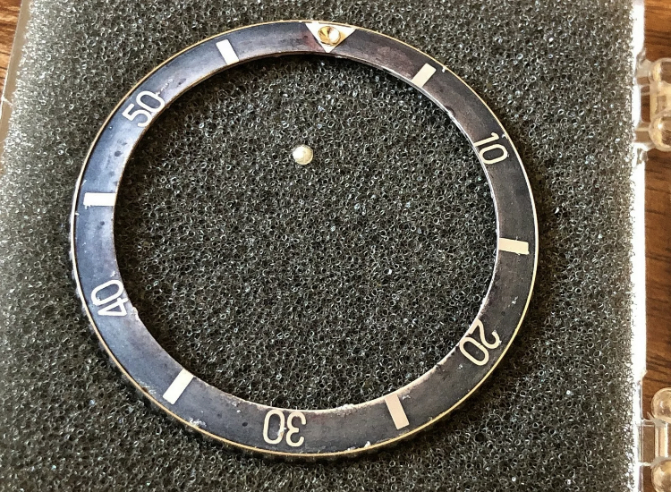

Good morning I hope everyone is staying safe, I’m reaching out for a bit of help on an insert for this watch.......opinions on this one please?

Agreed that this is not a Rolex Sub insert. What is you goal regarding the insert? If you are looking for the correct insert, it would probably be a red-triangle, and the price would be astronomical, if you can even find one. Or are you just looking for an insert that would be a plausible service part for this watch? In that case, you just want some sort of 60s or 70s fat-font insert, and I'm not sure it really matters which one you use, since it wouldn't be original anyway. Even there, you're probably looking at about $2k USD, but at least they are readily available.

Thanks for the help, ideally I would like to get the watch back to period correct condition, but like you say that is going to be very very expensive! I did find one red triangle insert in really good condition but it’s $30k, just an amazing price!!!! To make it wearable I’d agree it’s probably best to fit a plausible service insert. A couple of members have already offered some options. So I think I will just continue the hunt for a red triangle insert at a “reasonable “ price and see if I get lucky!

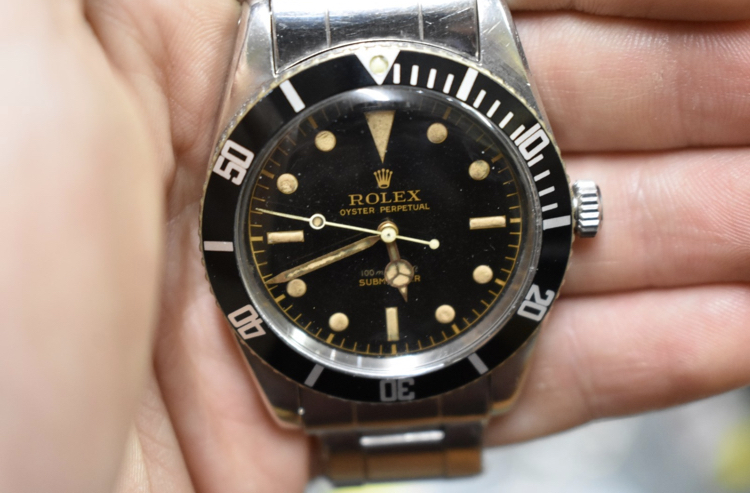

Dead Link/rover/0/0/0?mpre=https://www.ebay.co.uk/ulk/itm/383493602121
Some people must think it’s genuine!

Not correct, you could fit a long five on it to be as close as possible without having to spend a huge amount of money.

Well, they're wrong.

Did you notice that the sale didn't go through, and since then he has resisted it twice, with no bids?

Yes I saw that when it was relisted exactly the same description but added the word “aftermarket”!

Both inserts are fake, congratulations to the new owner of the ebay listing!!
