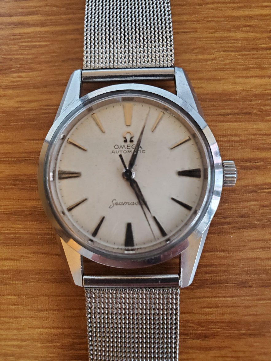

Hi all,
My early 1960's Seamaster has been losing around 60s to 70s per day lately and I was wondering if anyone thinks it's just a service issue- I just had it serviced just under 2 years ago. I know that it's a vintage watch but I somehow feel that 2 years or less between services is a little too frequent...
As an FYI cal is 552 and I had the rotor replaced during my last service as it was damaged (according to the servicer). I wear the watch every day.
Any ideas/help solving the problem would be appreciated- I don't want to go in for another service so soon just to have it not fix the issue...
Pic for fun 馃榿
