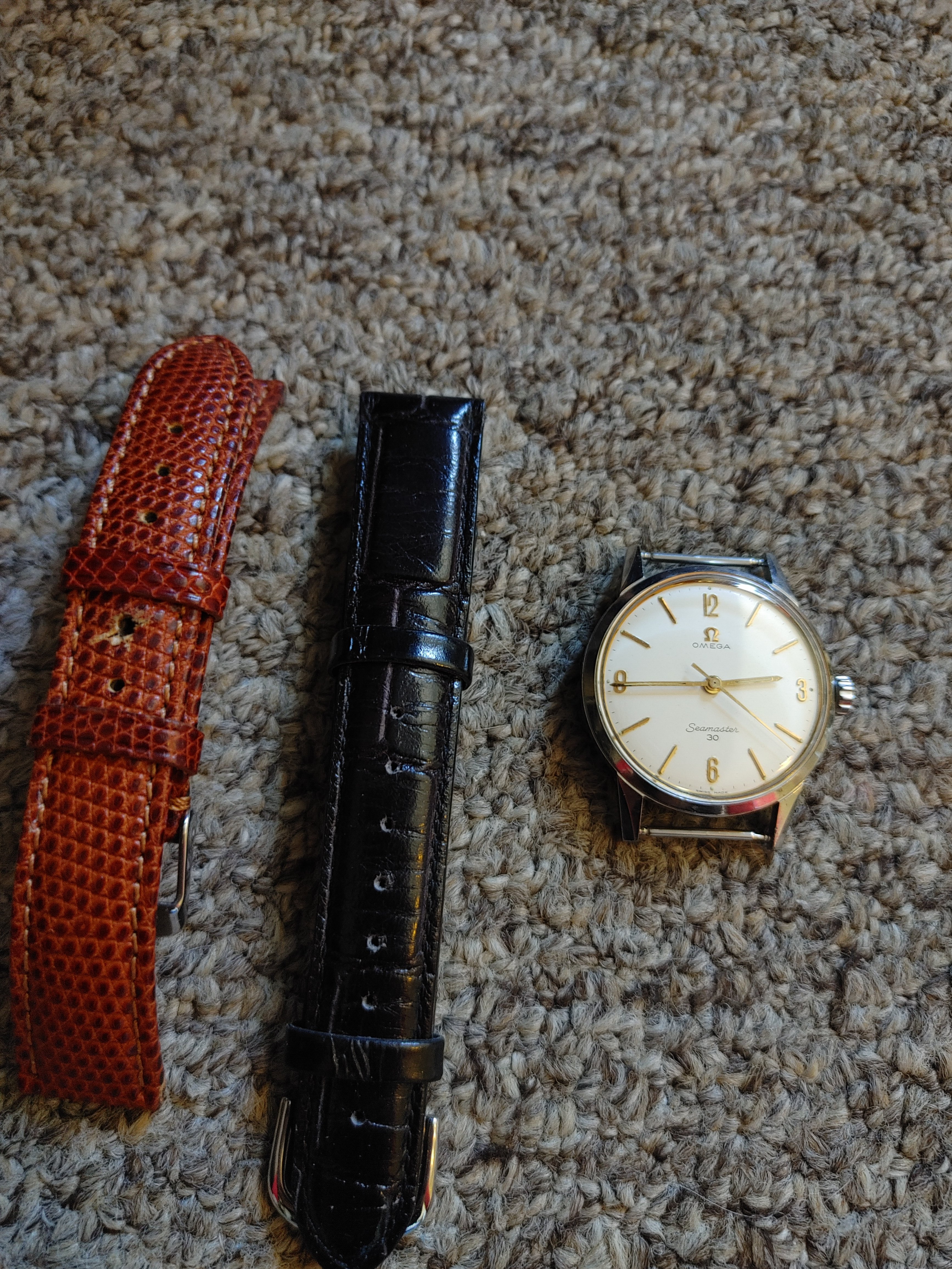

Hi all,
Ive picked up a very nice 1963 Seamaster 30, ref 135.003. I'm wondering about different bracelet options for this. First off, is this even possible?
In digging on this forum I've found: https://omegaforums.net/threads/case-bracelet-endpiece-list.81618/
The correct bracelet being the 1317/378 (if I'm reading this right). Is it possible to put something like a 1037/570 on it? Or no. Any alternatives as i can't seem to find the exact bracelet reference anywhere.
Thanks in advance from something of a newcomer.
