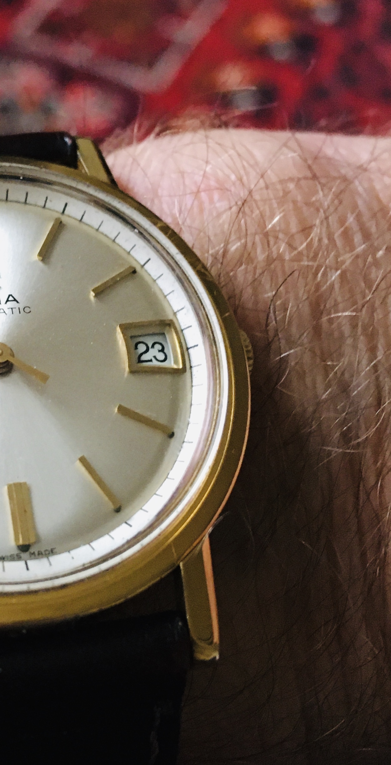

Hi all,
I recently had a watch repaired by a well know on the forums maker who specializes in omega. I received my watch back in excellent condition, however the replacement crown is impossible to wind. This was right before COVID, and wasn’t able to send it back to be looked at since.
Now he isn’t responding.
Does anyone have any vintage omega watchmakers they recommend?
Thanks!

Can’t speak to the what the watchmaker did but I have several factory replacement crowns that have gaskets that are just like you describe- almost impossible to wind or set without tearing up my fingers. It’s not a problem with the mechanism, it’s the friction of the rubber gasket on the tube and will loosen up with time- but feels like an eternity and makes me not want to wear the watches.
I posed this question not long ago regarding the same issue and many helpful members recommended a tool like this
https://www.esslinger.com/watch-crown-winder-tool/
They come in different sizes (crown sizes 4-5mm, 5-6mm, 7-8mm)and there are other makers but the principle is the same.

When I added new crowns. I placed a touch of watchmakers grease on the case tube which made winding easier.
You could try a little dab of vaseline on the case tube and see what happens.
Could also go to your local mechanic and ask for a little dab of grease
Pull out crown to setting position and touch a tiny amount to post and spread around.

Quick question - does the crown wind about the same forwards as backwards? There will naturally be a little more resistance when winding forwards because you are winding the movement, but if it's also quite difficult when winding backwards, it's likely the crown seal as others have suggested.
If there is a massive difference winding forwards compared to backwards, then there may be a movement issue. What watch is this specifically?
