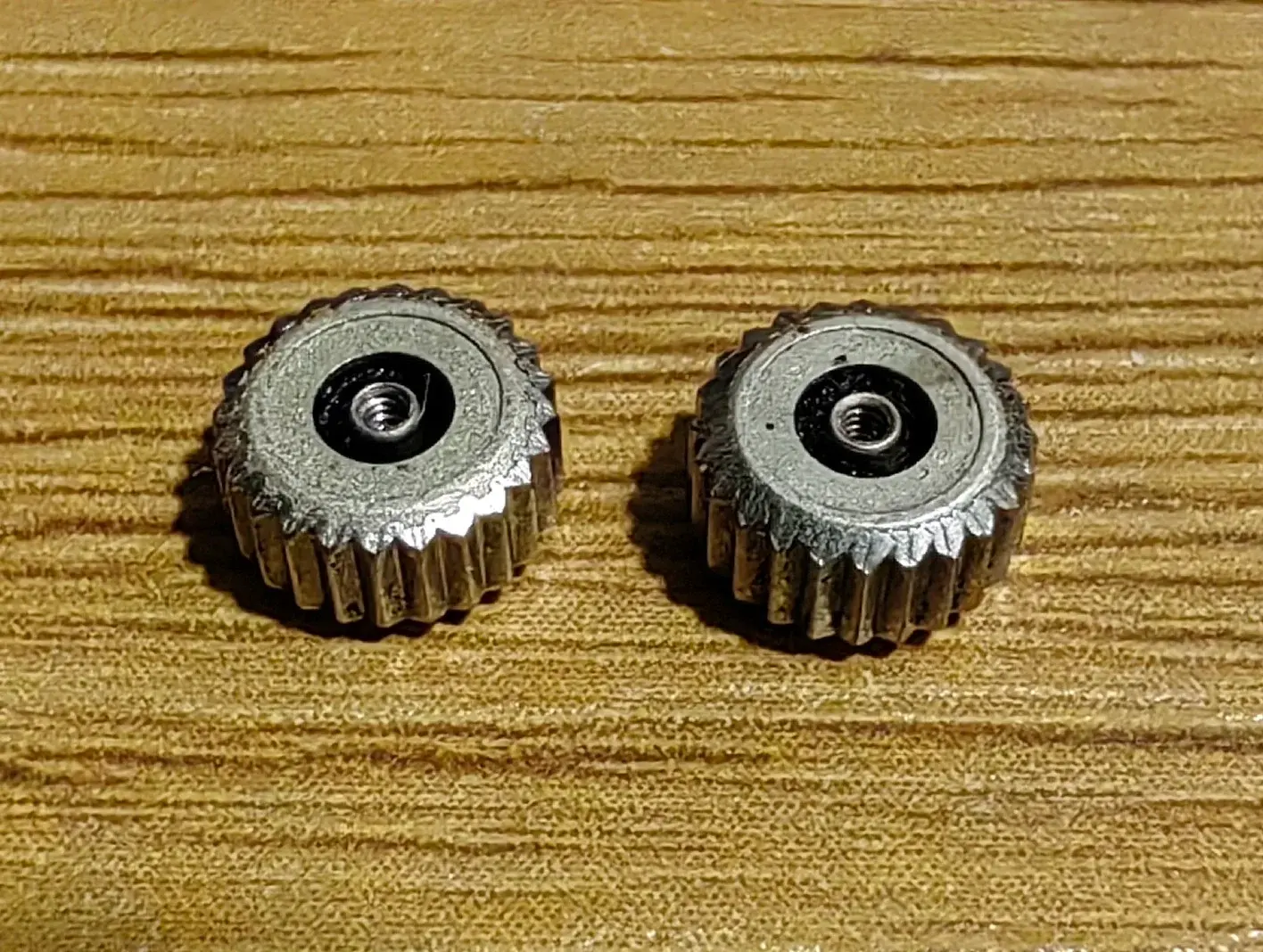

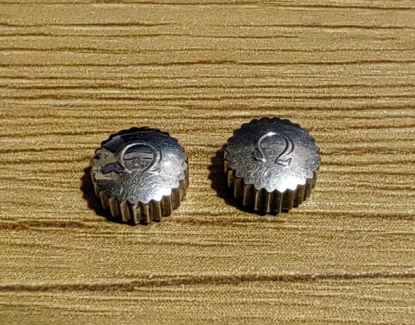

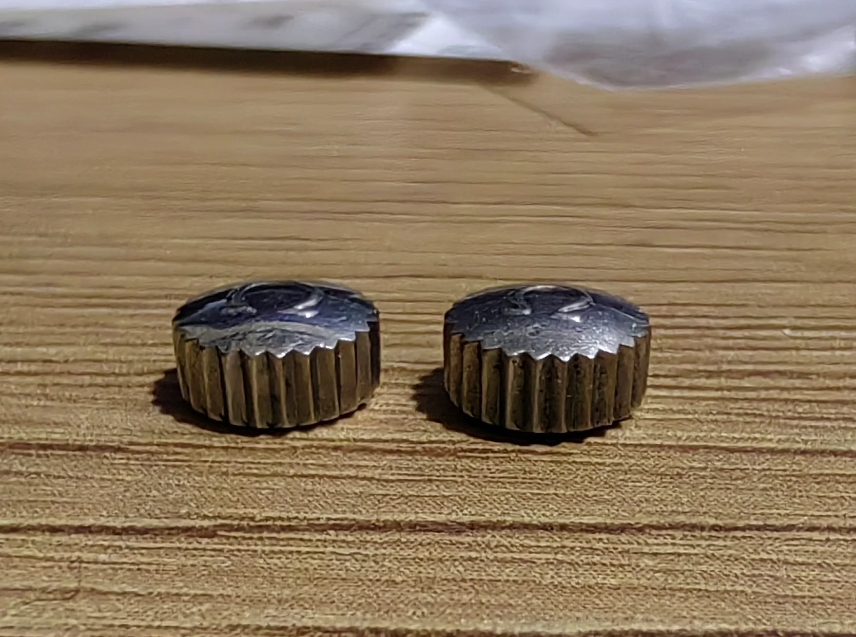

I bought some 6.5mm 24-tooth crowns a while back that I would like to define.
I done my homework and will share my attribution.
Please let me know if I am right or wrong in my assumptions.
The first pare has (diam 6.5)x3.35mm and X3.5mm in hight (pictures attached - sorry for the low quality of the shots).
I suppose both crowns to Speedmaster 145.022-69
282
64

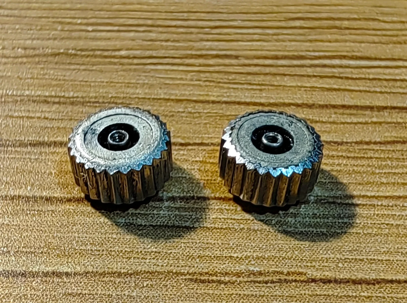

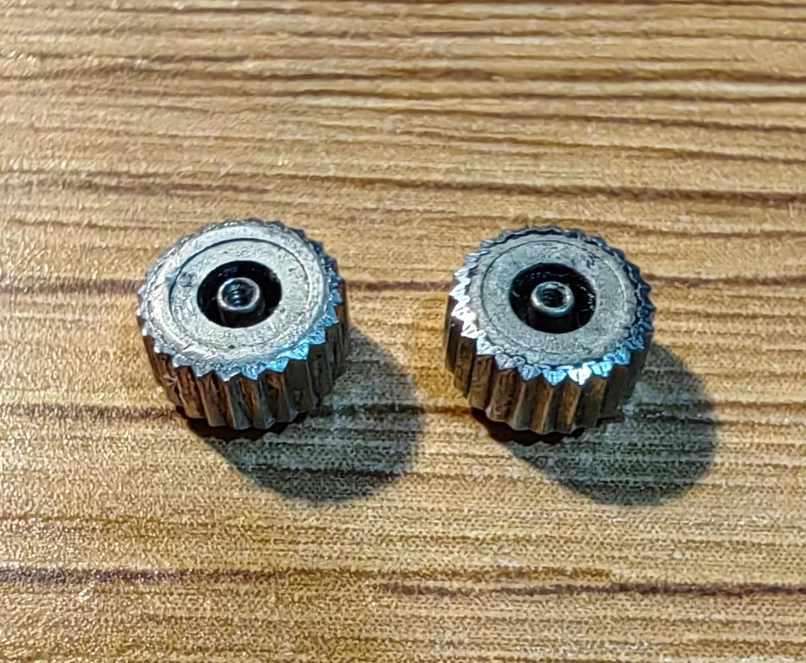

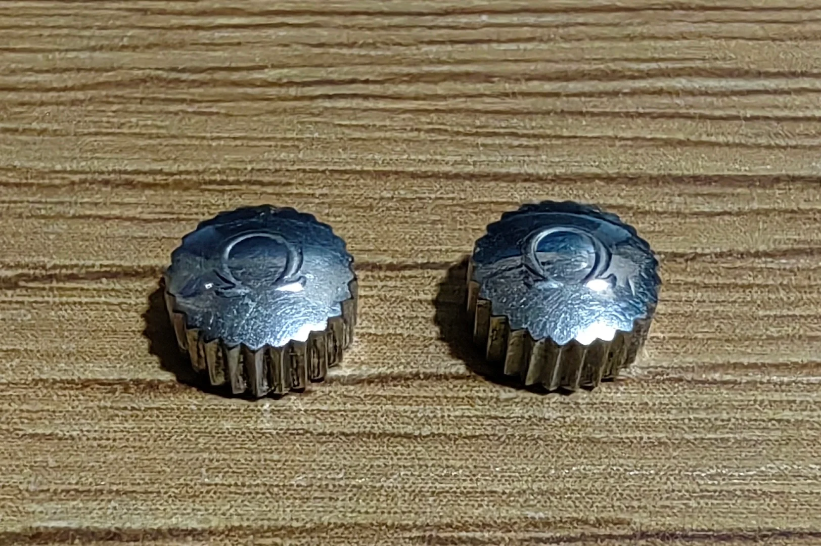

Second pair is 6.5x3.4mm crowns, which I suppose should fits to SM300 and Ploprof :
282
64

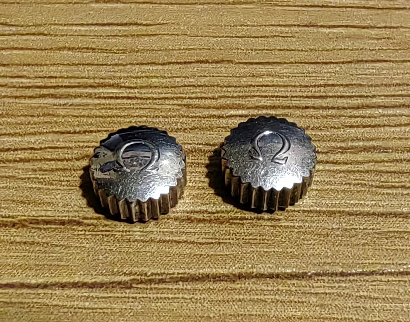

Please, let me know your opinions, and one's sorry for such pictutres.. 🙄
384
375
You need to check the tap size for the stem. A tap size of 0.9mm would fit a seamaster and 1.0mm would fit a speedmaster.
All I can contribute is that the crown on the top left is a likely a SM300 service crown due to the dimensions.
The lack of flat footed logos and later style of crimping makes me think all of these are crowns for later models or are service items.
282
64
