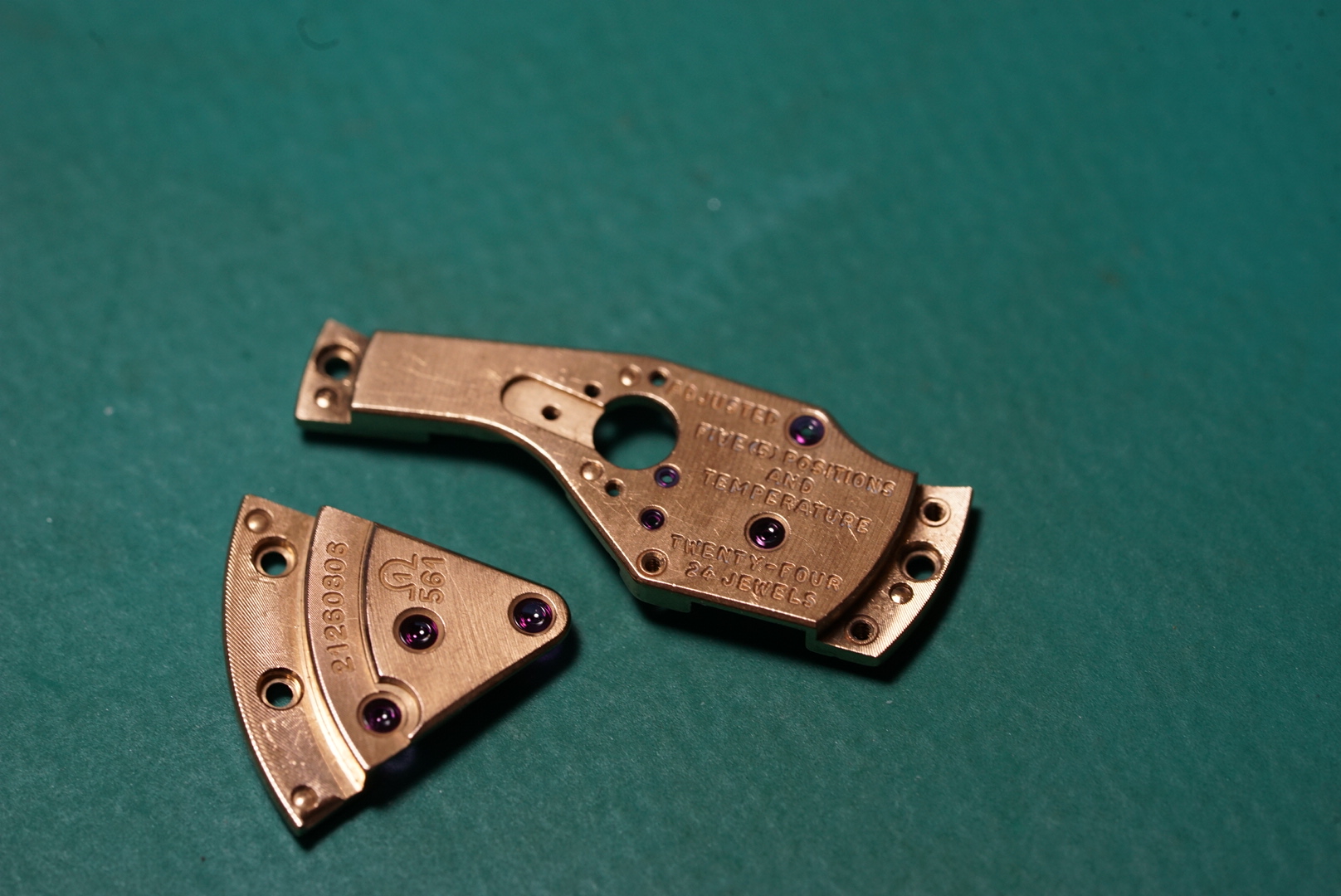

I purchased a constellation from an auction that has a "561" movement in it.
I have been working on servicing and restoring it, but have encountered at this point numerous strange things.
I wanted to ask if anyone knows if its possible that a 550-1000 would be swapped out for a 563-1000 main plate during a legitimate service?
This movement has a 563 main plate based on the lower incabloc setting, and also had a strange mishmash of the expected and 563 keyless works parts. So I am really starting to suspect a franken-movement.
Did i get a 565/3 with 561 bridges swapped in to make it look like a chronometer?
Is there anything visually identifiable for a chronometer balance? Or would I need to get some additional tools for checking the poise of this balance?
I am trying to determine of its worth it to sink a bit more into this movement to get it running again, or if I write this one off as a nice case and dial, turn it into a donor and look for a 564 donor to swap in wholesale.
At this point i need a winding wheel and a lower incabloc spring to get this running again, both of which are proving to be surprisingly difficult for me to obtain at this point.

Lots of confusing things here...
First, a 561 wouldn't have a 550 main plate, because the 550 is a no date version. It would have a 560 main plate. It may have a 563 main plate, but no photos are provided.
The setting parts will be different between the 561 and 563 due to the quick set mechanism, so if there are quick set parts ion there (you don't show those) then yes it has parts in it that are not right for the 561.
There's no way to tell if it is a "chronometer balance." It's the same balance in all these watches, from the 550 right through. The chronometer rated watches are just adjusted more. Checking the poise isn't going to tell you anything.
