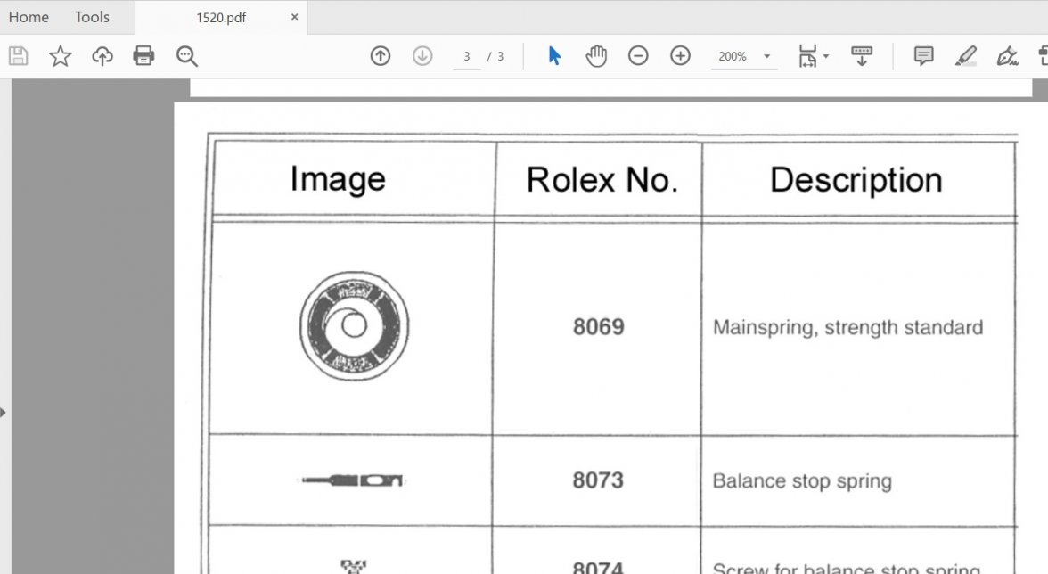

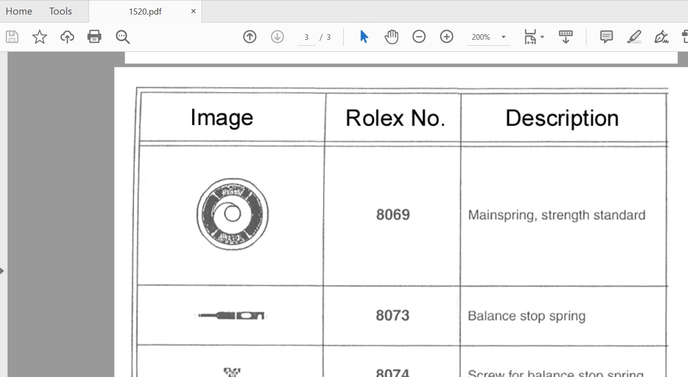

A caliber 1520 with a hacking mechanism? Maybe, but I don’t recall ever having seen one so equipped. Including my own 1520.
From the Cal. 1520 parts list...clearly shown...

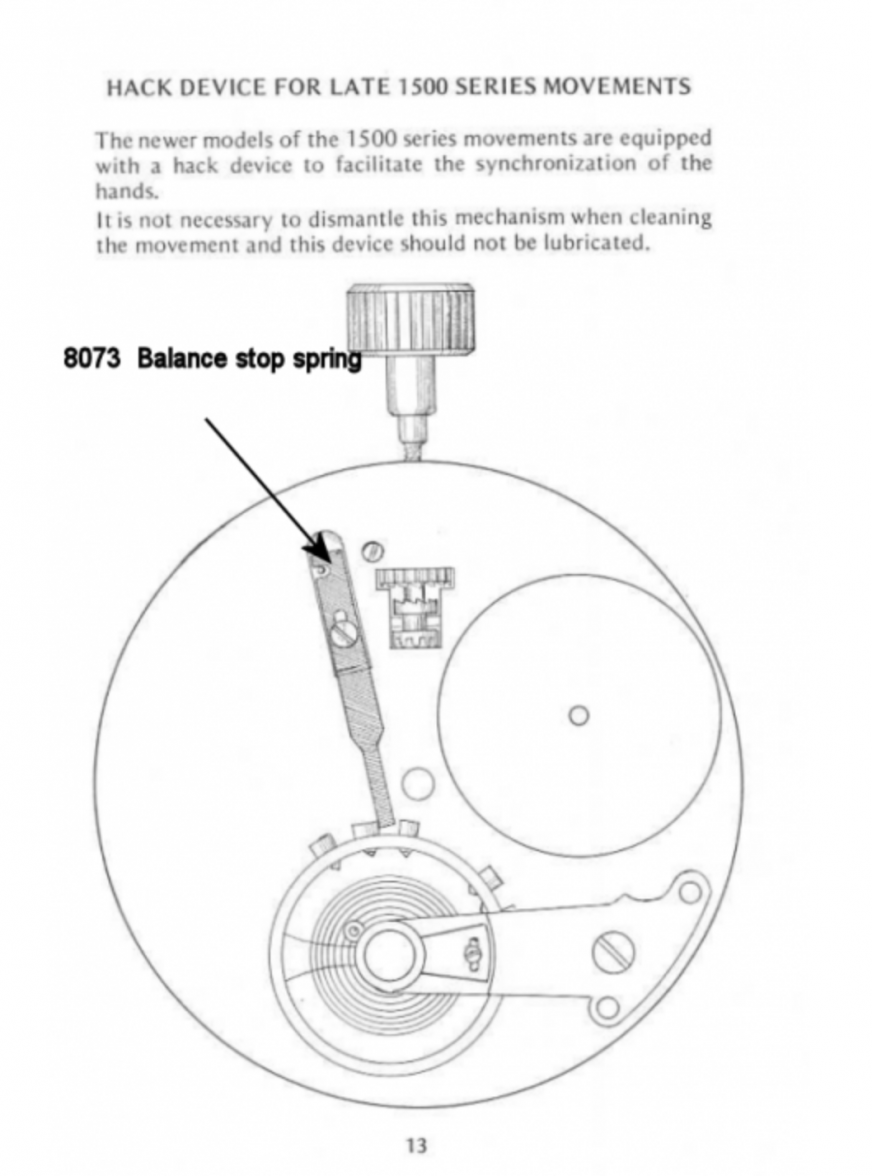

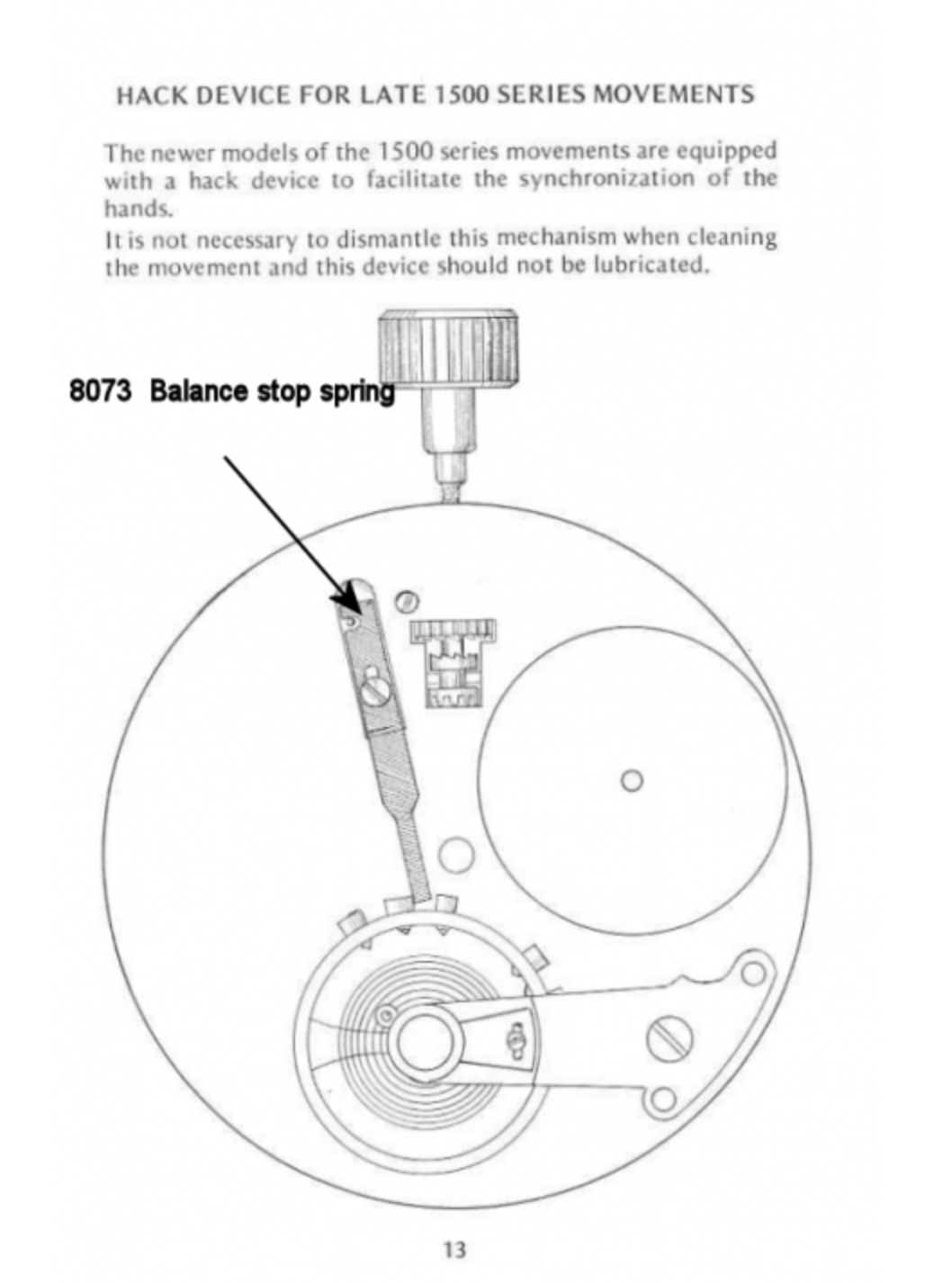

24,796
55,077
Several of the Rolex calibers added a hacking feature in the early 70s.
