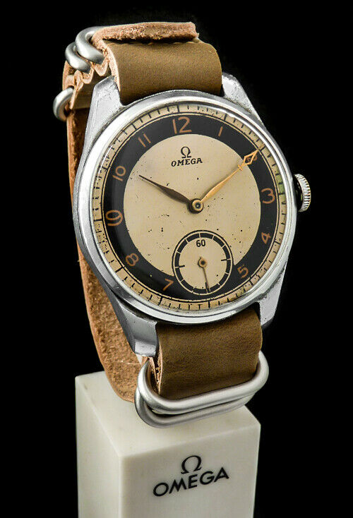

Hi all, and thank you for the help I have recieved over the last few months with a couple of questions I have had.
Today I discovered this and it has an appeal to me, however I have questions. Firstly, images.
The watch (45mm?):

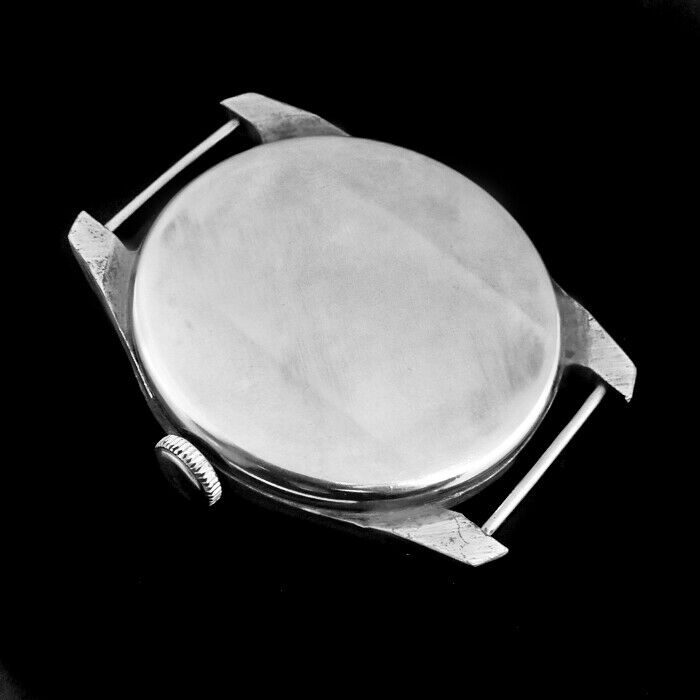

The caseback:

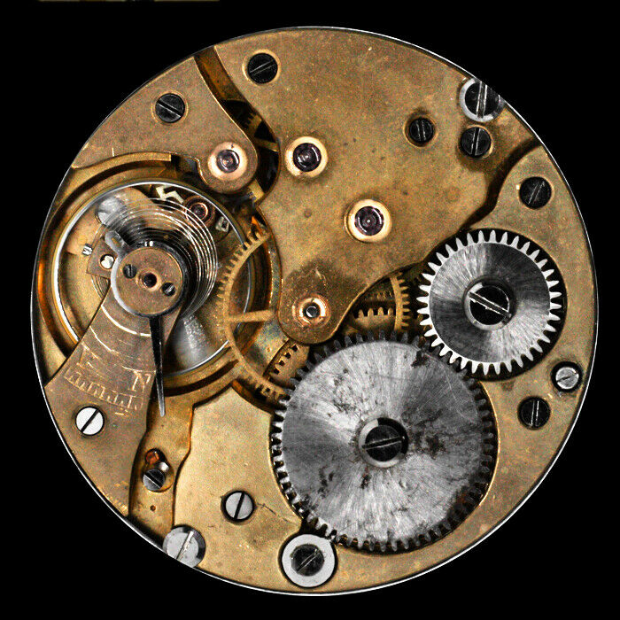

The movement:
Doing a little research the Omega type could be correct for the period, I searched Art Deco on the forum and a few sales examples had that typography.
Everything else I am finding it hard to decipher. The movement has no markings, which having looked around can happen (unless I am very wrong?).
The size would indicate that if correct it maybe a converted pocket watch? I can also see that the hands are different shades and possibly the minute hand has been changed.
I suppose the question is. Is this just a big freak/franken watch that isn't even an Omega?

It is a recased pocket watch movement.
Which was my assumption.
In this scenerio would the face and movement have simply been placed into a wristwatch case, or are they 2 seperate pieces that have been placed together, or impossible to tell?
3,277
14,260
There is an entire cottage industry of folks who repurpose old pocket watch dials and movements into new, large wristwatch cases and sell them on eBay. These are known as a "marriage watches" and have no value to vintage watch collectors who prize originality above all else
However, a caveat: In the late 1930s a few wristwatch manufacturers - most notably IWC and their famous "Portuguese" models - placed pocket watch movements into large (44mm) cases. Omega did this too, in the very rare CK2039. Find one of those, and you'll earn the envy of collectors everywhere
