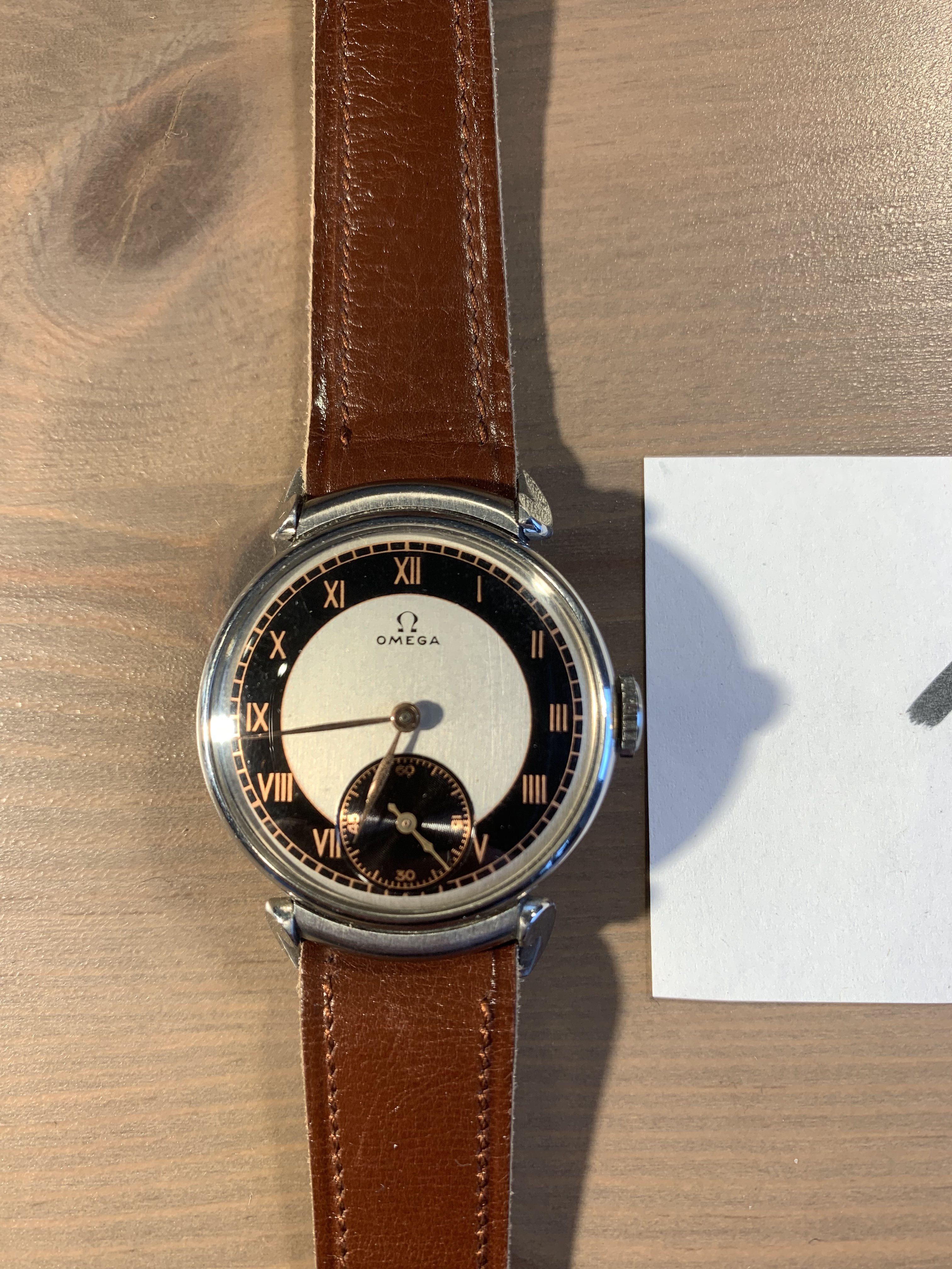

Hi.
My name is Matthias and im from The middle of Germany.
Thanks for having me in this nice forum.
And first of all, i apologize for my bad english/writing.

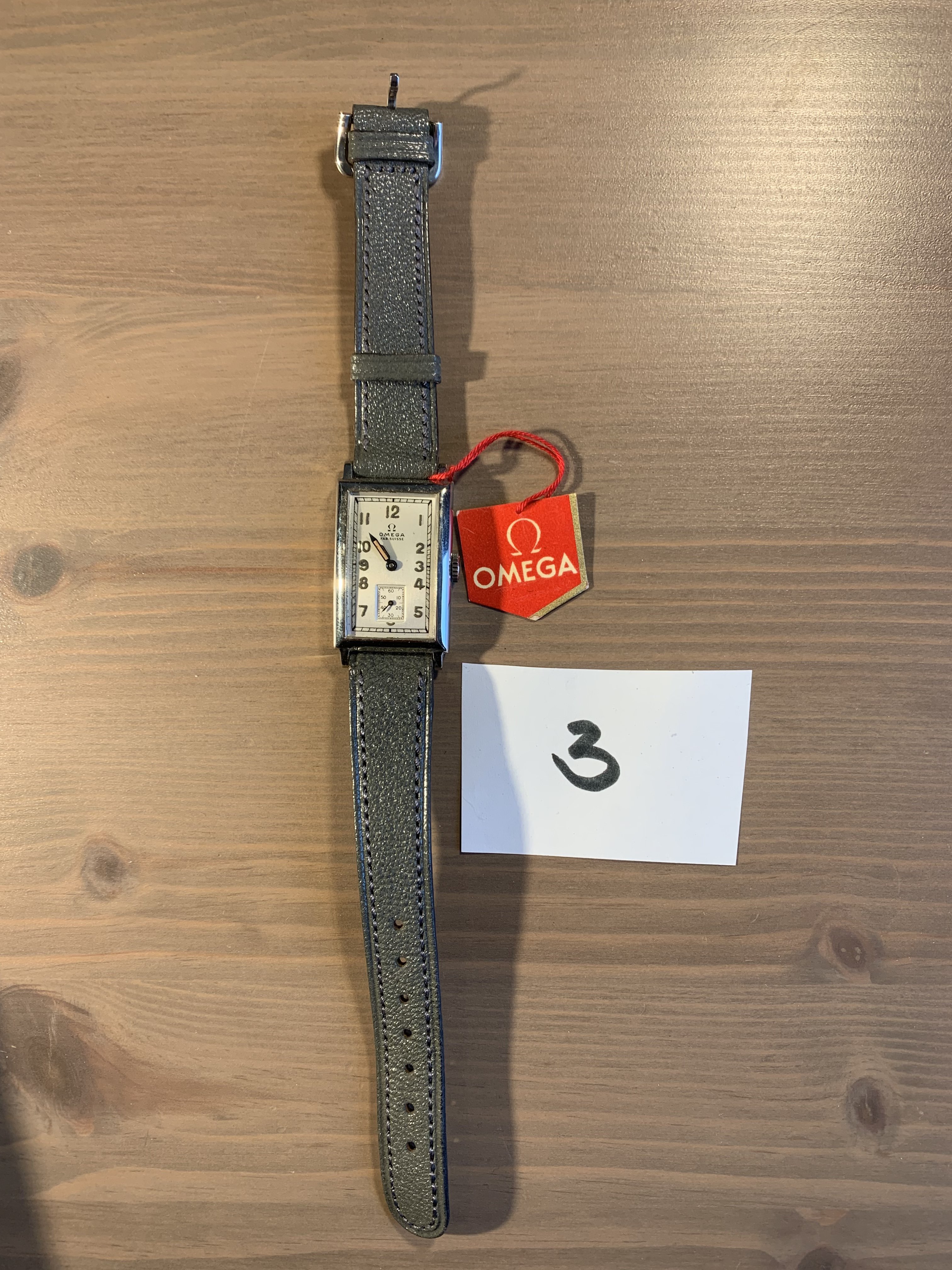

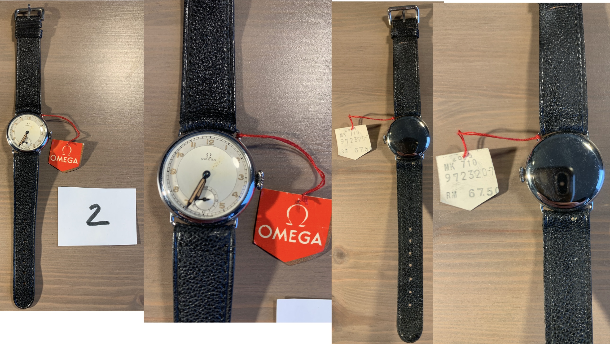

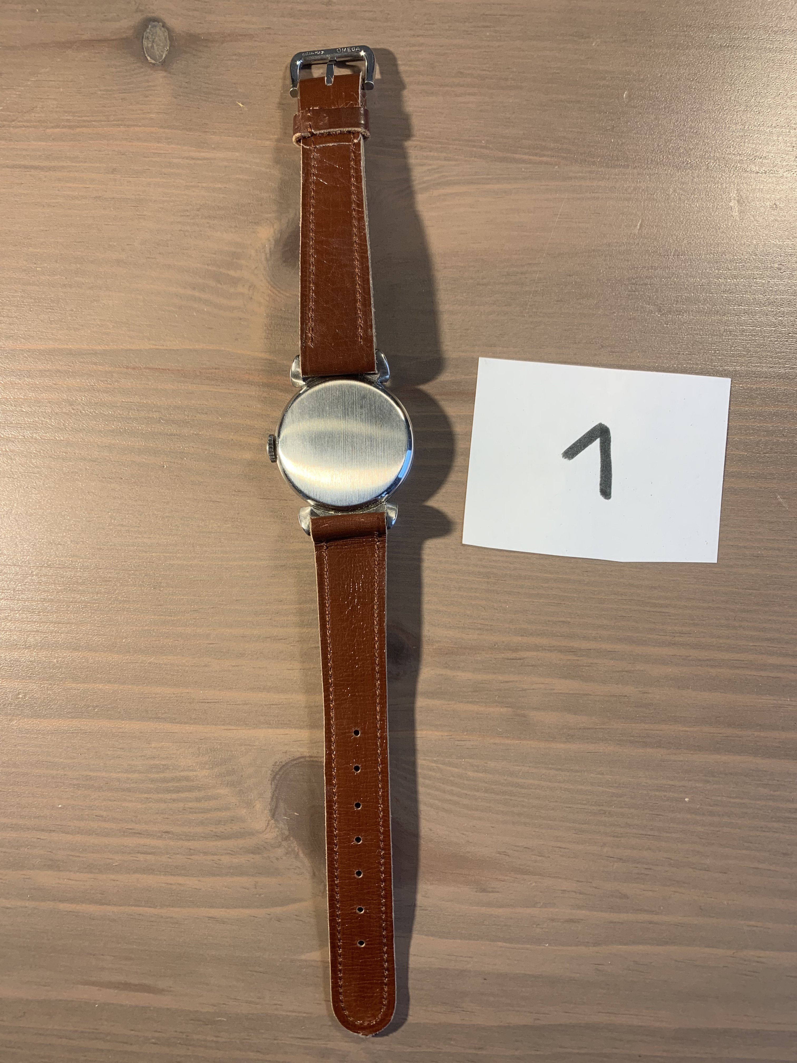

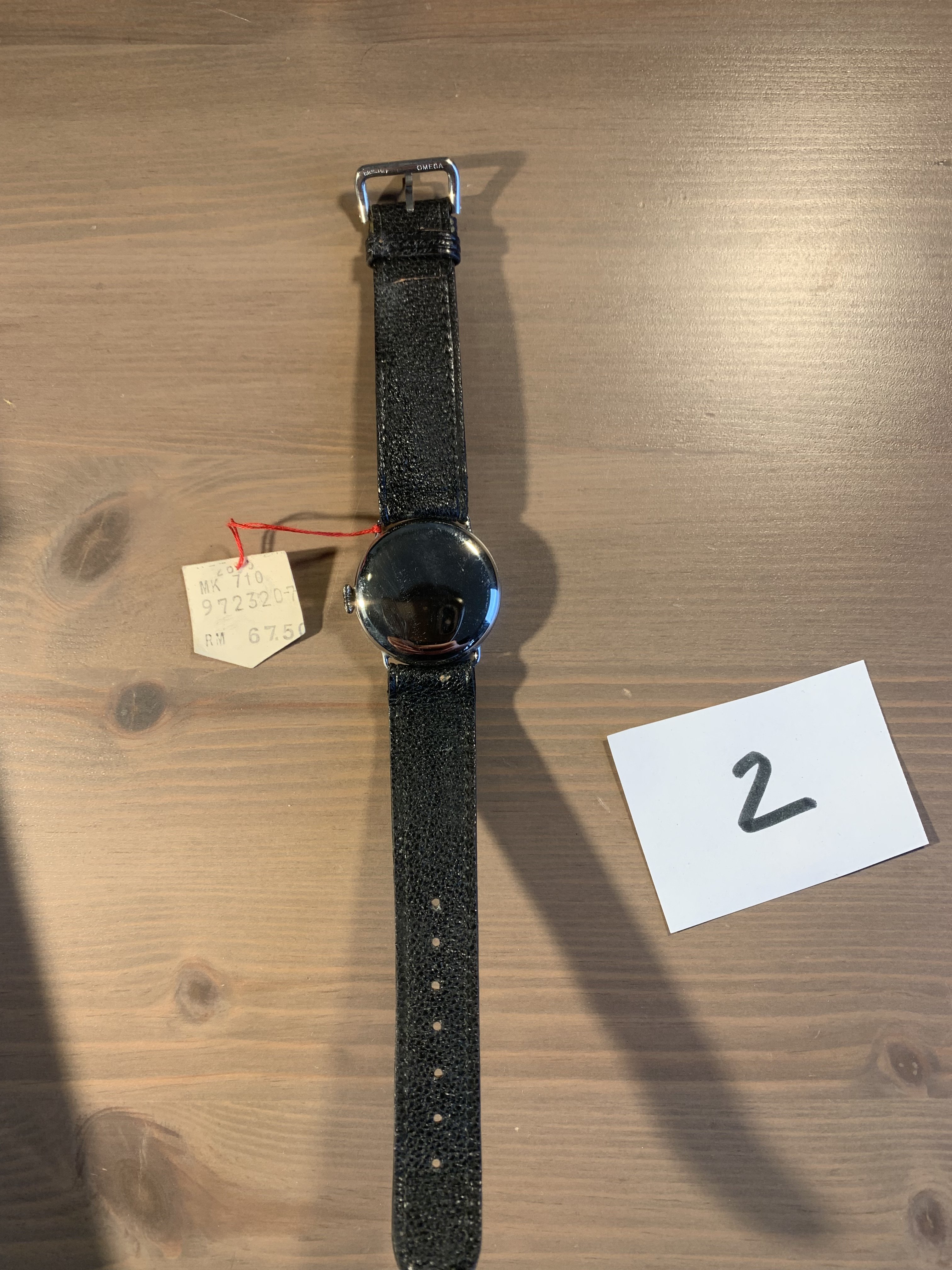

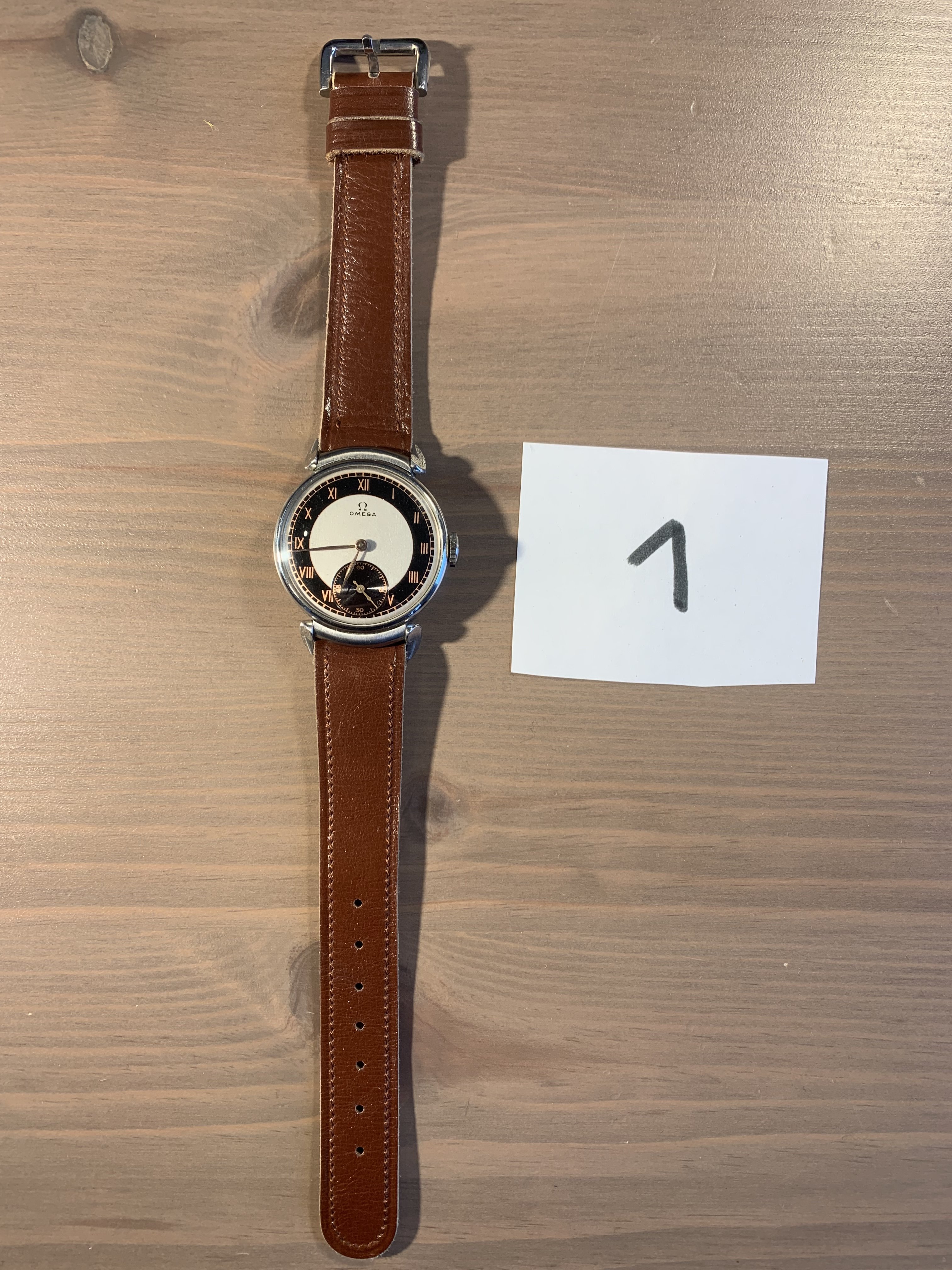

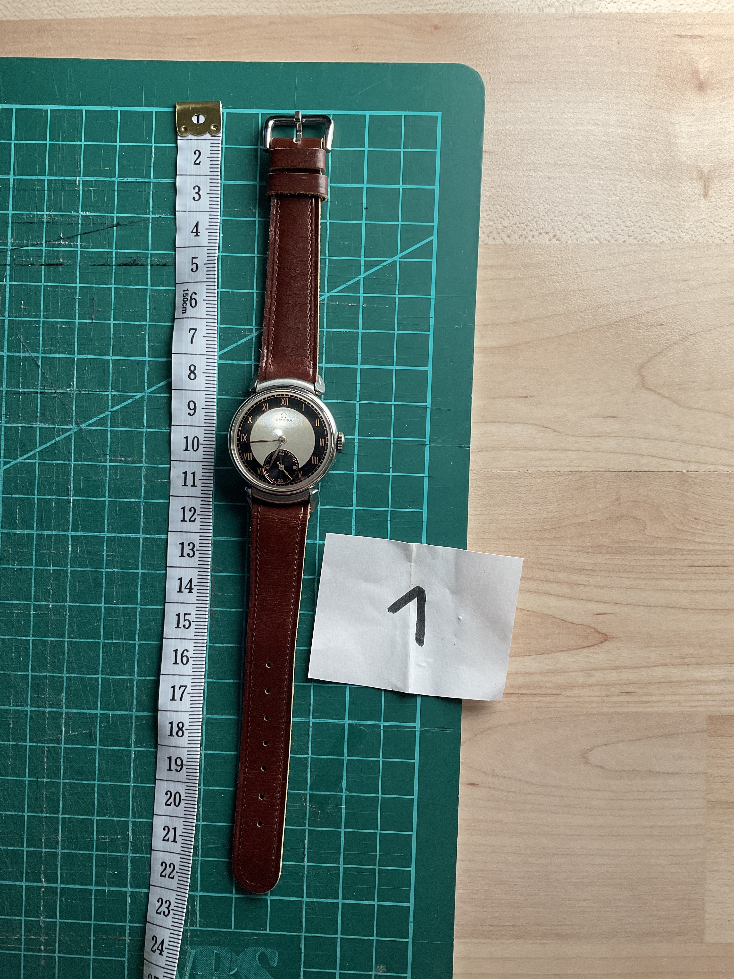

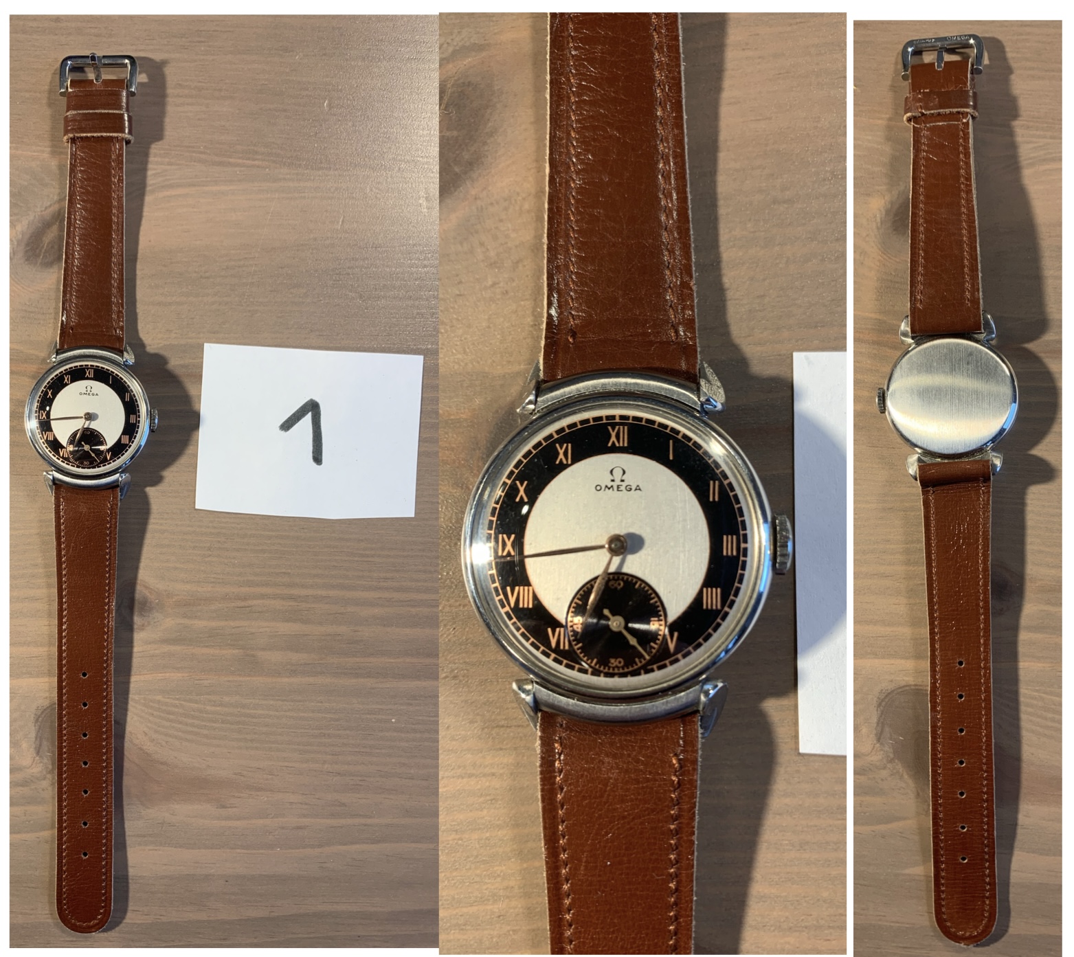

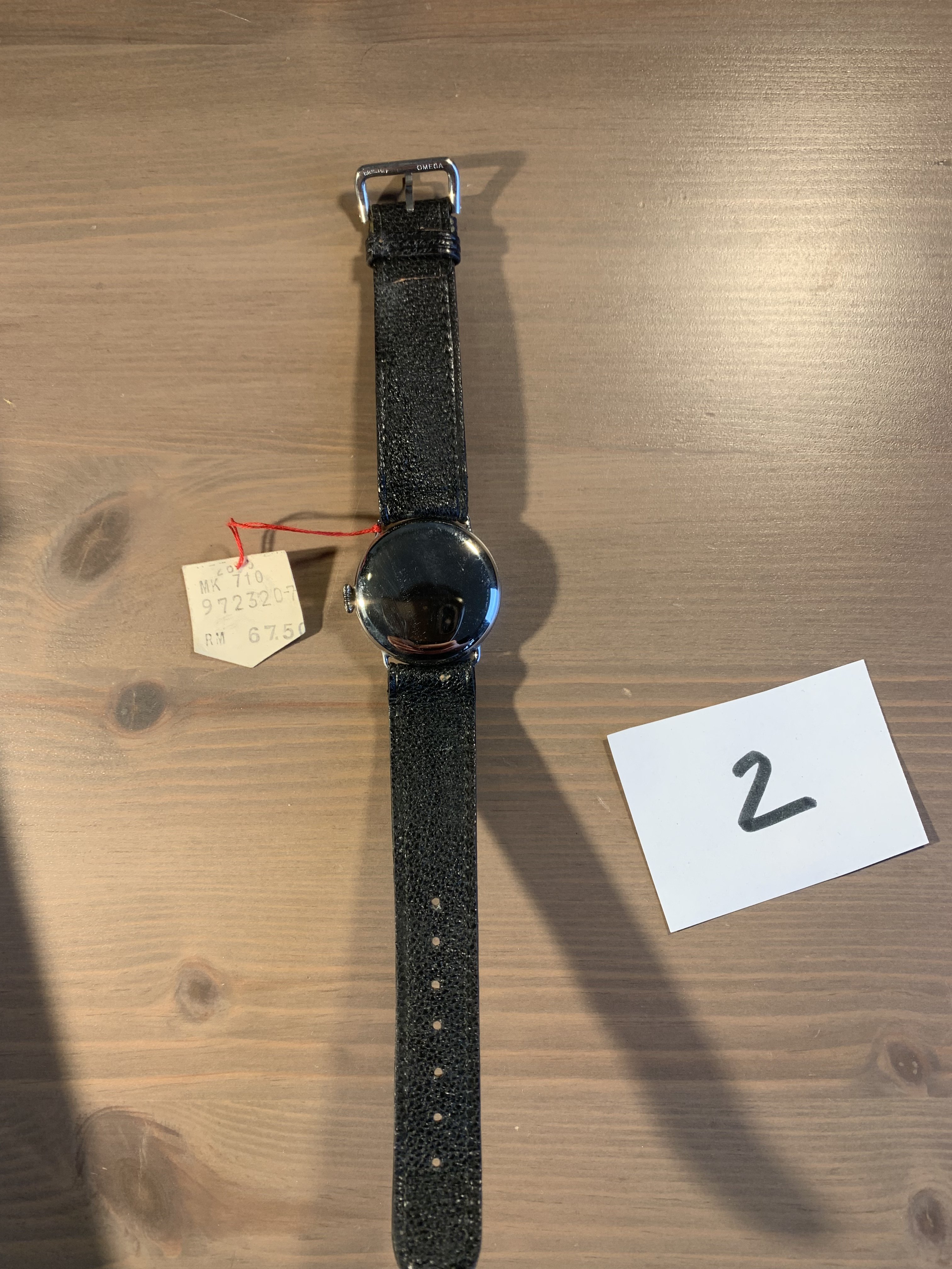

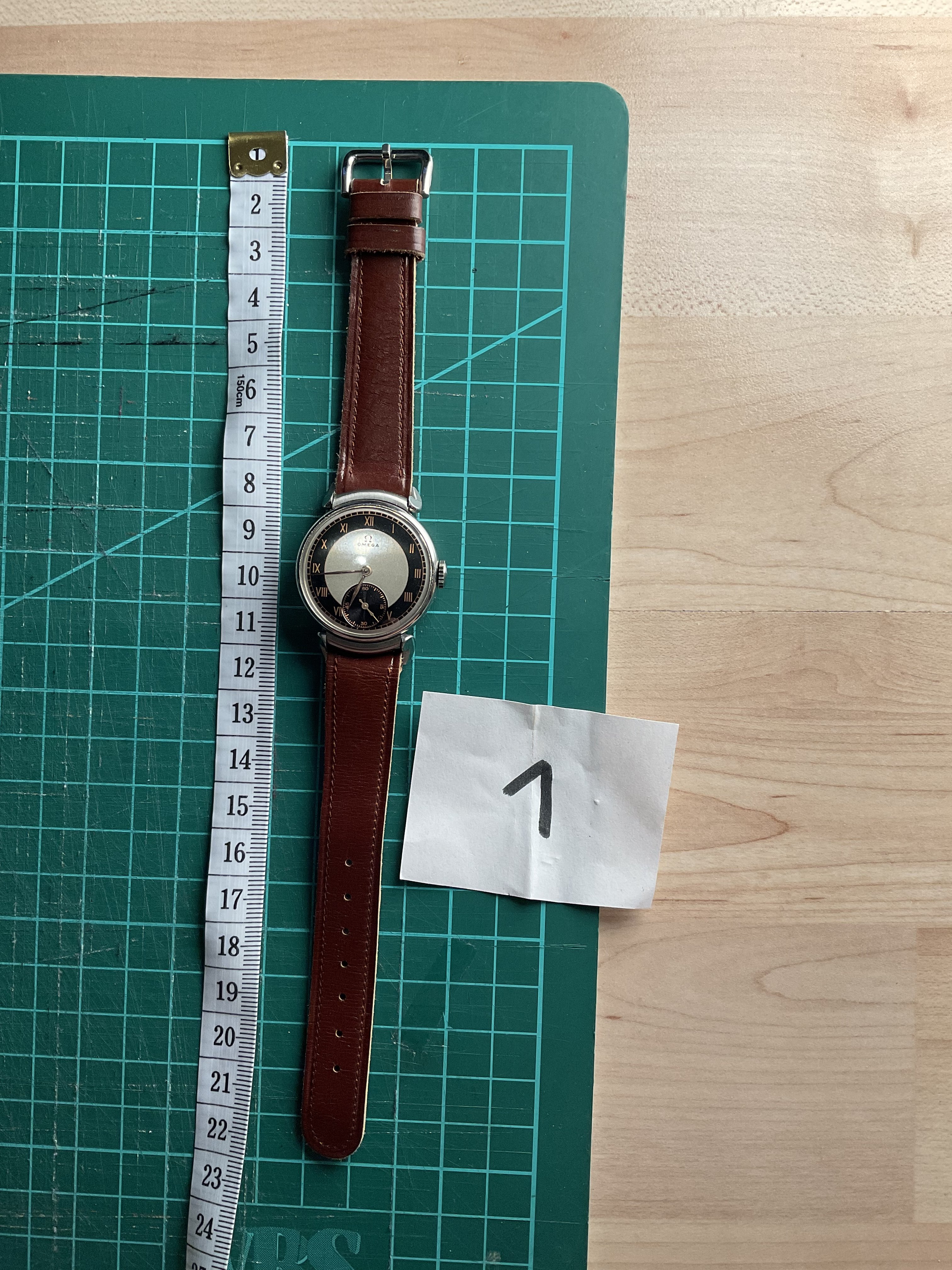

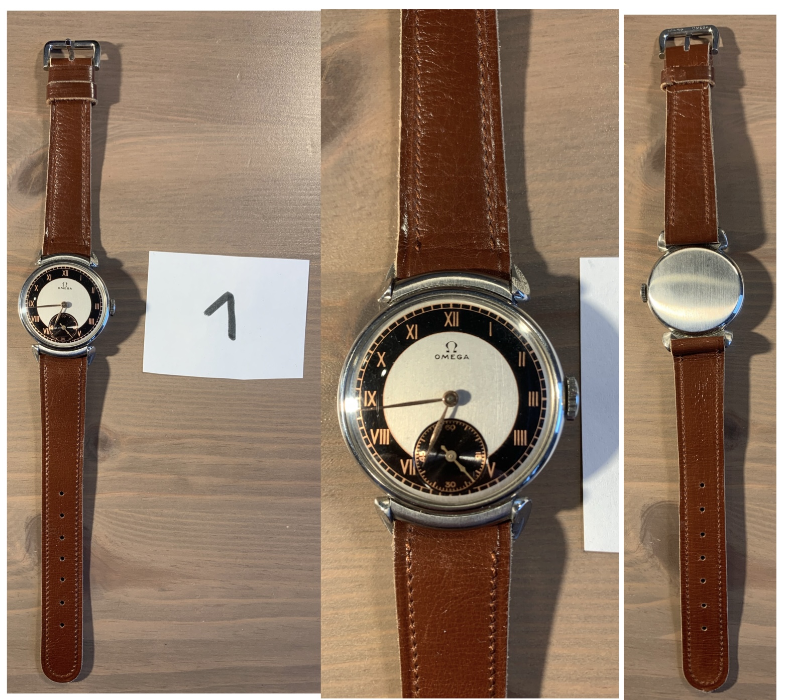

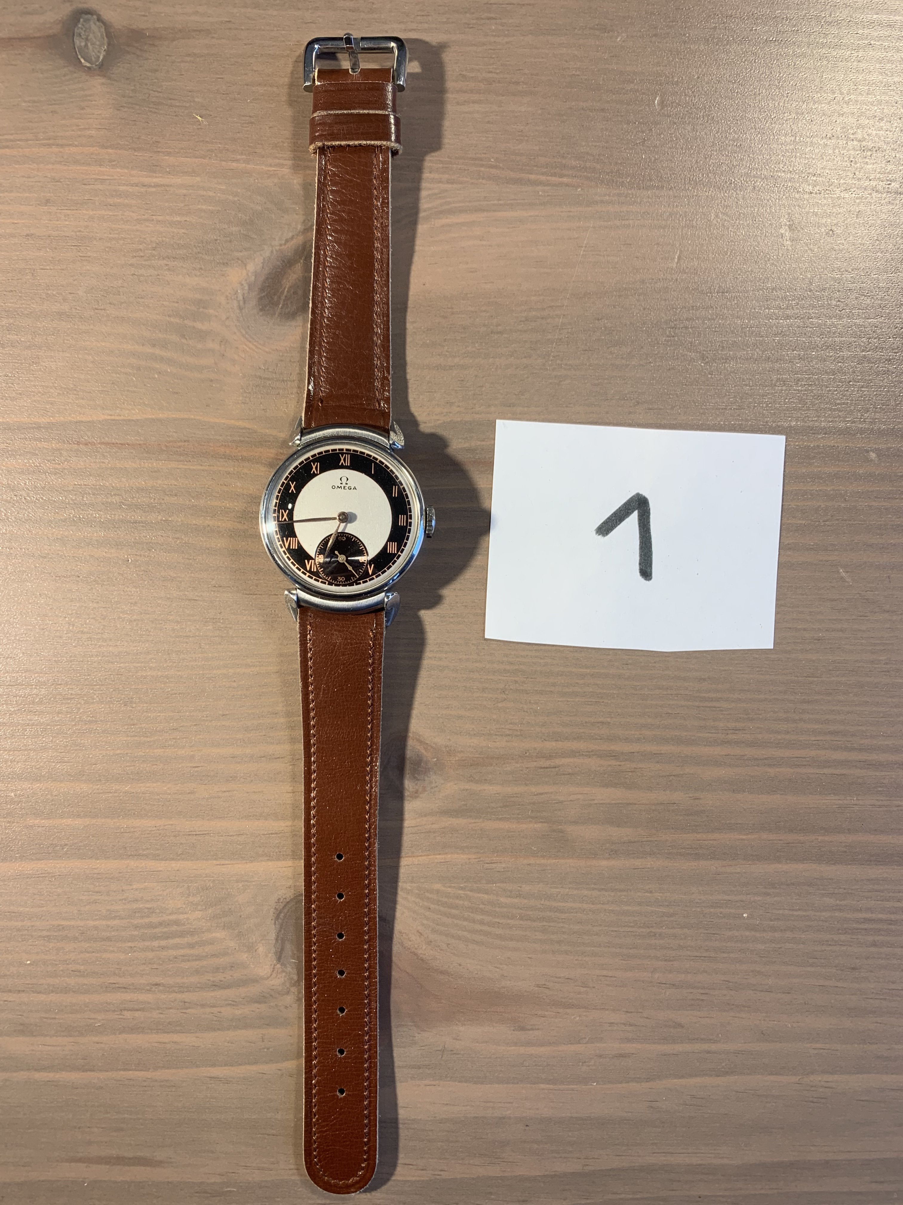

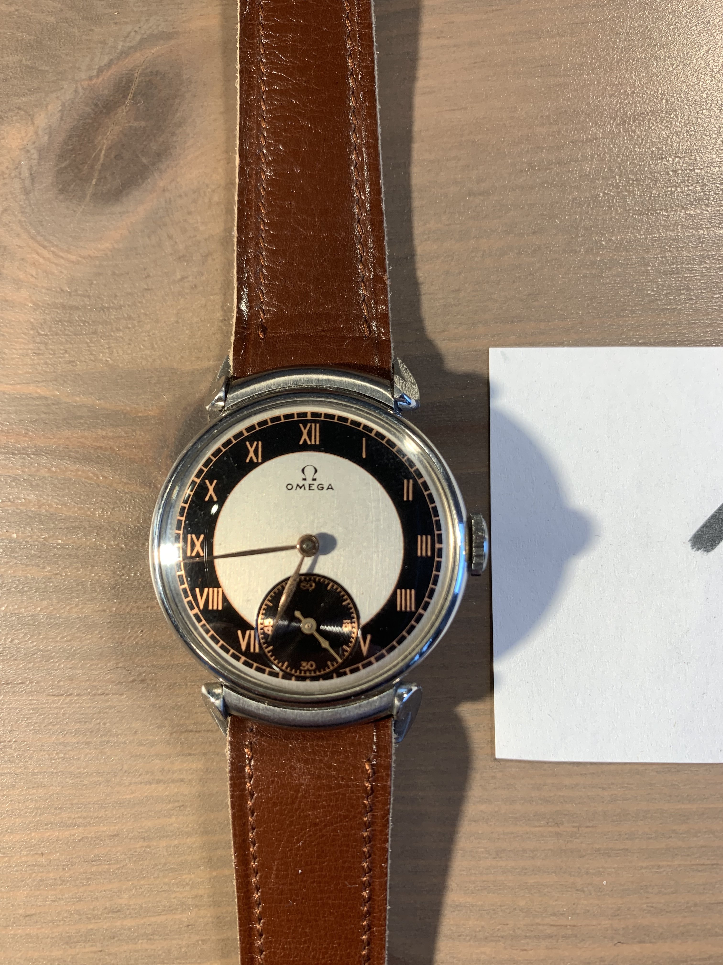

Beside of 29 other vintage watches, i was given these 3 Omega watches.
All these watches came from a store in Germany, that allready closed its doors 45 years ago.
The watches are despite their age totaly new and never worn.
Two of them with original labels on it. They have been stored dry all the time.
I dont want to open or wind up the watches, cause i dont have a clue about those things and dont want to break anything. Or do you think i can wind them up, to try them out?
Do you know wich models these are?
What do you think of them?
Is there something nice, that maybe have a value?
Thank you very very much for your help.
Greetings, Mat.

All I can say is WOW, just WOW, amazing!
13
6
Very nice watches, maybe have them checked and serviced before winding
13,556
23,504
Go-lly! Look at those! They’re wonderful.
Think very carefully before you do anything with them. They’ve been sat waiting for 80 years, so be patient and don’t rush in to opening them yourself if you don’t have the tools and capabilities.
Are you keeping them? If so are you looking to wear or preserve them as NOS?
2,816
3,747
As others have said, wow. These really are NOS. That label gets bandied about a lot, but these are obviously the real deal. If you want to sell them, do nothing. Anything you do (winding, servicing, cleaning) will diminish the value. If you want to keep and wear (and who wouldn’t), then definitely have them serviced before winding.
6,685
11,654
In the immortal words of Joey Tribbiani - "How you doin!"

Normally the term NOS gets thrown around very loosely but those are absolutely amazing examples.
That Scarab is epic.
10,125
57,953
OMG. Those are spectacular examples. The lubricants in the movements have long since dried out, so I would have them serviced before winding them. I can’t give you an opinion as to their sale value, but as a collector I’d say that they’re priceless! Congrats!

Welcome, Matthias - 🥰 for your "Fab Suisse" tank! And the others too... 👍

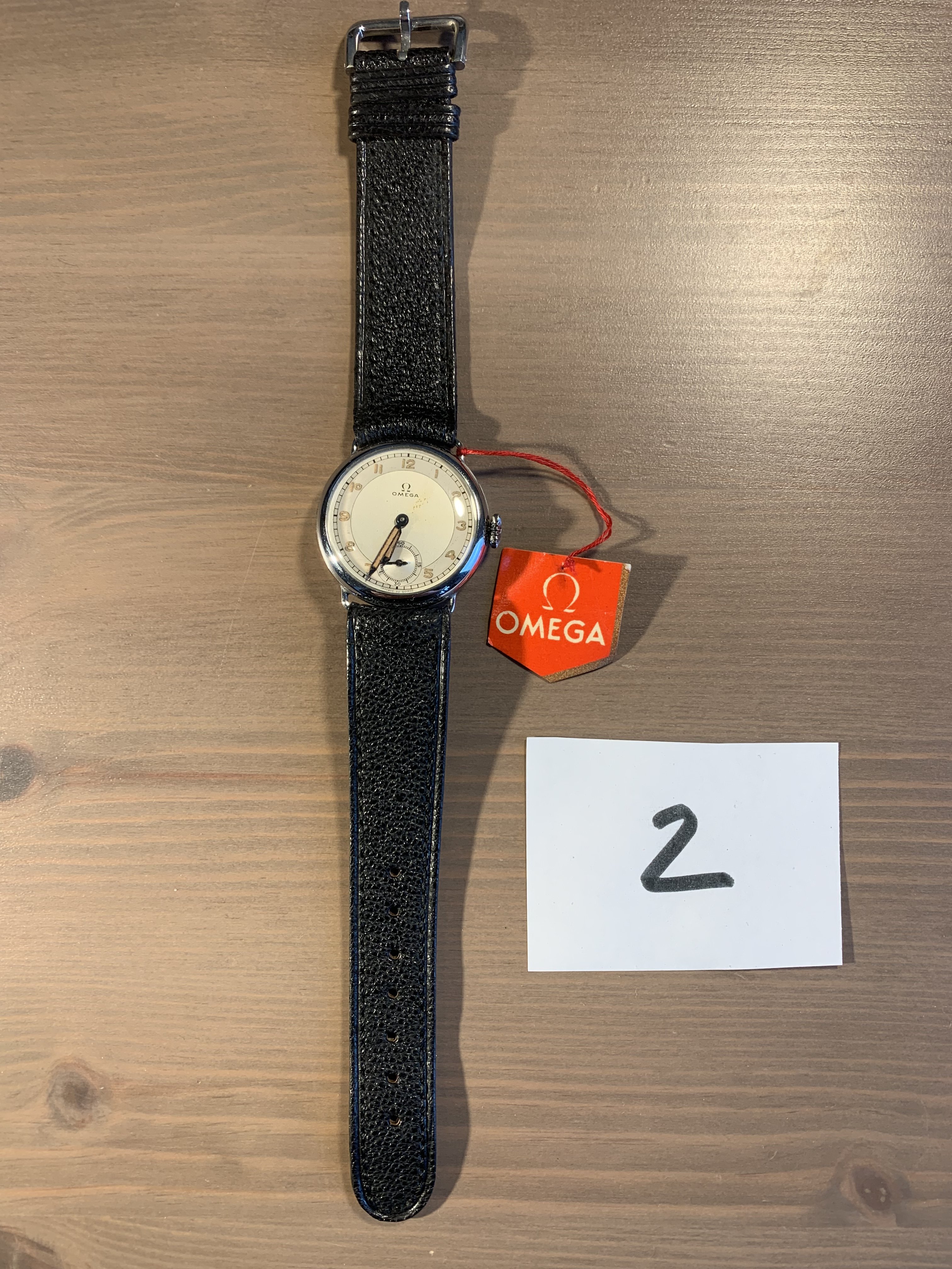

Hi,
Three superb examples, congratulations for this find!

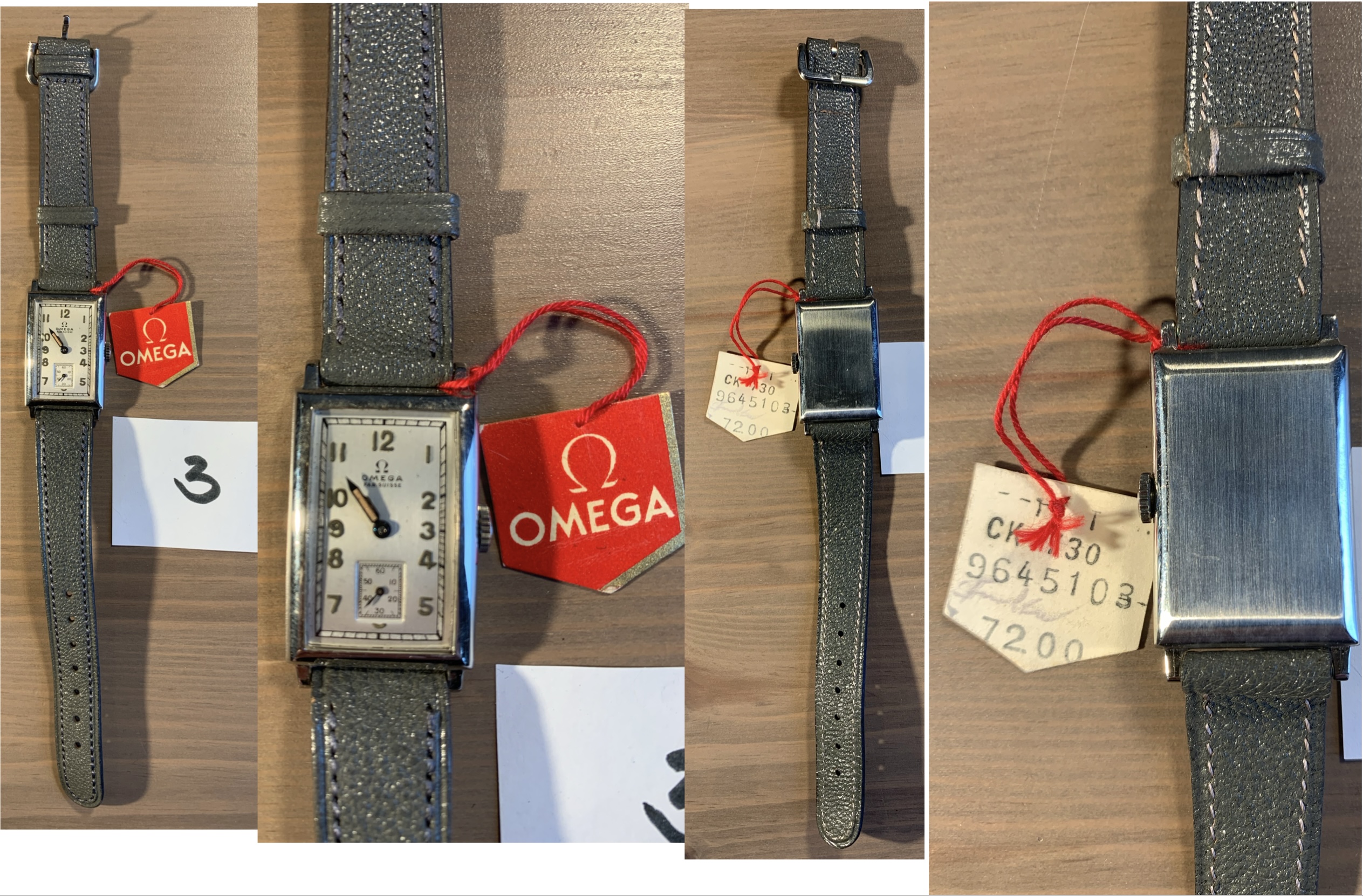

A lot is already said on the original tags :

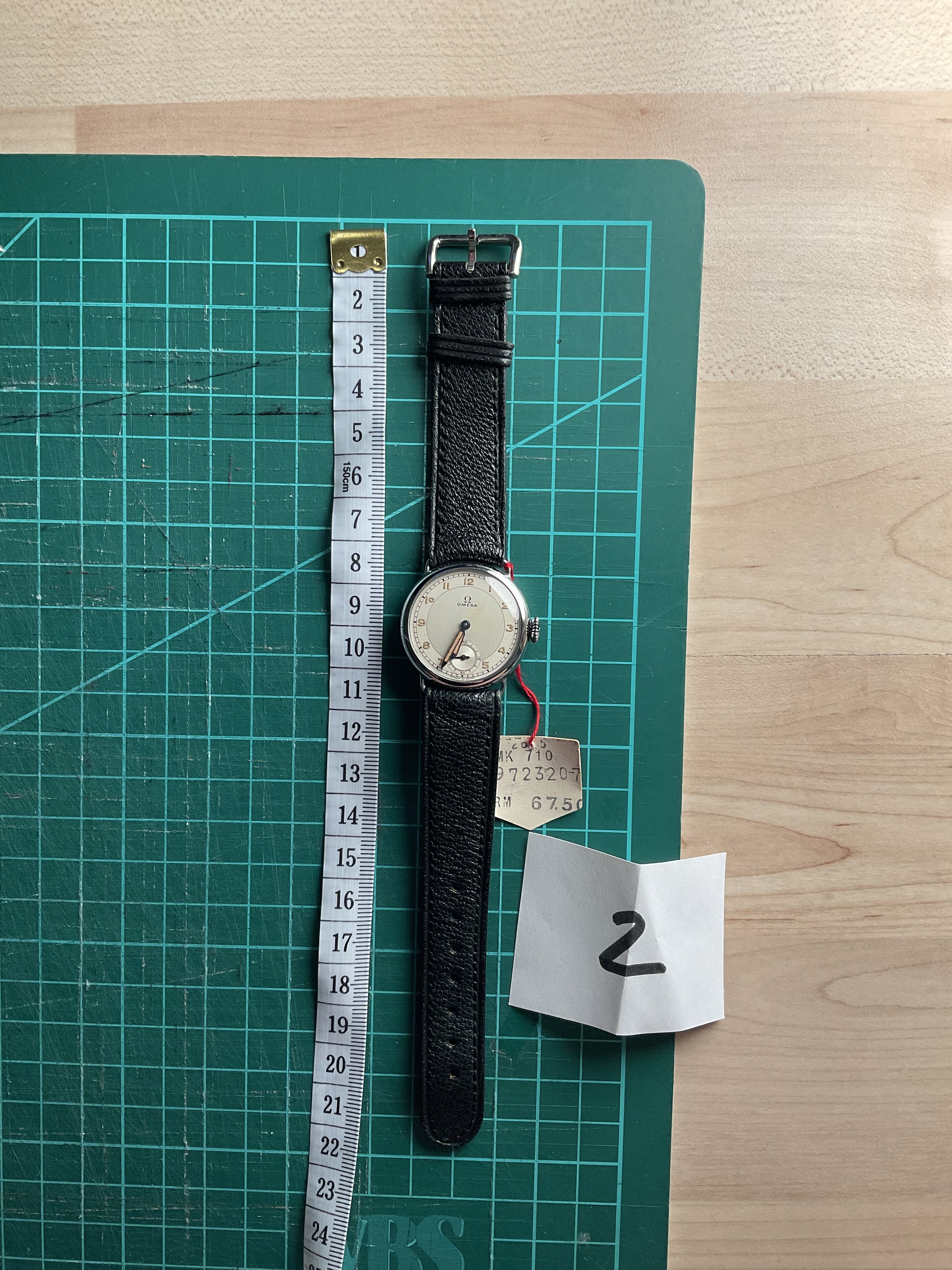

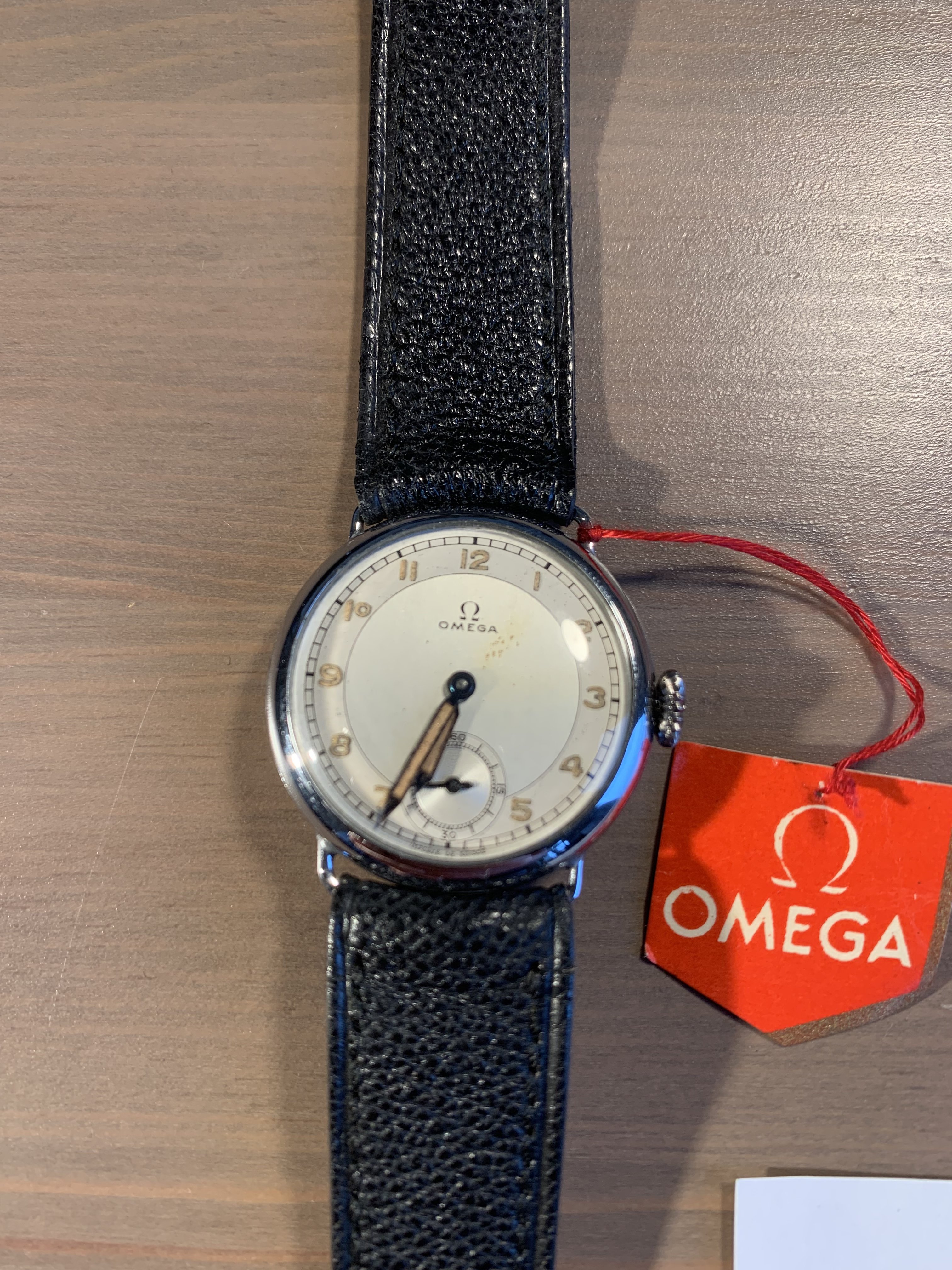

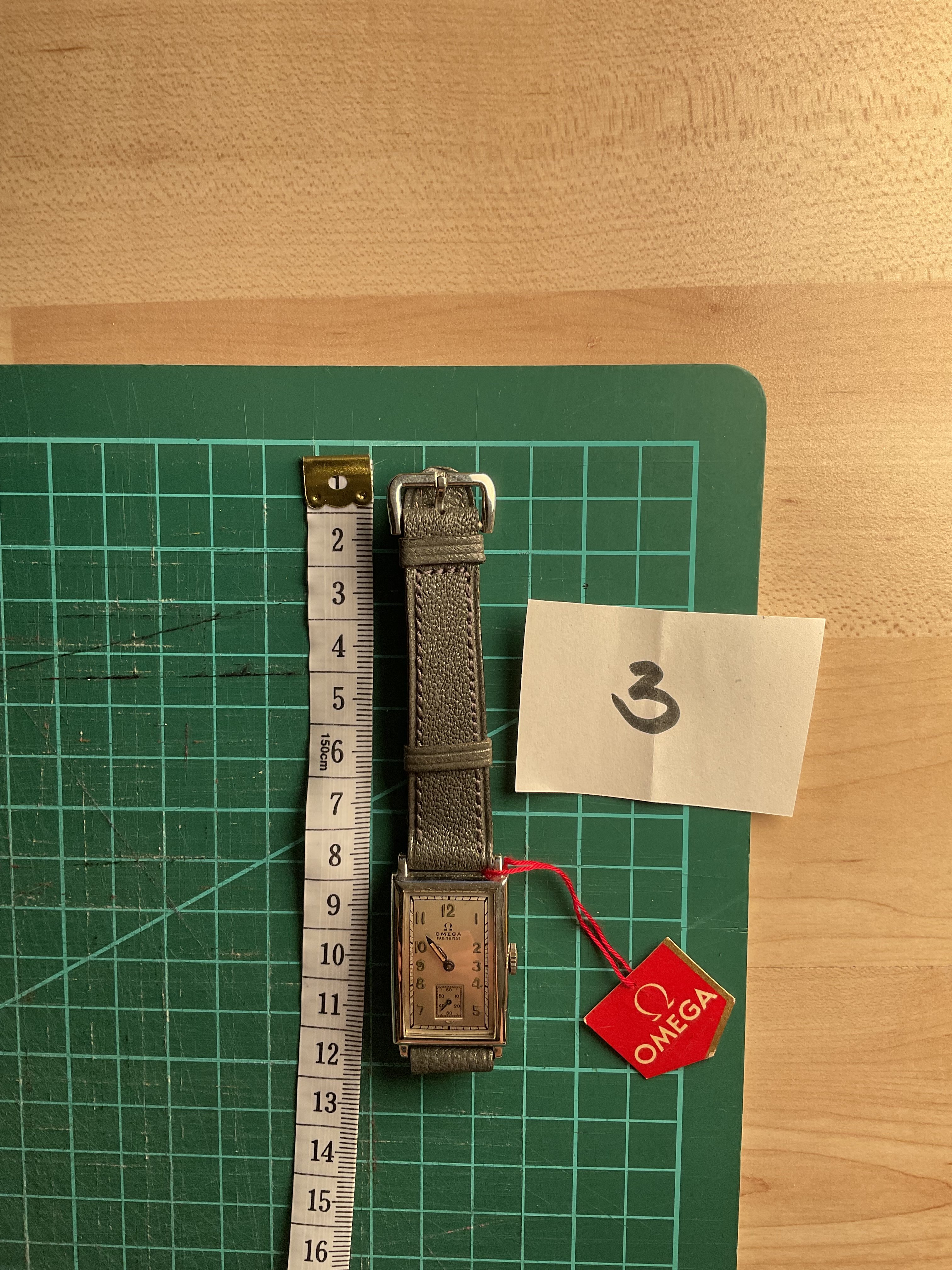

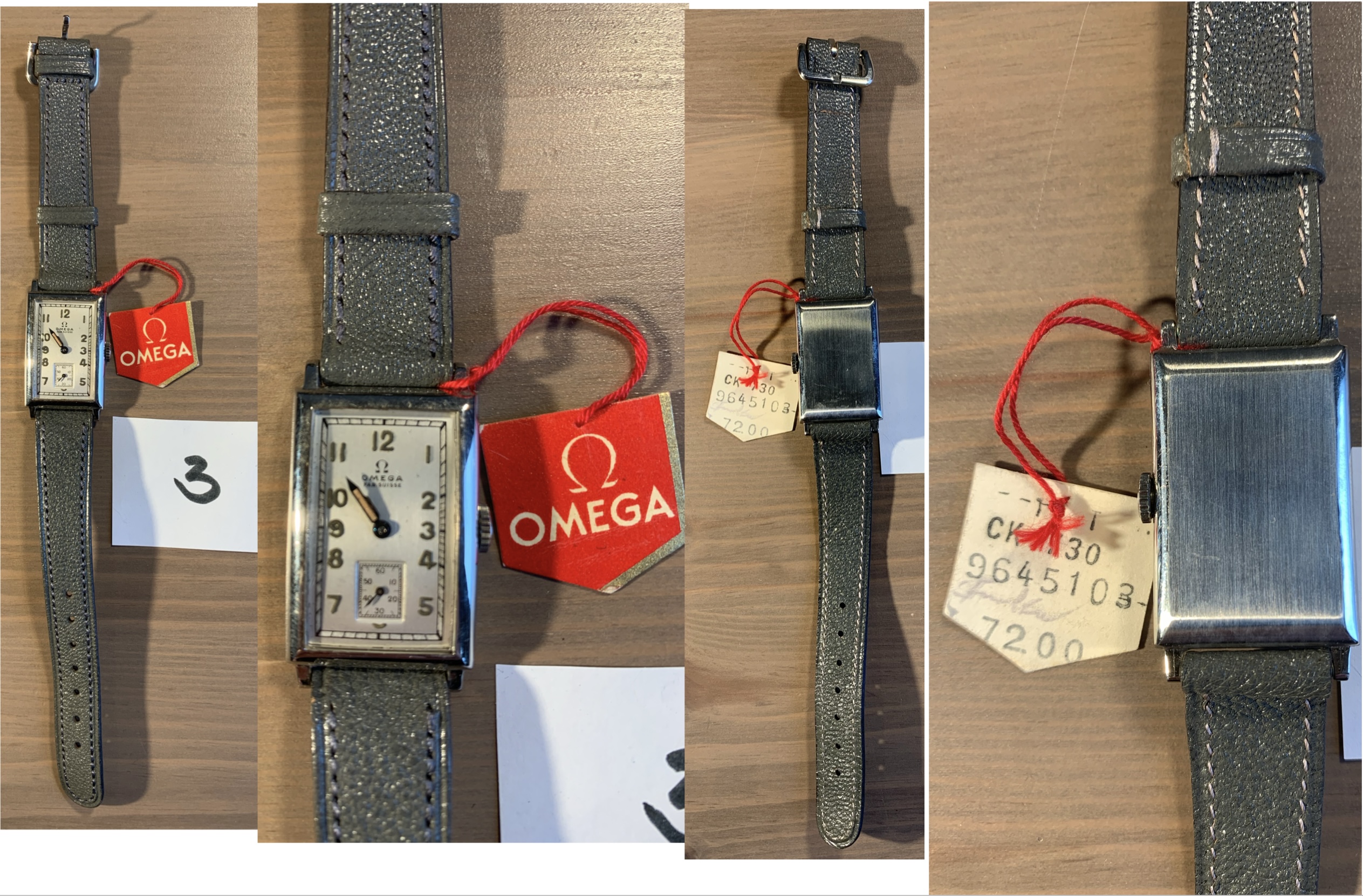

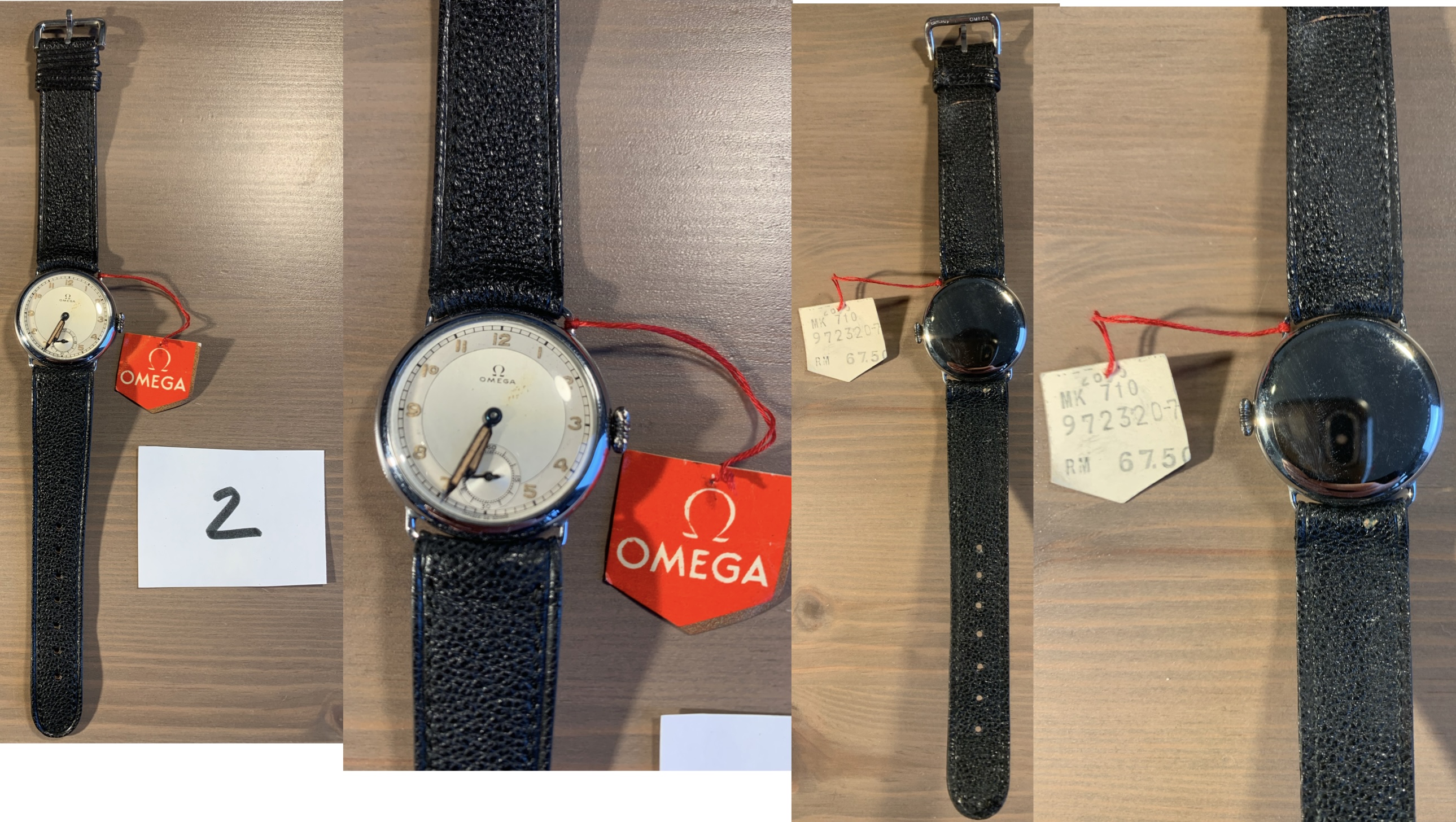

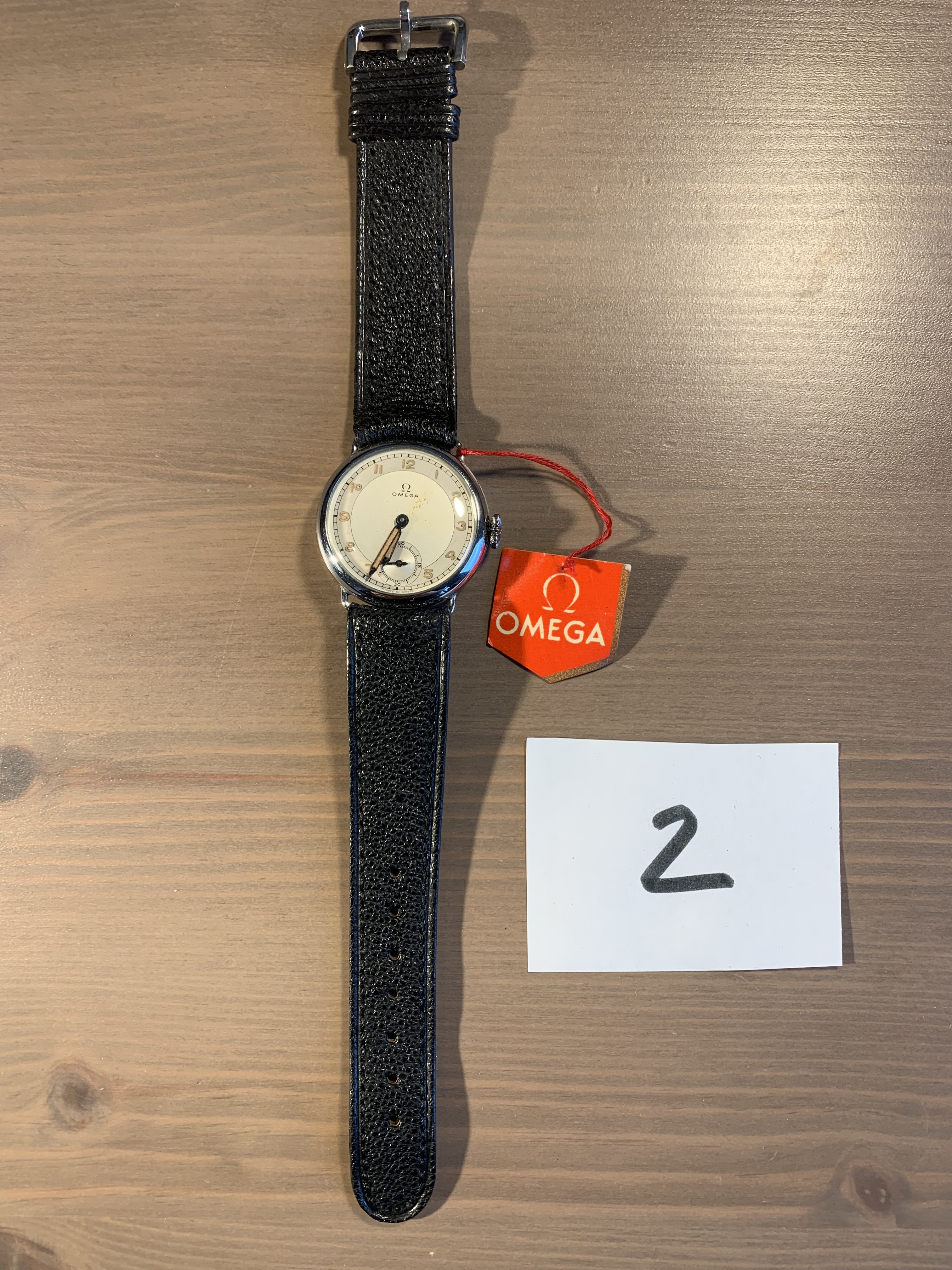

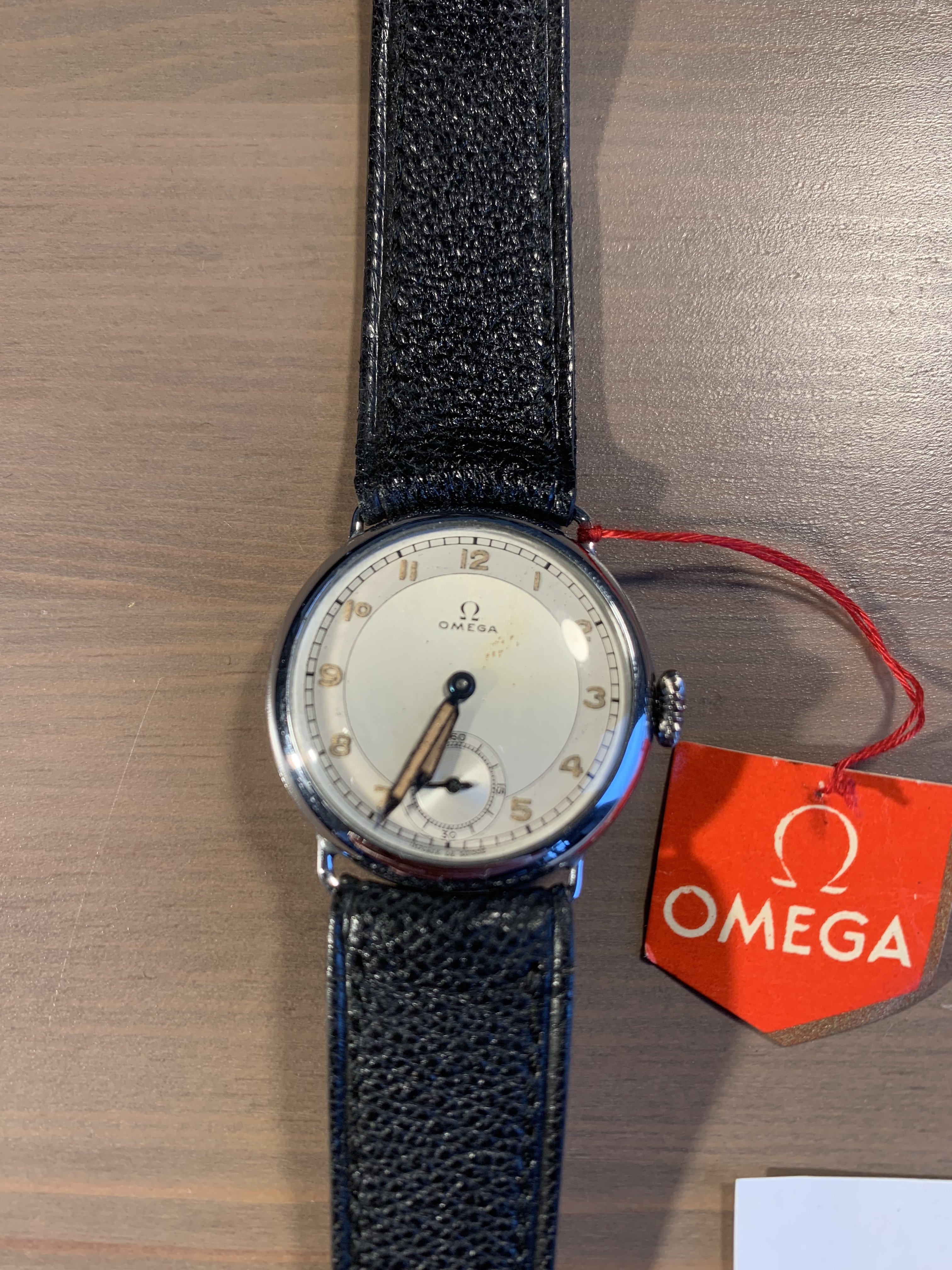

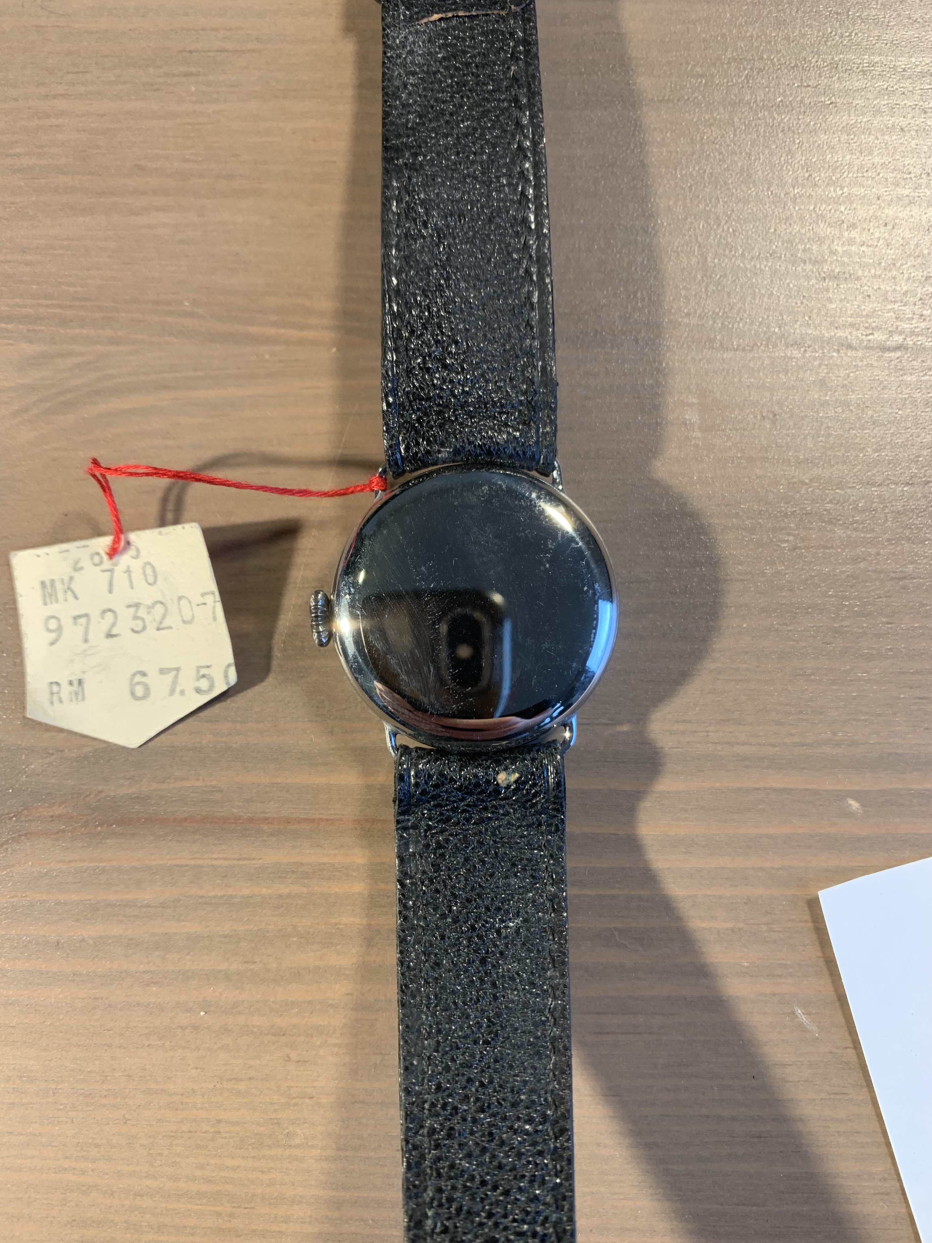

n°2 is a ref MK 710, with 26.5 SOB inside. When Omega launched the 26.5 SOB caliber, they issued two models, this one and the ref 800.
Here is ref 710 in a 1926 German catalog :
and one of mine from around 1927 says hello :
and another one of mine, from around 1933, with a nice (but damaged) modern radium dial :
Both of mine have incorrect crown. Very interesting to see yours as we have an example of how it should look.

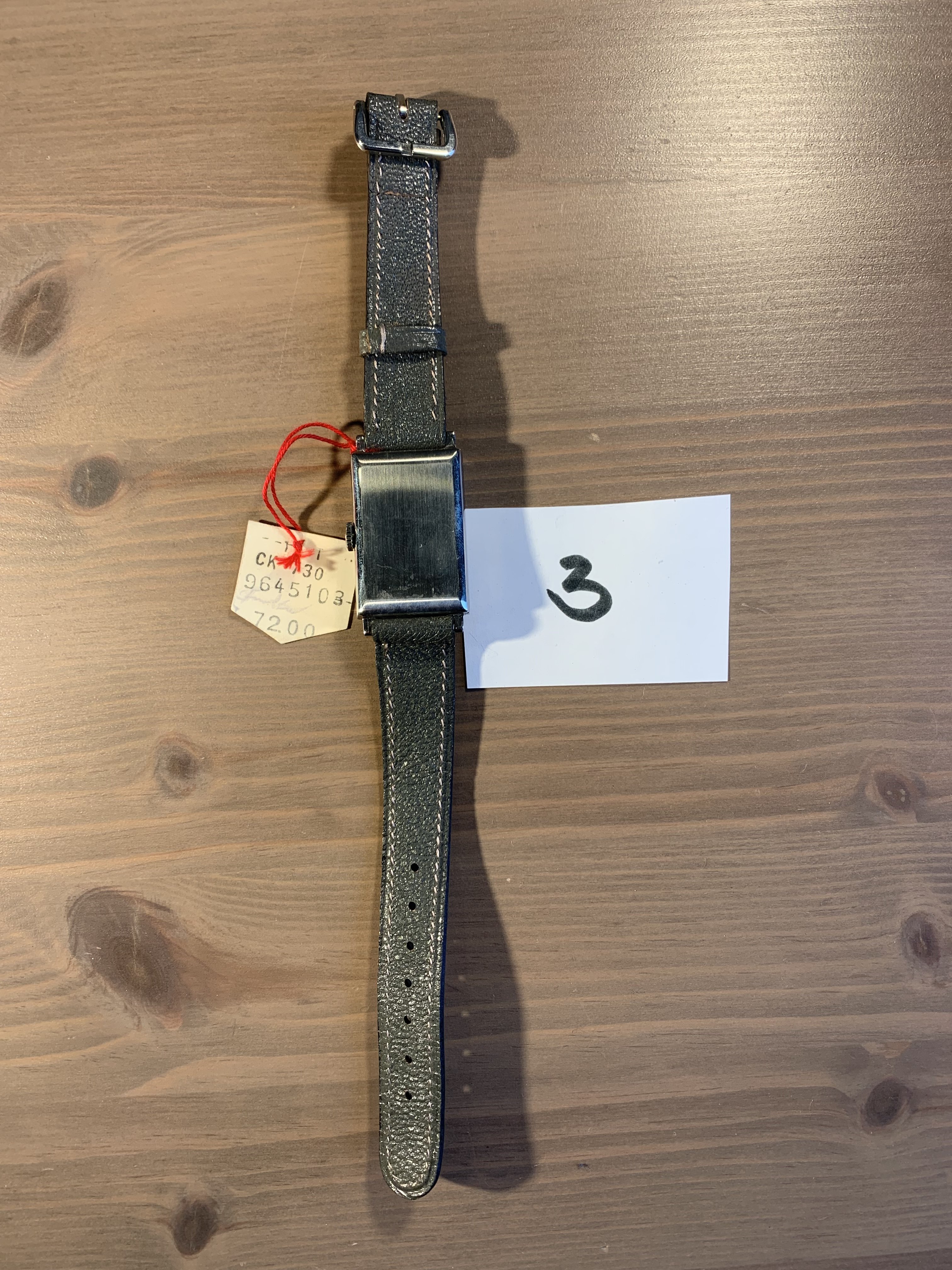

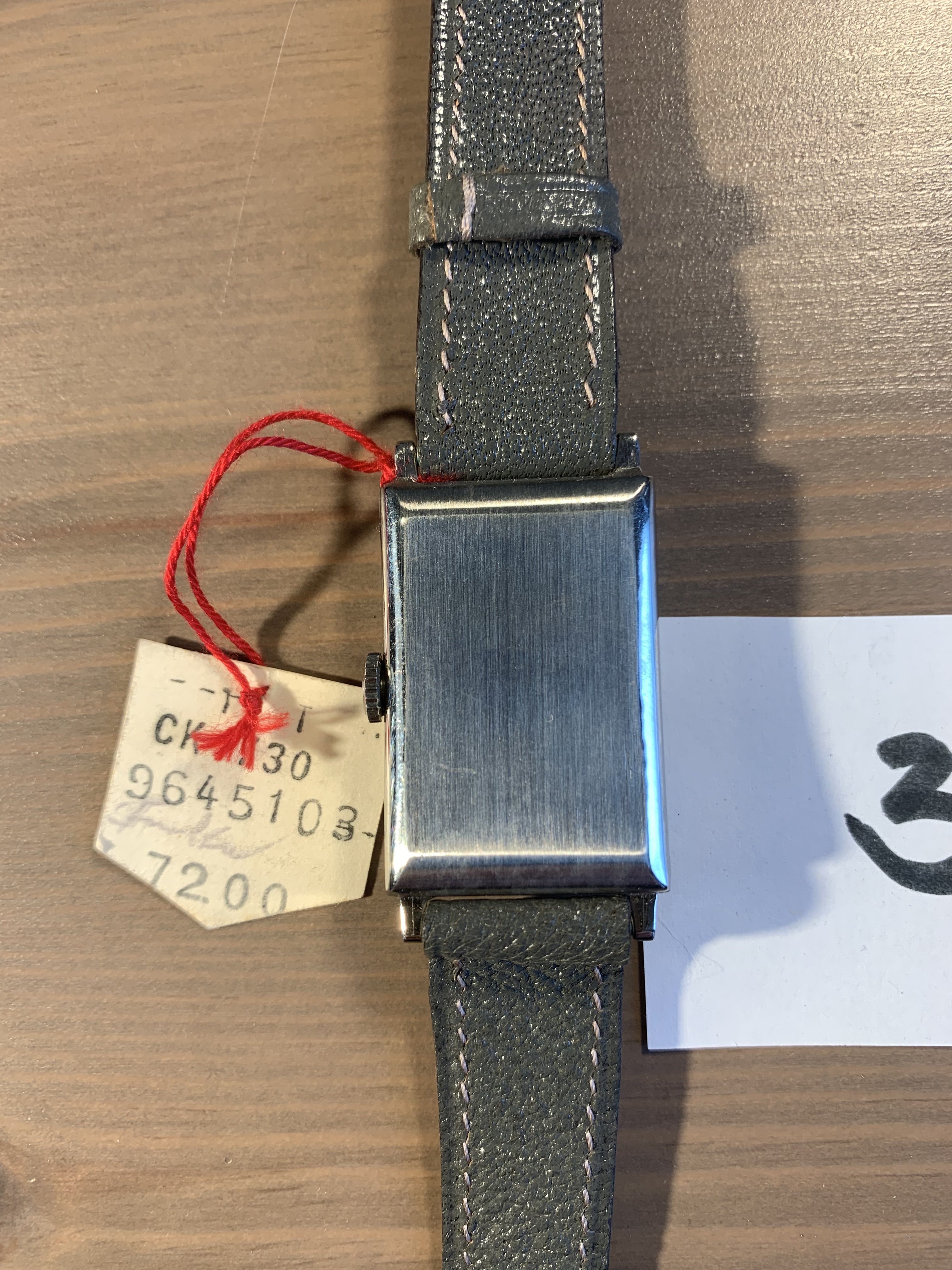

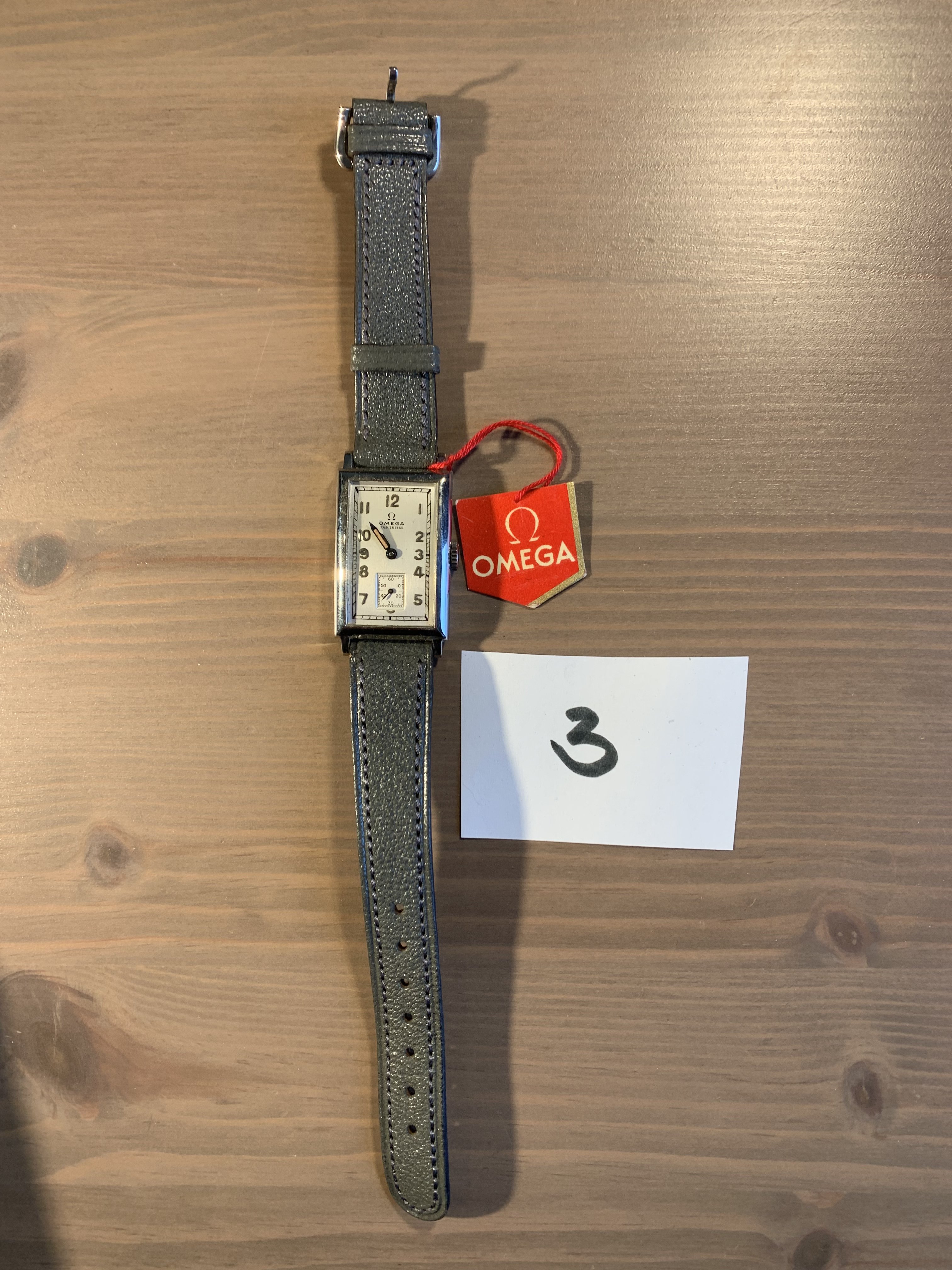

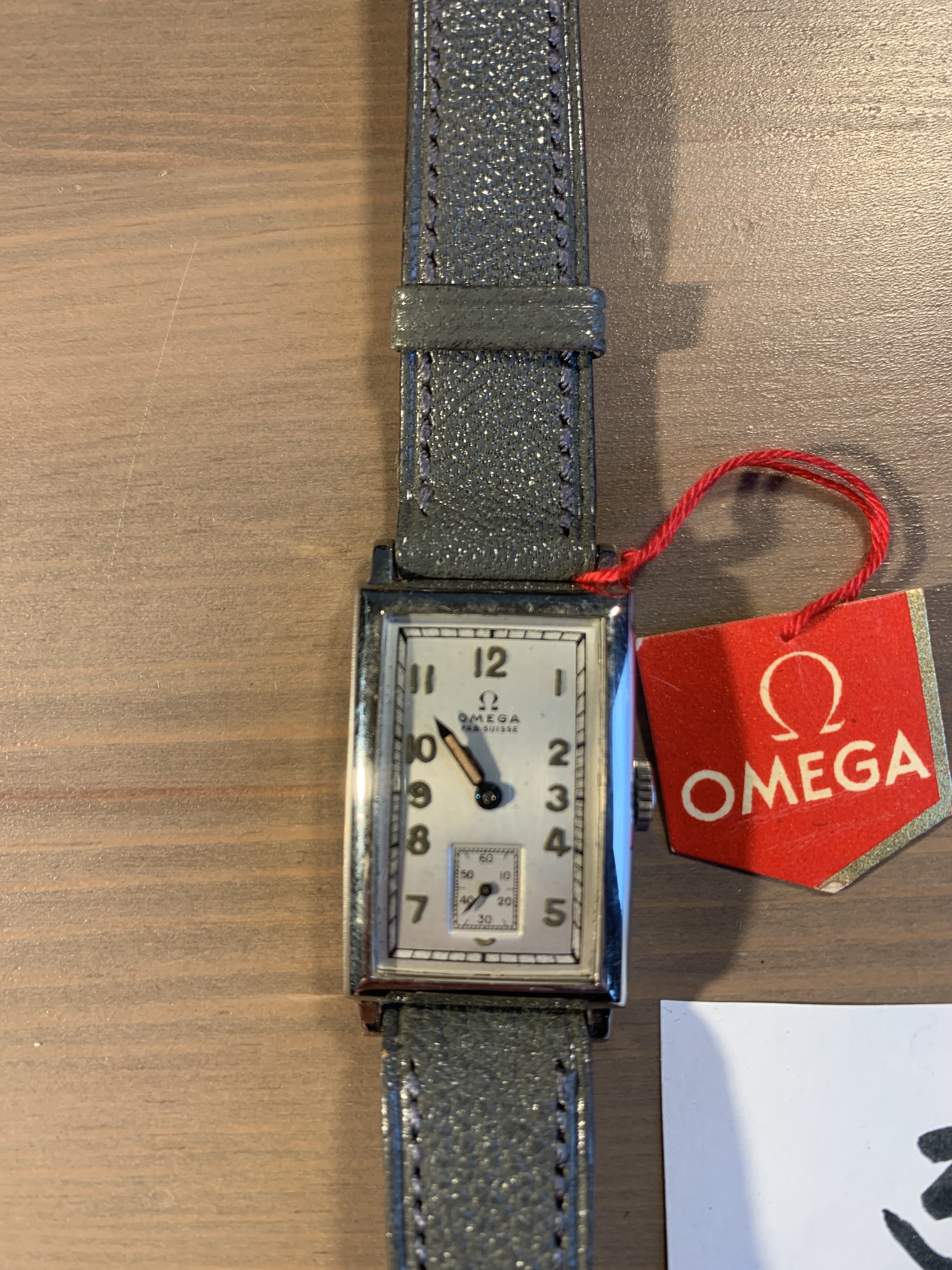

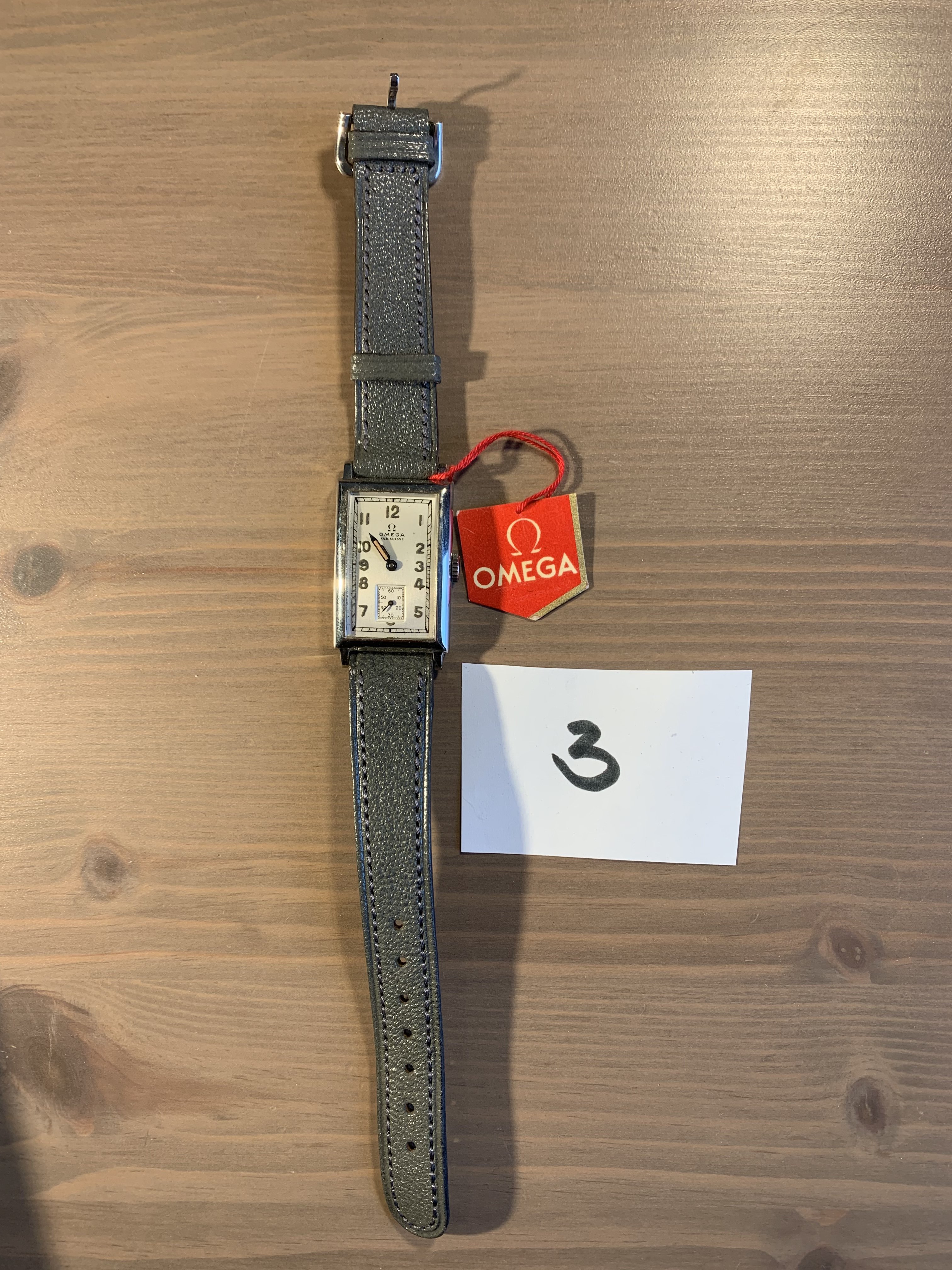

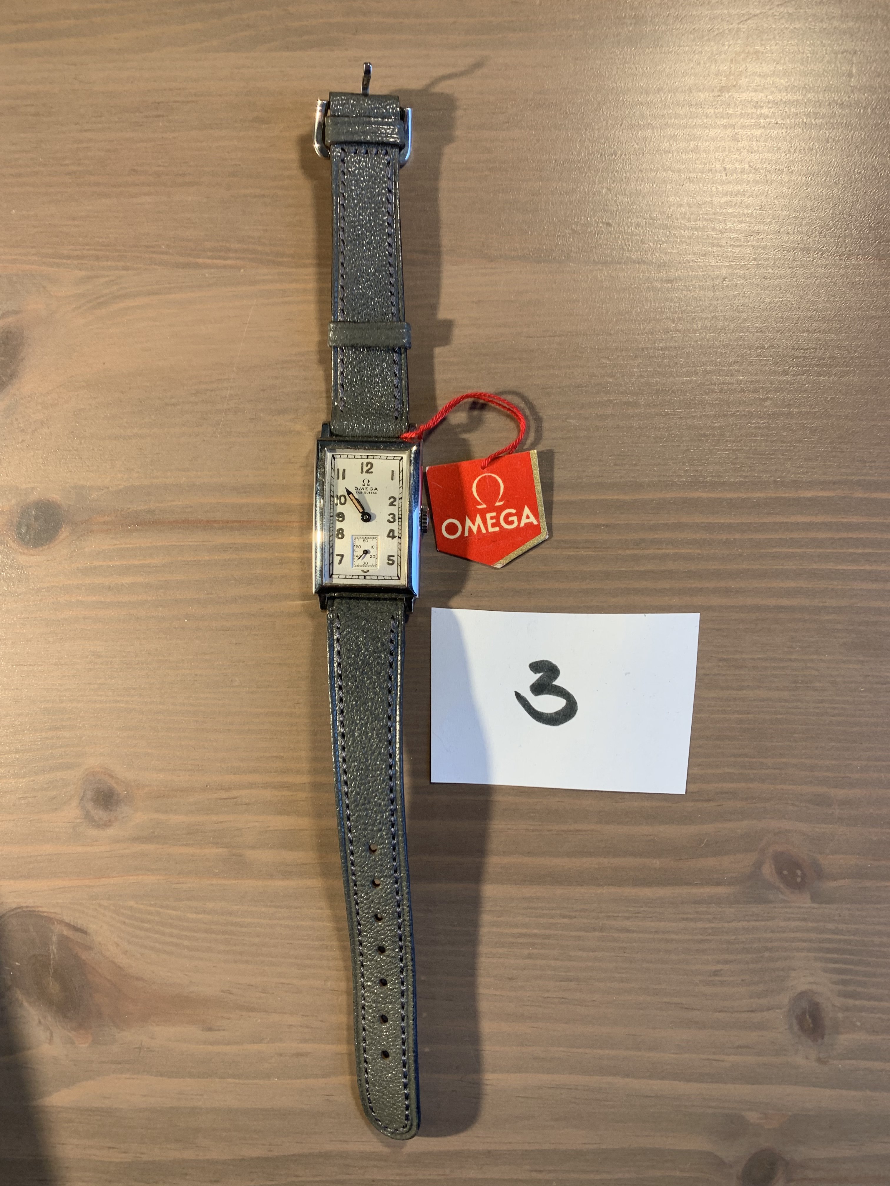

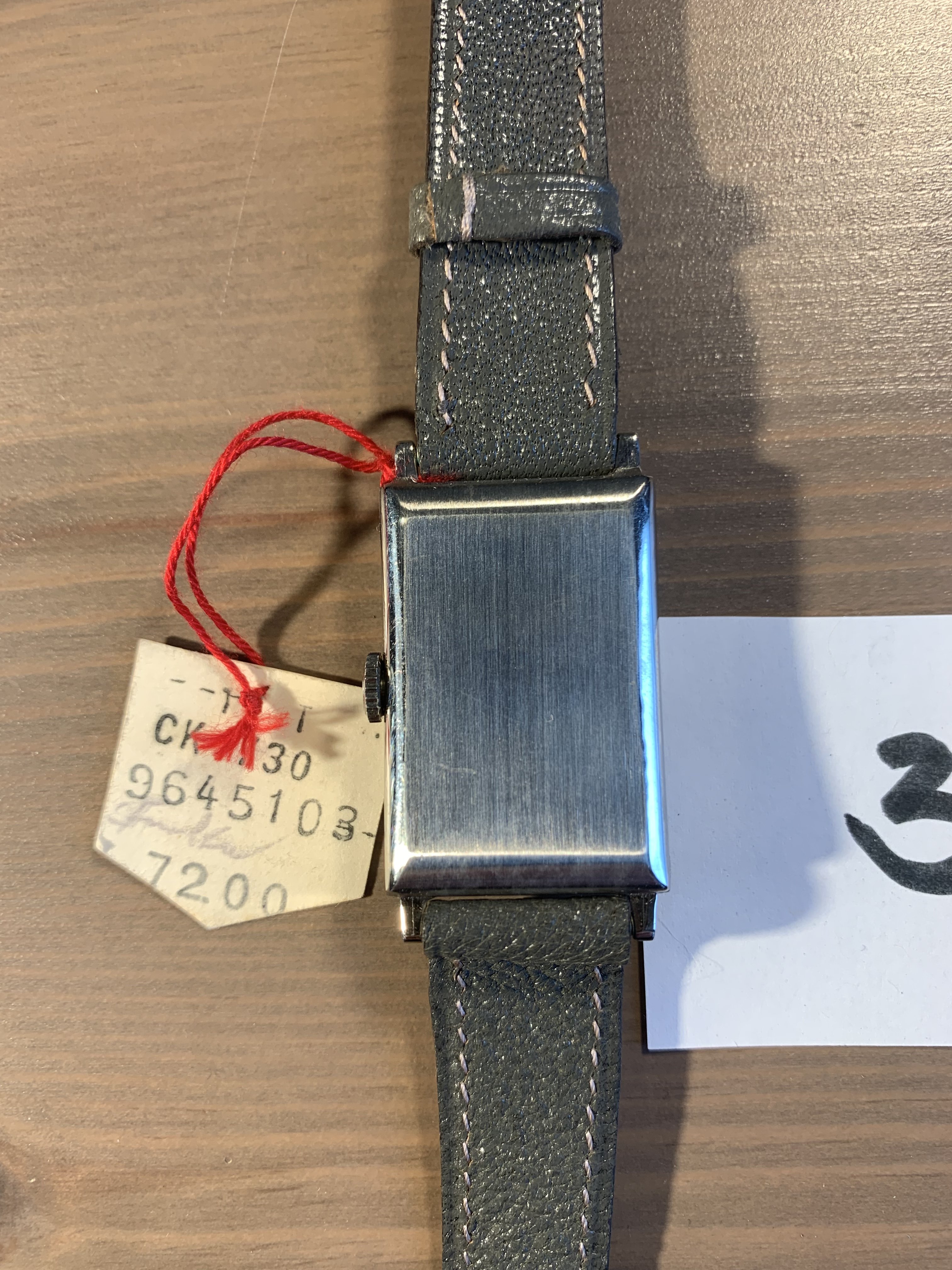

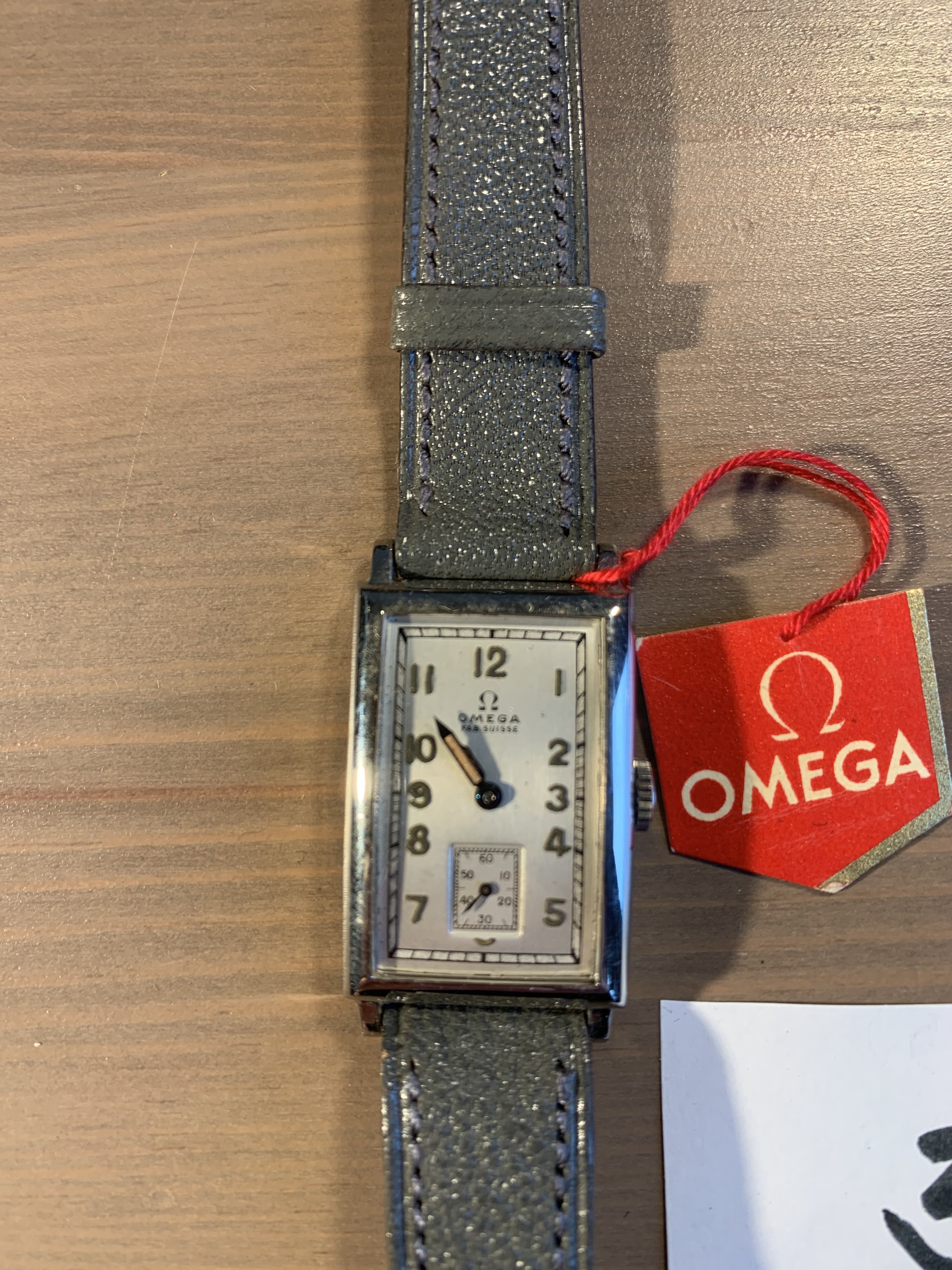

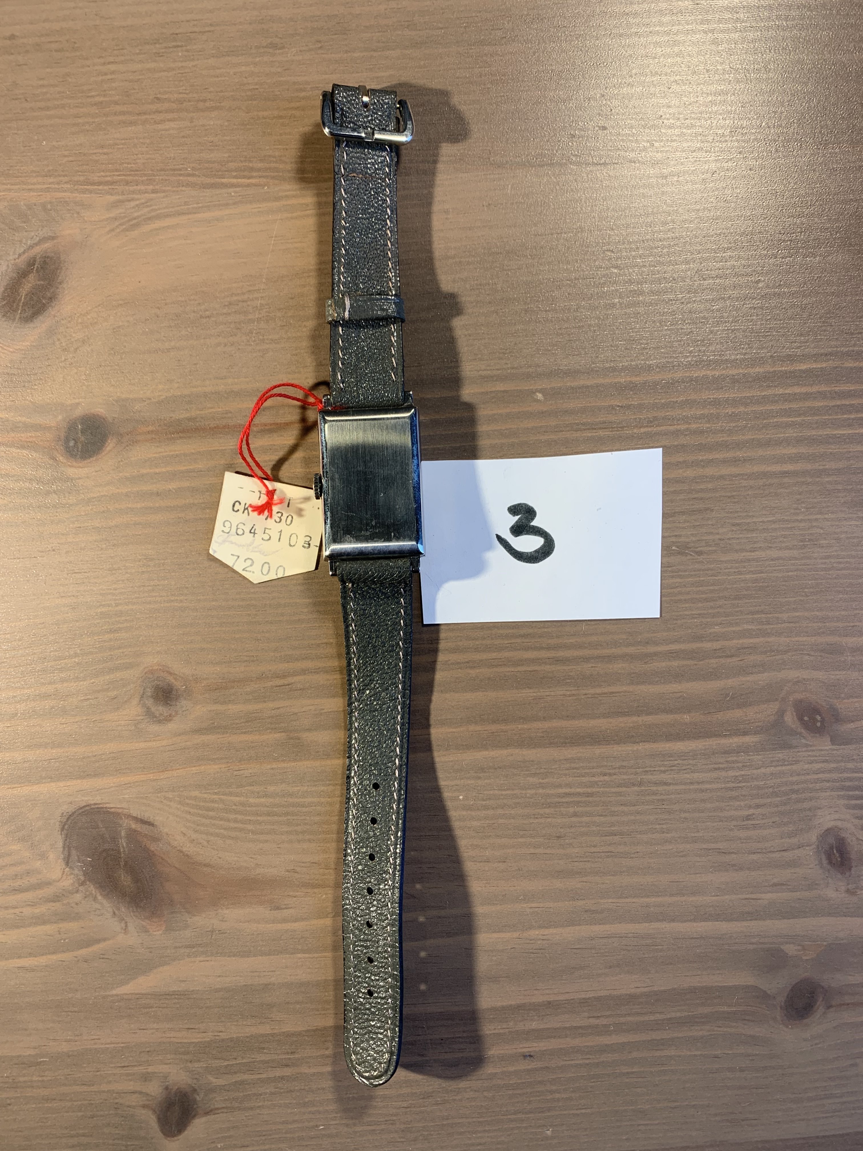

N°3 is a ref CK 730. This model was produced with caliber 20F (again issued when they launched the 20F in the 1930 collection) and later with caliber T17. The tag doesn't say what is inside yours.
Here a ref 730 with 20F inside, in the novelties chapter of a 1930 French catalog
And here, CK730 in a 1935 catalog for the launch of the T17 (note it has a very specific dial with omega logo and name on top of the dial. This was only on early CK730.17, and was replaced by two variations, one named 'carré' and the other 'rectangle') :

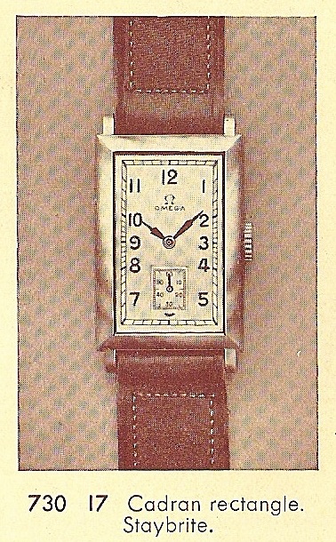

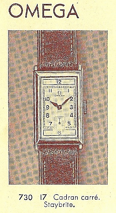

Here are the 'carré' (square in French) and the 'rectangle' in a 1938 French catalog :
and finally one of mine (CK 730.17 'rectangle' dial from around 1936) says hello :
