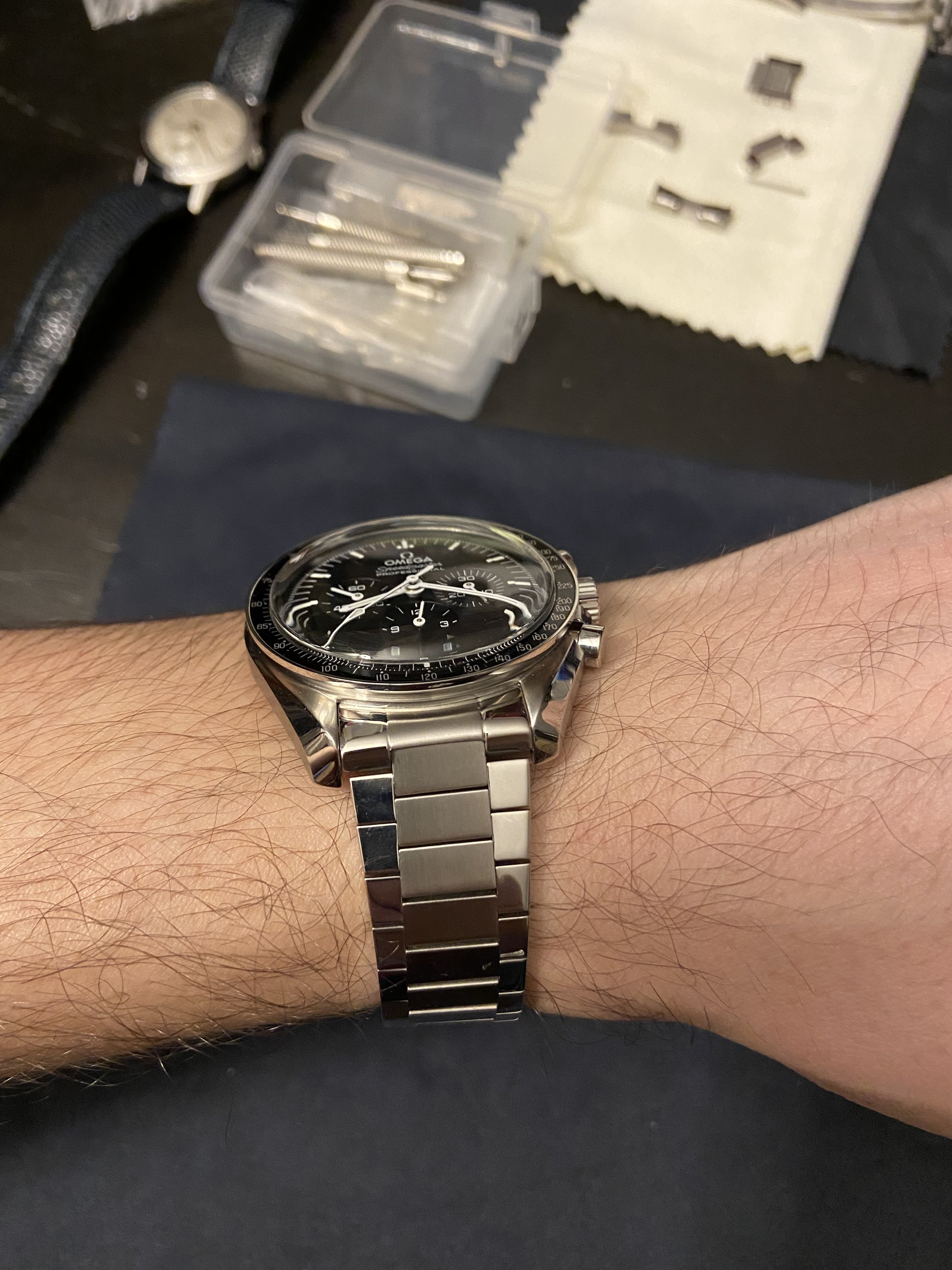

After spending a rather unpleasant hour trying to get this bracelet onto my 3861, and some rather unfortunate & frustrating scratches on the inner lugs (fortunately kept the carnage to only one side once it became apparent that the endlinks weren't lining up with the lug holes), the Uncle is either full of shit or I got two poorly manufactured endlinks.
Charmed life or at least some modicum of basic skill -- have never scratched a lug until today with many bracelet & strap changes.
Moderately pissed off, not so much at the scratches (even though that's some rookie shit that annoys me even though I tried my best to avoid it -- however it was inevitable while placing the endlink into the lug with the springbar kicking out because of mis-alignment), but because I ordered everything correctly as per the Uncle Seiko website and really wanted this bracelet to fit.
Can anyone else report in about fitting this bracelet with the US approved (ie: Standard) endlinks to their 3861?

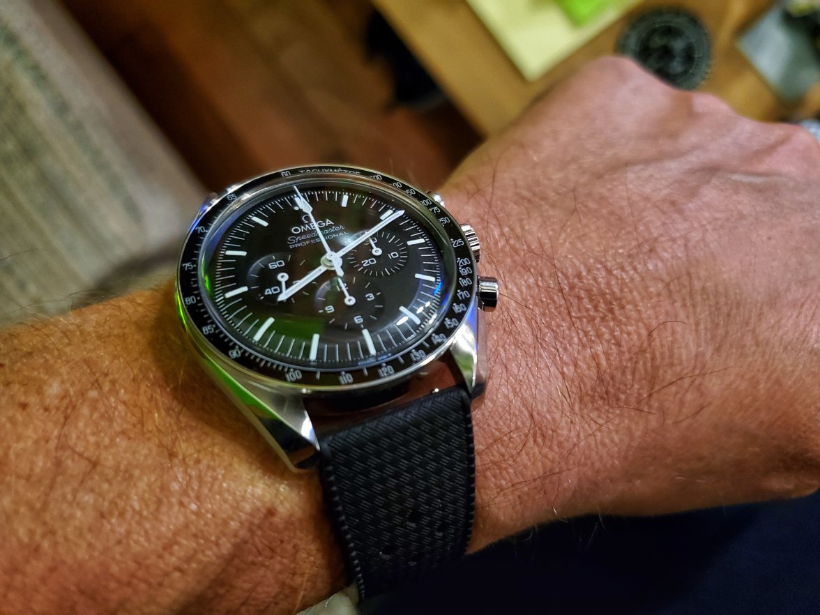

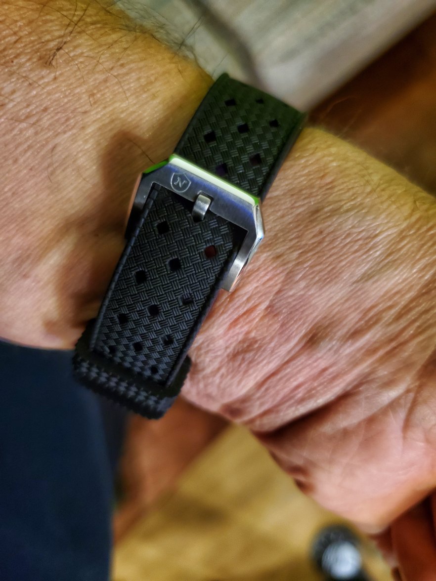

Another hour of bullshit, no - OEM bars are no bueno as is two other pairs of bars: Rawlexx and No Name Generics.
Kid wanted the PC for WoW (also my makeshift ghetto pretend watchmaker cave) so I quickly tried a still unopened Forstner Komfit w/horned ends (wow, what kind of monkey can operate that shit with a single hand? Maybe the day I'm having but I gave that 10 minutes of trying to put it on and take it off my wrist before I felt like my brain was going to explode and then removed it) and threw the Nivada Grenchen Chronomaster tropical on (QR bars so I could stop getting side-eyed from The Daughter) which is too much black even for my scorched heart on this watch -- I'm putting the OEM bracelet back on tonight once everyone goes to bed and I have some space to cry over the wasted day, the wasted coin on the US flat link, the wasted optimism and my freshly procured lug scratches.

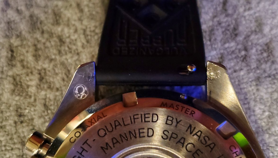

Look at that horseshit in that last photo... it's like a WUS "For Sale" ad for a Timex that never stood a chance against some ham-fisted rookie with a shitty flat edge screwdriver.
Heartbreaking.

PS→ The Komfit looks and feels amazing old skool cool but I'll be damned if I am messing with that once per day when I pull the Moonwatch off to wind it.
Them astronaut bois musta had better digit skillz than me -- or NASA had techs by their side 24/7 for removing and reattaching that bracelet.

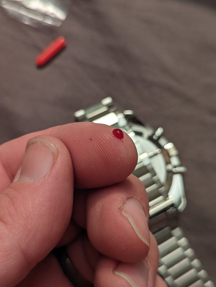

If it makes you feel any better, a jammed forstner bracelet screw led to a nice little puncture wound tonight:
This watch nonsense is not for the faint of heart. And, don't even get me started on my brand new Seiko Prospex bracelet that I can't use because the unfathomably small collar flew out of my tweezers. If you're going to use a pin and collar system, the least you could do is include a spare in the kit. The thing was as tiny as the teeth on an accutron index wheel.
