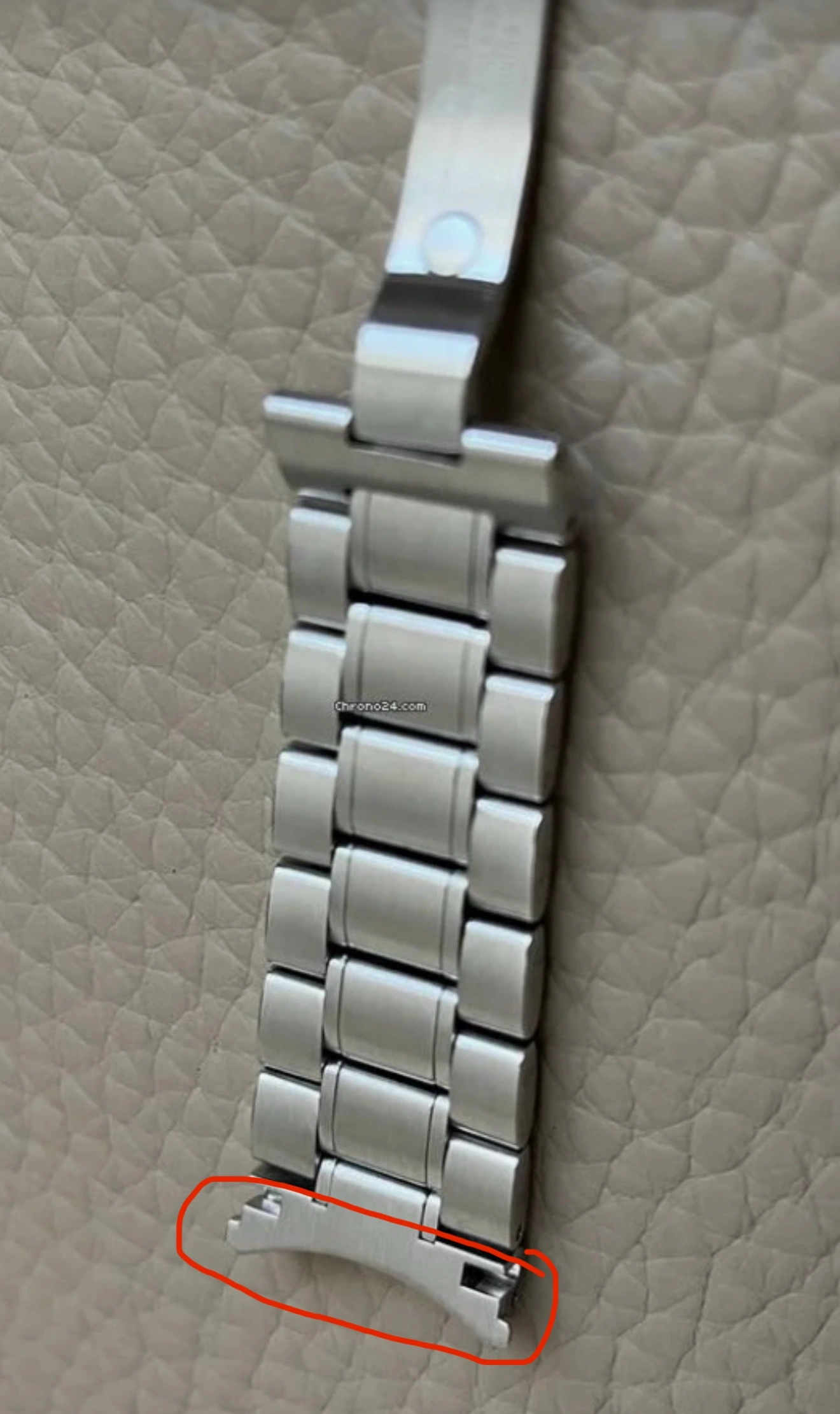

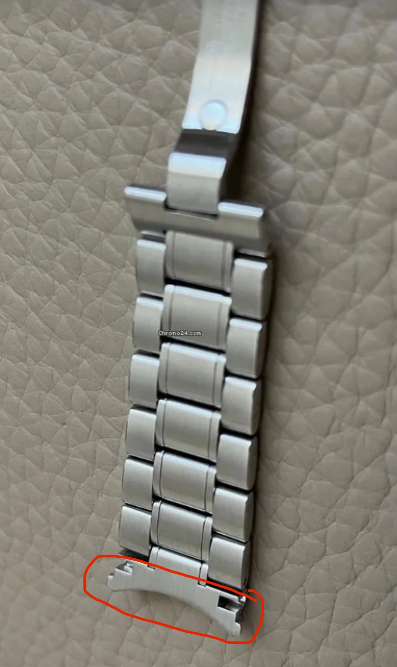

This is the bracelet I’m looking to get, but it seems to have to protruding lugs just above the bar spring notch?
Will it still fit?
Pic attached…..
6,458
31,809
Yes those are just for hugging the lugs at the bottom;
83
51
The 1861 bracelet will fit your 3861 Speedmaster Moonwatch. You will need shorter spring bars, but that's it. You'll probably need to get new ones as they are not the same size.
