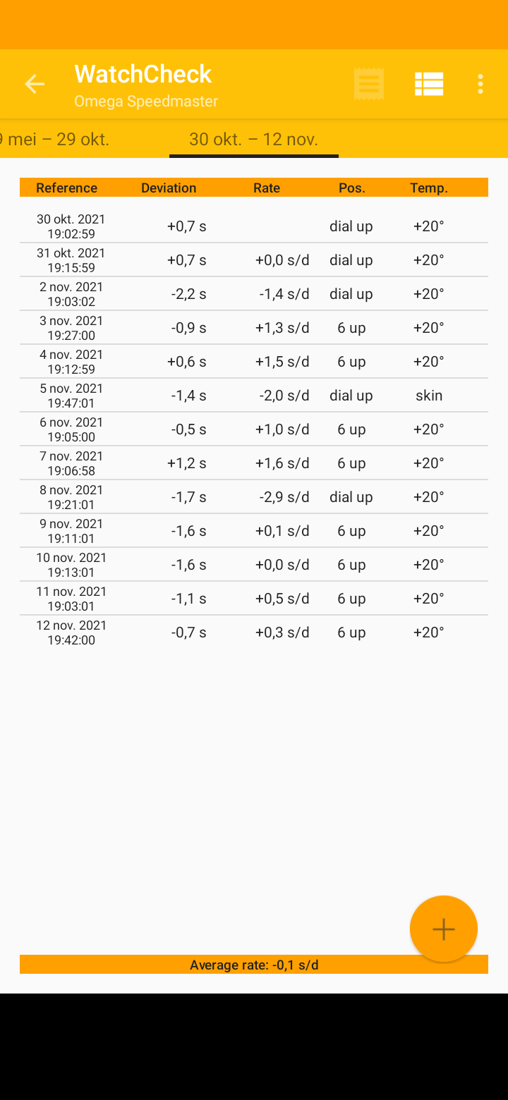

I'm doing fine with the A11 50SS:
How do you keep your watch in the “6 up” position? Do you mount the watch head in a clamp?
When do you actually wear the watch?
No, just upright in the box with the pillow as backing, it didn't get in this week's rotation so Nov 5th was when it was worn last.
17
17
Ah, that never occurred to me but so obvious now that you mention it. Thanks for inspiring my next round of watch timing measurements!
