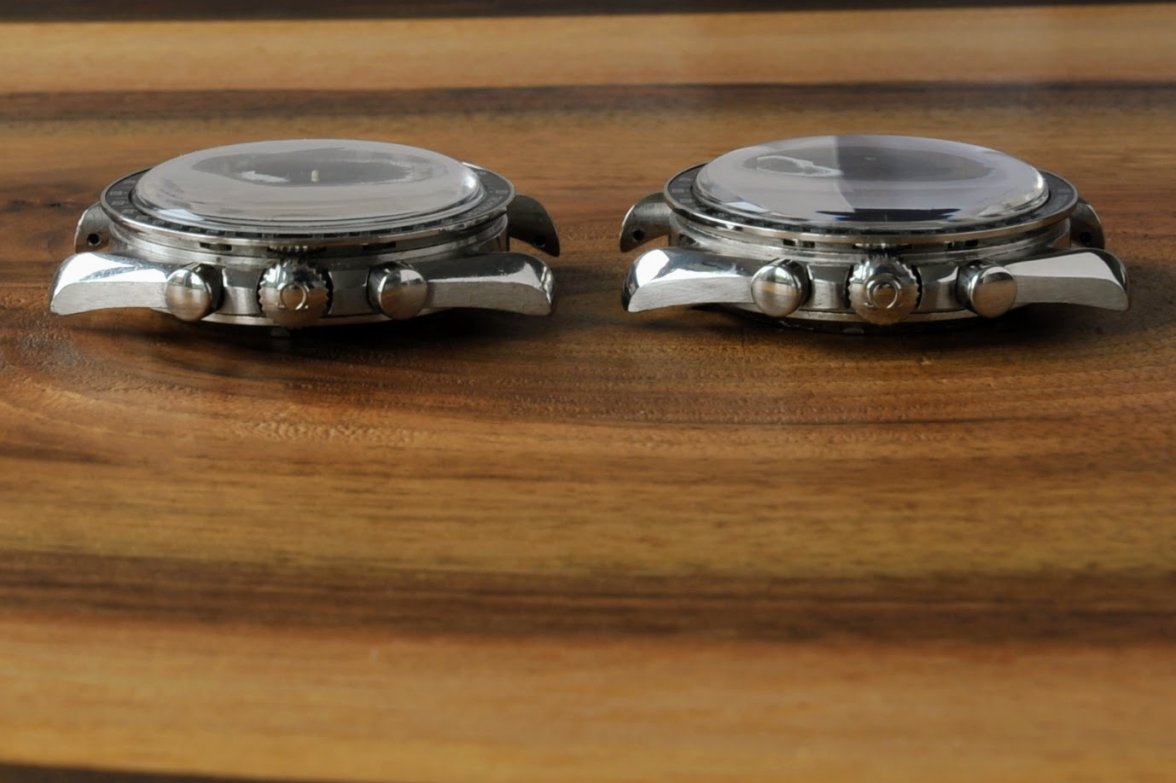

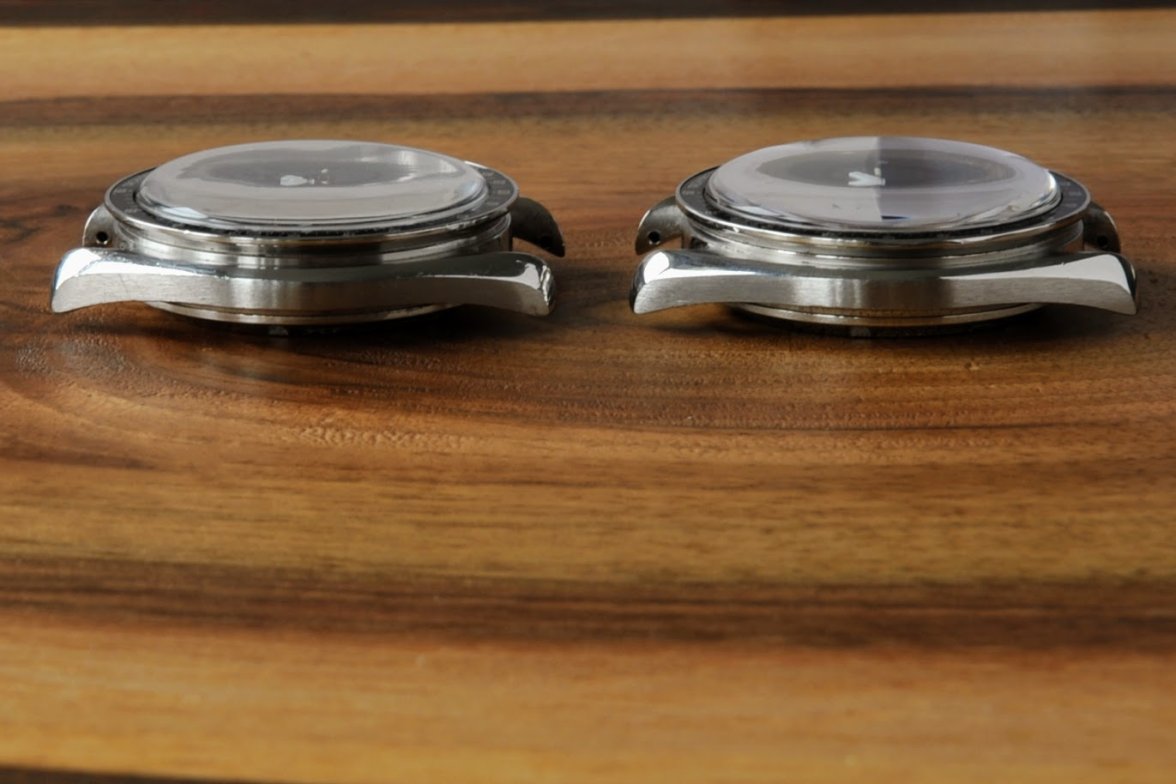

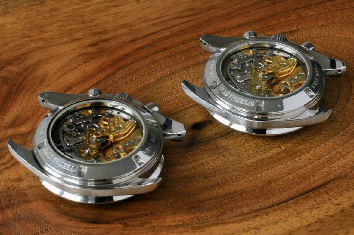

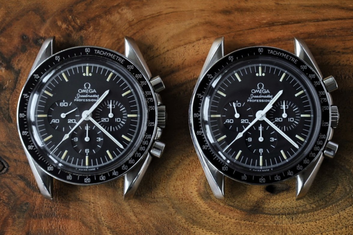

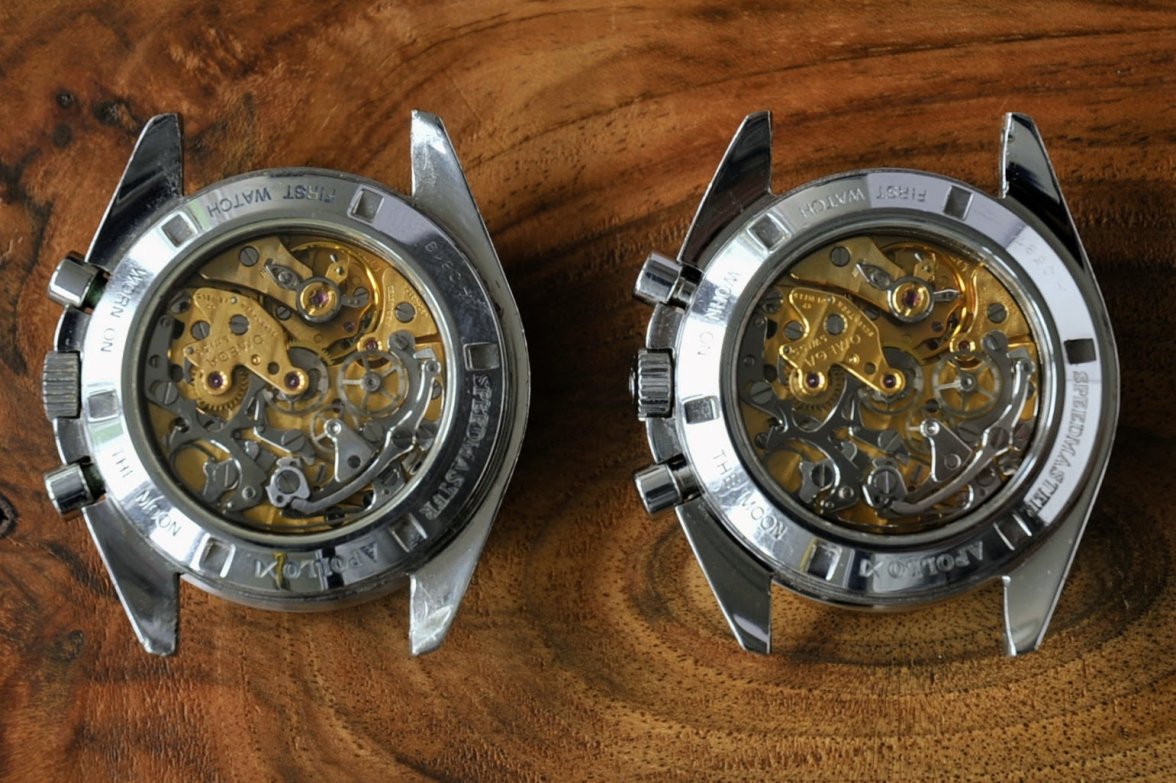

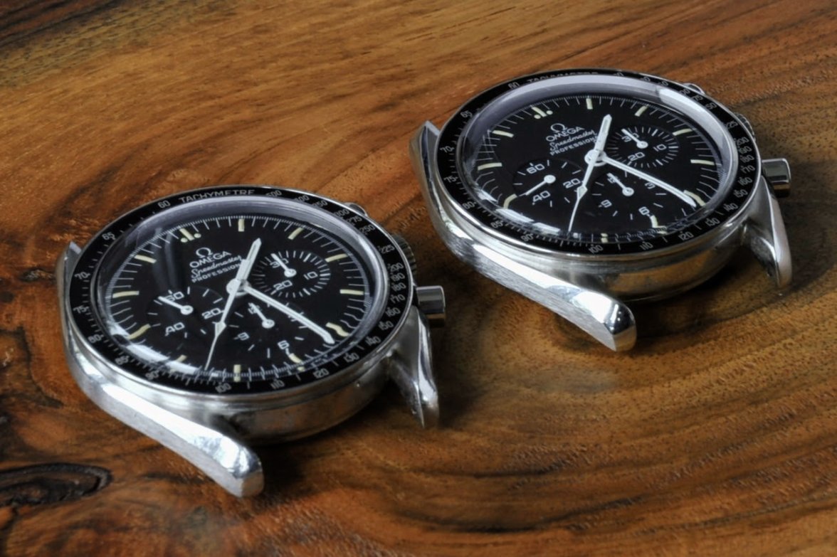

It is some time since i last contributed to the forum, but the recent acquisition of a watch is a good reason to write, today.

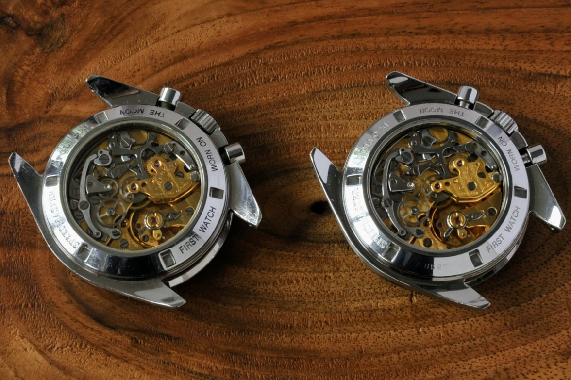

Many years ago i bought a 345.0808 numbered, second generation, with the gold plated Cal. 863. Some days ago i had the possibility to get another one and i did.
To me, this version is one of the Speedmaster highlights from the 1980s. Not just because of the beautifully finished movement, the relative rarity of just 1000 pieces and the 1450 bracelet, which is the correct one for this execution.
Some pictures (head only, but i do have the 1450 bracelets needed 😀). On the left the one i bought many years ago, on the right the recent one:

Possible, but i do not know the number of pieces of the "Unnumbered Edition". Let's break it down:
- 1000 of the numbered and copper-colored 863 -> "first edition"
- 1000 of the numbered and yellow-plated 863 -> "second edition" (the two above watches are from this edition)
- an unknown quantity of the unnumbered and yellow-plated 863 -> "third edition"

Then my 345.0808 must be from the third edition, of which (I have read) there were 4,000 produced. How to distinguish which edition these watches came from?

The easiest way: Each edition features a different dial.

Thank you very much.
Well, it's not the only reference i do own more than one of. ;-)
The main reason i bought the second one was for a physical comparison of the two. I am very happy, the middle cases and casebacks show the same lines. As it often is the case, each one of these two watches does have its strengths and weaknesses. But i do not intend to swap parts between the two, as i do value the originality of each watch more.

Not sure at all it is 4000. (4000 is the production of the unnumbered 20th anniversary Apollo11, which is a totally different watch).
Unnumbered means exactly what it means. IMHO, impossible to give an exact number. Moonwatchonly book says the same thing.
Easy to describe:
First and 2nd edition= case back engraved with LE number. Second with a Axxx.
Third: no engraving
(And as mentioned also, different dials...)(And case engraved between lugs for the 1st)(And specific 863 for the 1st...)

The third edition of the 345.0808 is a totally different watch! Hmmmm! Here is the case back of my 345.0808.
