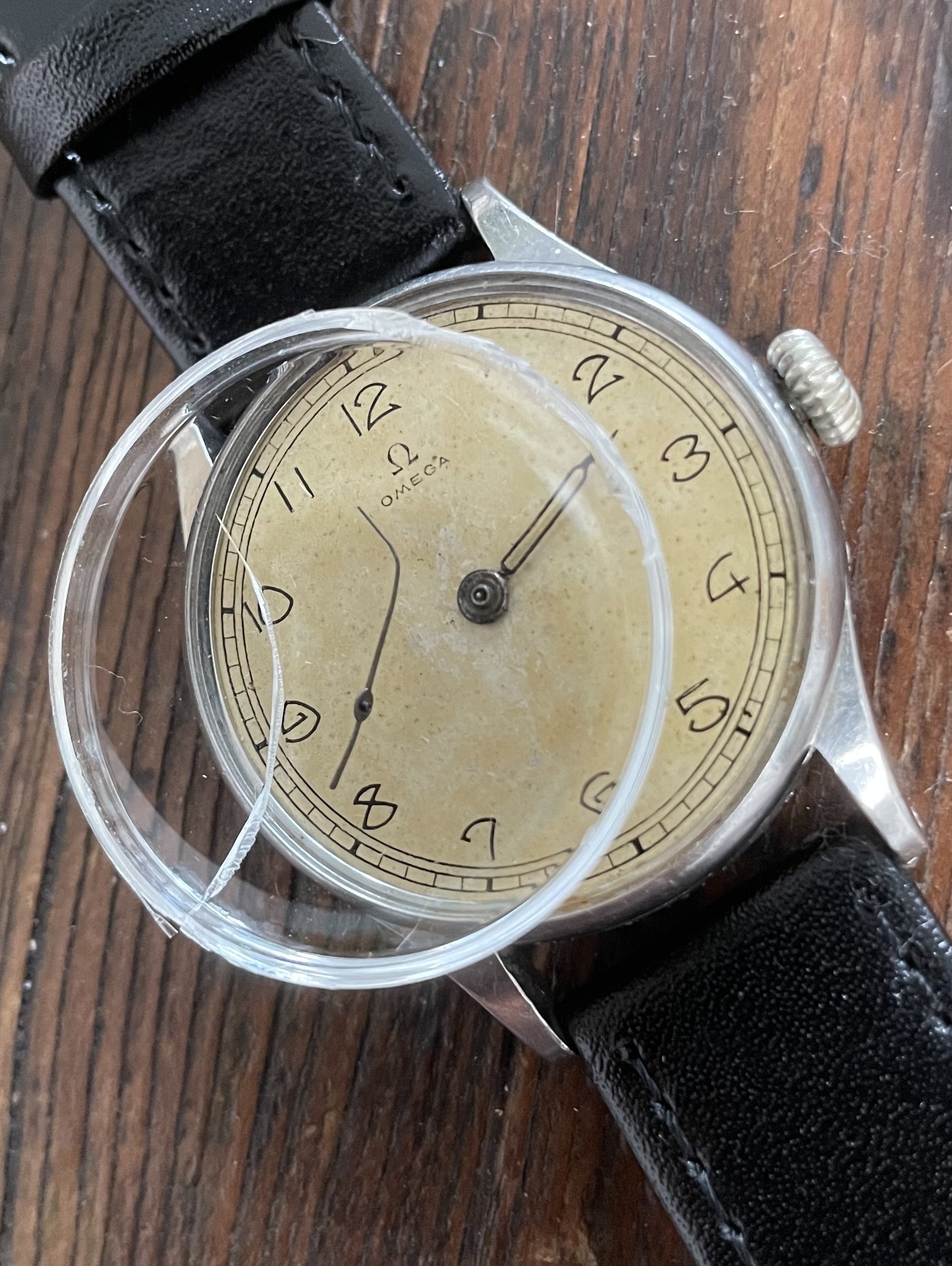

Can someone suggest a source for syringe hands to fit a 30T2 movt? I accidentally dropped my watch and wrecked the sweep & minute hand yesterday I’m so pissed off you have no idea..

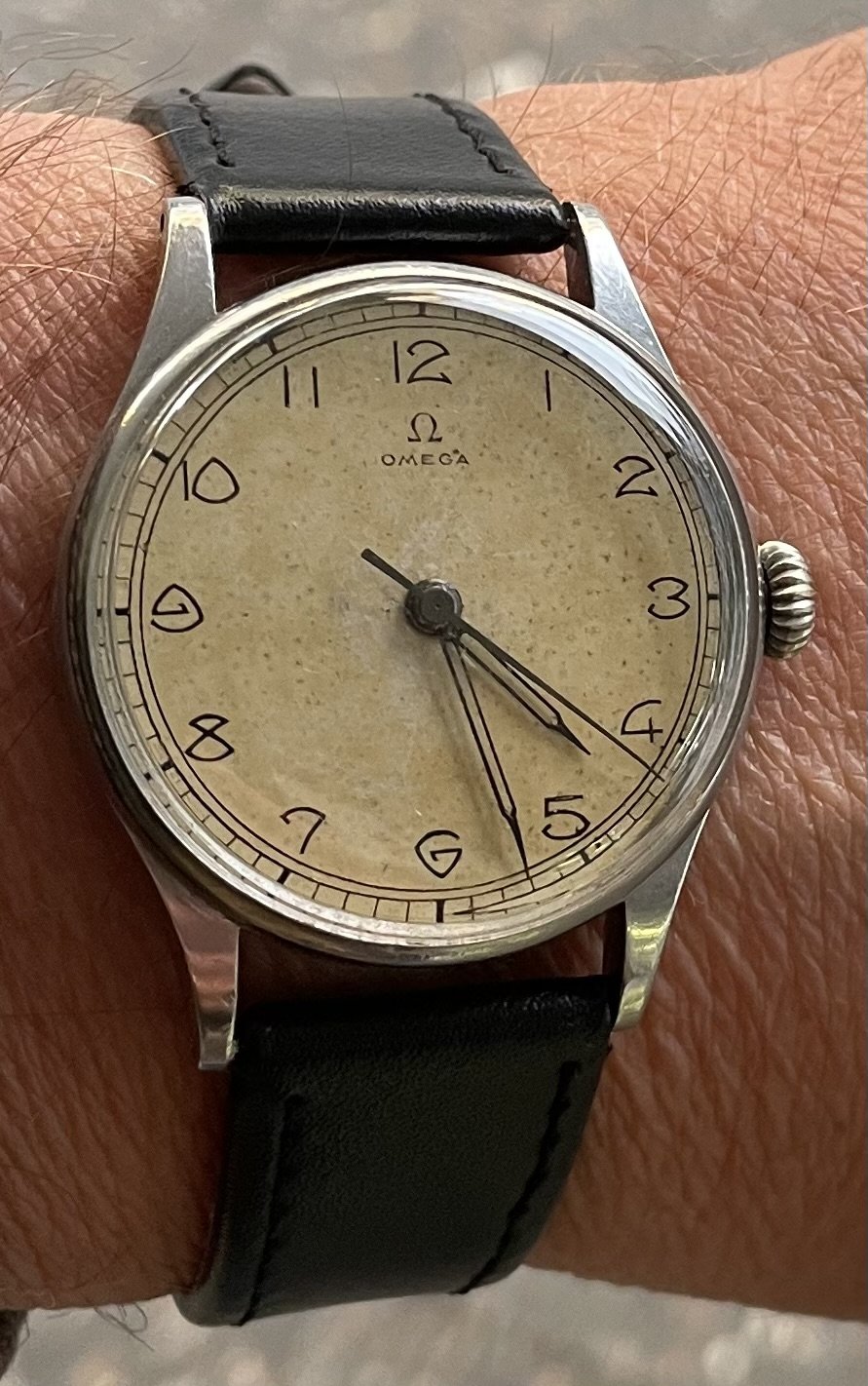

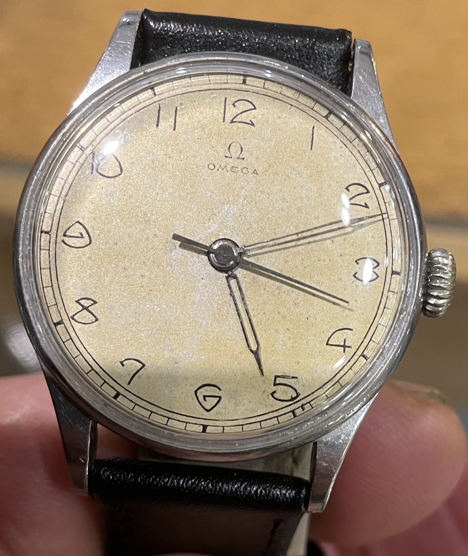

I had posted this watch recently and this is the before:

Sadly the sweep tip snapped off during the fall and the minute hand cannot be made better and in bad shape. The hand finish is black rather than blued..Thanks everyone for your help very much appreciated
