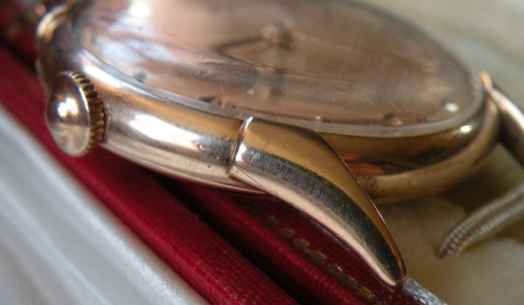

3. On this particular example the crown is flat. On many other examples the crown is not flat, but rather, features a sort of wart, like that on the example below.
Is either crown appropriate to 30t2 watches?

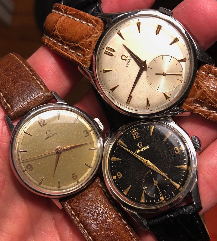

And because every thread needs photos ...

30t2 used many types of crowns depend on case designs and function. Some were waterproof some did not. That nipple crown was correct on some non waterproof cases.

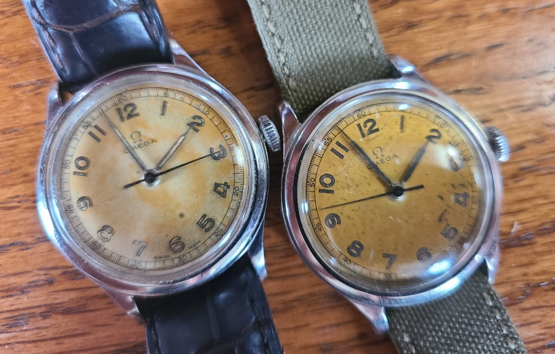

30T mvmts are easy to service. Very robust. Parts available. Balance and Hairspring very hard to find and there are many different ones over the years.... Your first one: looks good . Good size for an Ladies Watch. Crown needs a better side pics.,but should be correct. Your second one: Crown is correct and often called Bowler Hat crown. The rest is a disaster , broken Lug as well....

Is the first watch I showed a "Ladies Watch?" That is one of my greatest concerns in the pursuit......I cannot rightfully say that I am able, just from a photograph, to confidently distinguish men's from women's watches. Now, if your comment was just a good-hearted confirmation of your preference for larger watches.....I would respond: The buckler went out of style with the sword; thank heavens. 😀
