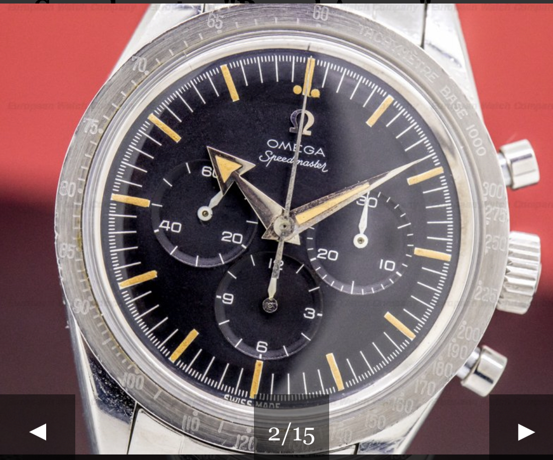

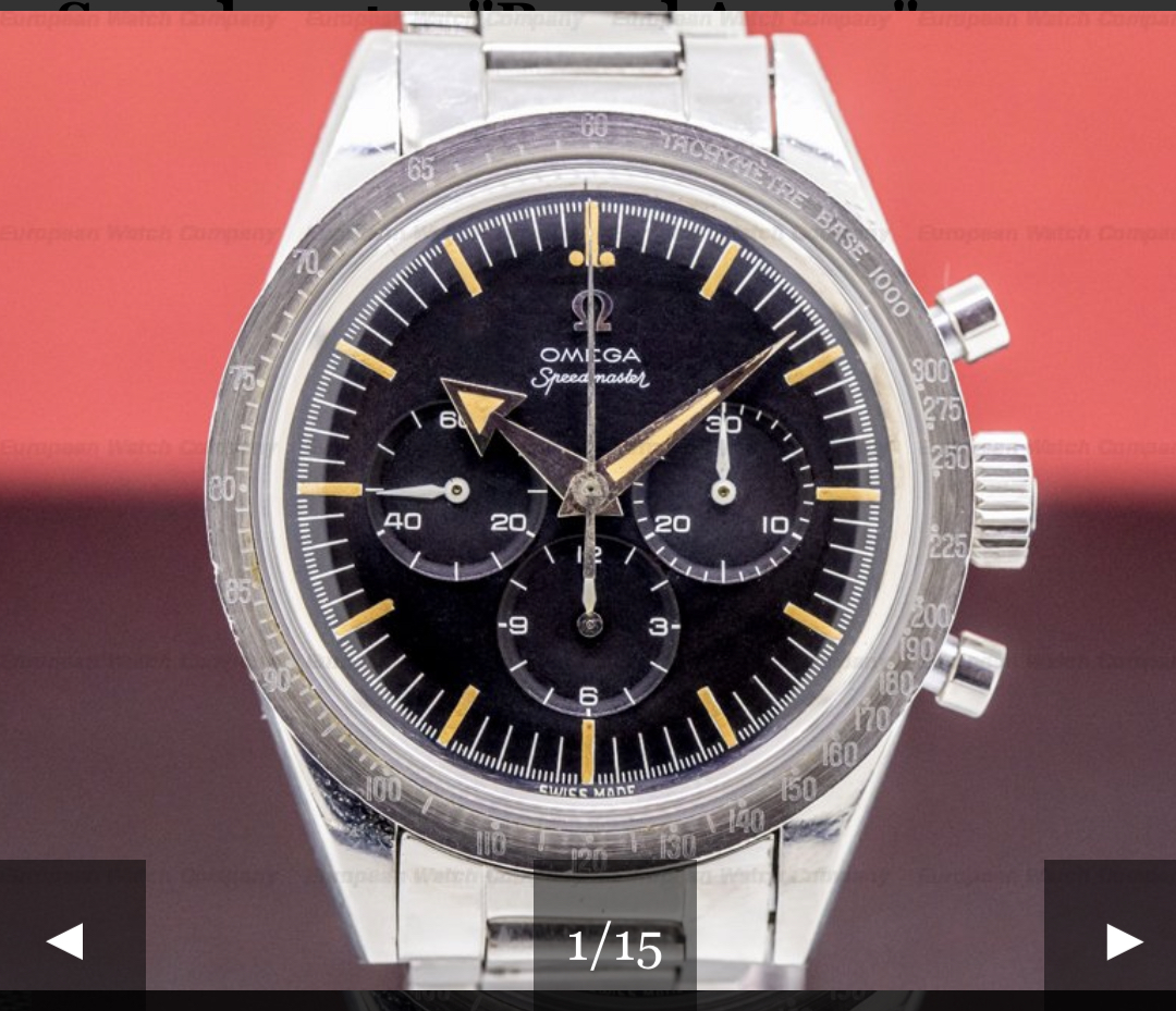

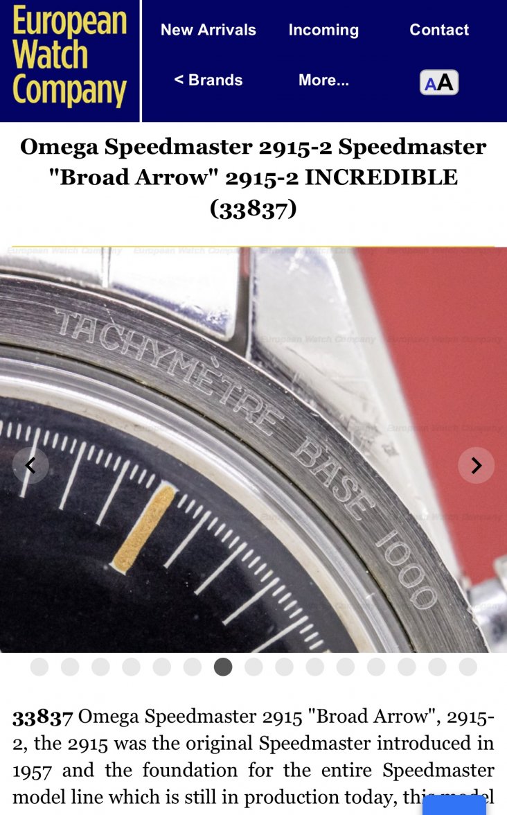

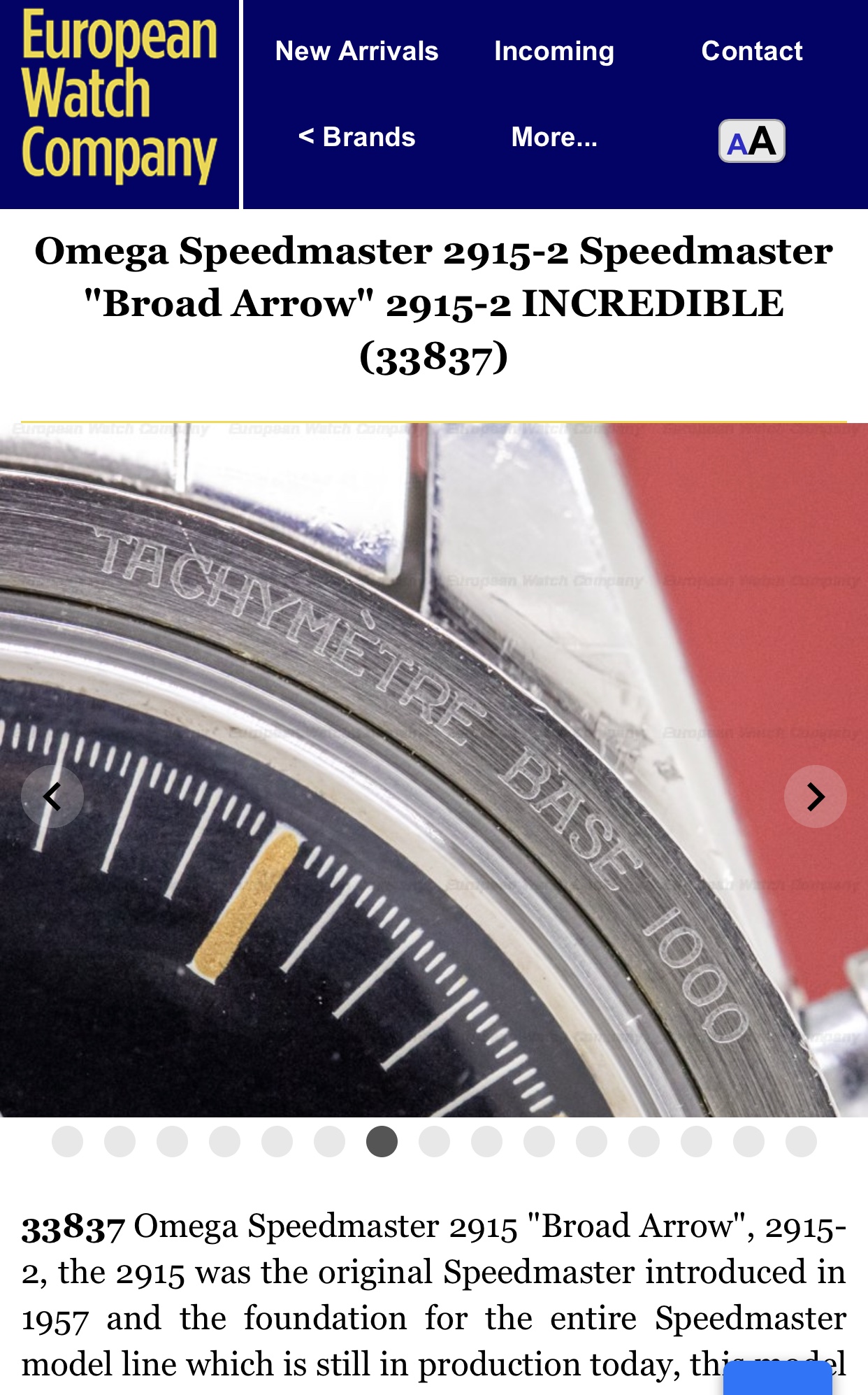

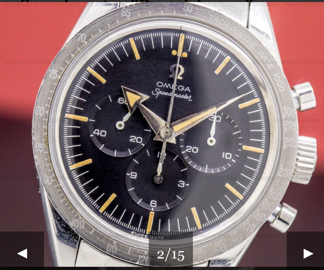

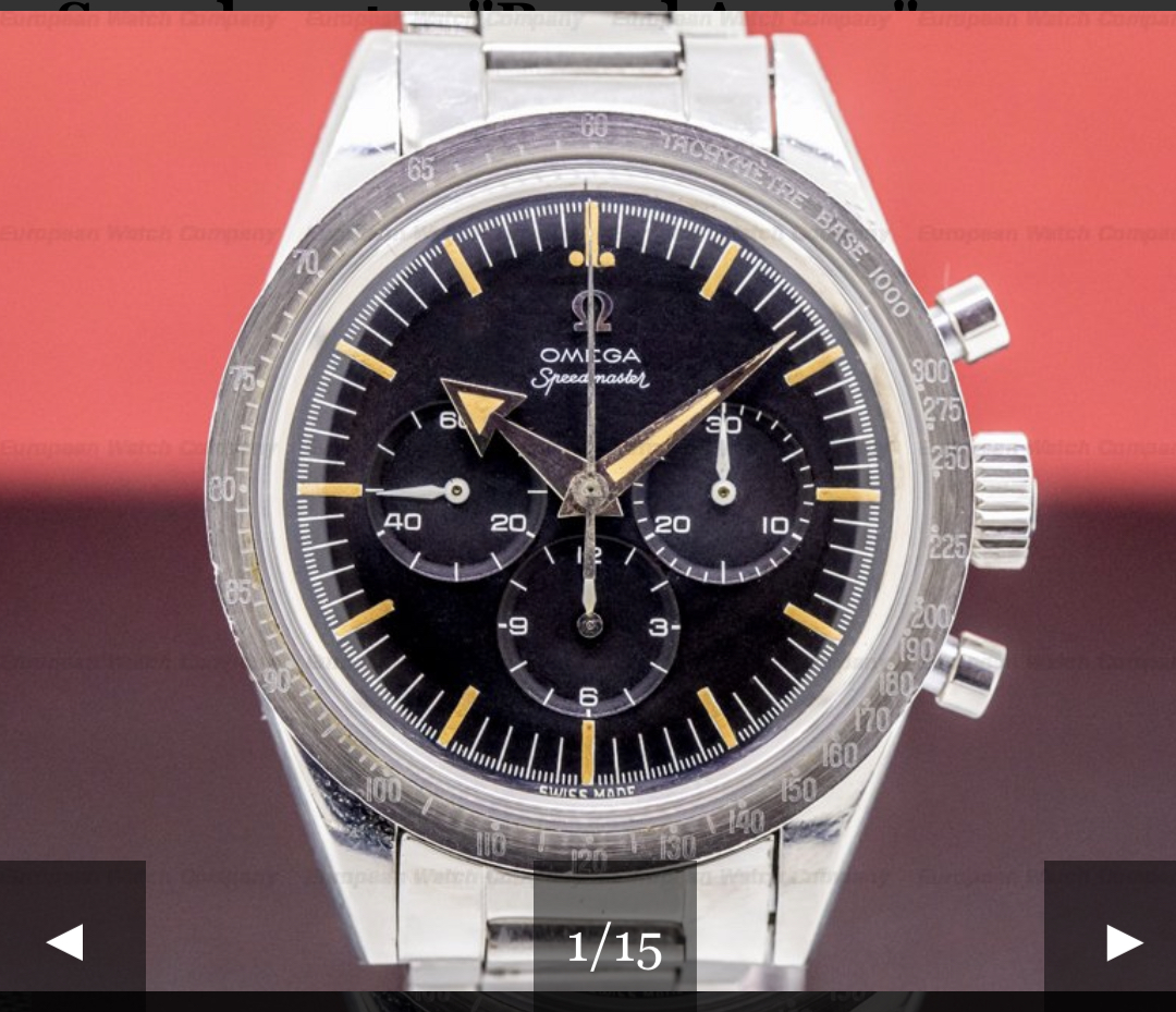

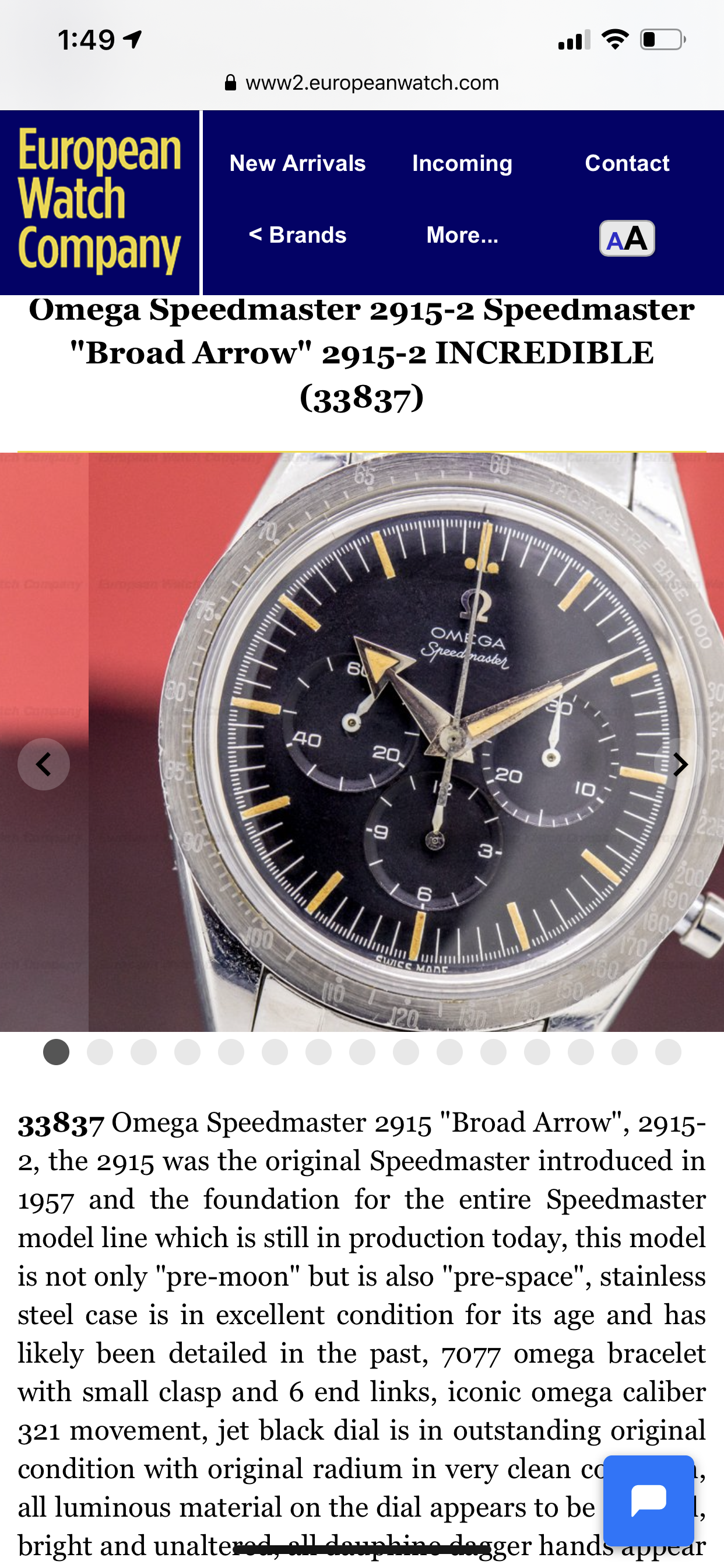

As already mentioned in the concurrent thread: strange ringwear to the bezel, ain't it?
2,318
5,713
To start, first thing I notice: strange ringwear to the Bezel..
Nothing "Strange" about it. It is not wear.

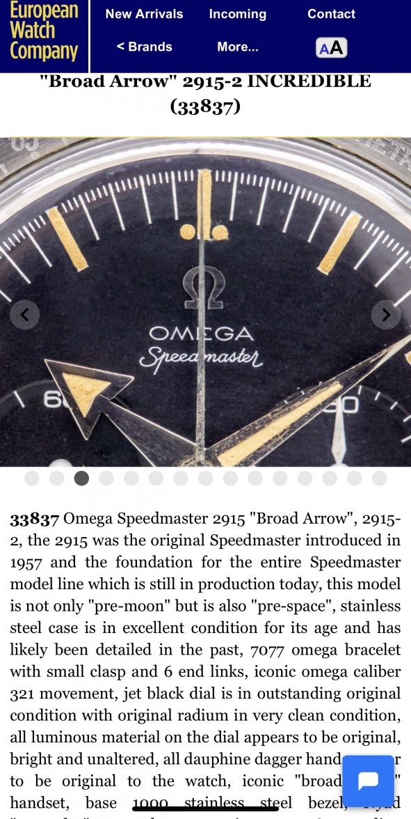

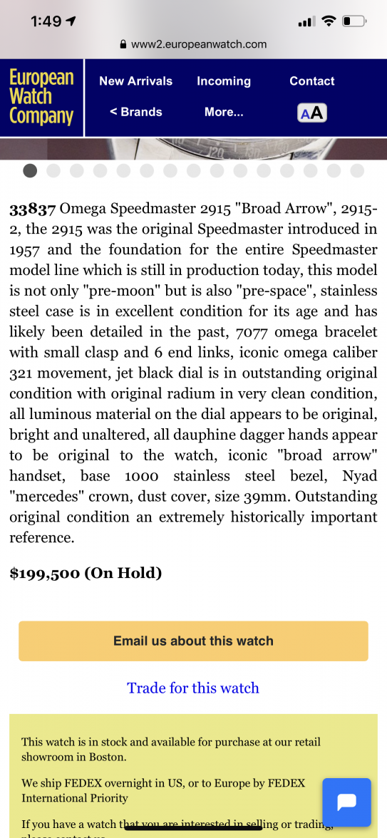

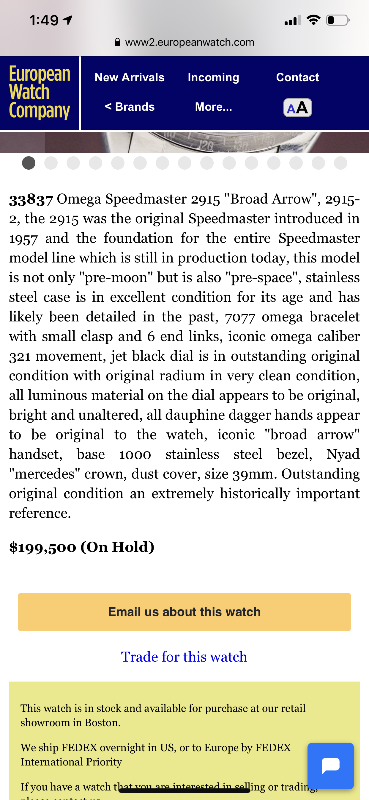

While original is used a few times in the description it is not used in conjunction with the bezel.
It also doesn't say "Original" caseback, or "Original" Crown, or "Original" 6 end links and so on, and so on...
well spotted

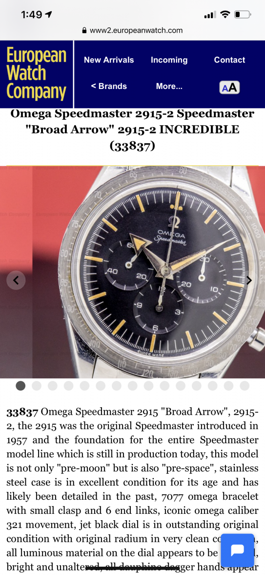

This watch looks fine to me and I believe it is completely original.
The bezel is genuine and correct for the reference.

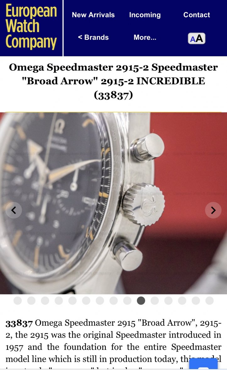

The crown doesn't necessarily have to be a naiad crown, though naiad crowns can be found especially on the 2915-2 and 2915-3, up to the early 2998 models.
