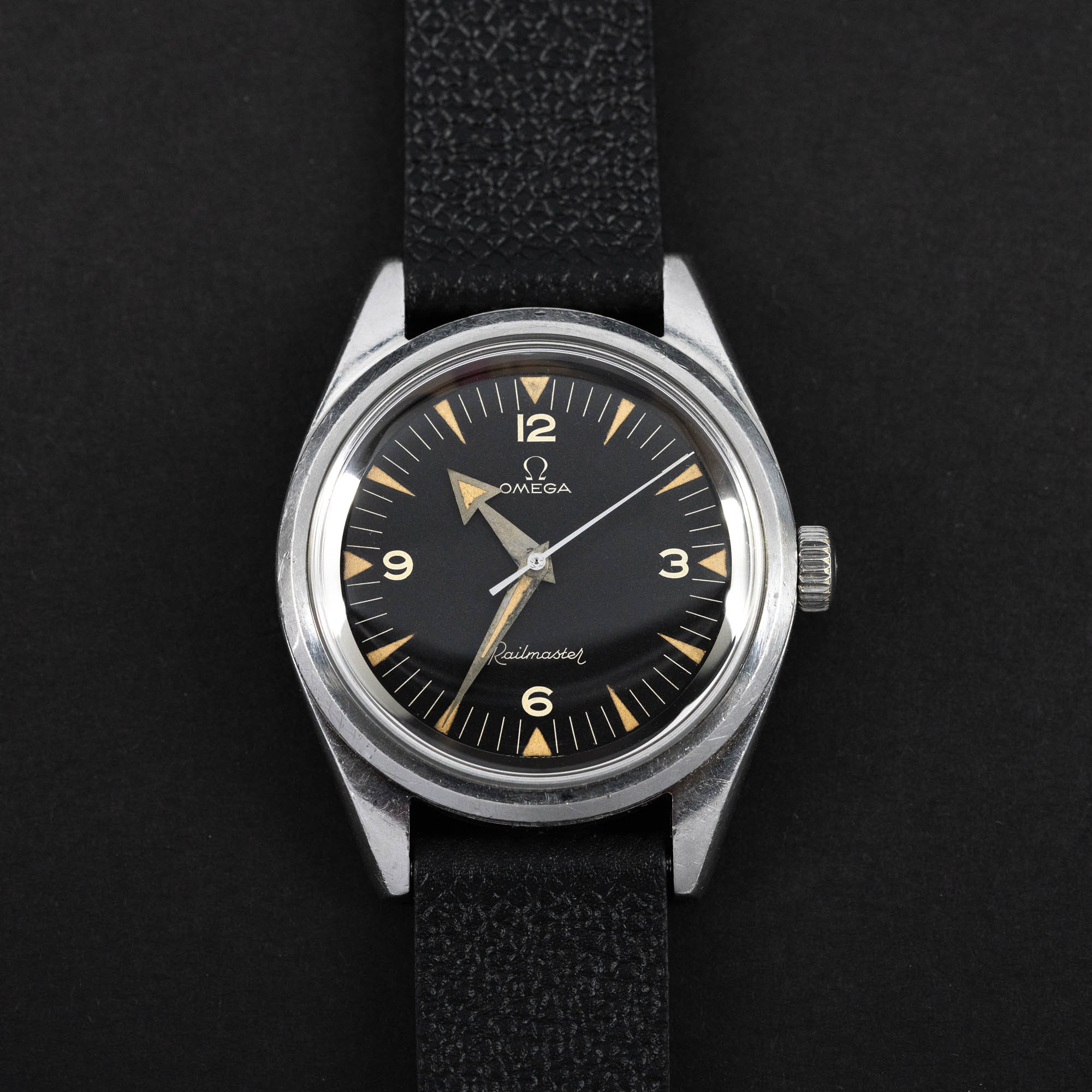

Hi all,
Surely this seconds hand is too long for this watch? It stretches over the minute marker. It also looks like the center screw hole is too wide? What do you guys think......

Seconds hand can be easily clipped to length.
don’t know what the center screw hole is. The seconds hand is not screwed, it has a pressure fit.

Sorry Franco, didn't know it was pressured fitted. Looks bigger than other examples I have seen though.

Second hand length is fine.

There is no need to be sorry, we are all here to learn. The seconds hand is the same as many 28x series watches, in the 30T2SCRg was blue, in others white or silver or gold.
