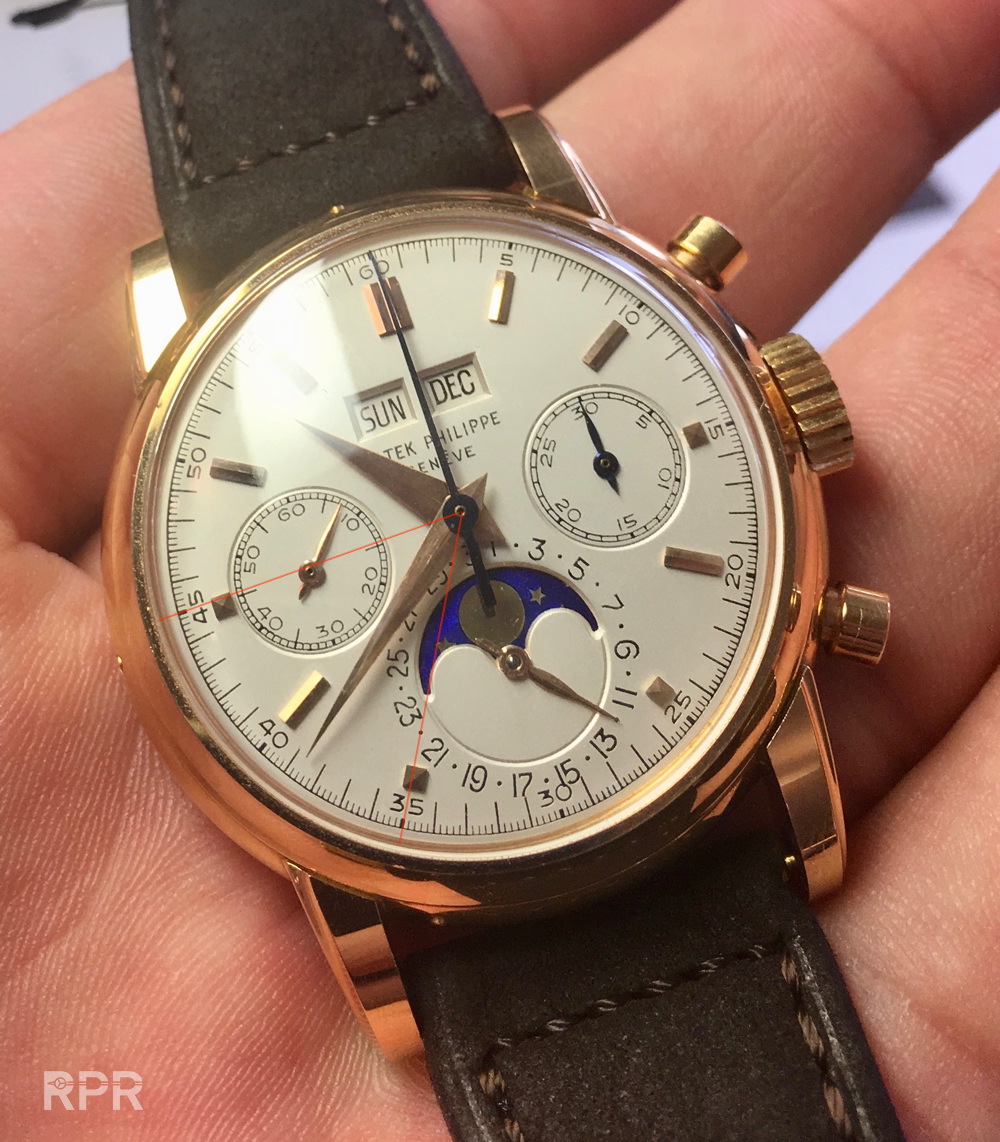

I think I found it, this Patek 2499, got it from: http://rolexpassionreport.com/25228/geneva-watch-auction-report-november-2017/

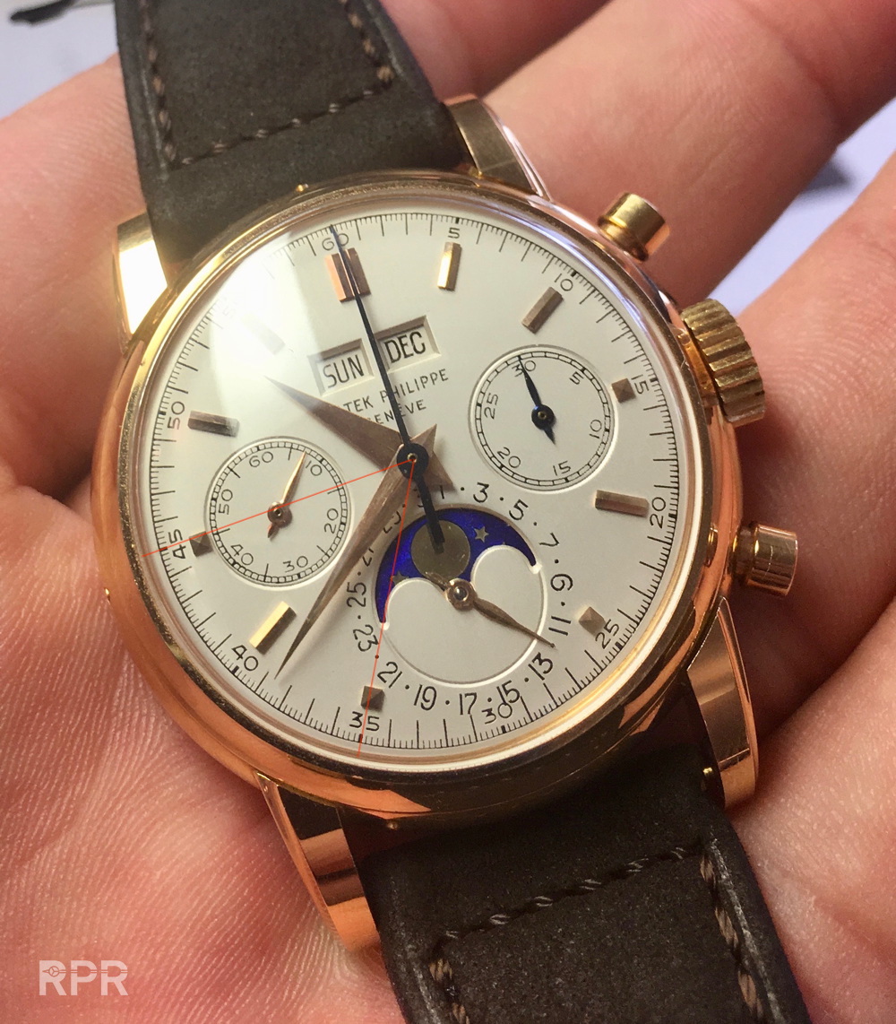

The post was regarding the hour markers and how off center several were. Specifically 7:00 and 9:00

If you draw a line connecting the pivots of the second's subdial and the minute recorder's, you will see clearly that the whole minute chapter ring is off by a large margin (as well as the second chapter ring). The hour markers are fine.

You have to be at least a bit careful with drawing lines like this. It would only really work correctly if the image was taken absolutely head-on to the watch face, and best with a reasonable distance between the lens and the dial. In this case it's clearly at an angle, so the position of the actual dial-centre will be somewhere down and to the left of the estimated position (which is taken from a higher plane than the dial). Using the correct dial-centre would make the problems at 9 and 7 both seem less, but I would guess there is still mis-alignment.
agree, but 9 is still waaayy off regardless.
7 i could put down (without seeing a dead on picture as you state) to a bad photo angle.
At the specific camera angle of this image, the perspective effect is reducing the off-alignment of the minute chapter ring compared to the hour marker at 9 o'clock. It's actually to the opposite effect of what you thought.

Yes, that's it - good searching.
The 4, 7 and 9 markers are visibly misaligned, and note the overprinting of the 15 on the calendar subdial with the 30 of the minutes track. On the genuine example, those numbers come close and may contact one another, but certainly don't intersect. From my very limited knowledge of Patek Philippe, their quality controls are way stricter than this
