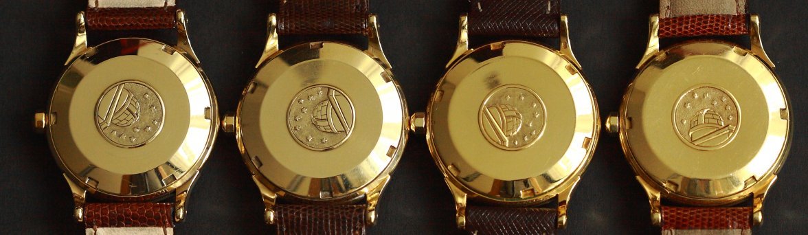

These are all 2652 case backs, 2x 14kt and 2x 18kt.

Not to be too picky, but could you rotate the casebacks on the first three so that the observatories align with #4 please?
Only for the photo though, you can re-tension them after.

You're absolutely right Jim, I've been having sleepless nights over this photo for years.....I'll get the DSLR and tripod out over the weekend....😁
