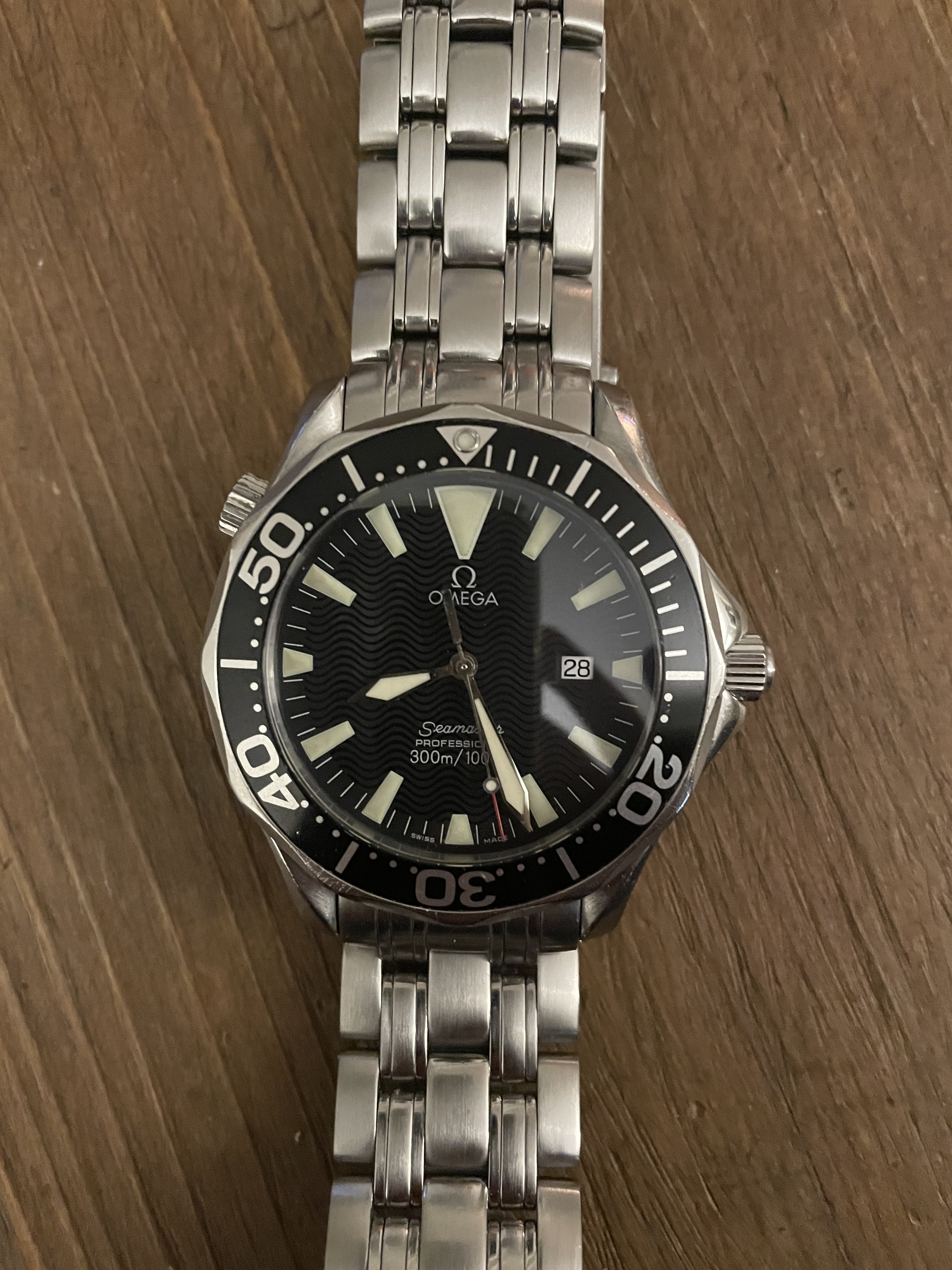

I recently bought a 1990’s Seamaster 300 and had it authenticated by two separate (and trusted) watch repair services. Problem is the date wheel is white with black numbers instead of the other way around. I didn’t know enough about the 300 when I got it so my question is: Can it be possible the previous owner had the date wheel swapped out? Or am I dealing with a non-Omega part? Any info on this would be appreciated.

The blue dial (Bond) reference used the same movement and had a white date-wheel. So my guess is sometime in the past, a watchmaker replaced it with that one.

Date wheel font looks right to me. Beautiful watch, congrats!

Thanks for your reply. I really like the watch and the date wheel color doesn’t bug me so it’s become my everyday watch. Cheers

Even it was replaced in the past you have a beautiful watch and my advice is to enjoy your watch as it is.

With the serial number I can look it up in the Omega service website and probably see what the original wheel was.

No need for the serial number - it should be a black wheel with white lettering.
Two possibilities...someone has changed the date wheel, or the entire movement has been swapped out (likely for the ETA version of the movement).
Only way to know is to open the watch up. It should have an Omega 1538 inside, and should be clearly marked as such. If it isn't, then it's a franken watch.

It was opened up and it was genuine (not ETA). I don’t know why someone would switch out the date wheel though. Thanks for taking the time to give me the information.

It could be an accident/oversight or a request from the previous owner for legibility reasons. It can always be corrected at a later time, but as long as you enjoy it 👍 I have long thought this reference is sharp.

Thanks for the reply. I use it as my daily watch and it keeps perfect time, so I guess I’ll just leave it as-is. Unless anyone has any ideas on how to get a black one. I dove deep into eBay and found nothing for this model. I imagine they’re hard to find.

Part number might help...
72214412557/1N | DATE INDICATOR BLACK
