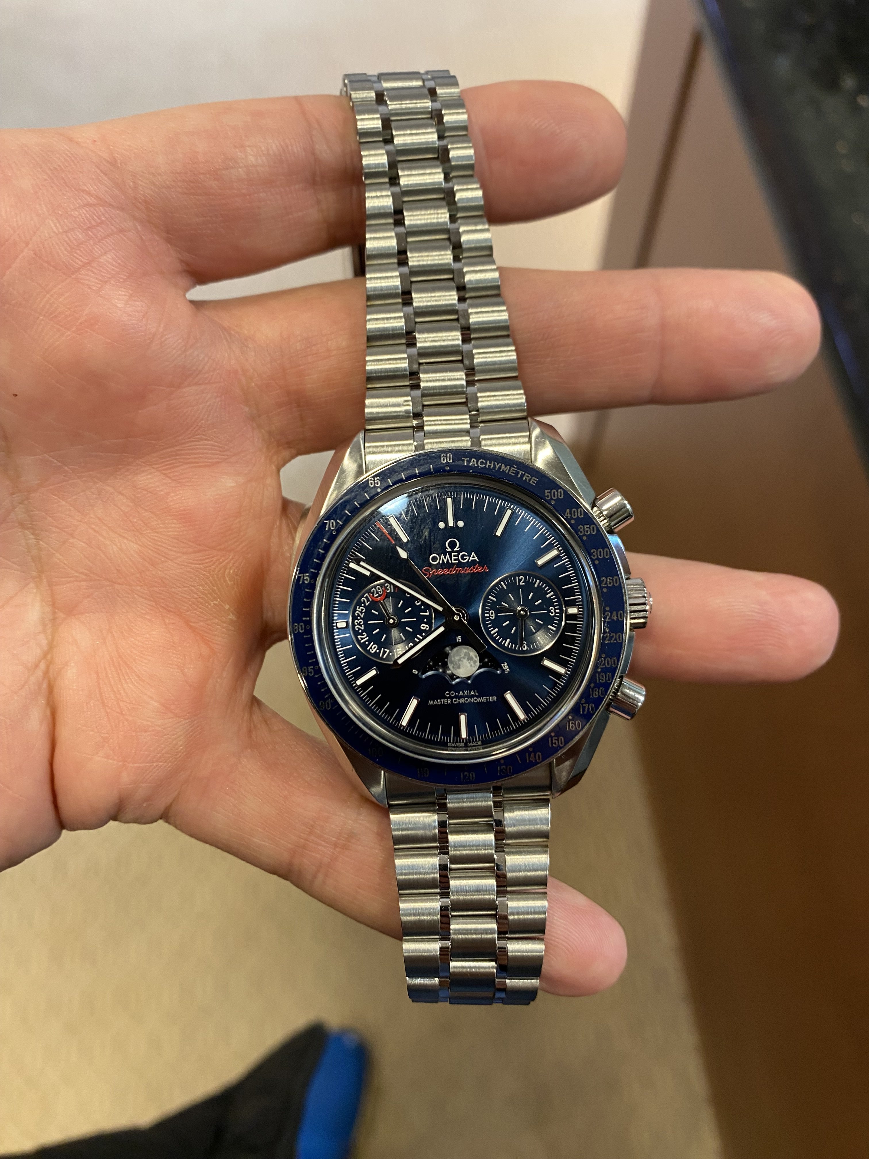

Boom! Even 1.5mm springbar was tight. They were going back and forth between a 1.3 and 1.5 but it was a very solid snug fit

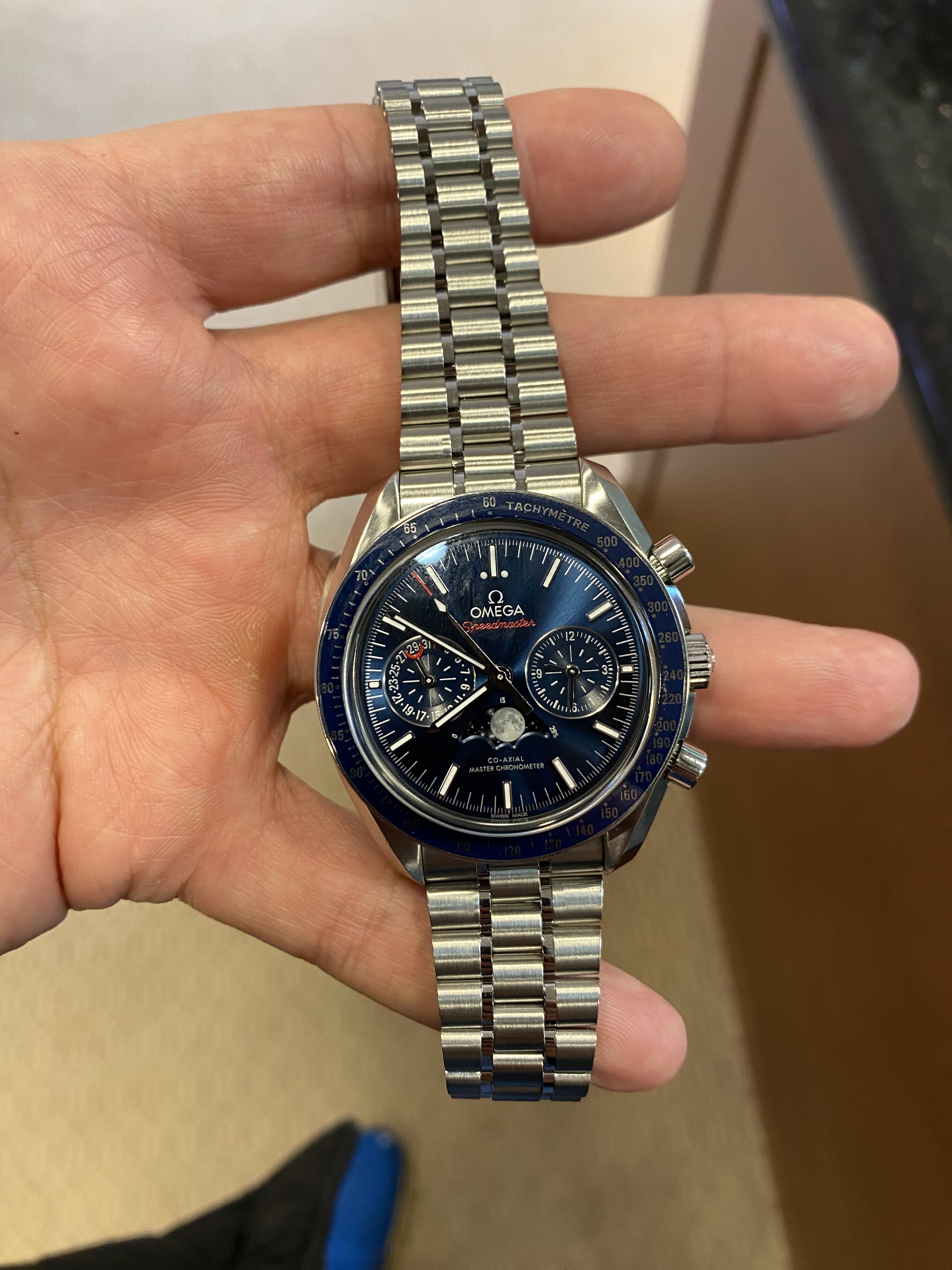

Wow. Beautiful. Could you please share exactly what was done and who was able to achieve this feat?

Bravo. Could you please share the details. I have the same watch and the bracelet. Would love to get it fitted asap

They just used a 1.5mm straight spring bar. That’s it. Toss the 1.8mm bar that comes with the bracelet. At one point they said they could only get a 1.3mm bar to fit during the test fit but I asked them to try the 1.5mm again on the actual bracelet upon taking delivery and they were able to work it in.

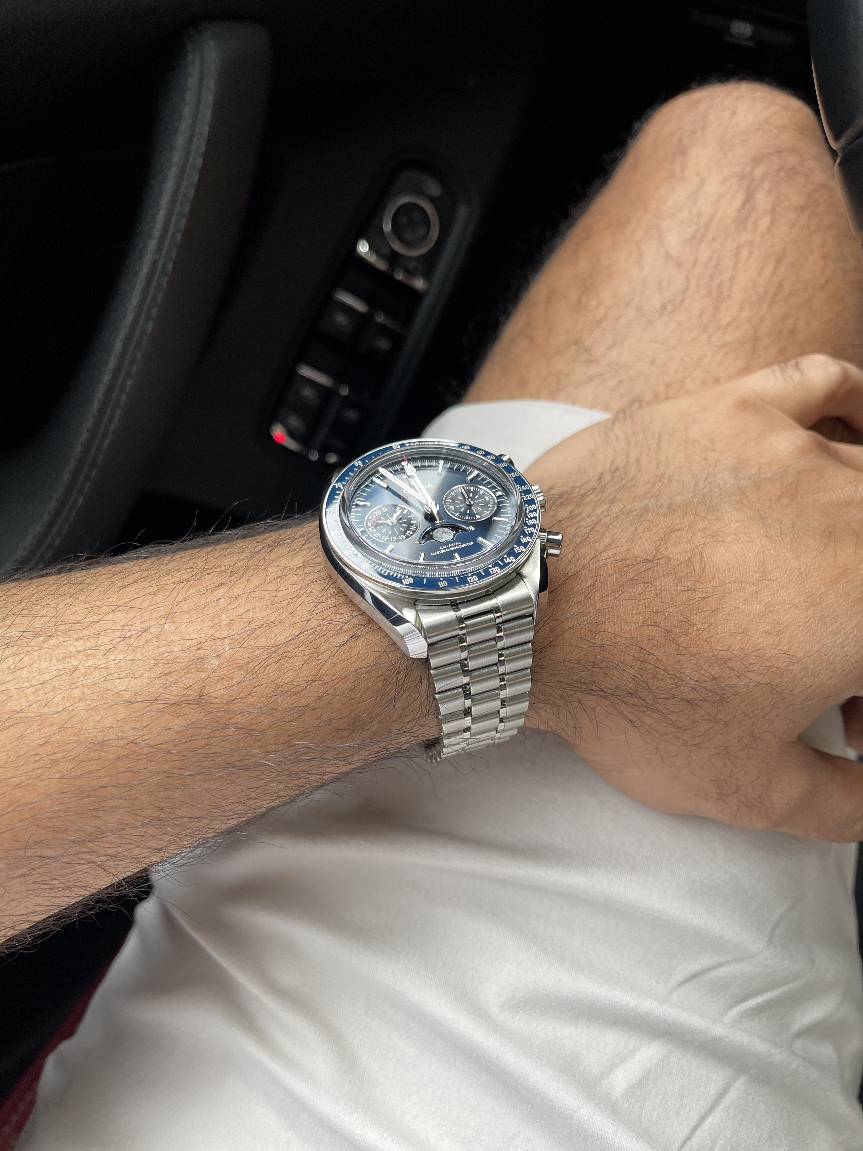

how is the bracelet holding up. My local jeweler tried the 1.5 spring bar and couldn’t fit it. He advised me to not attempt it since the watch can fall off the weaker spring bar.

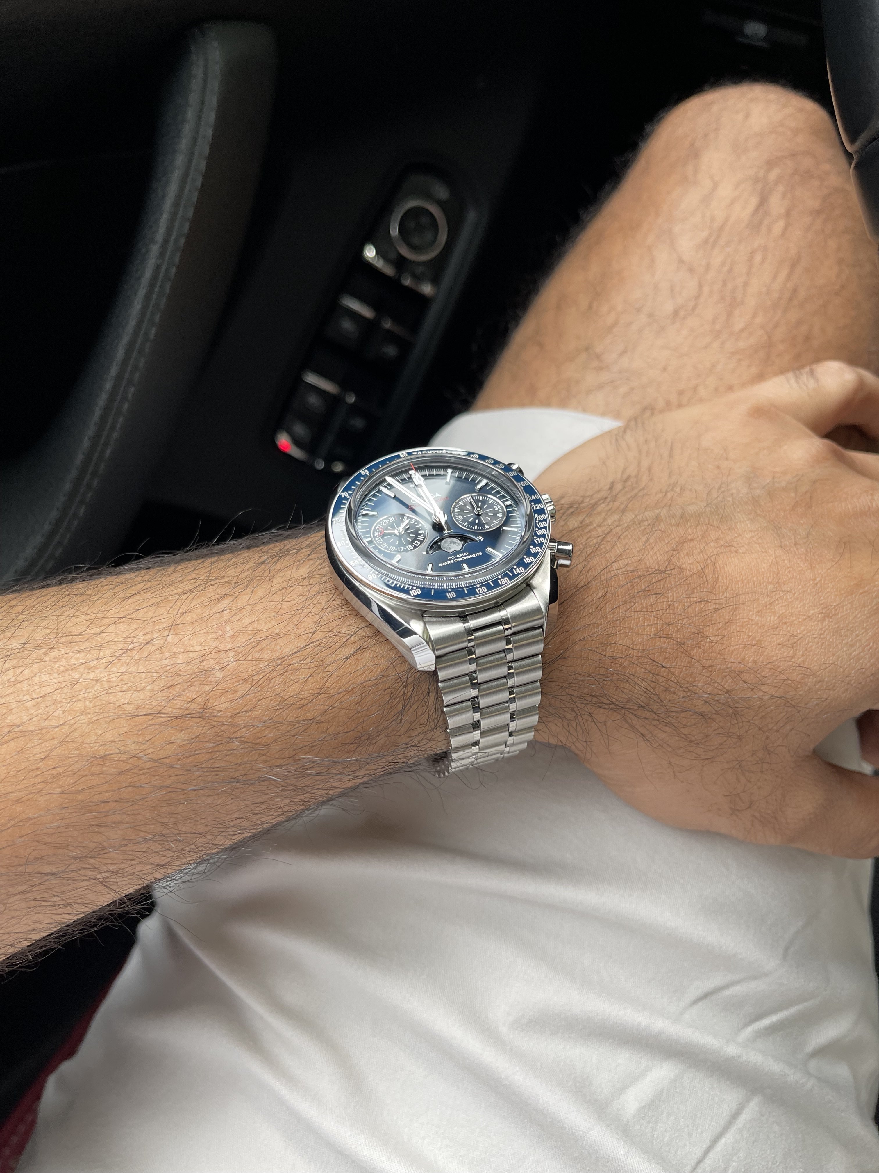

I finally got mine fitted too. Did it by myself using a spring bar tool. Had to use force.

How is the bracelet holding up with the 1.5 MM spring bar. I fitted mine today by myself. I hope it holds well

Totally fine. I wear it 4x/week
