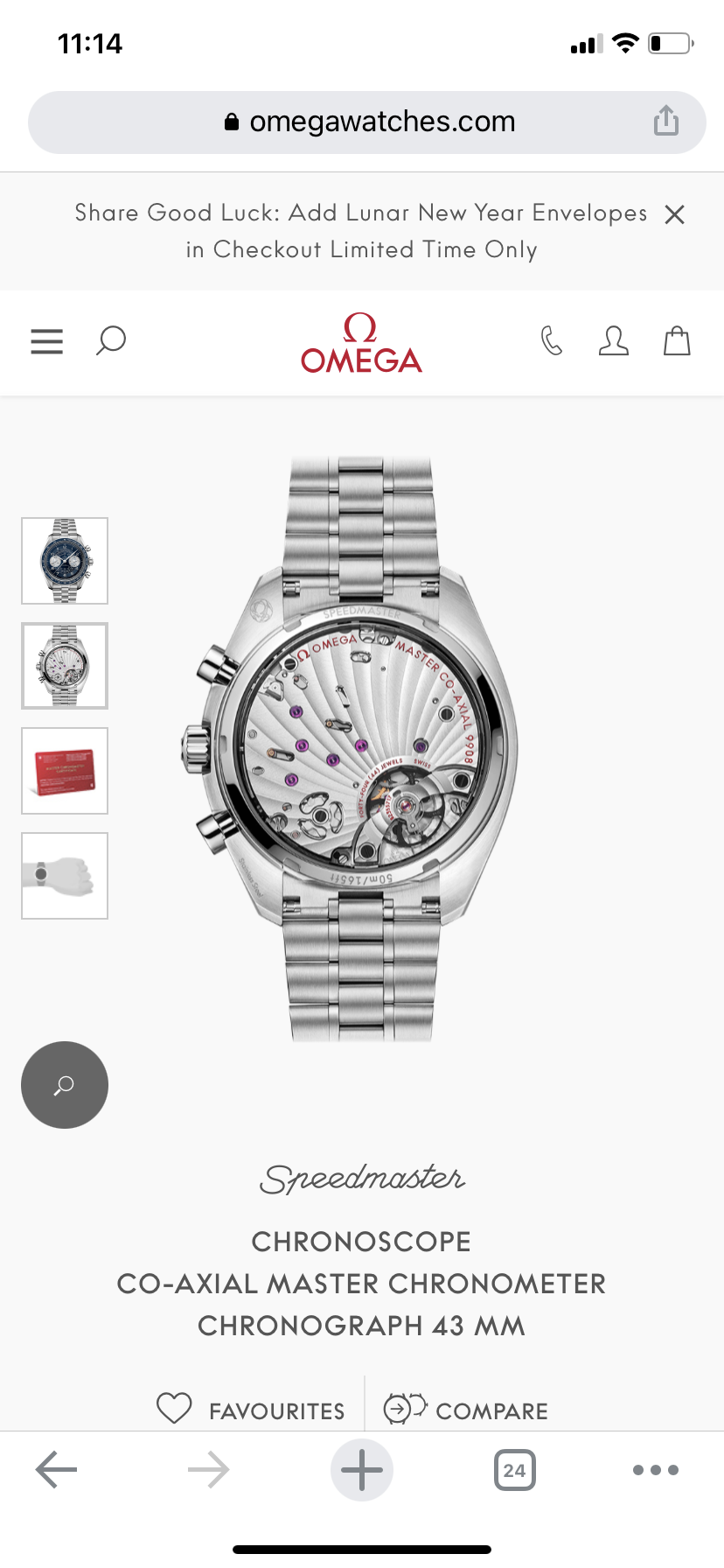

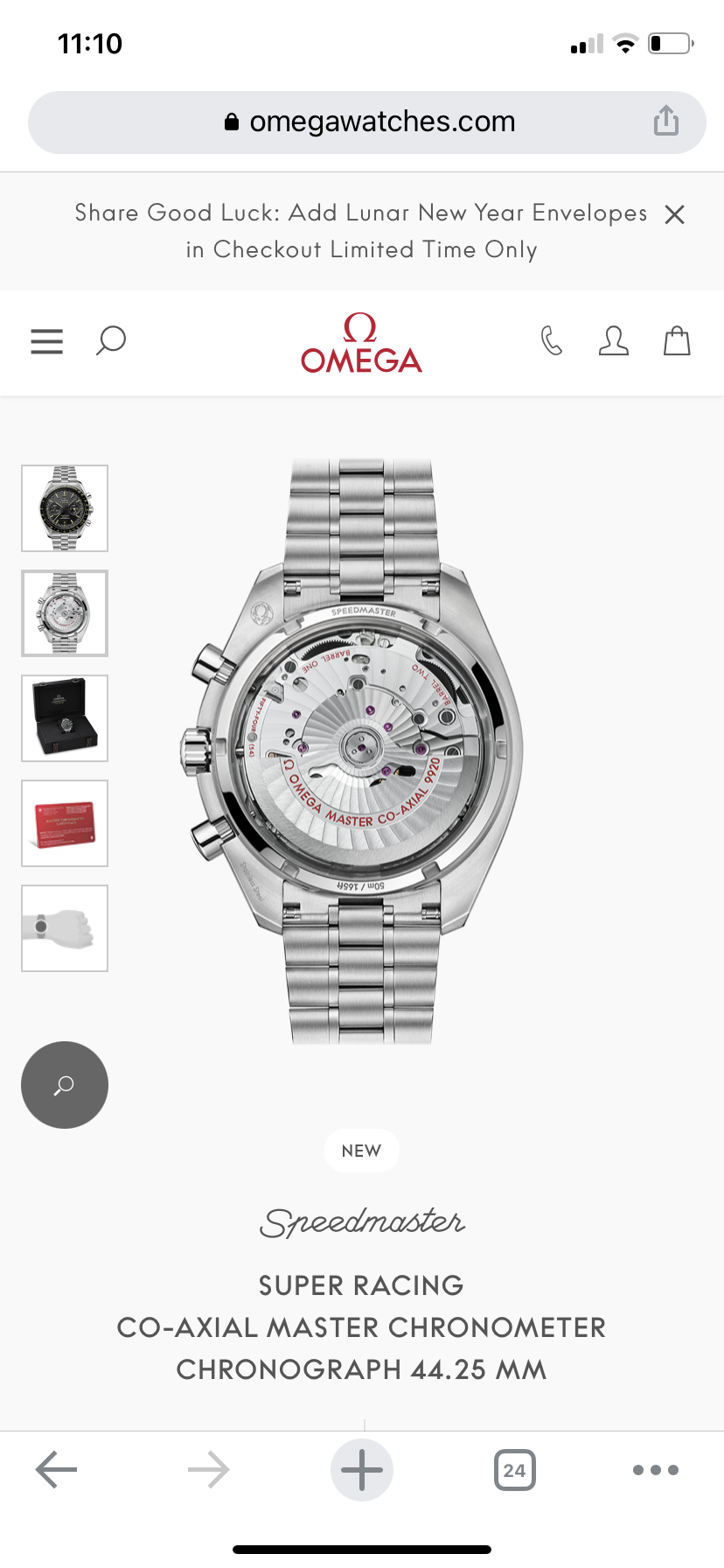

I have a blue moonphase on leather and would love to get my hands on the new bullet style bracelet from the Super Racing model. They are both 21mm lugs and 44.25mm cases. I’m not a fan of the blockier older bracelet that comes on the outgoing racing model and black moonphase.

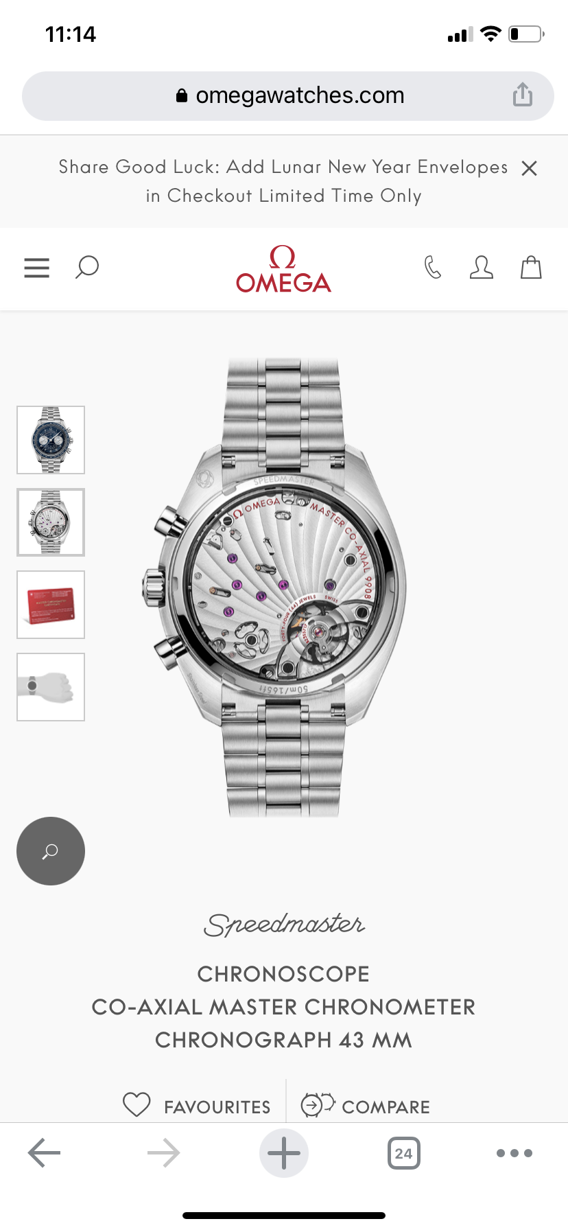

however - it’s my understanding that the 44.25 super racing model is using the same bracelet architecture as the chronoscope - the design is identical (keep in mind the chronoscope is 43mm case but same 21mm lugs). I’ve read on here and also been told independently that the chronoscope bracelet will NOT fit the 44.25 moonphase. Like it fits the lugs perfectly but the pin holes don’t work. If the chronoscope did fit it would be on my moonphase right now but fingers crossed maybe there is hope for the same bracelet slightly adapted for the 44.25 super racing.
I called Omega to get the ref number on the super racing bracelet to see if it were identical to the chronoscope bracelet (because then I would know it’s not worth trying). They don’t have it yet.
So what do you think?
Either
A. omega straight up reuses the exact chronoscope bracelet, thus changing the pin hole locations over the prior 44.25 racing model (which also means the older racing/moonphase bracelets are not interchangeable with the new super racing)…
or B. Omega keeps the pinhole locations the same as the outgoing 44.25 racing case and slightly tweaks the chronoscope bracelet pins with a different ref, thus making my moonphase able to accept the new bracelet.
I could see omega going with option A, particularly if all of the bullet style bracelets need a specific leverage point and pin hole locations need to be consistent with all models that offer that style bracelet, meaning it won’t be interchangeable with the moonphase or last gen racing which have pin holes set to a different bracelet style….But then again, the chronoscope is 43mm case not 44.25 so who knows, maybe the new super racing bracelet has a new ref number and slightly tweaked and interchangeable across all 44.25 speedy cases

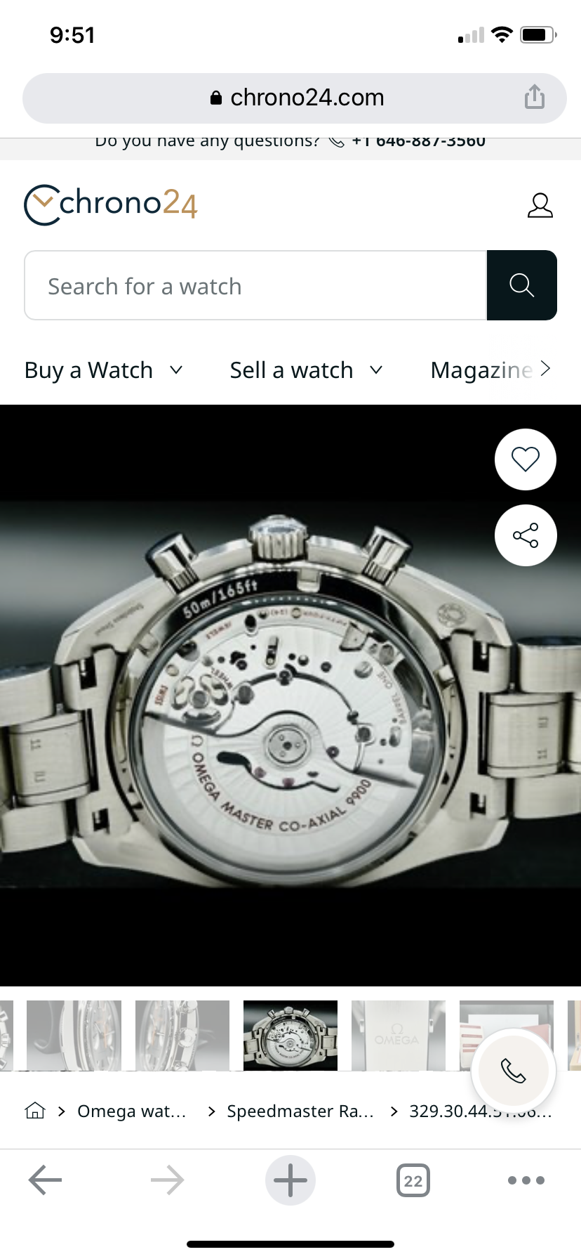

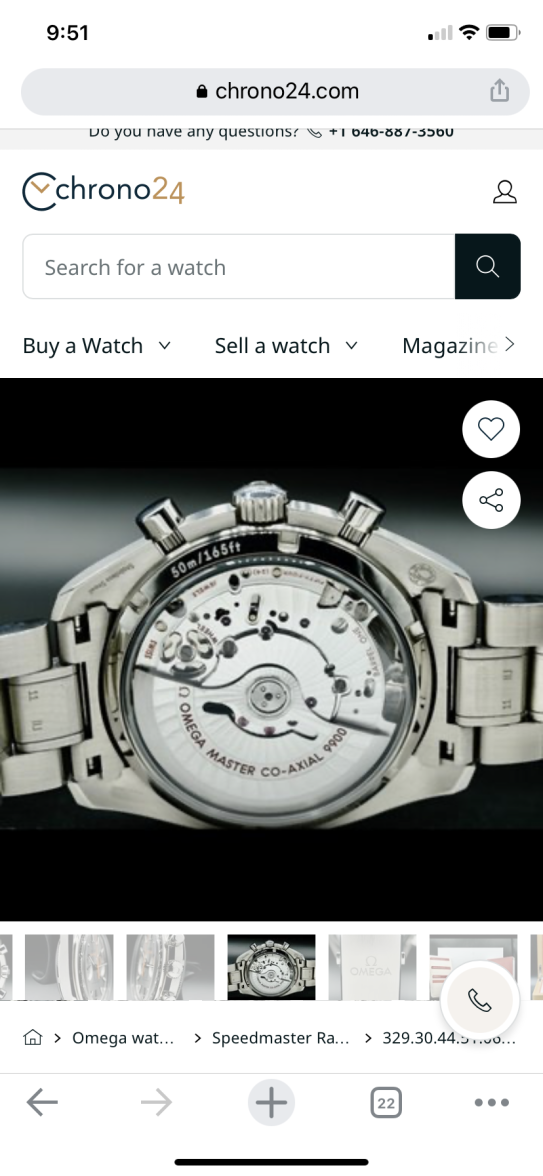

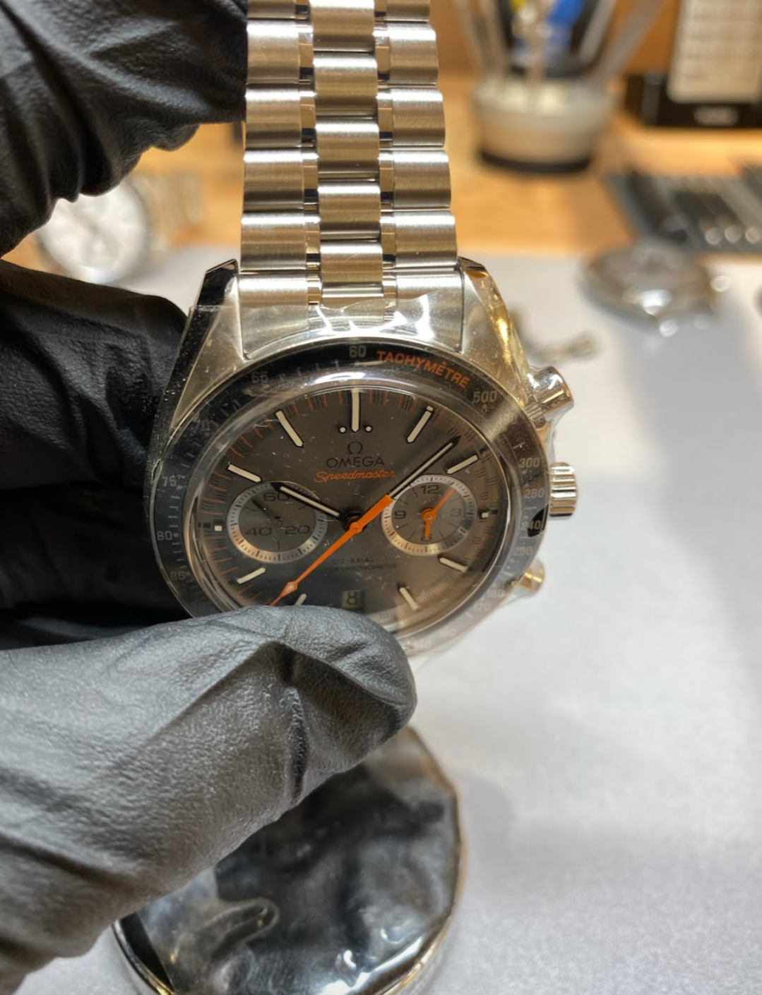

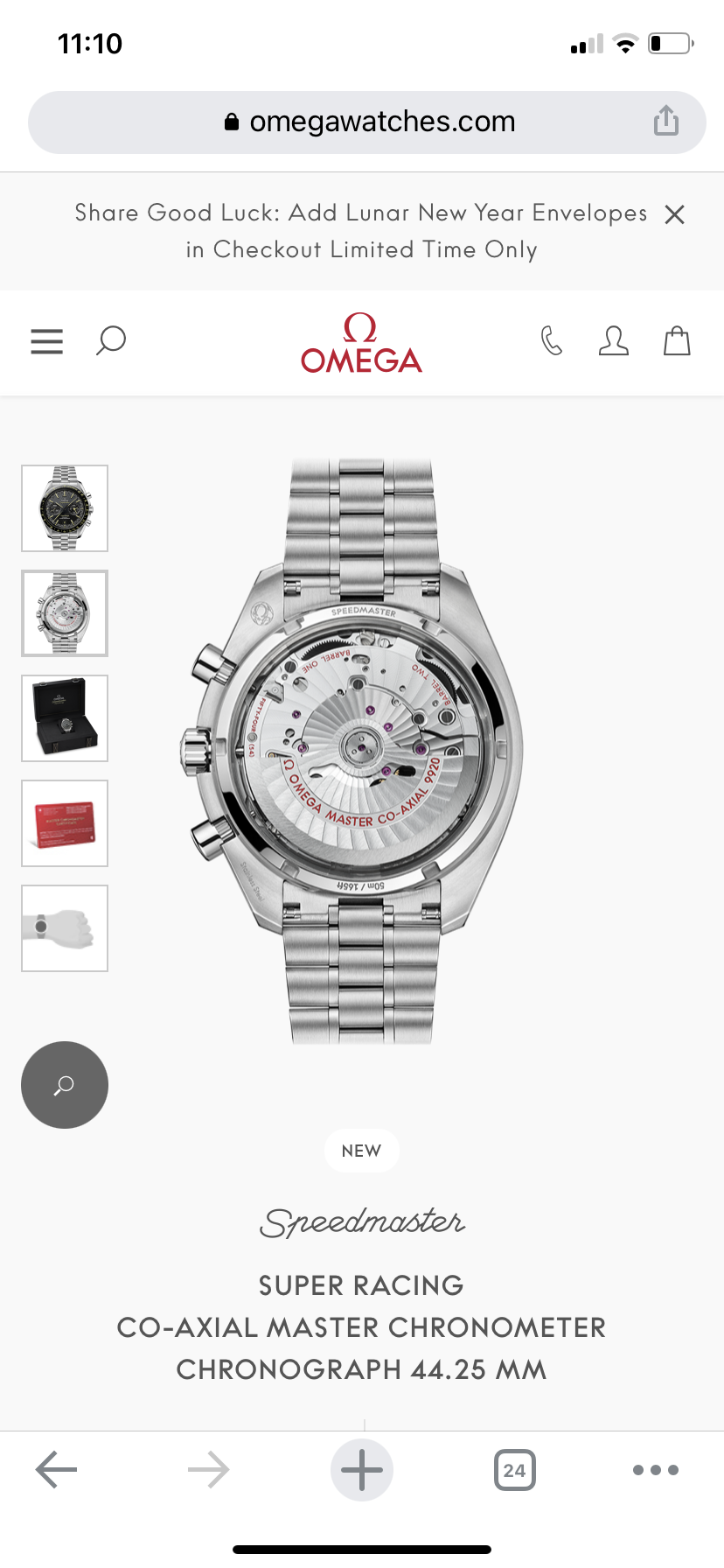

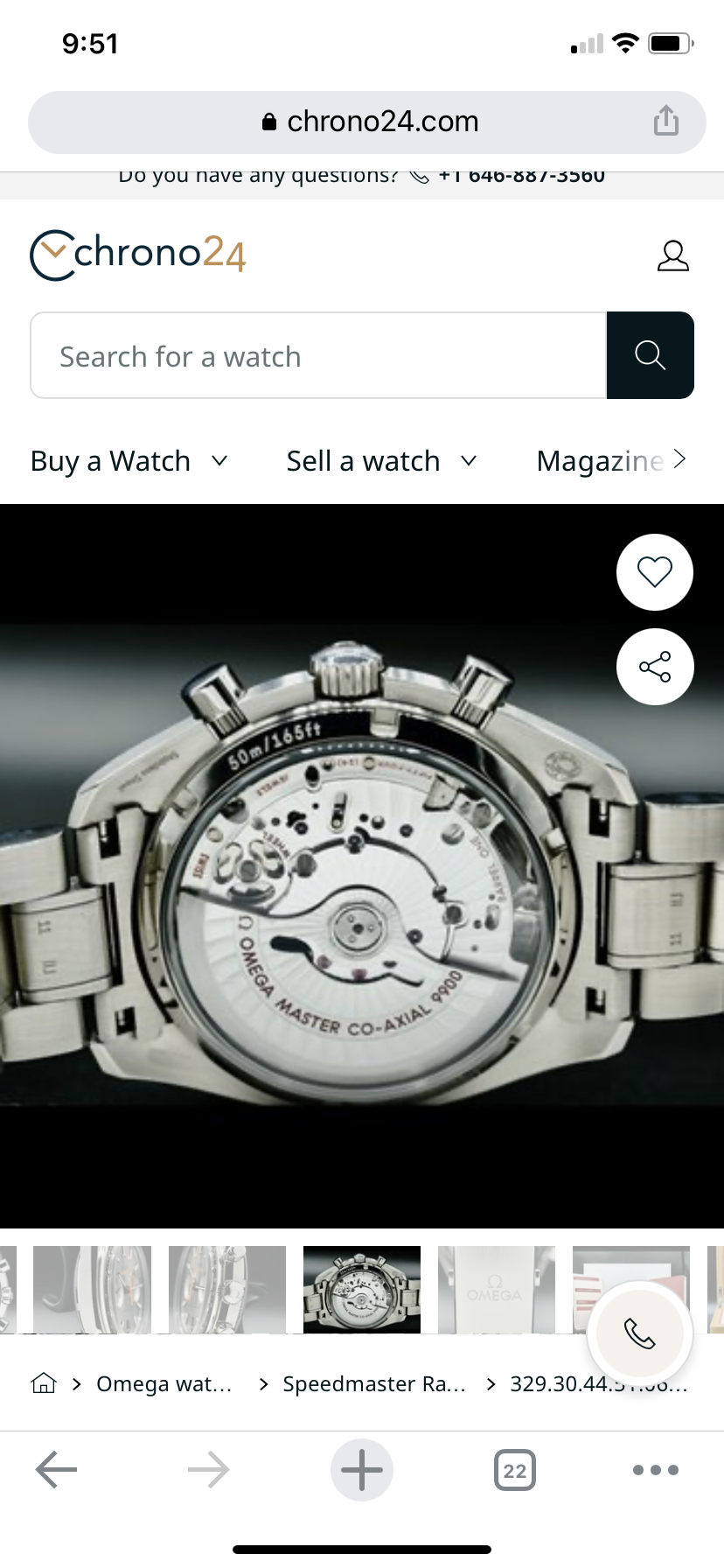

photos below of 2023 racing, chronoscope and outgoing racing/moonphase with blocky bracelet

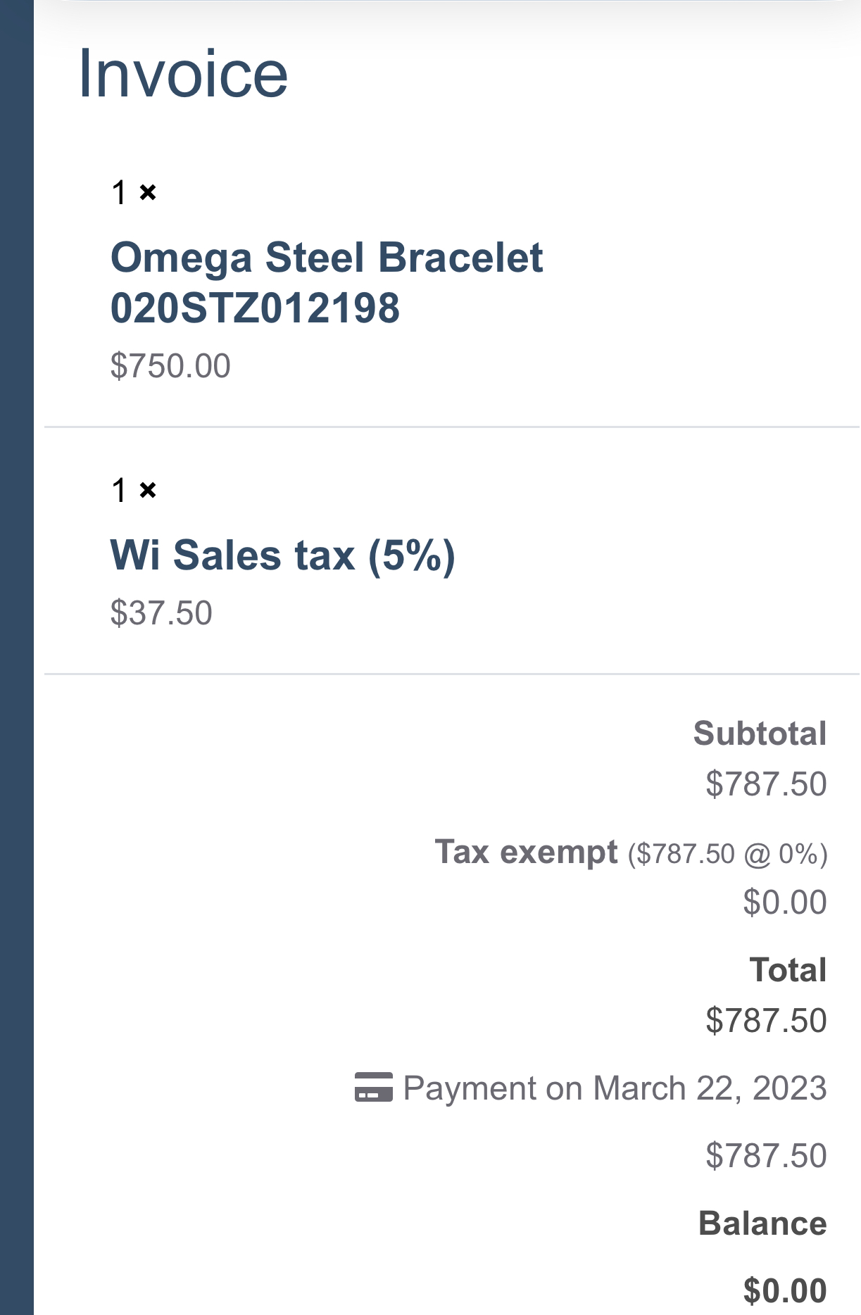

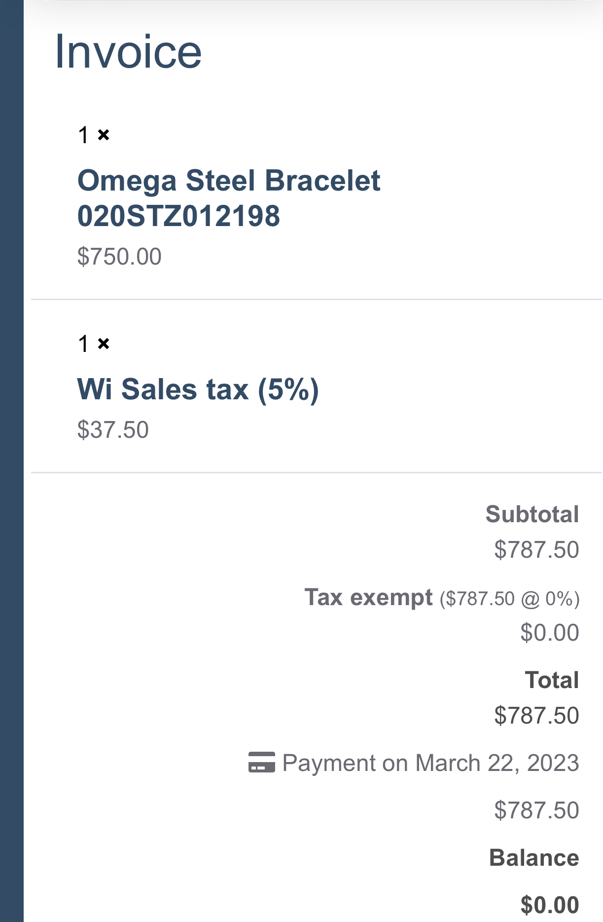

I bought this bracelet from omega for my moonphase and sure it didn’t fit. Now I am checking with them if they will refund me since they told me that it should fit.

I did buy the super racing bracelet indeed through Burdeen jeweler in Chicago who ordered it for me through his omega connection. The omega folks didn’t straight up recommend but said it should fit. Bump, it didn’t .

Here is the serial number
Yeah that’s the SKU for the chronoscope bracelet. Same one I tried on. I’ve been told the SKU for the super racing won’t be out until the actually watch is out (August/September) and the actual part may not be readily available for a couple months after that.
Either your dealer 1. Has information to the contrary and has confirmed the chronoscope bracelet is unchanged for the super racing with the identical SKU, or 2. Simply thinking that bracelet is the same because it’s a 21mm in the same exact design
the only saving grace is that omega changed the endlinks for the chronoscope bracelet and left the pinholes in the same location as the outgoing racing (same as the moonphase) but Omega is saying the new super racing bracelet doesn’t have a SKU yet.

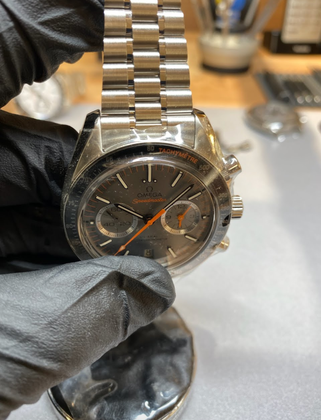

For what it's worth, chronoscope bracelet on the racing works with thinner spring bars no problem. I chose to stick with the stock bracelet though because the chronoscope is way to thing at the clasp for the 44mm beast and looks way too dainty

This was my Omega boutique that test fit on a speedy racing for me to see if it would work on the new panda dial I was buying. He used whatever the thinner spring bars are that omega sells. It fit fine though I just didn't like the look on the big 44mm very aggressive taper.
Also no bends on the bars
