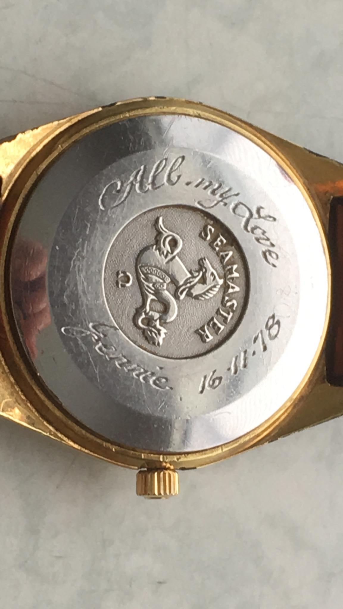

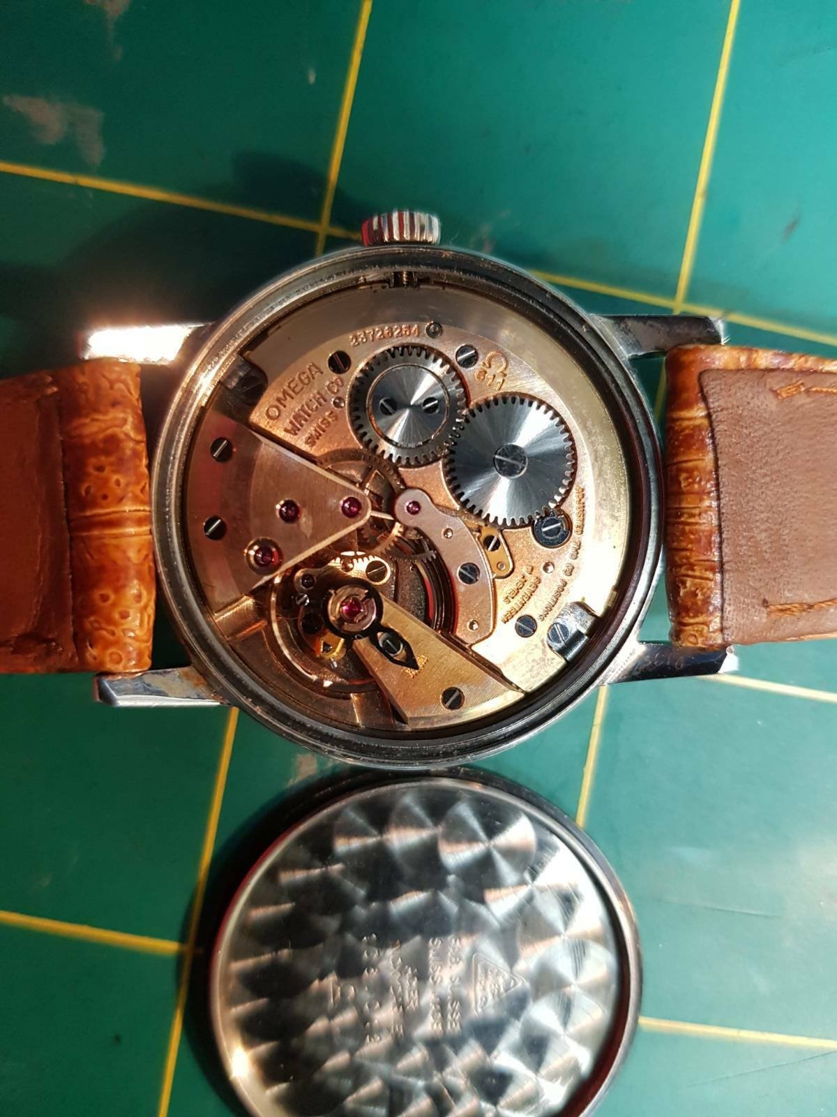

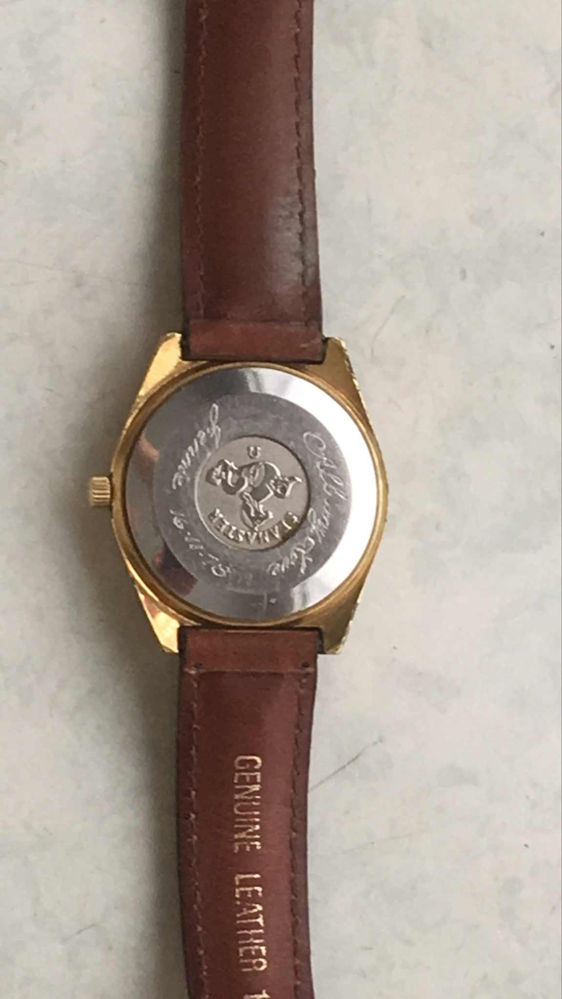

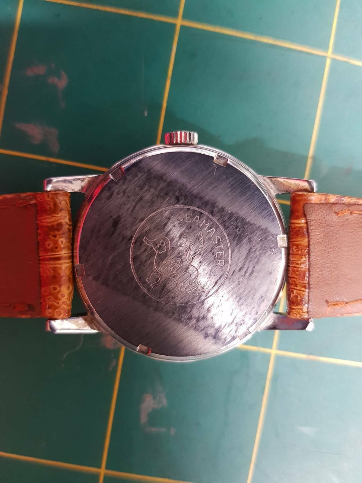

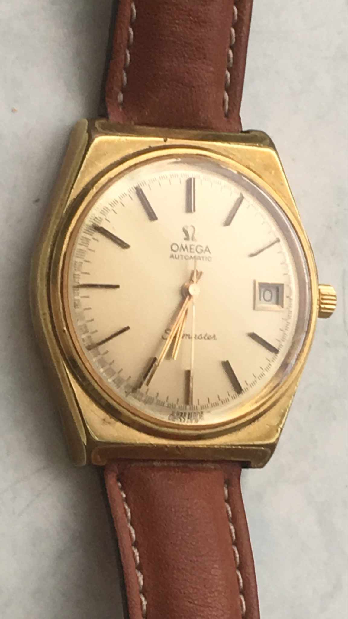

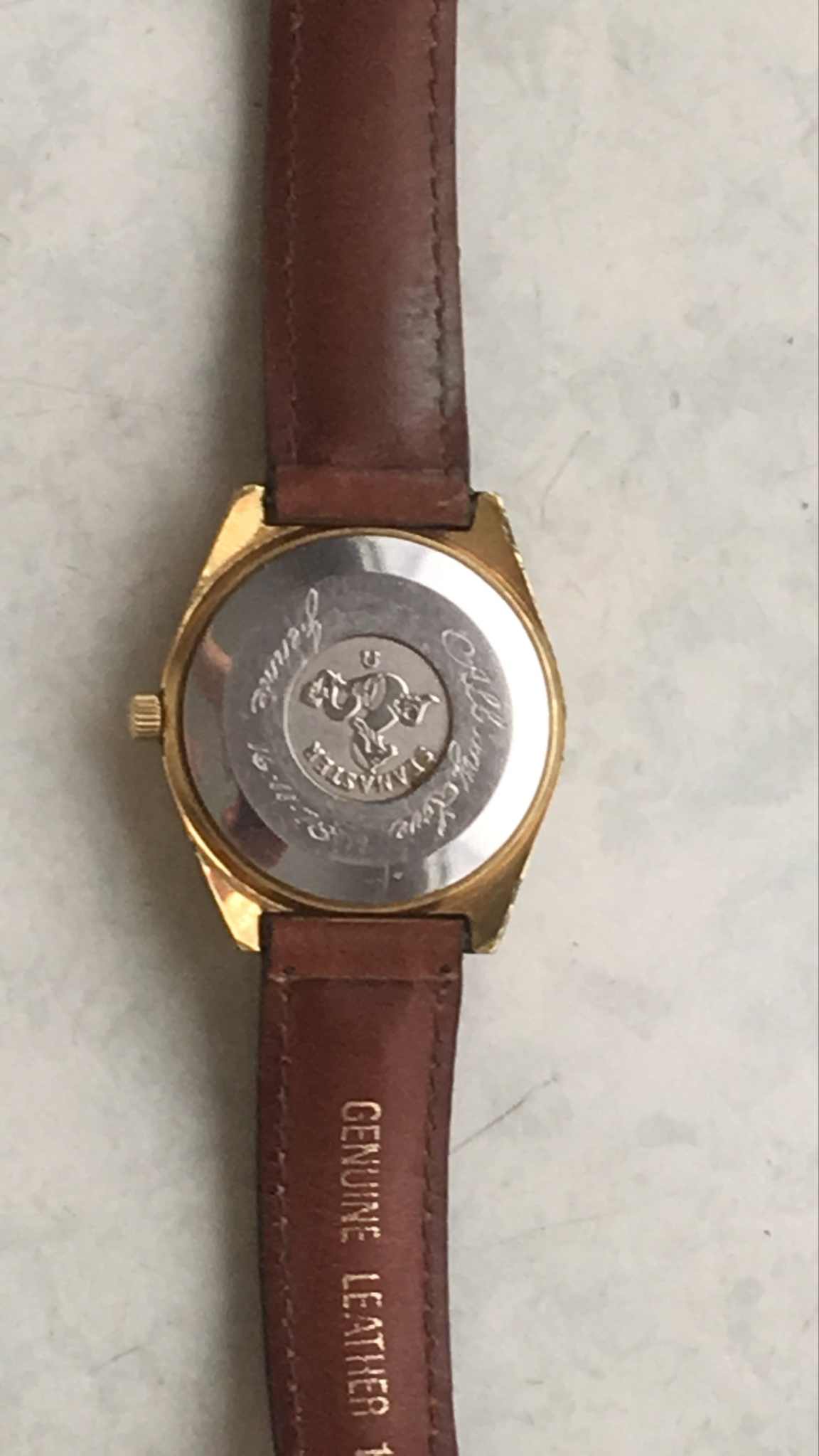

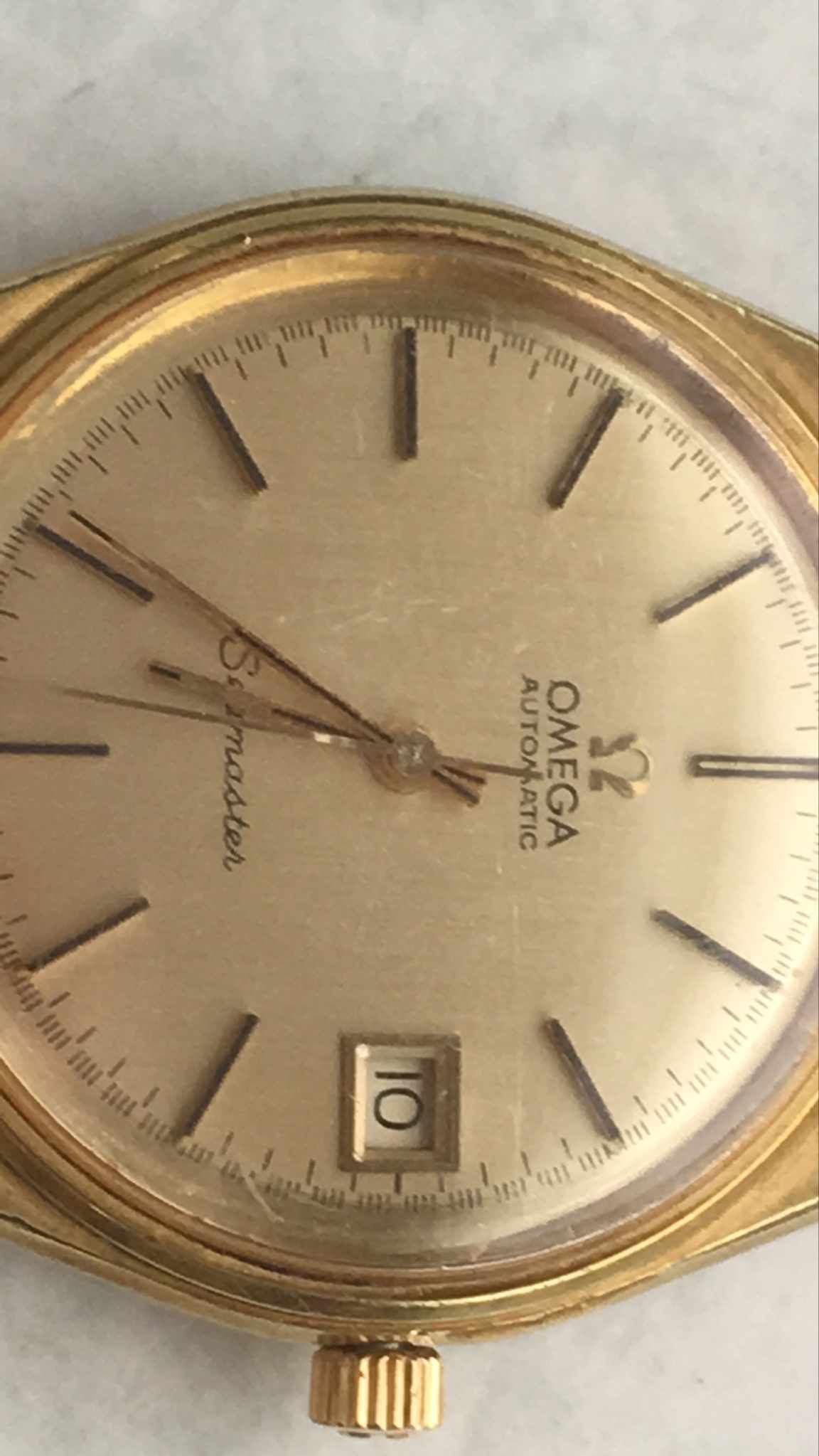

Hi, I have 2 watches that I want to buy but I only have photos atm. I was wondering if they are authentic and worth the price point according to these photos. I'm considering buying one of these. Sorry about the quality of photos these are from the dealers.
Edit: I've added clearer photos of the second watch.

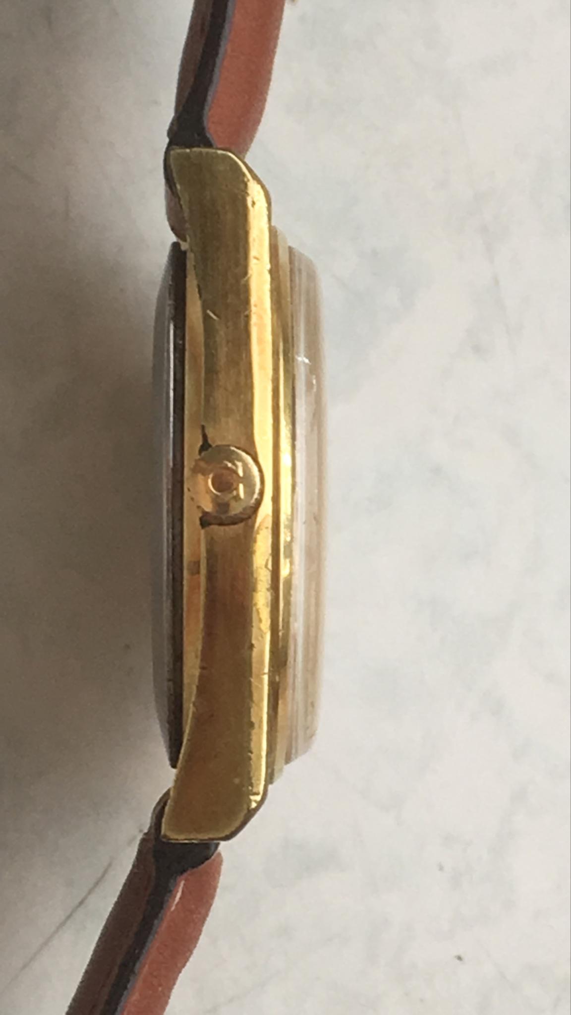

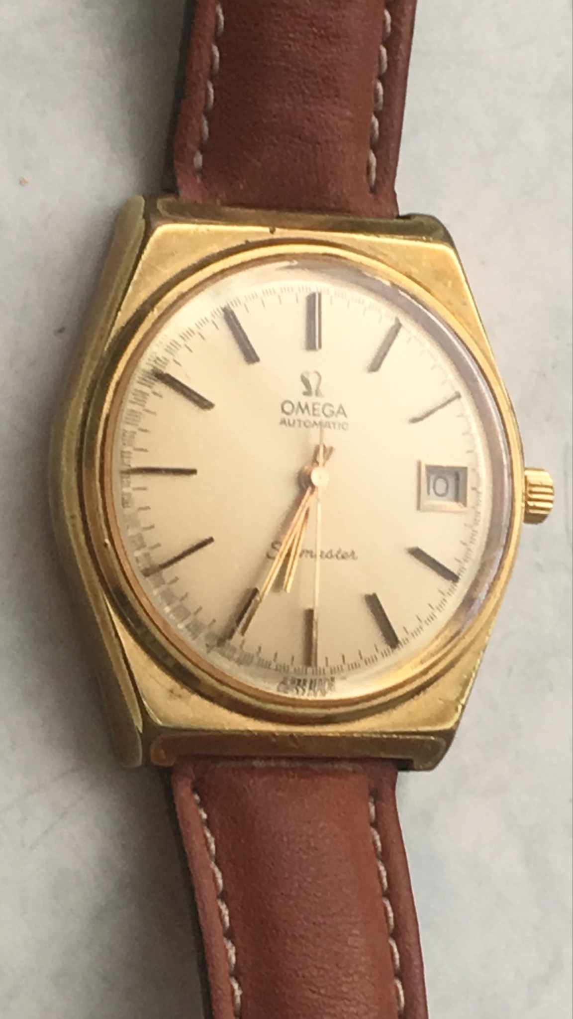

The first one is from a seller who received his Omega Seamaster in 1978 for his birthday. He isn't sure about the model type etc.. but it seems like the man is legit, he is an old man on a legit site (spoke to him over the phone). This one is going for $500 USD

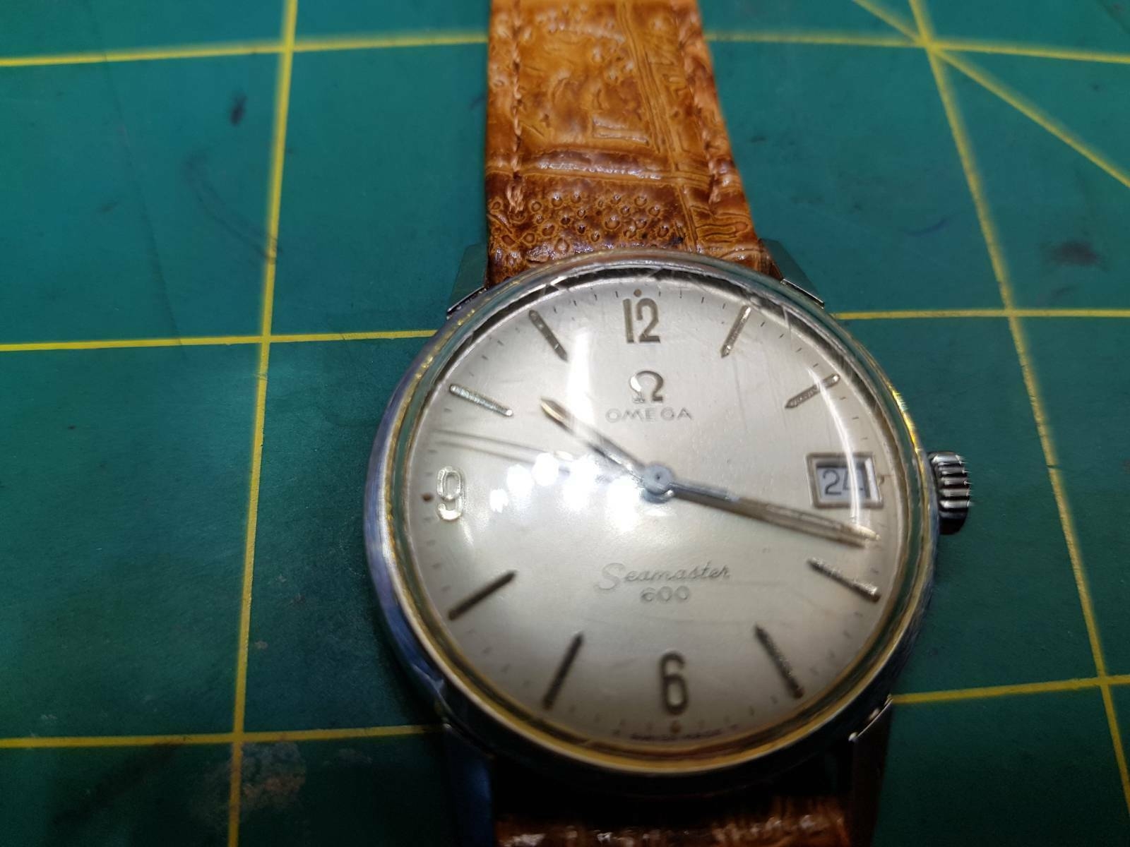

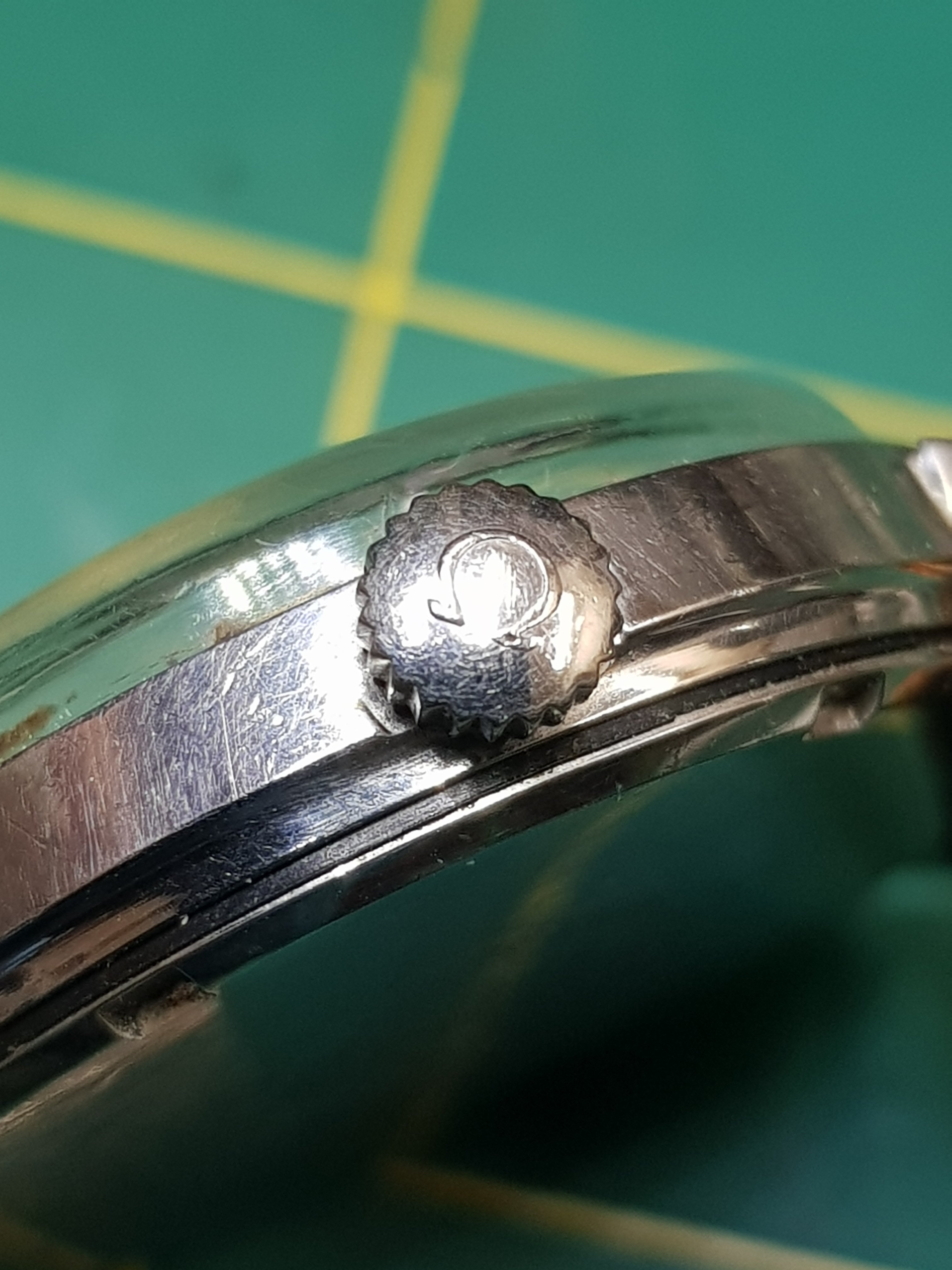

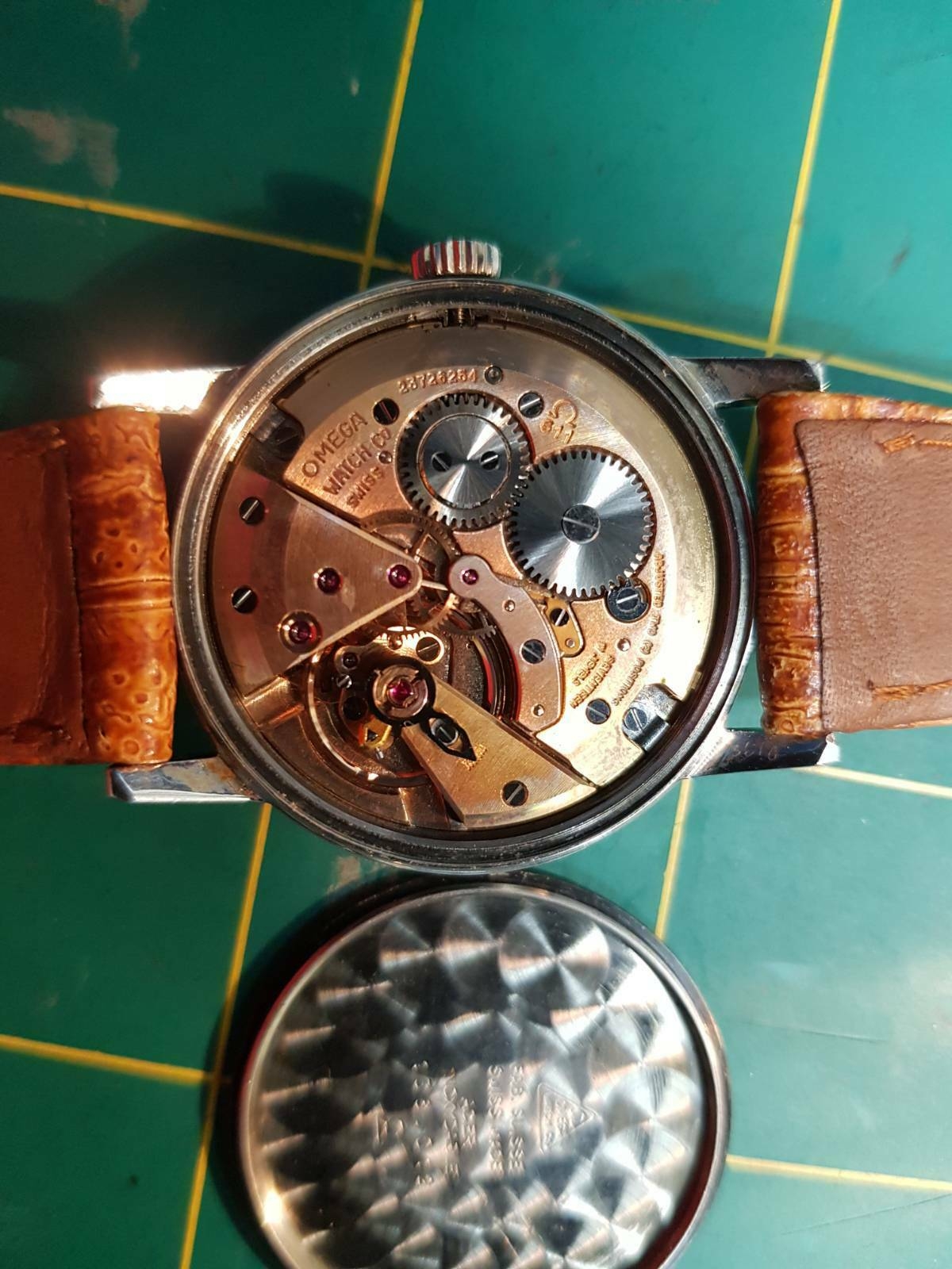

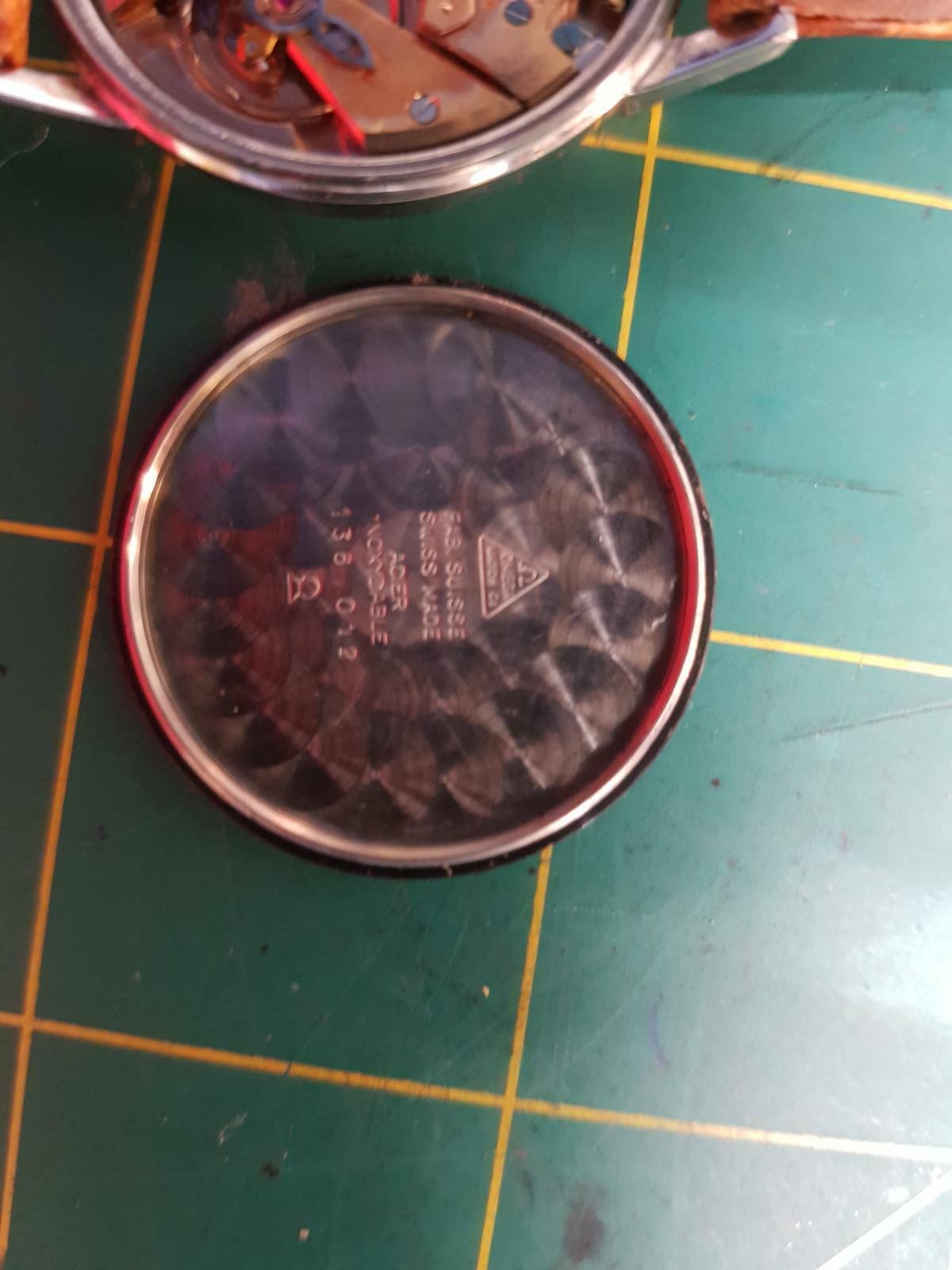

The second one is a Omega Seamasters 600 featuring the 17 jewel Cal. 611 manual wind movement. They want to sell it for $545 USD, it's from a charity second hand store.
Thank You
81
97

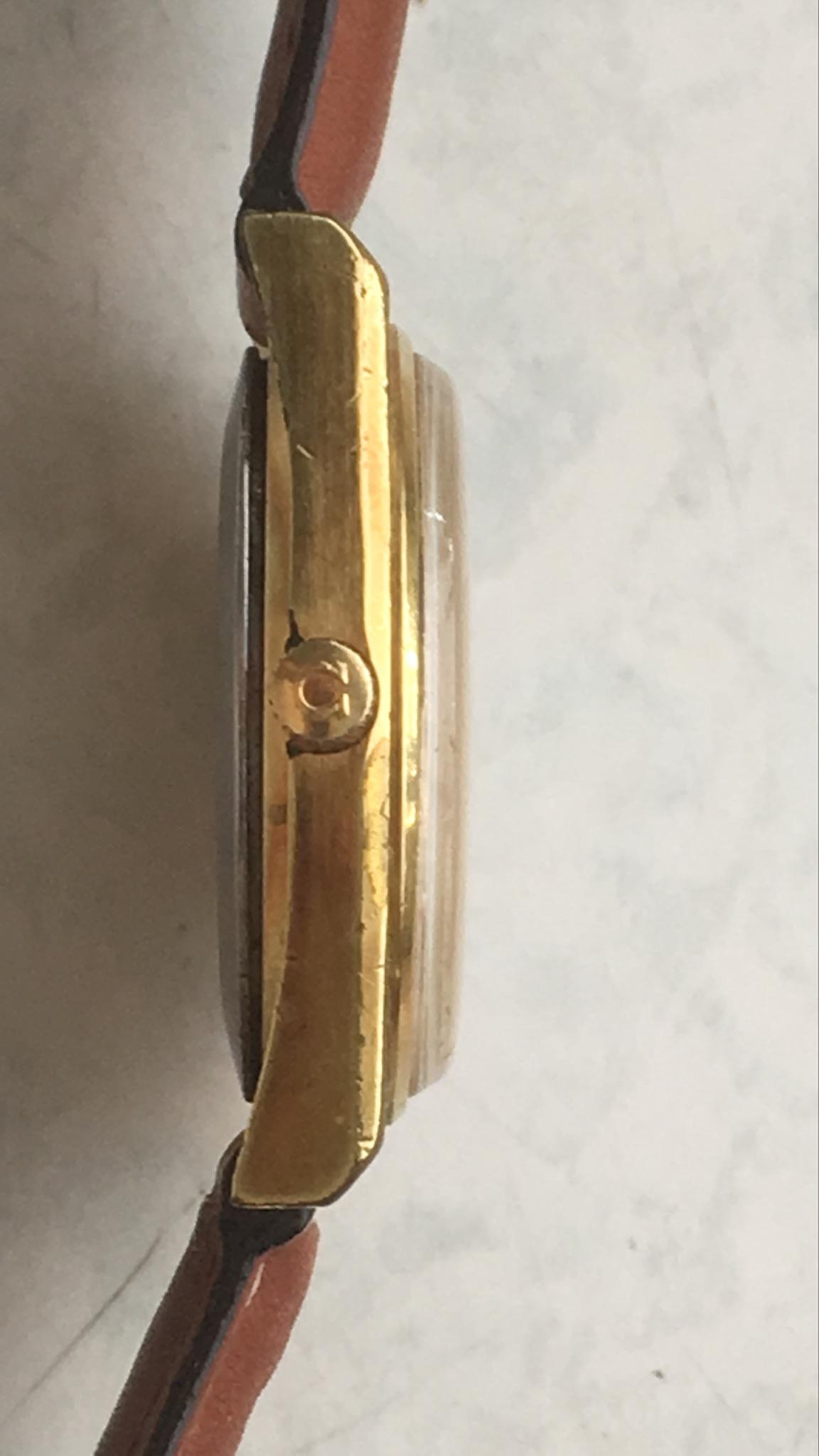

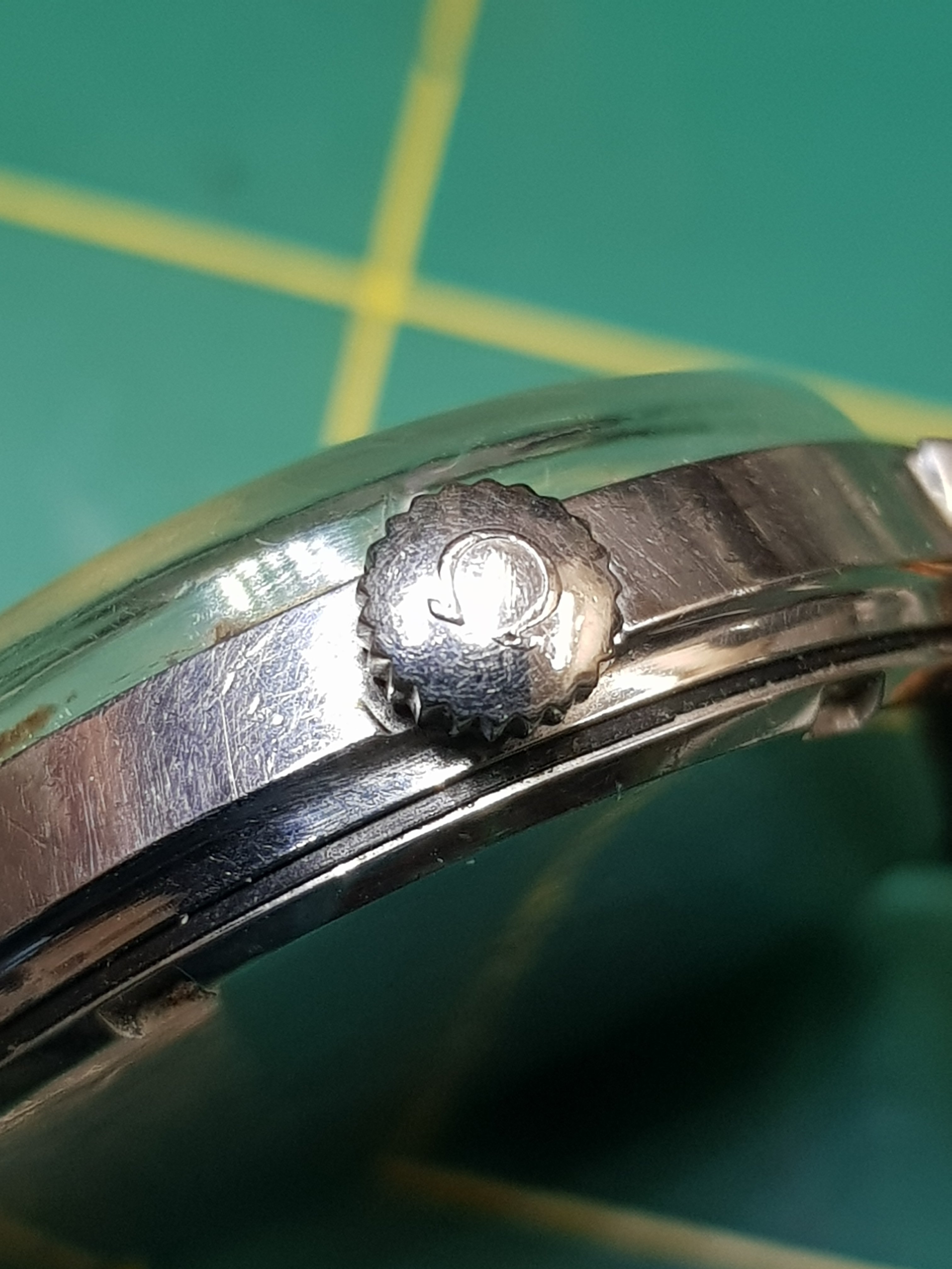

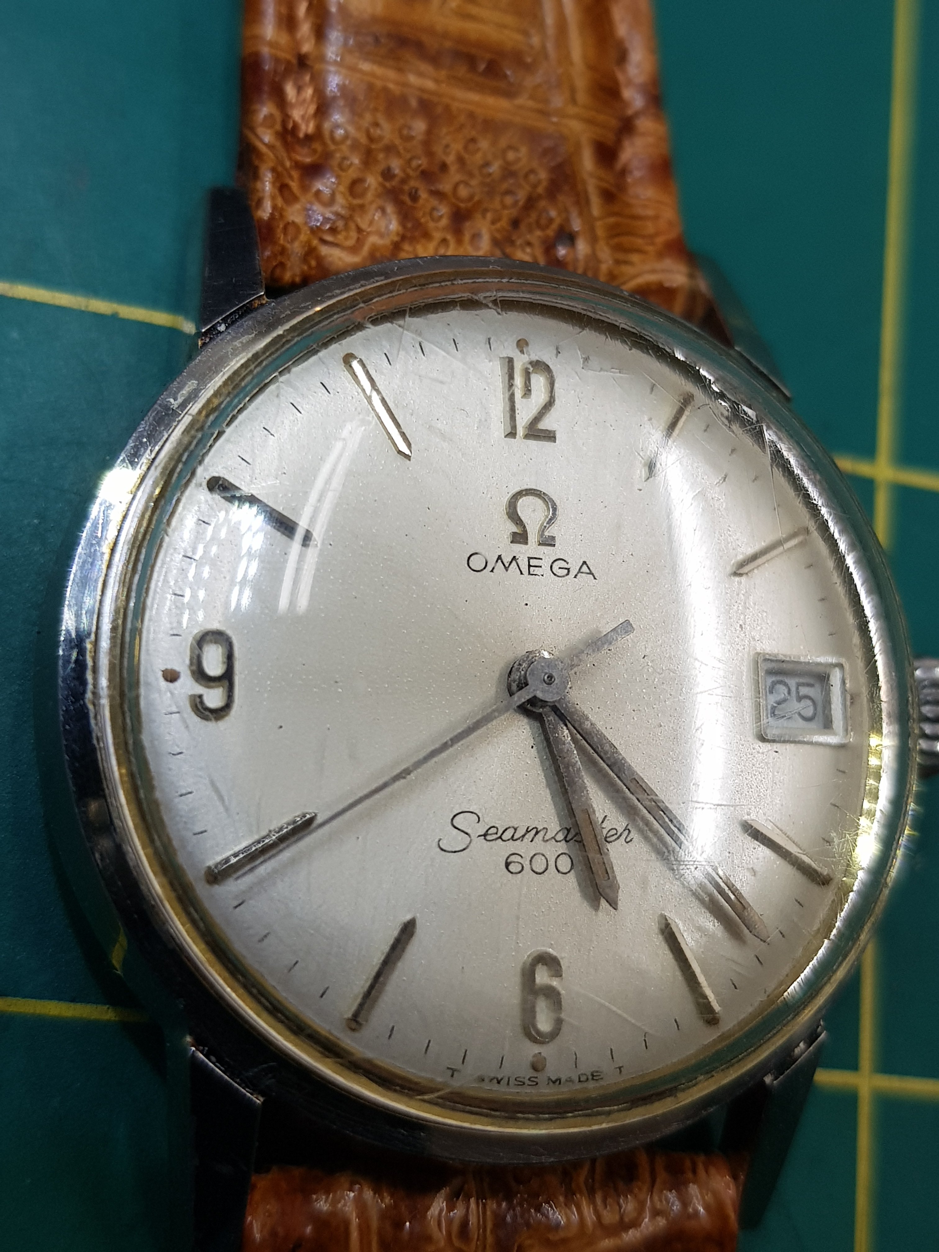

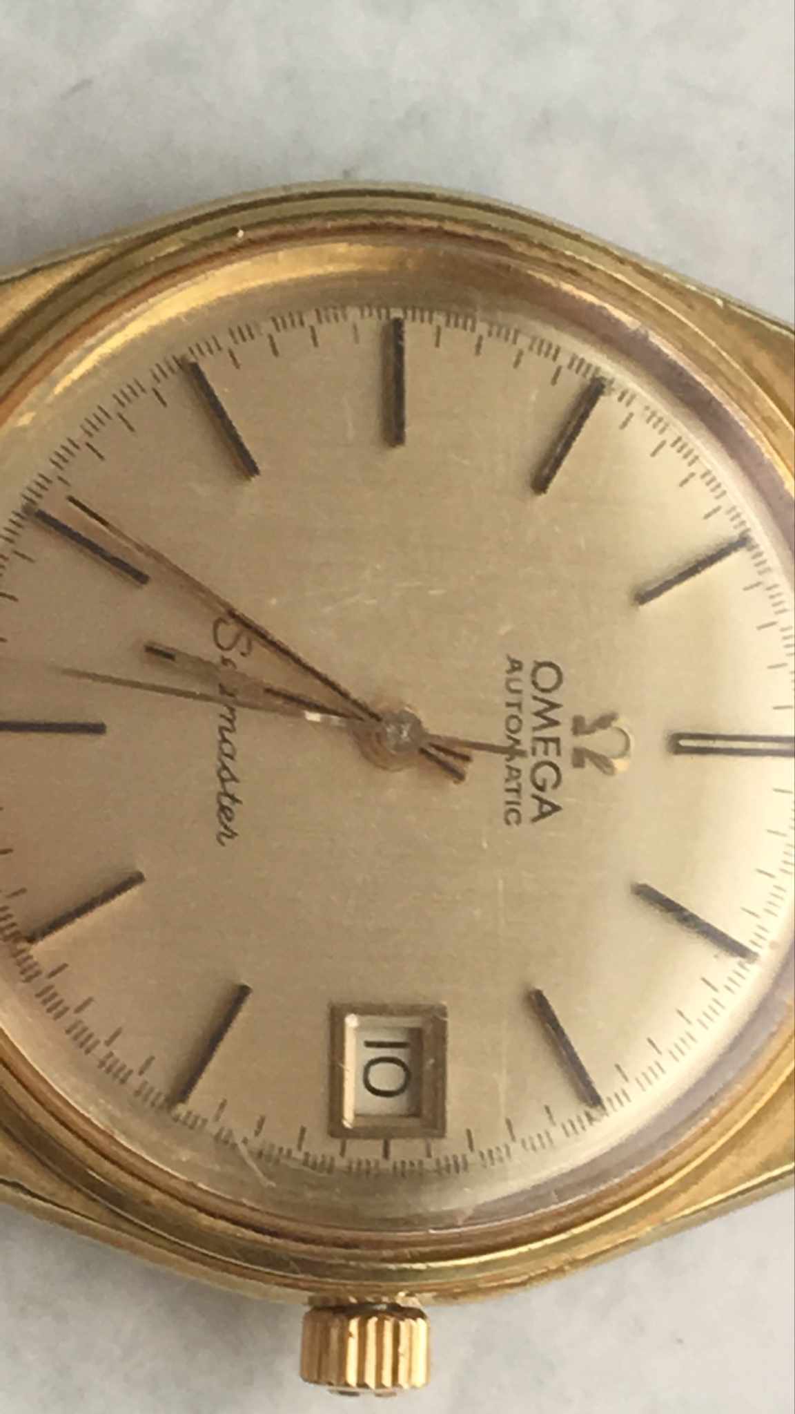

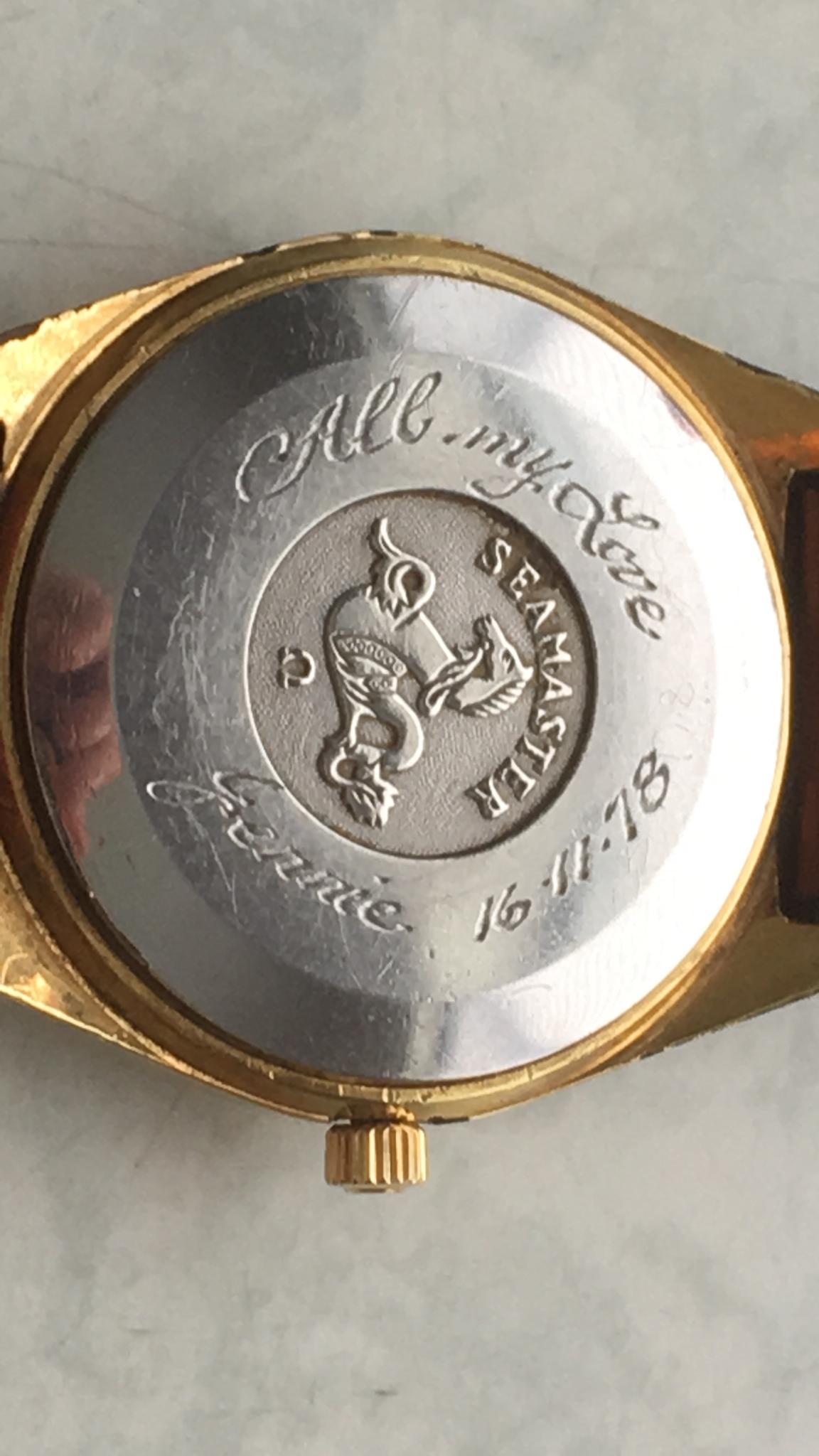

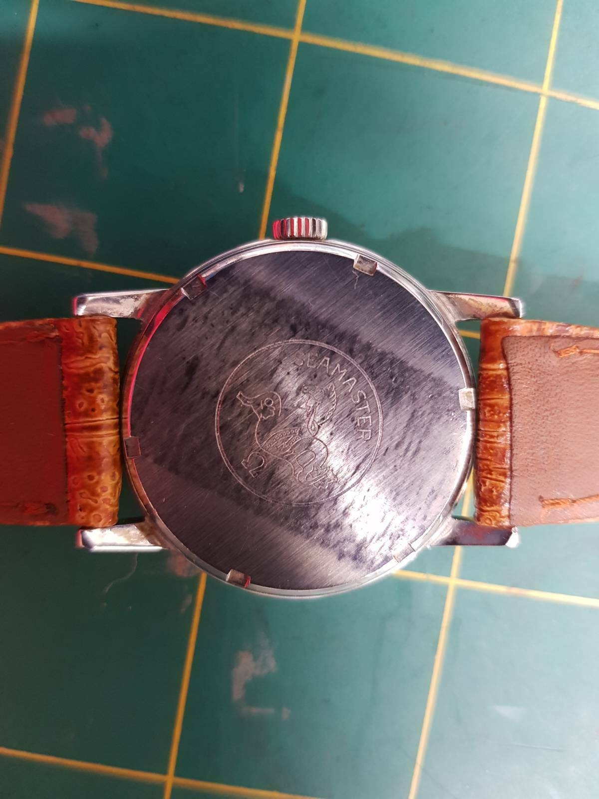

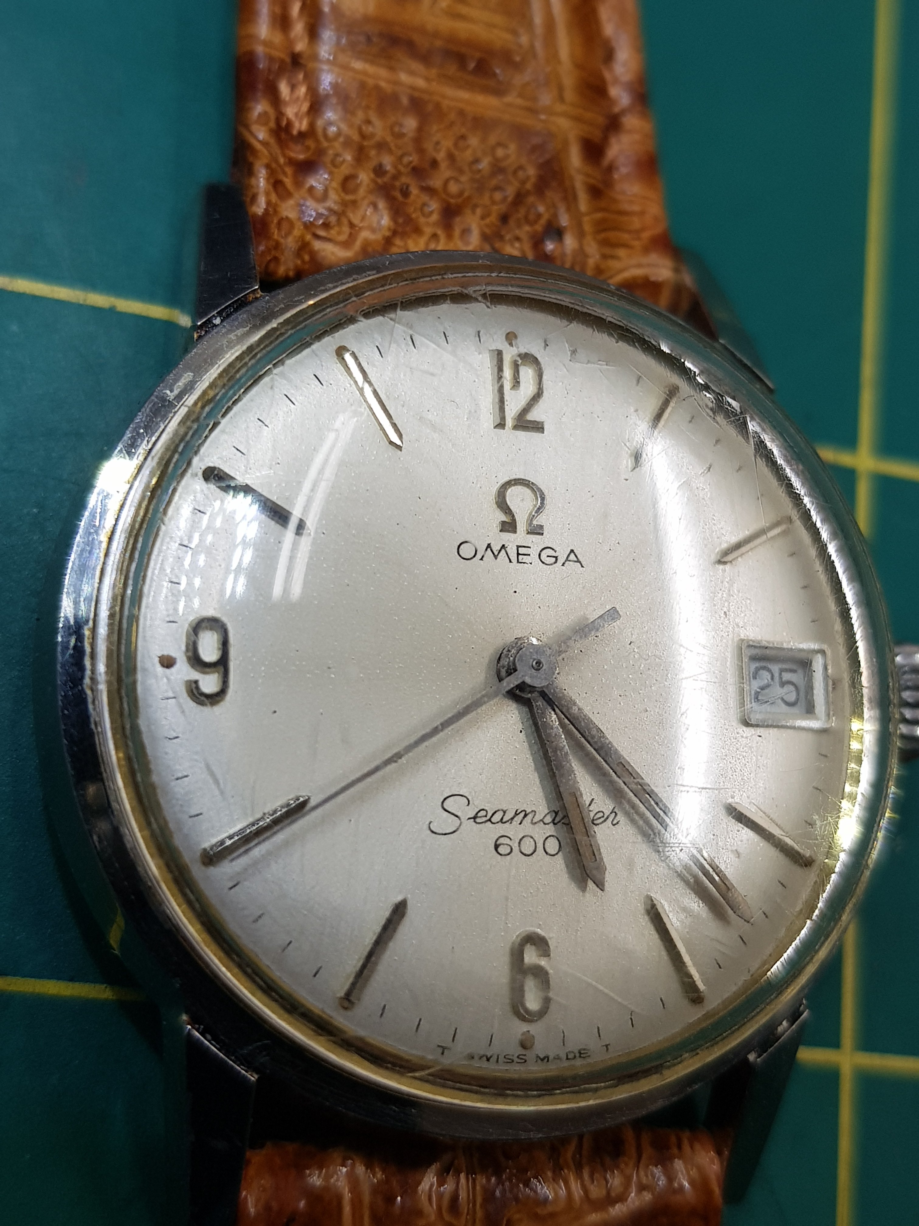

Prsonally i would pass on the first one as the case is in a very rough shape(rounded from overpolish and beaten up).
But the second one looks legit to me: the case is still sharp, the dial looks to be original although you should definetly ask for better quality photos if you plan on purchaising it. Not sure about the hands and the movement is a manual wind workhorse.
Agree. Both watches are original, for what I can tell on these pictures, but have seen better days.
First has been over polished badly, just look at the rounding on all sides of the case. Would pass on that one.
Second one is difficult to grade based on these pictures. $545 seems a little high, but charity is always a good way to spend your money 馃槈
PS not a Seamaster expert by any means
Really appreciate your reply! I've added 2 new photos which shows the watch dial clearer and also the side view.

I agree with the general assessment: pass on watch #1 and watch #2 is a good example. If you decide to buy watch #2, be prepared to spend several hundred dollars to get it into serviceable condition. If you can tell us where you鈥檙e located, we may be able to recommend a watchmaker in your area who specializes in servicing vintage watches. Regarding your second question, many of Omega鈥檚 vintage calibers are excellent movements, particularly the 30 mm calibers (eg, the 200 series) and the 500 series chronometer certified calibers (eg, 551, 561). I have several vintage Omegas from the 1950s and early 1960s that keep time within 5 seconds per day. The key is regular servicing every 5 years or so by a qualified watchmaker.
