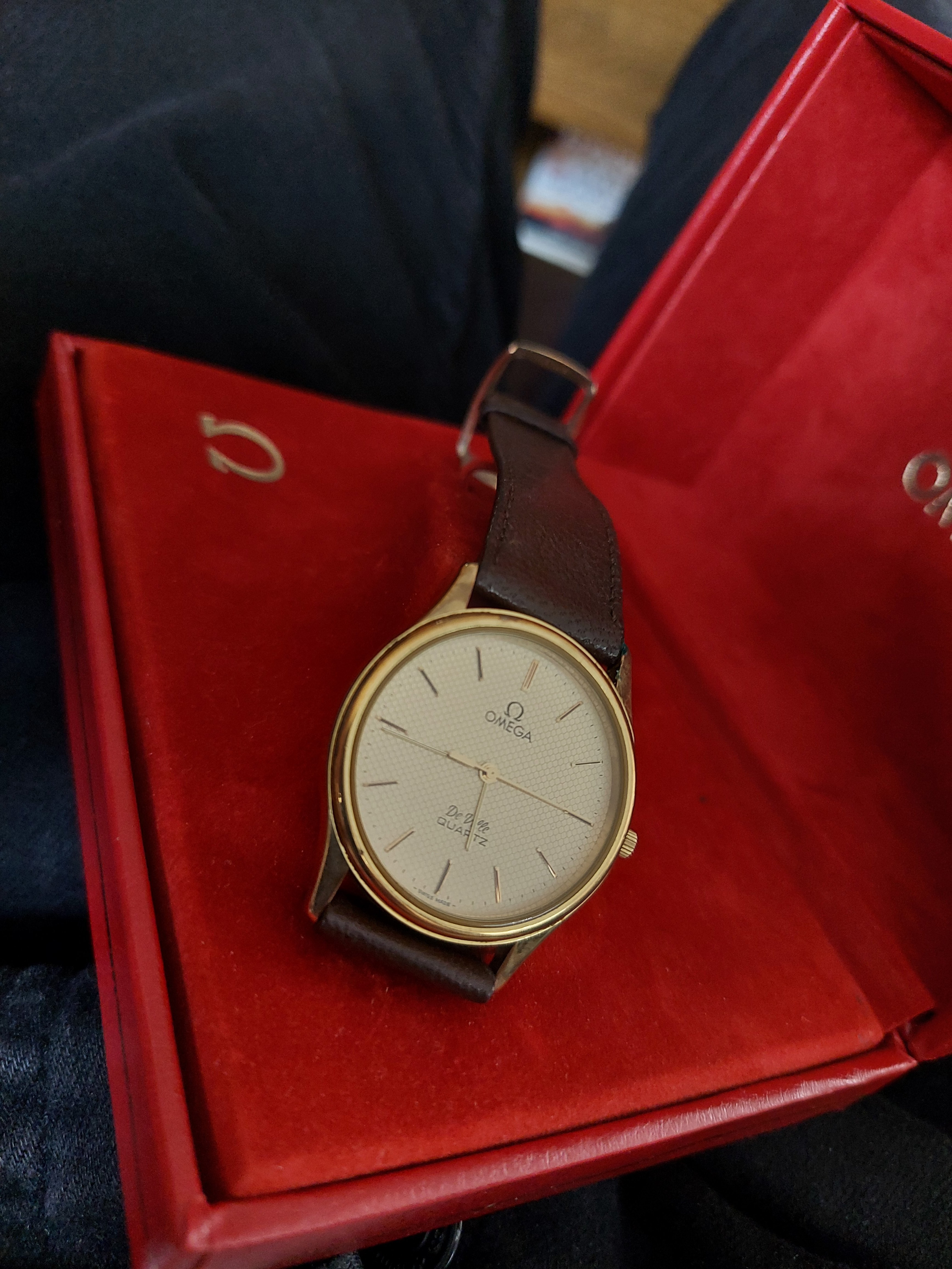

Hope its ok to reach out here? My first post, looking for some advice on a repair.
My mother has my grandfather's 1983 De Ville quartz (195.0011 I think) locked away in a non running state.
I have little knowledge of the watch, or Omega models in general.
I understand that she took it to a regular UK high St jeweller who swapped the battery.
It ran slowly for a few days and then stopped. She returned it to them, who confirmed the battery was fine.
She does tell me that she would wear it if we could get it working.
