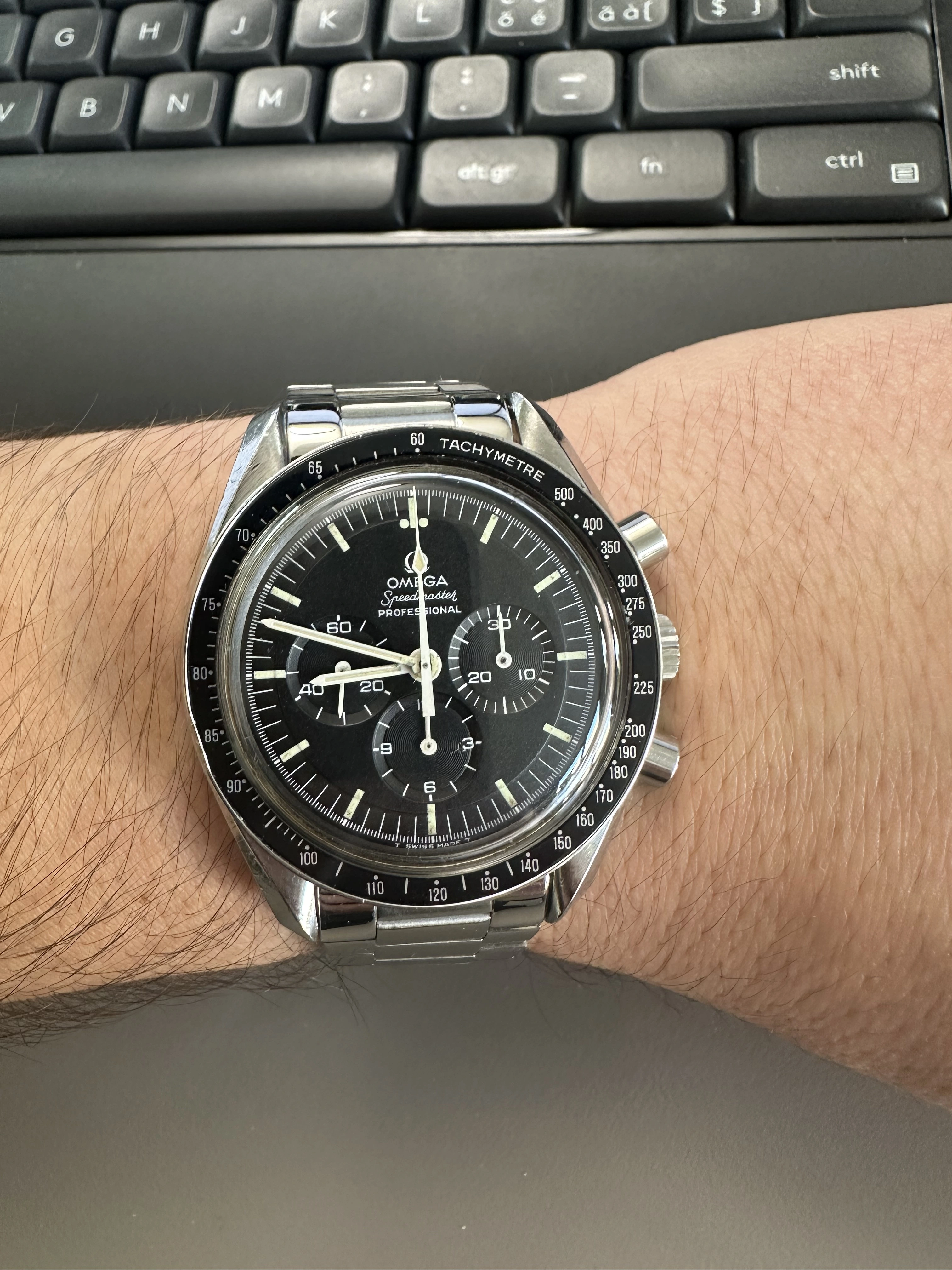

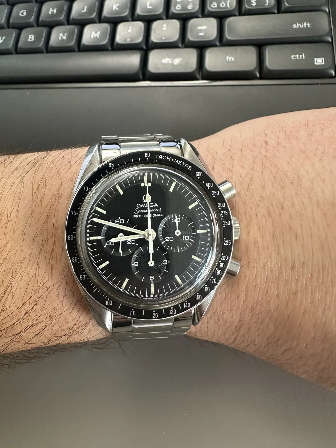

Wait... Is the watch in the photo different than the one used to write up all the issues? Geeze, I was expecting to see a total basket case versus a typical early '70s Speedmaster.

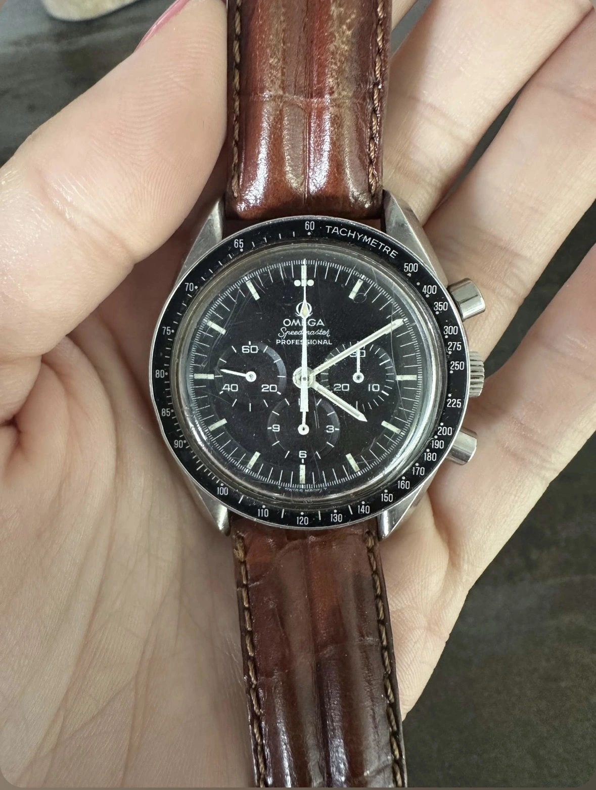

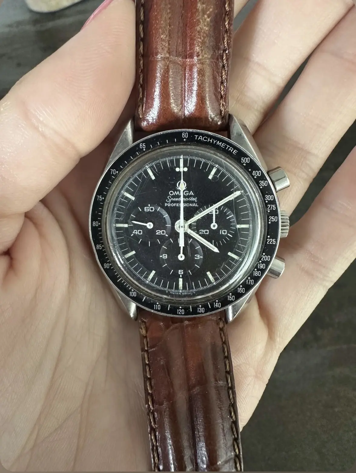

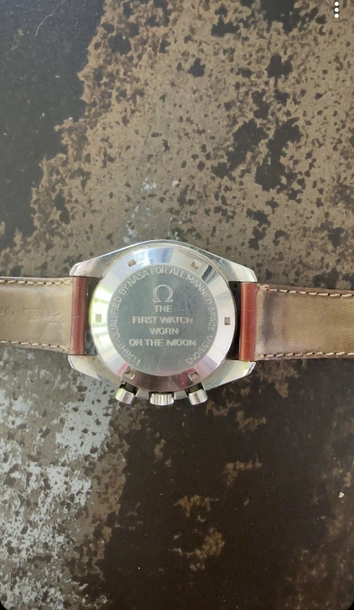

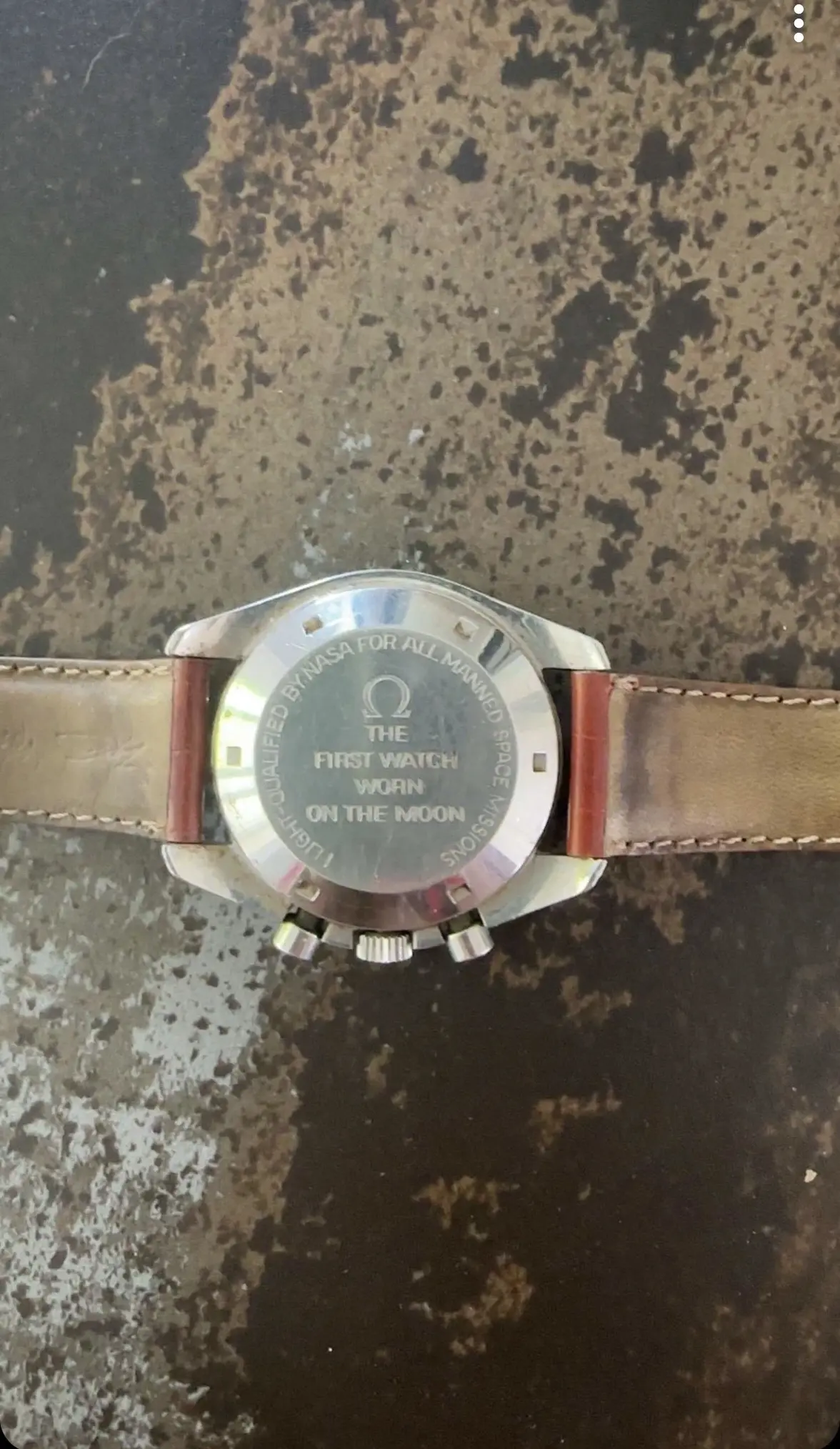

Some pictures before I cleaned it myself.
