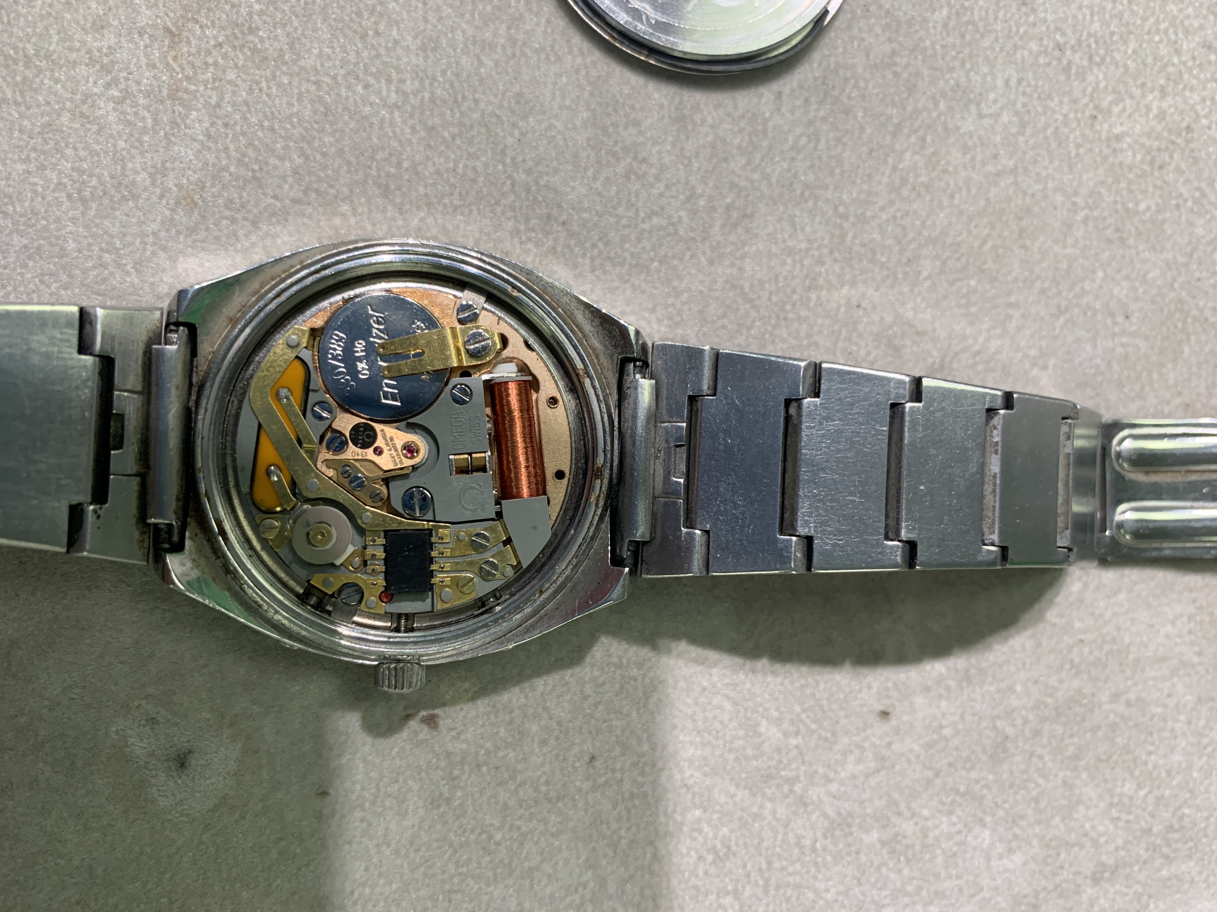

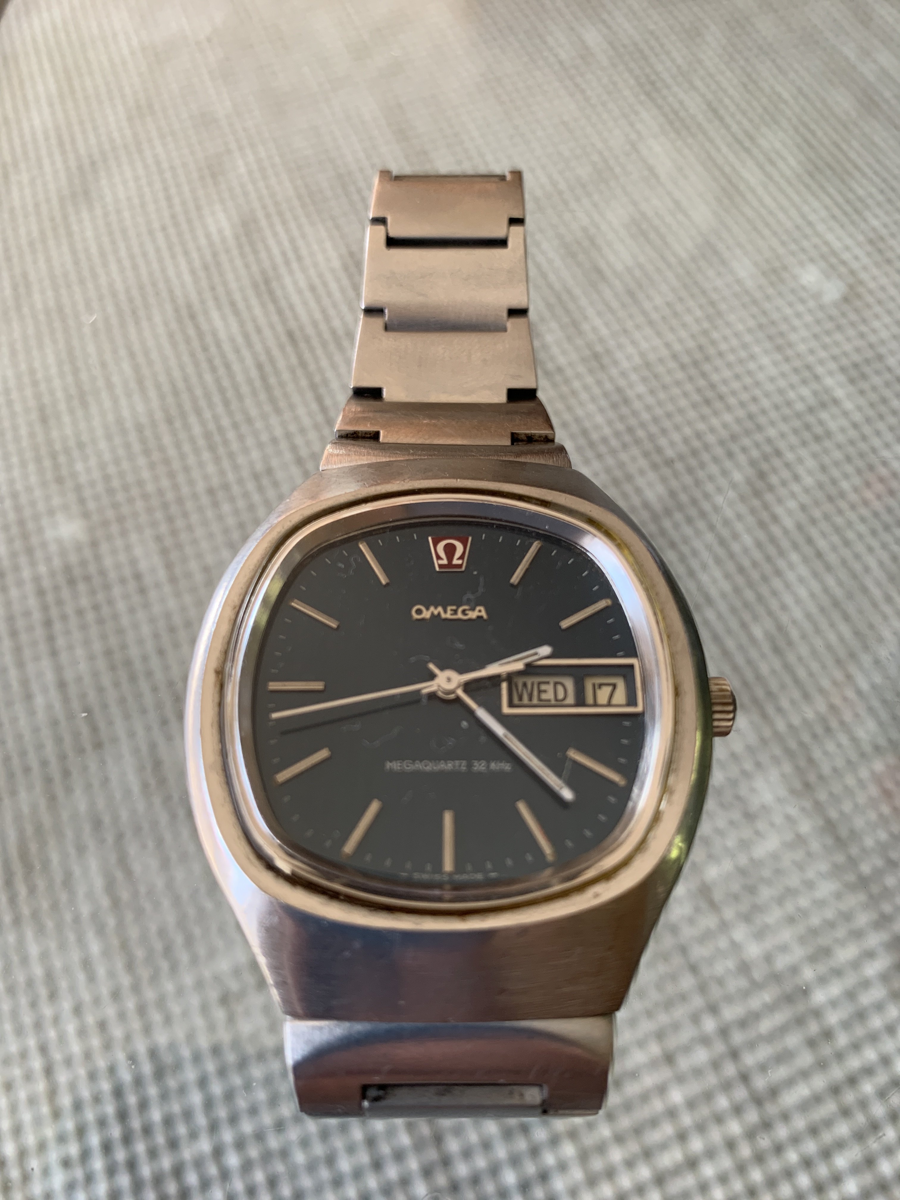

I received this watch as a gift from my father-in-law and plan to give it to my son as a graduation gift. I have no intention to sell it but was hoping to learn more about it. It is currently not working so I’d also like to hear about best approach to repair/restore it.
It was bought in Switzerland in 1973 or 1974. It worked when I got it. The battery subsequently died and was replaced at a jewelry shop. It worked for about two weeks afterwards and then completely quit. That is the only time it’s been opened up while I’ve had it and per my father-in-law it’s never been serviced.
There are a dozen very similar models but I’ve only found a few very brief references to this specific model.

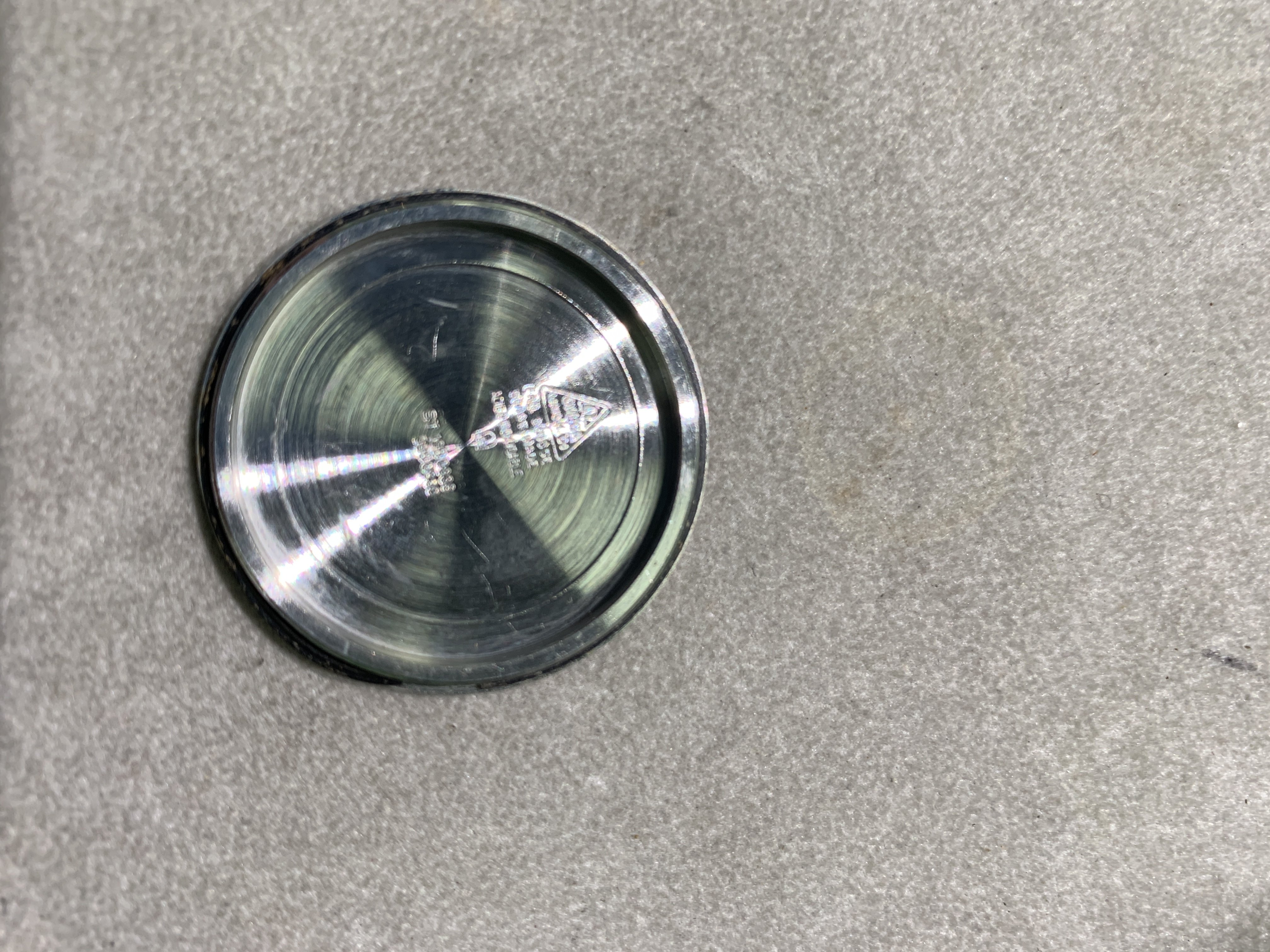

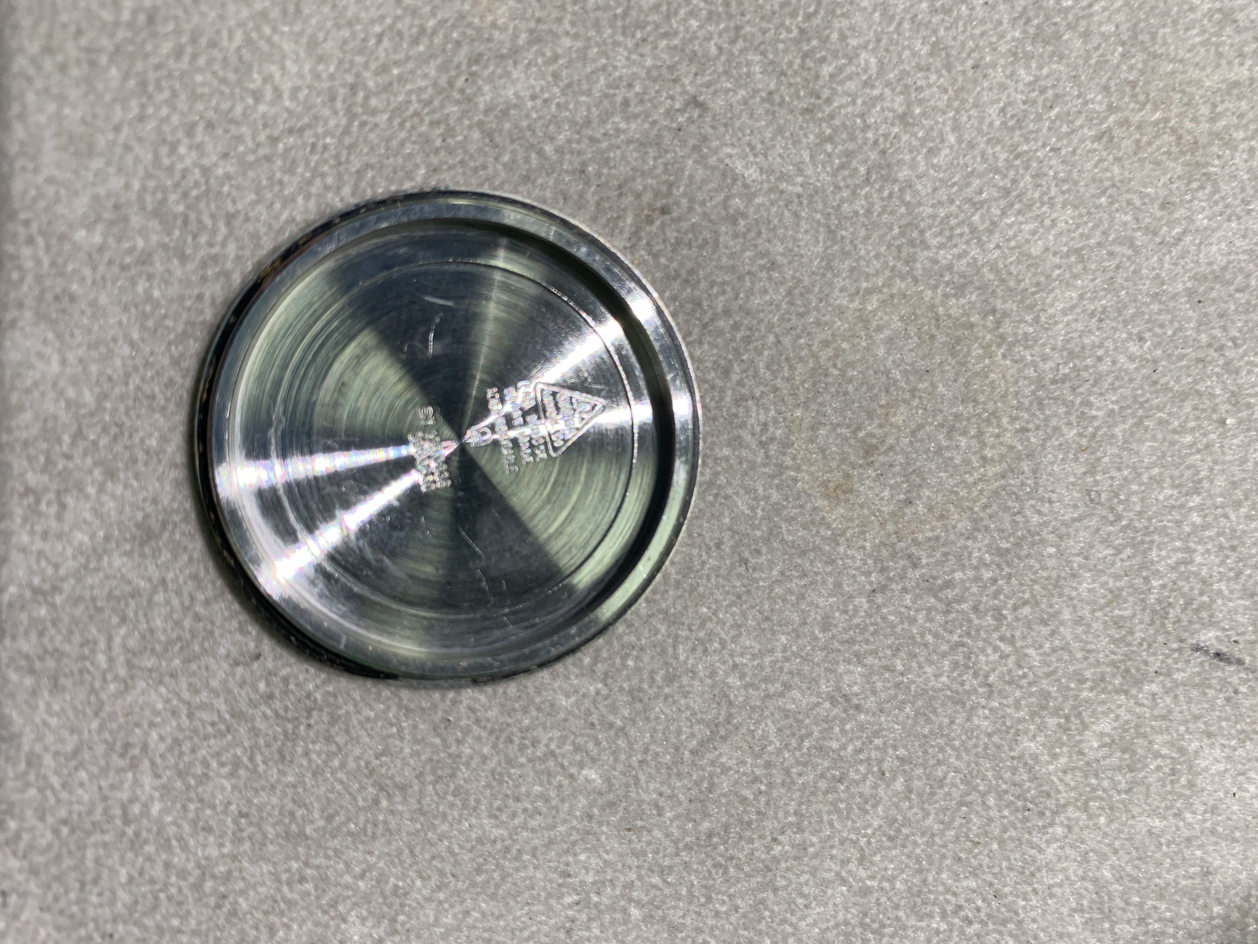

Well I got a few different estimates. A certified Omega repair place quoted me 865 USD to repair. Omega would charge 550 USD to send back to Switzerland. They noted that they would replace or fabricate parts. They’d also send back all parts removed.

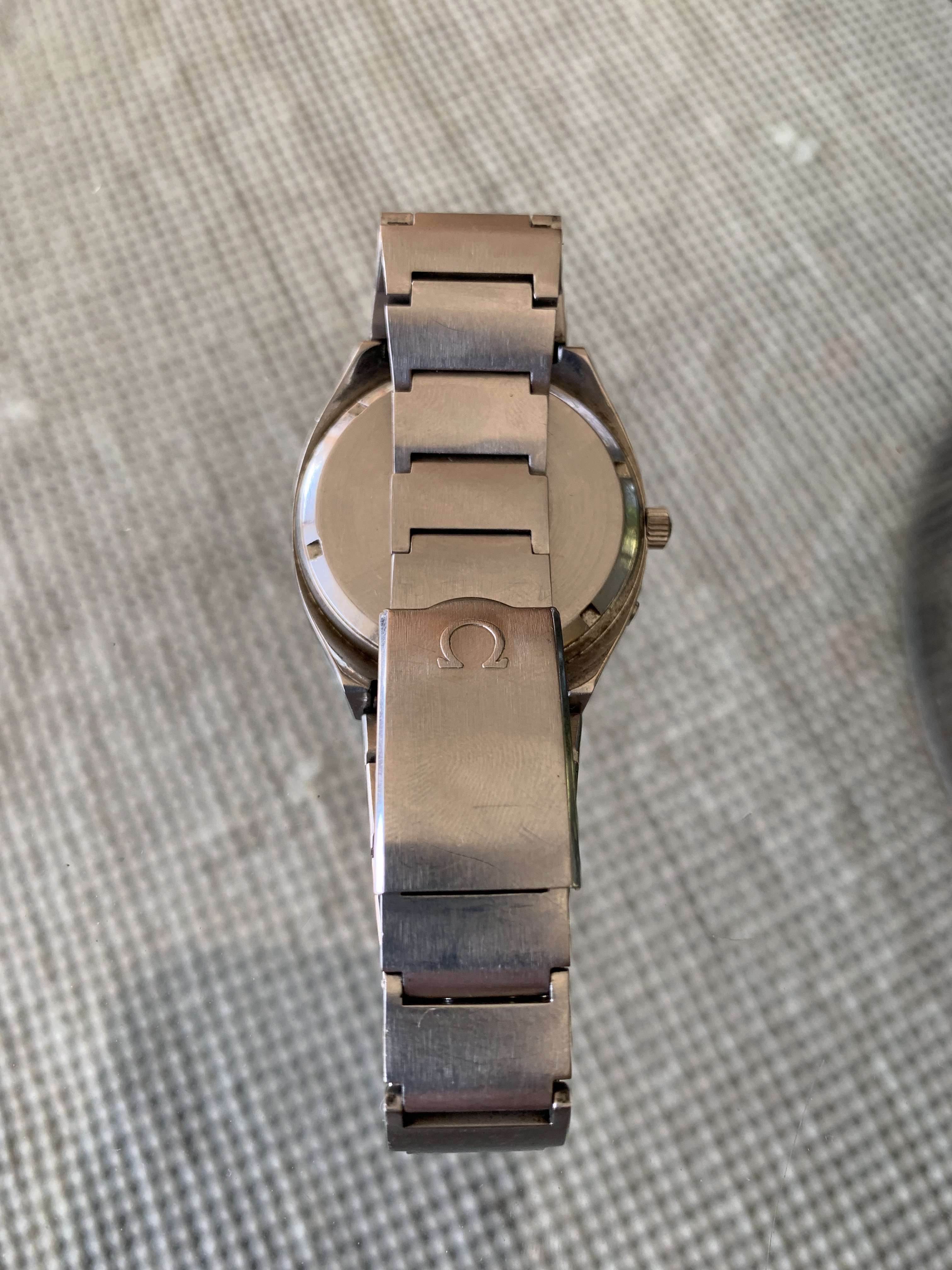

I photographed the back and even Omega couldn’t tell me what model this is. Based on my own research it appears to have been made in 1975. Can anyone tell me roughly what it’s worth? specific model? year of manufacture?

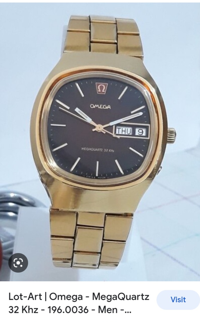

Google search omega megaquartz st196.0036 and you will find other examples for sale and have a guesstimate yourself at value based on its condition compared to others and the fact it is currently not working

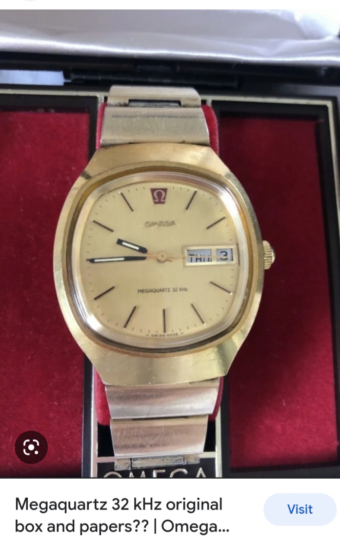

Thanks, that was very helpful. Interestingly, all of the watches that come up in that search match in every way but they carry the Geneve tag which mine doesn't have?

I have seen both in my search

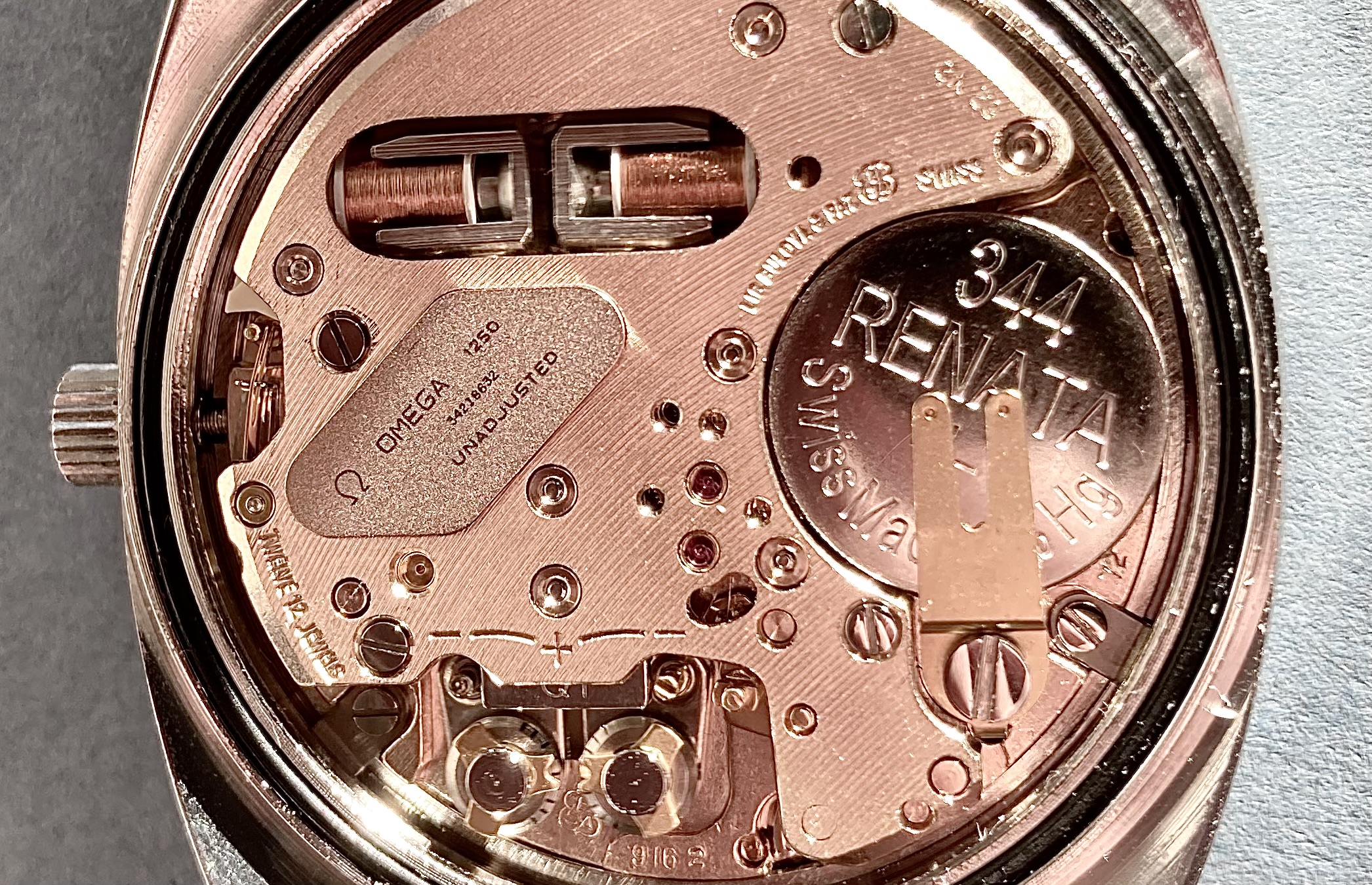

The 1310 movement uses a 386 battery, yours appears to have a 389 which is a bit thinner.

Well spotted. Some people have reported that the 389 would not work, albeit having the same nominal voltage, even when the contact is intact, due to lower capacity. I believe that @kaplan had a similar problem with his hummer.
So maybe you should try a 386 first before giving up on the movement.
