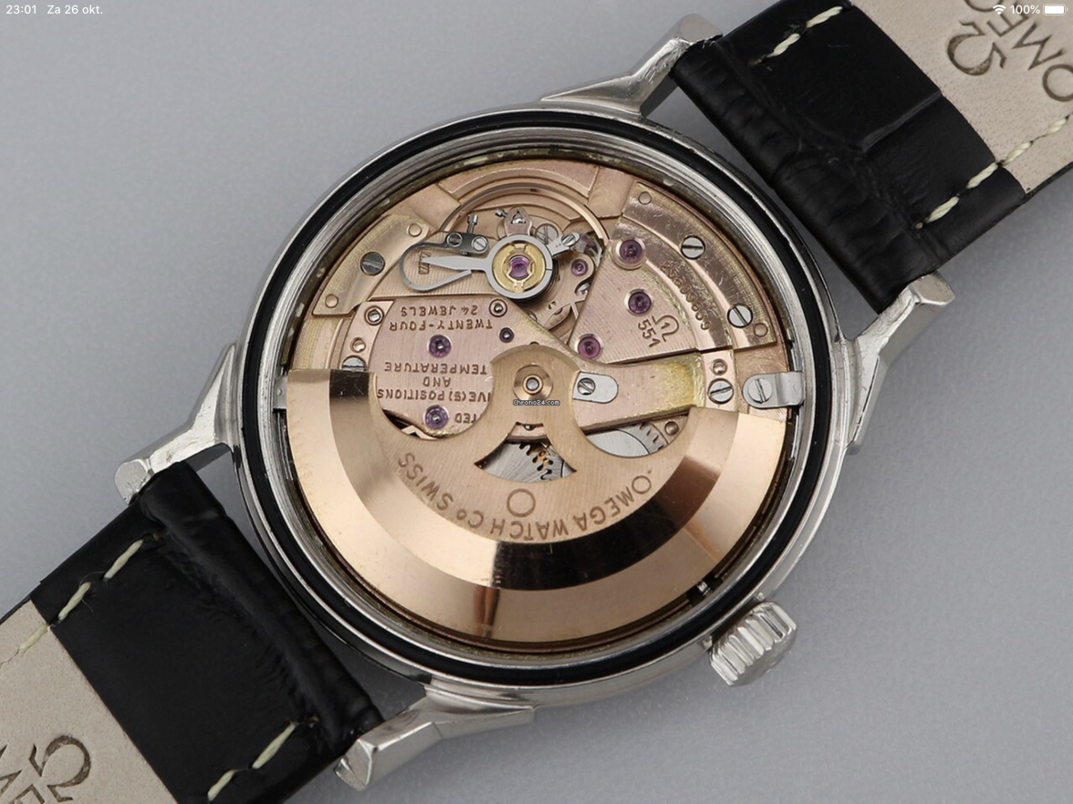

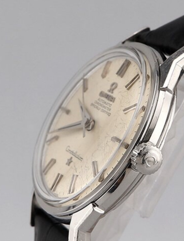

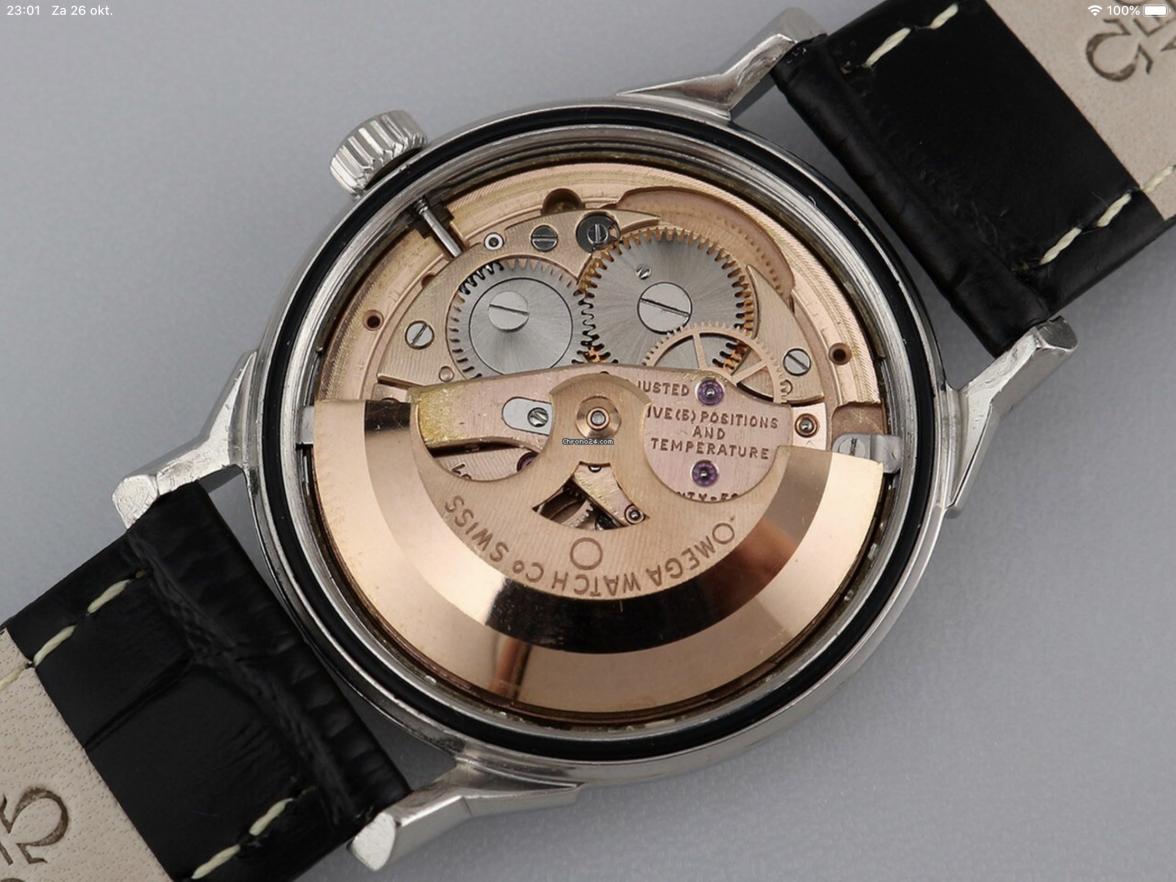

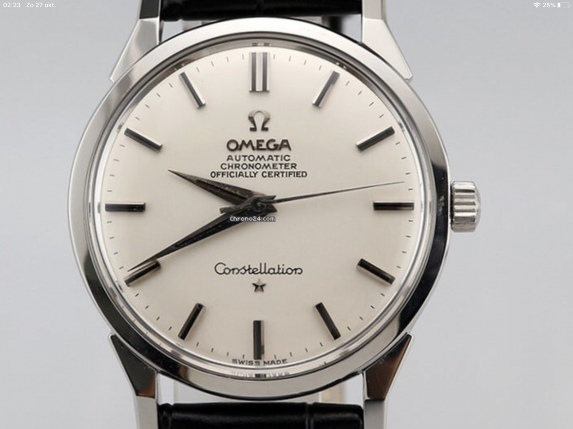

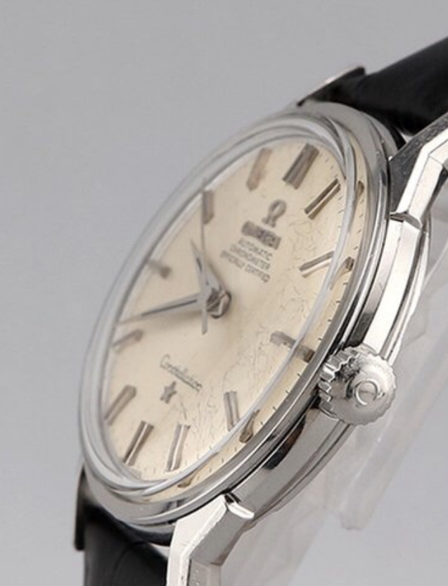

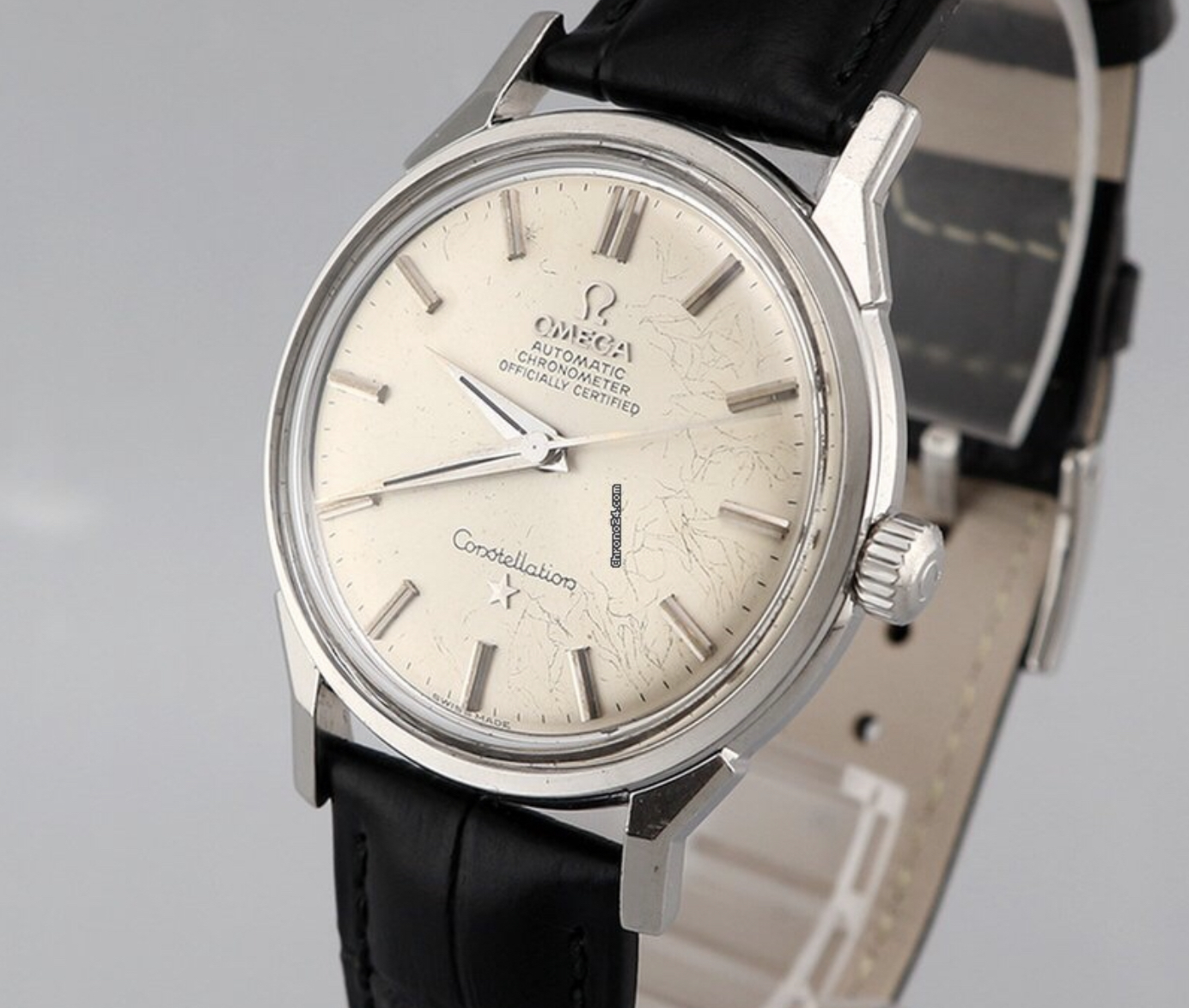

Hi there all, I am looking at this watch. See pics below. I did some research based on everything I found here and great links from here.
The watch is supposed to be 1967 which reconciles with the number (25.xxx.xxx).
The dial is clearly original with nothing painted as far is I can see.
The case I find more difficult, the facets are there as far as I can see, correct?
The glass seems like once replaced.

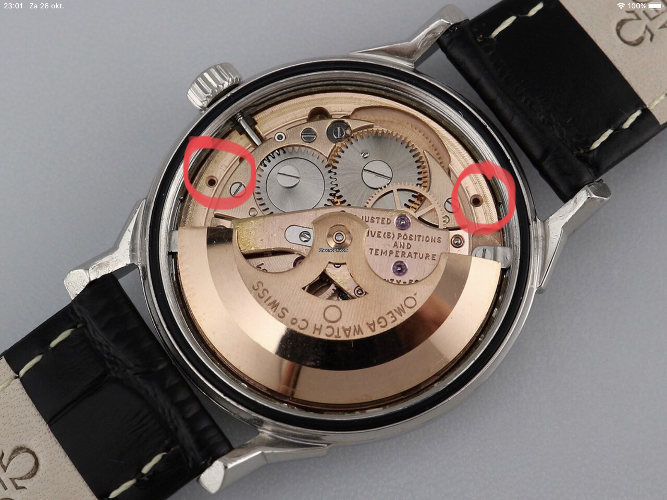

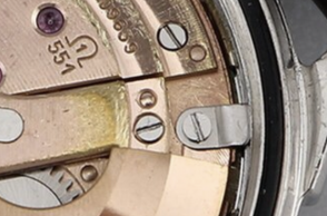

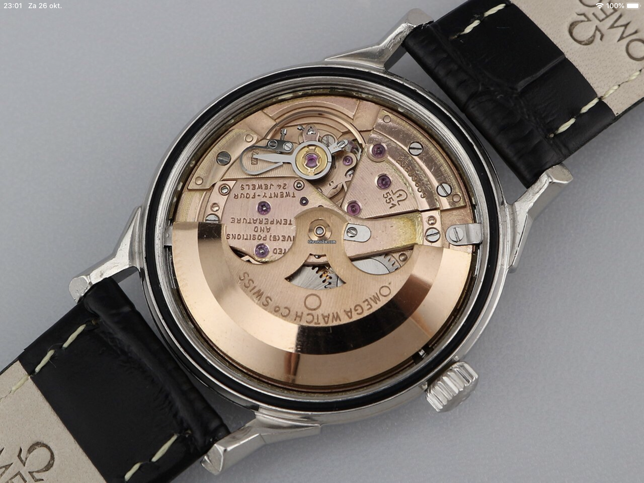

Buckle and strap far from original. Calibre 551 matching. HOWEVER, what about these two strange holes? Shouldn’t there be screws???

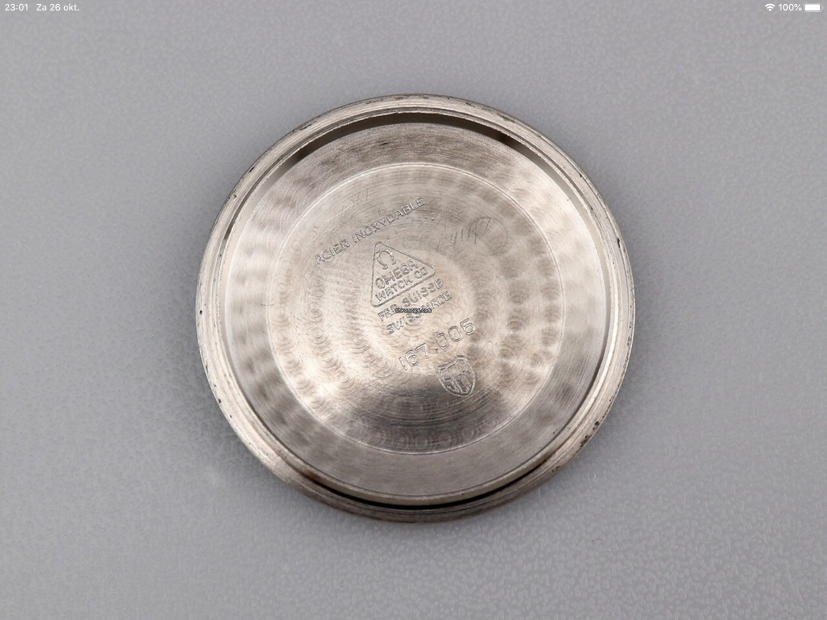

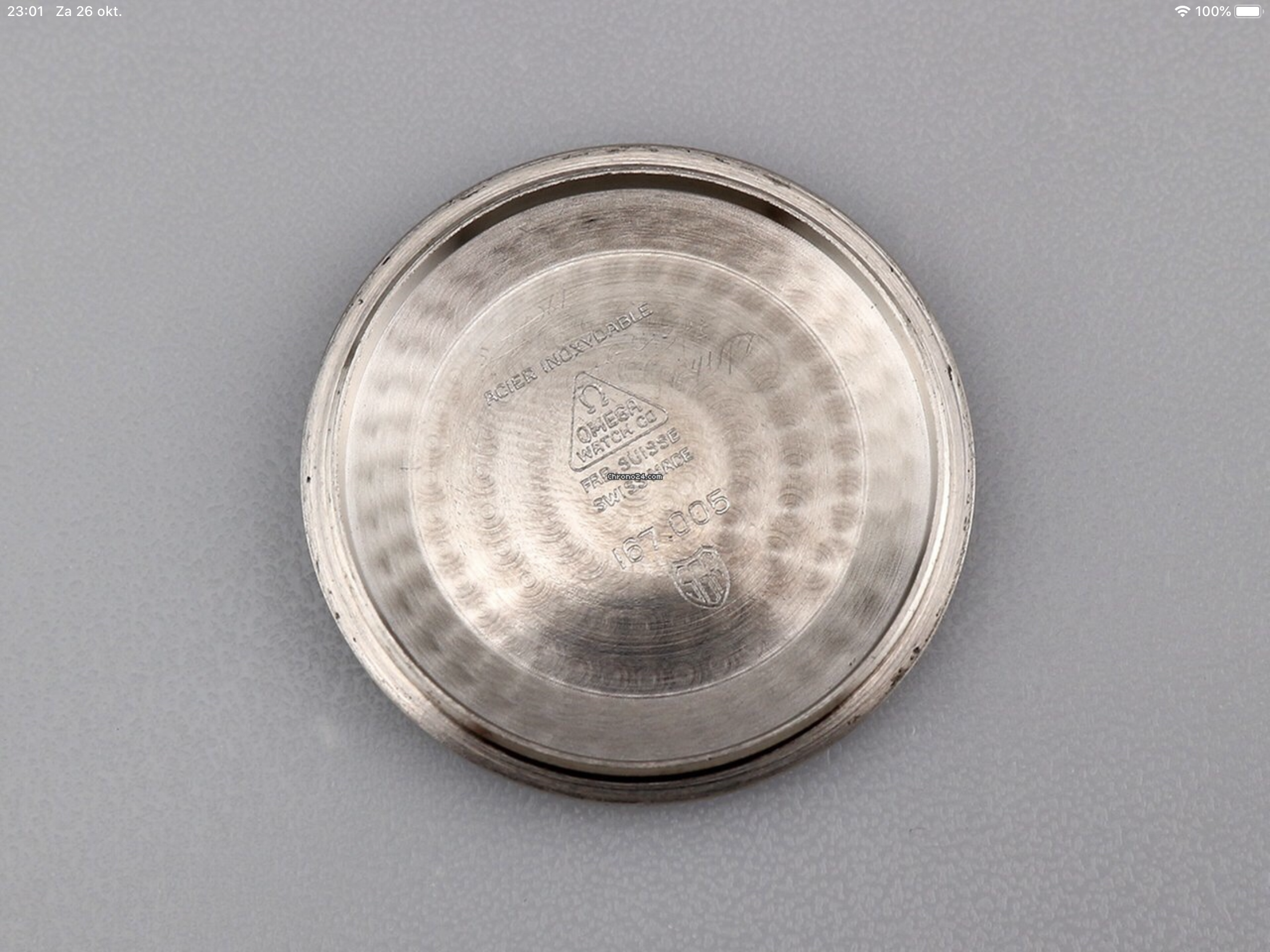

Now the back, if I read the great notes from Desmond Guilfoyle it looks like this might be fake since the machine circles are not overlapping enough.
What about the crown?
All comments on fairness of this watch greatly appreciated!!!!

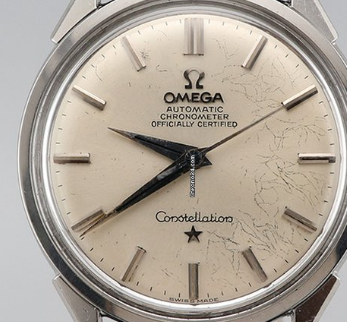

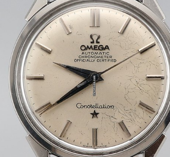

For me this one is a clear pass:
Indices without inlays???
Lines/scratching on the dial
wrong crown

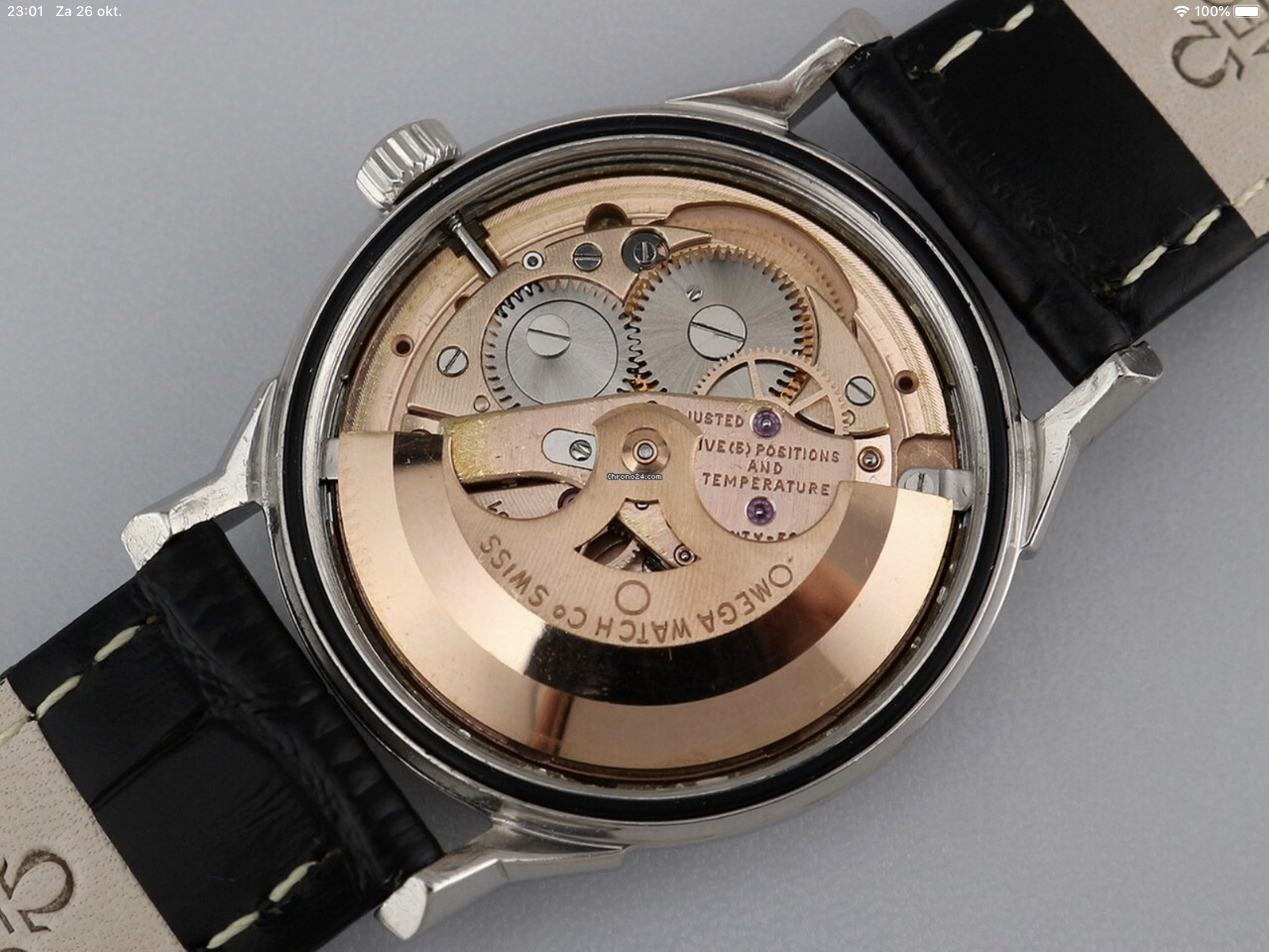

What is this:

Has the bridge been replaced 😕 the wear on it seems off from the rest of the movement.
383
349
Aha. I understand. No idea. Will ask. All these vintage omega’s are new to me but I am now so far that I need to have a 60’s constellation next to a modern Speedy. Just a matter of time......

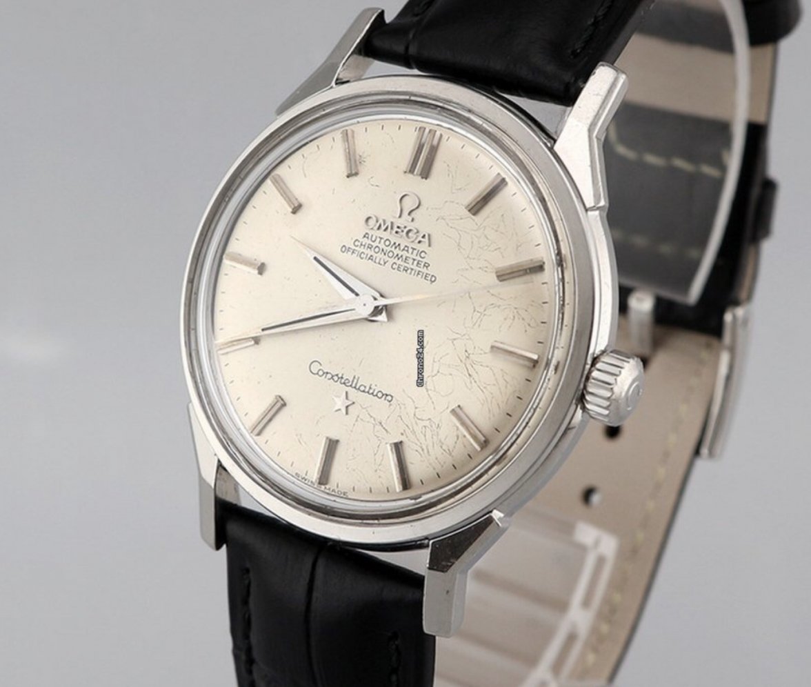

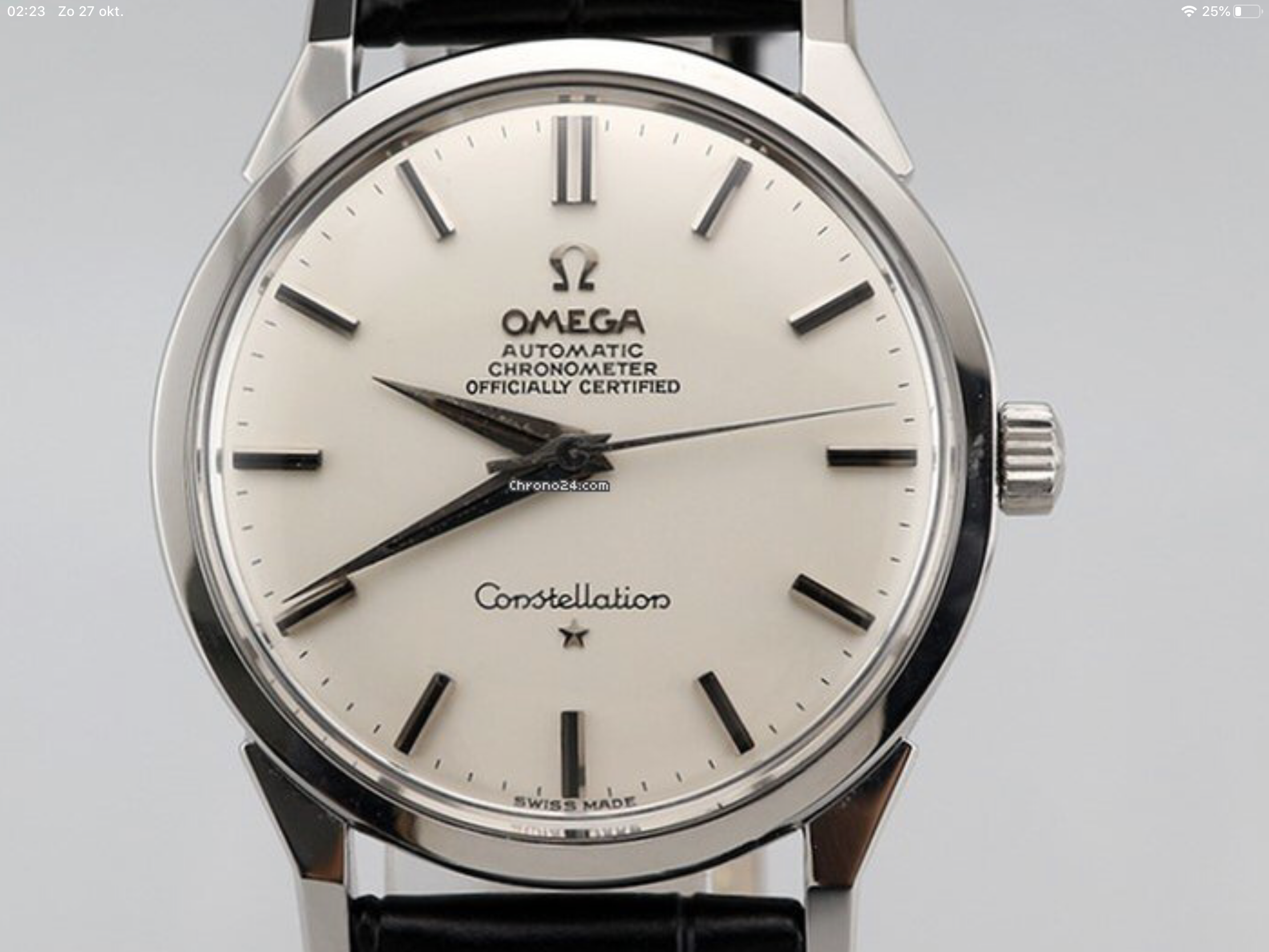

Back on the remark about the inlays. I assume you mean the black “stripes”? I kind of assumed this was also an option. Do I understand that these were never sold like this and the picture below would be the standard?

I'd want to see a straight-on shot of the dial in high rez. But I probably wouldn't bother due to the other items already flagged.
They did, but they went together. Lumed hands = lume plots on indices, onyx hands = onyx inlays on indices, black paint on hands = black paint on indices, plain steel hands = plain steel indices. In your watch, the hands/dial don’t seem to match.
[EDIT: actually it seems like somebody polished the black paint off those indices]
2,298
3,155
Reviewing the pictures I think @Lotus_Eater8815 is right
that on the OPs watch there has been painted indices and the paint is not present any more.
Some paint left on 3 and 4...
383
349
OK, thanks a lot all of you. I learned a lot. I am going to pass this one. The picture of the other one (with the good looking black inlays) I found too expensive. I will keep looking. That in itself is also a hobby one could say. 😀
