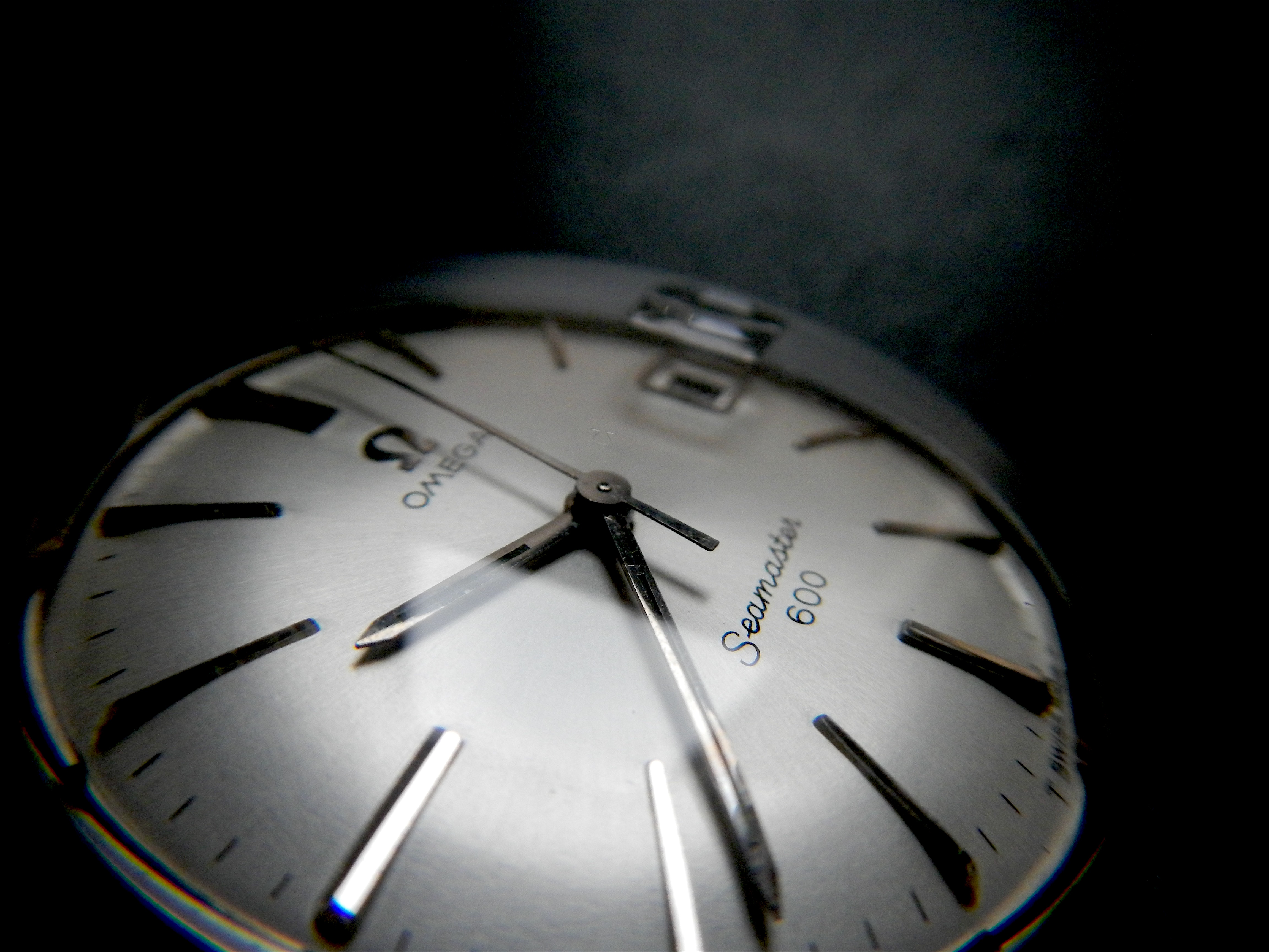

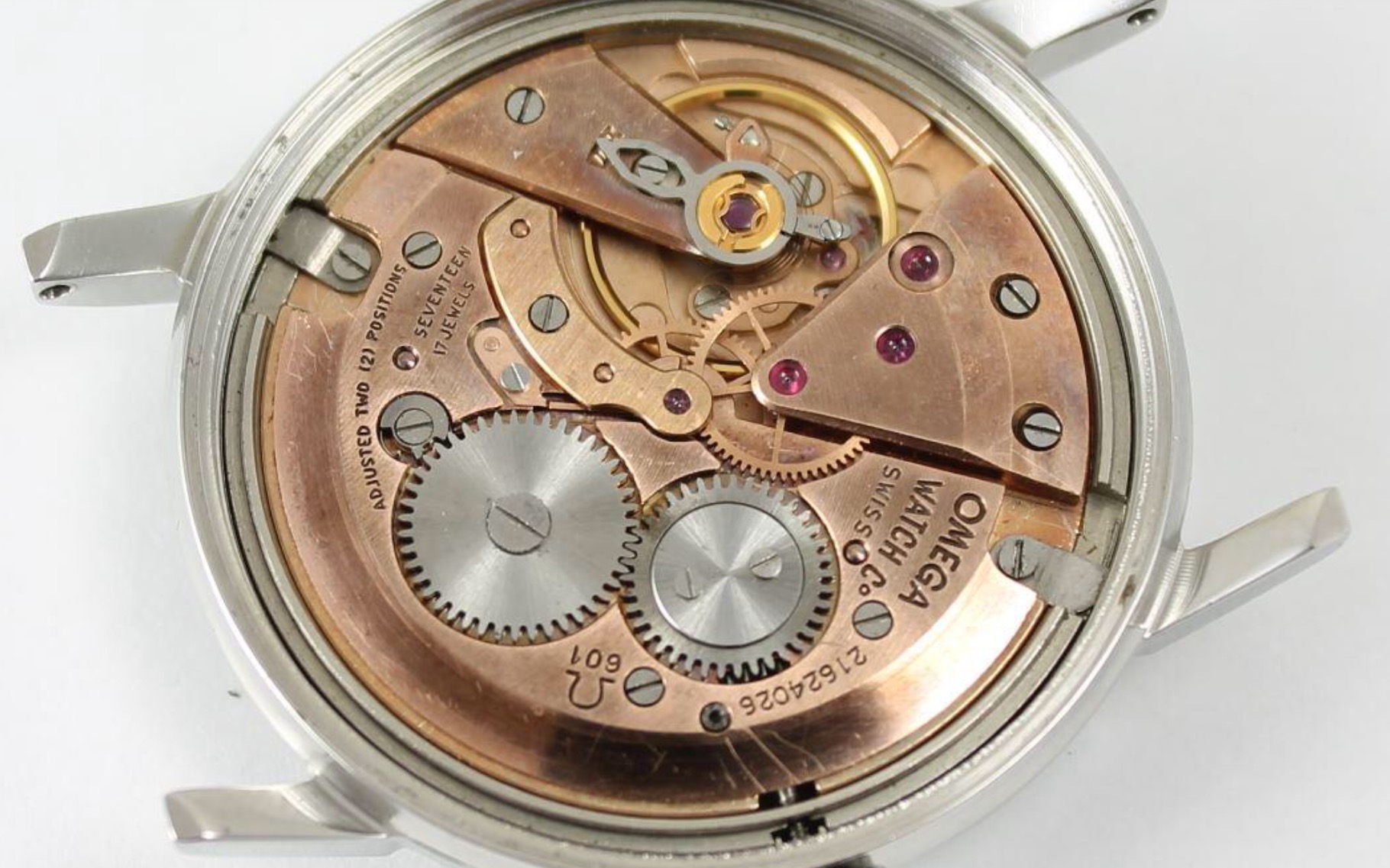

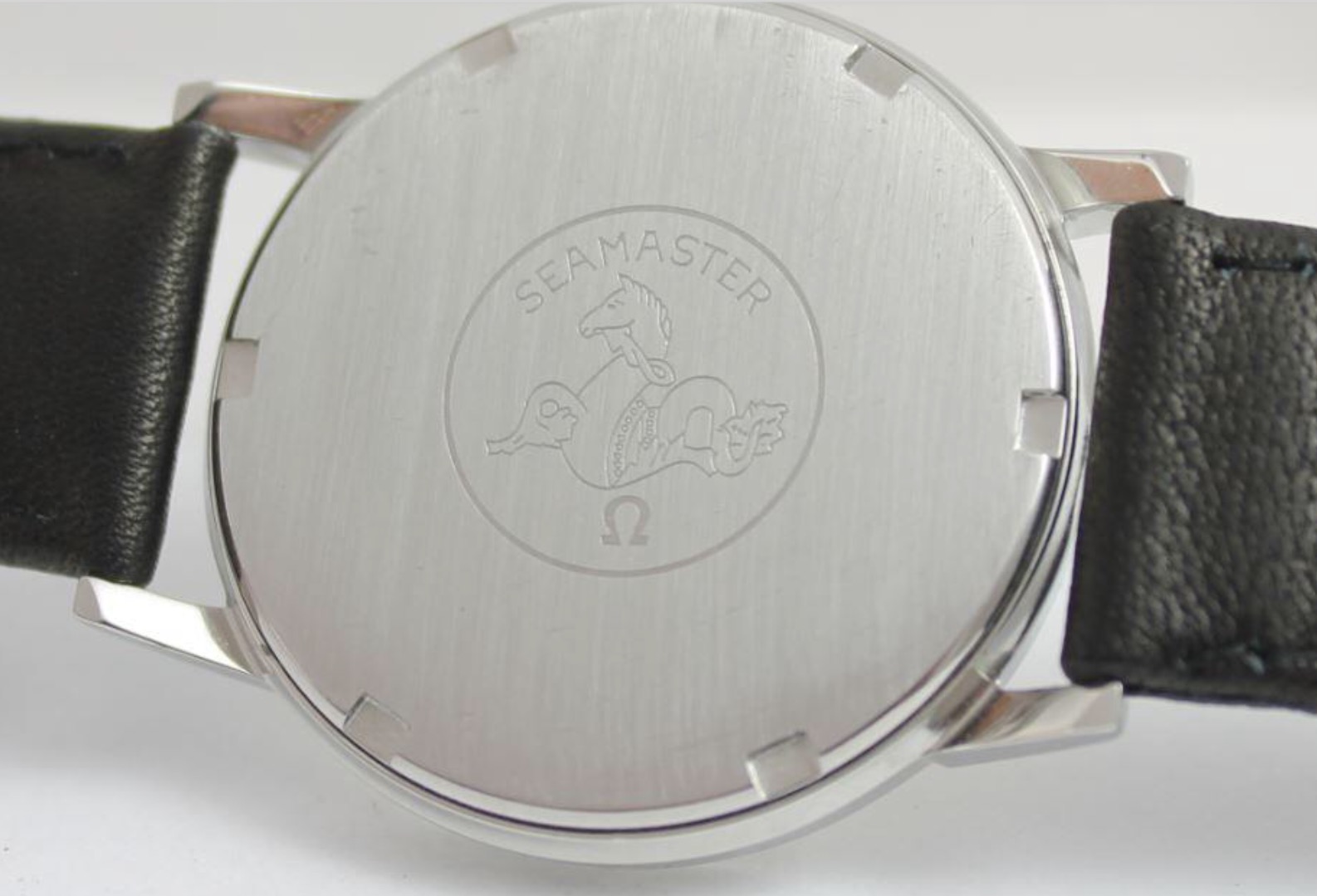

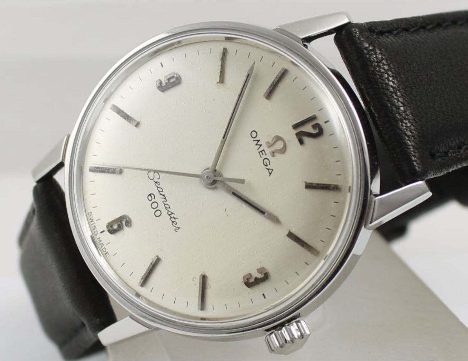

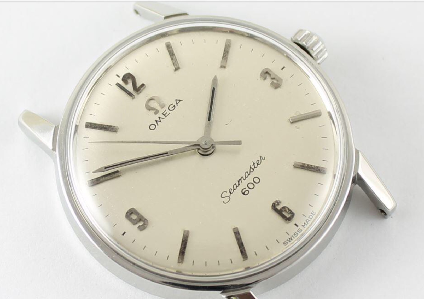

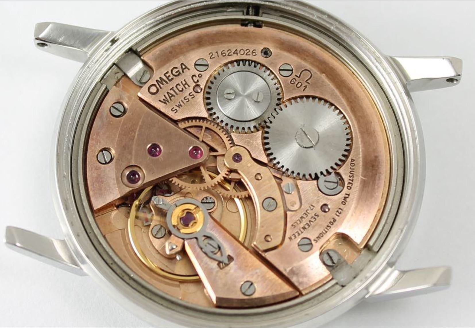

    Hi, apologies in advance I'm another new member with very little knowledge of Omega's let alone watches. I have for a long time wanted to purchase a classic vintage watch, something to keep and pass down to my son. Up until now I haven't really been able to afford one but no I can, I've started to look more seriously and it's an absolutely minefield. So I thought I'd start with this. I've been looking and really like this 1964 Seamaster 600. I was wondering if any of you kind people out there might be able to point me in the right direction or advise me on the originality of this watch and if the components are original or not.
    Here are a few pictures of the watch. image.jpeg image.jpeg image.jpeg image.jpeg image.jpeg image.jpeg image.jpeg image.jpeg image.jpeg image.jpeg
    Thank you all very much for looking at my first post. If there are any questions or you need any more information please let me know and I'll do my best to fill in the blanks.

    I have been wrong before (just ask my wife) but this one looks all correct to me. There is some spotting to the dial but I would guess it to be original.
    But hang around before you buy, others with more knowledge may disagree with my assessment.

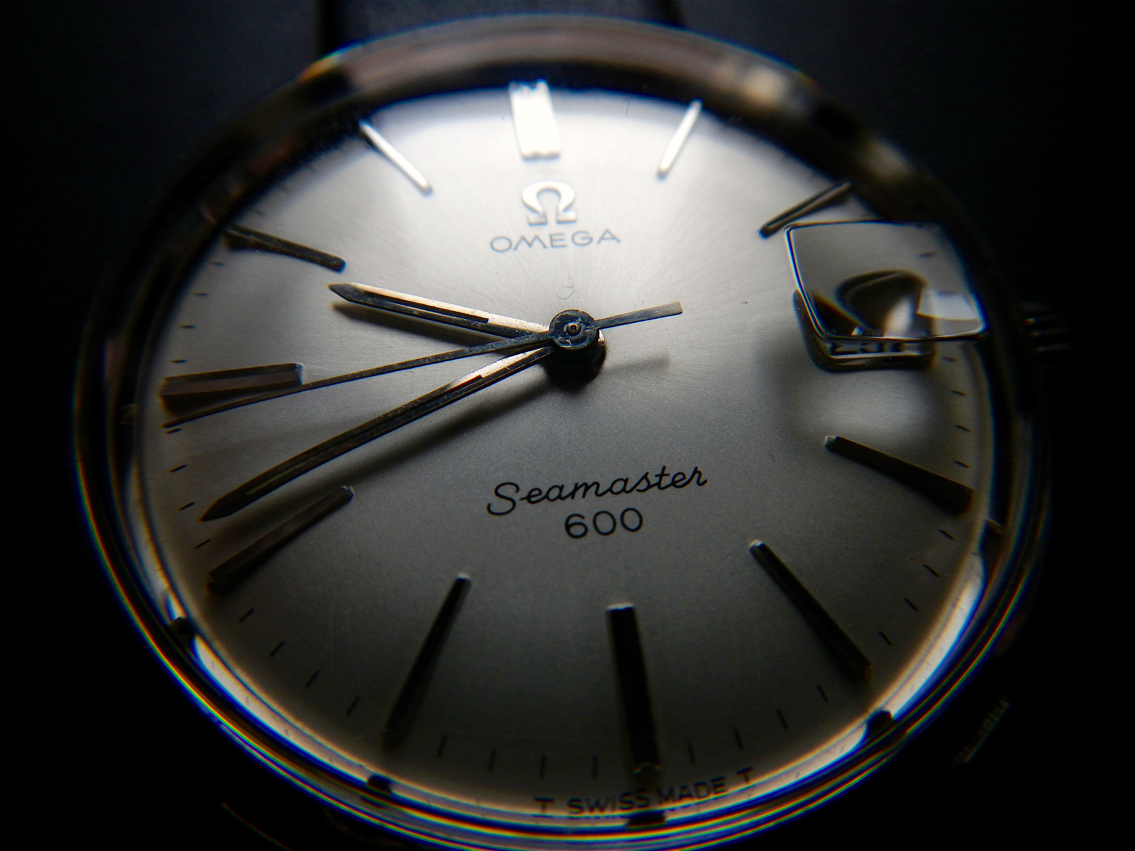

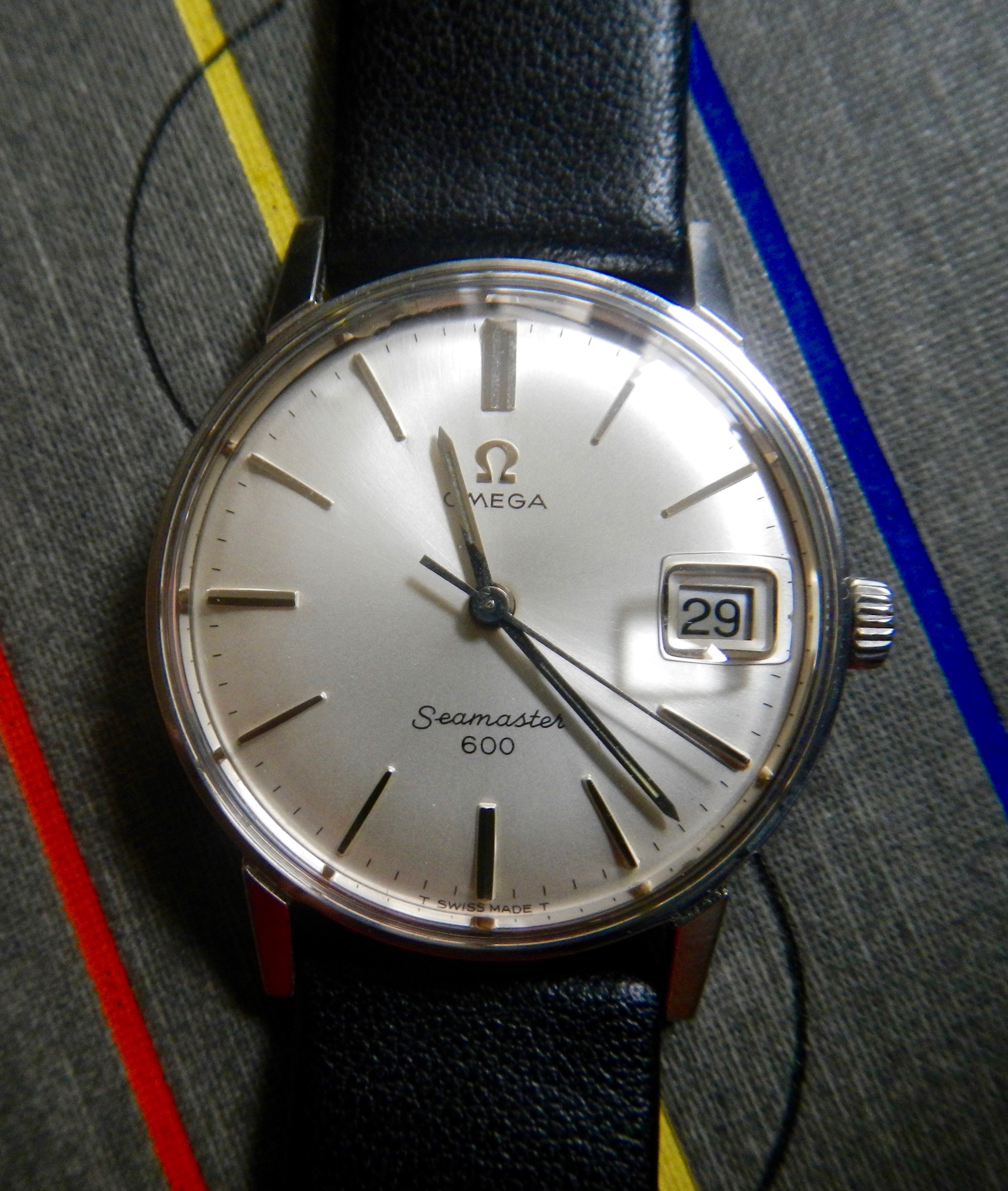

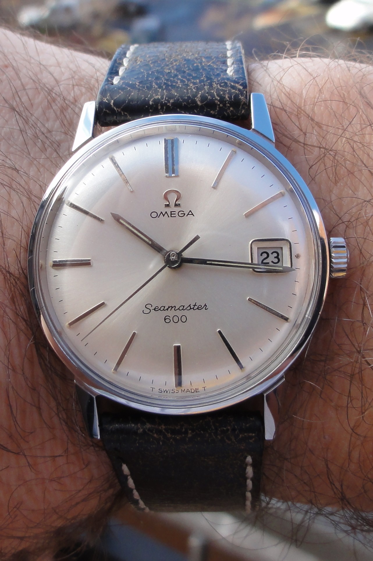

    Welcome to the Forum, you've come to the right place.:thumbsup: The watch above on first look seems to be not too bad overall but I have a concern about it. It looks original except for the replacement crown (not a big deal) but looking at the dial, hour markers on the dial and the movement, it seems that this watch has had some type of water or moisture encroachment. If you look at the dial you can see the spotting as mentioned above and this along with the corrosion on the hour markers raises a red flag. Now looking at the movement, the discoloration of the copper color on the various parts along with the above evidence lead me to believe that this watch has had moisture inside over a period of time. These watches are fairly common (you can find a better one) and IMO this watch is a pass. I have a very similar watch to this one and like it very much. These Omega hand wound caliber 600 series movements are very robust and can be found at reasonable prices with some effort. Here is mine for reference...
    Good luck on your search and check back with us to vet any watch you are considering. Also read up as much as possible, knowledge is your friend when looking for a vintage watch!:thumbsup:

    Hijak, just out of curiosity, just looking at the dial on yours and the photo I posted, could you tell me pleaspe what the T stands for either side of the Swiss made at the bottom.

    Thanks Ryan, I like it a lot too and it is not for sale but I appreciate your interest.:) The T on my dial stands for tritium (might have spelt that wrong) which is the material applied to the dial and hands that glowed in the dark. Most modern watches use Superluminova (again with the spelling) these days. You can google radium, tritium and superluminova to learn more about these materials and the time frames they were used(and the correct spelling;)).
