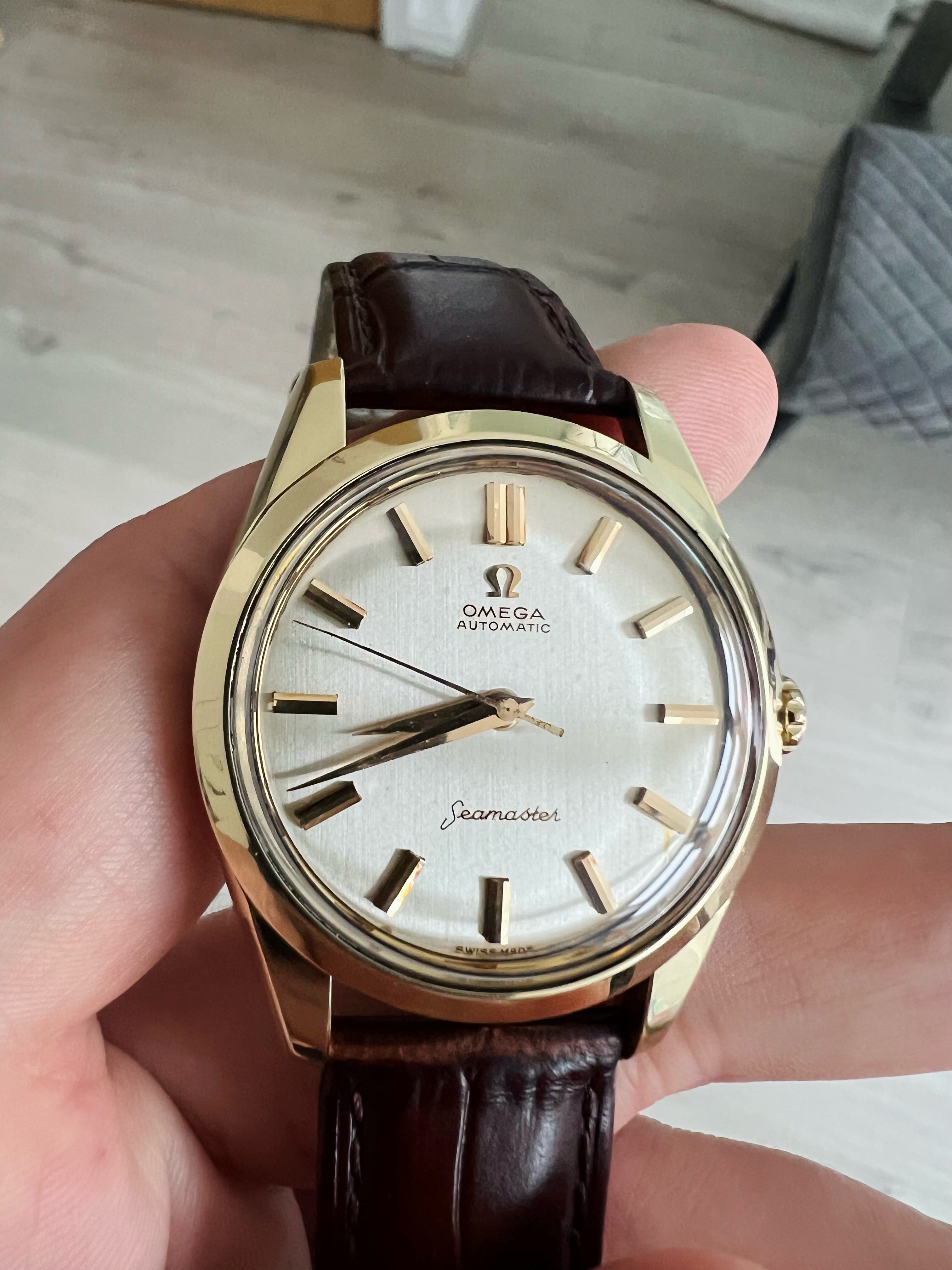

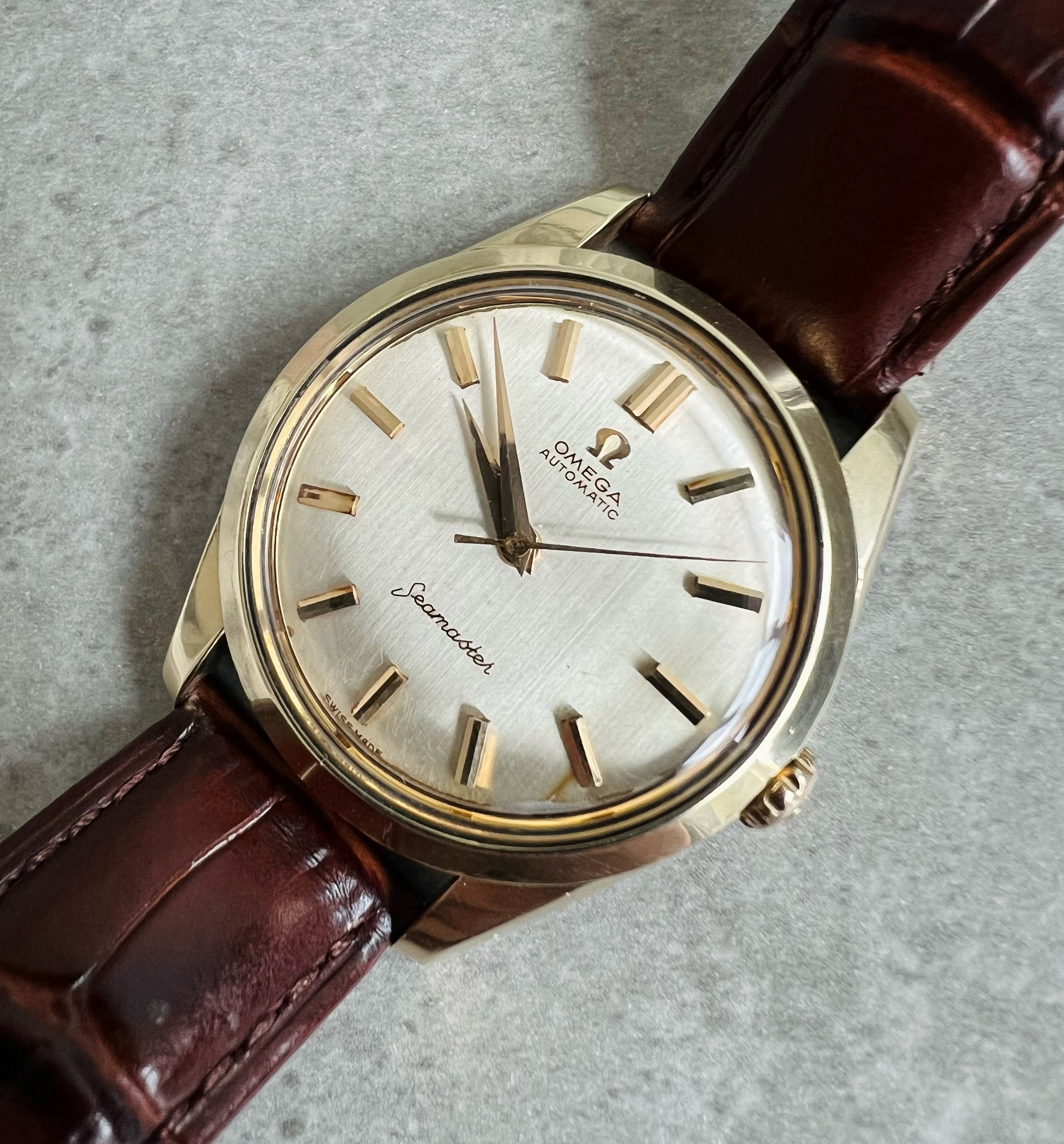

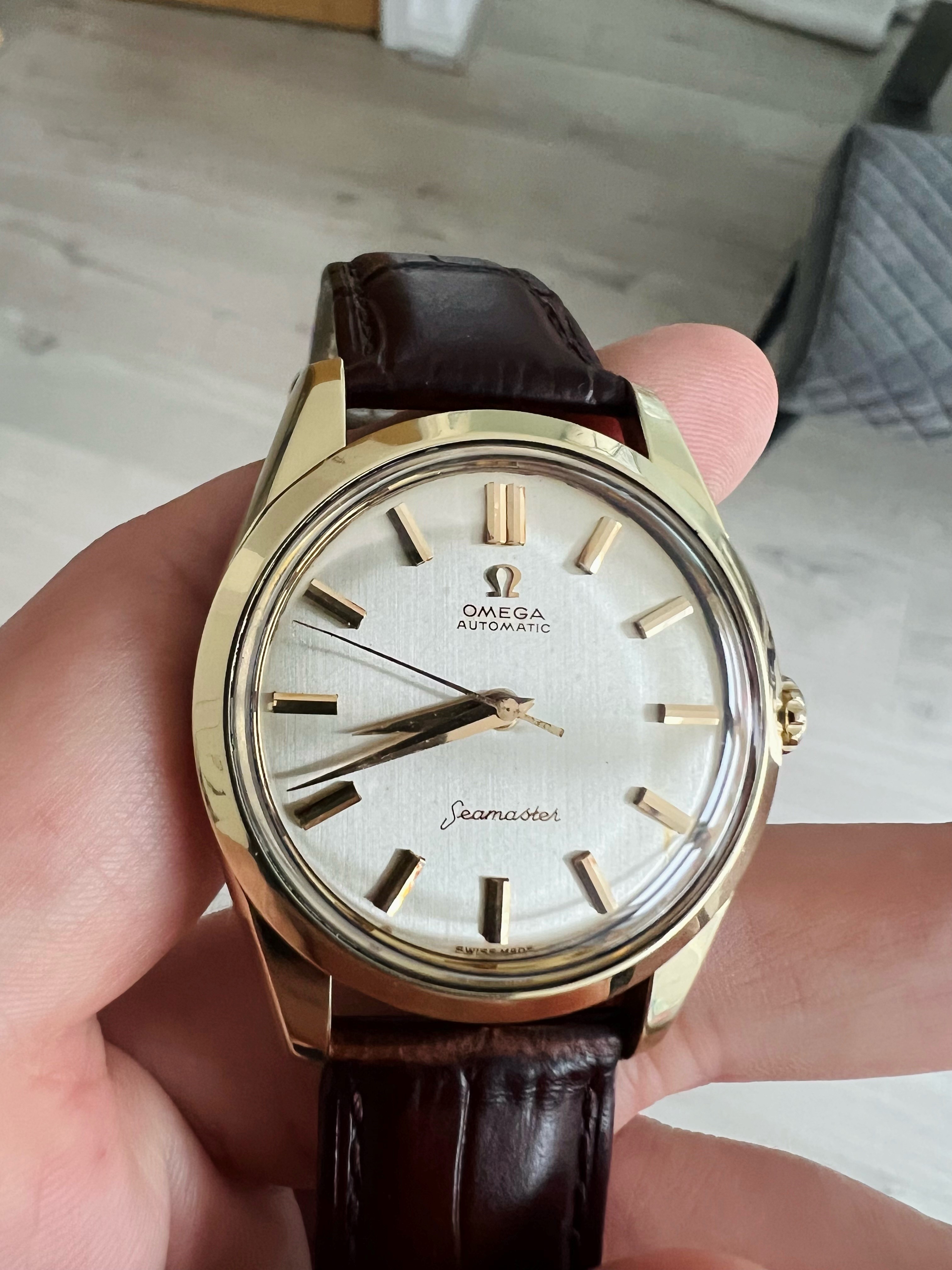

Hi Guys,
I'm hoping someone might be able to shed some light on this for me. I have a 1961 Seamaster (sorry I don’t have the exact reference) without the minute track. I believe everything else with the movement/dial etc is original, i'm just wondering if Omega did make some watches without the minute track?
Personally I prefer the simplicity of the look without the minute track, but it would be even better to know it was original! If you have anything similar please feel free to share, I'd love to see some more.
Thanks in advance,
Cal

Lovely watch, I assume it's gold-capped. It might help to provide the reference.

Thank you, it is gold plated.

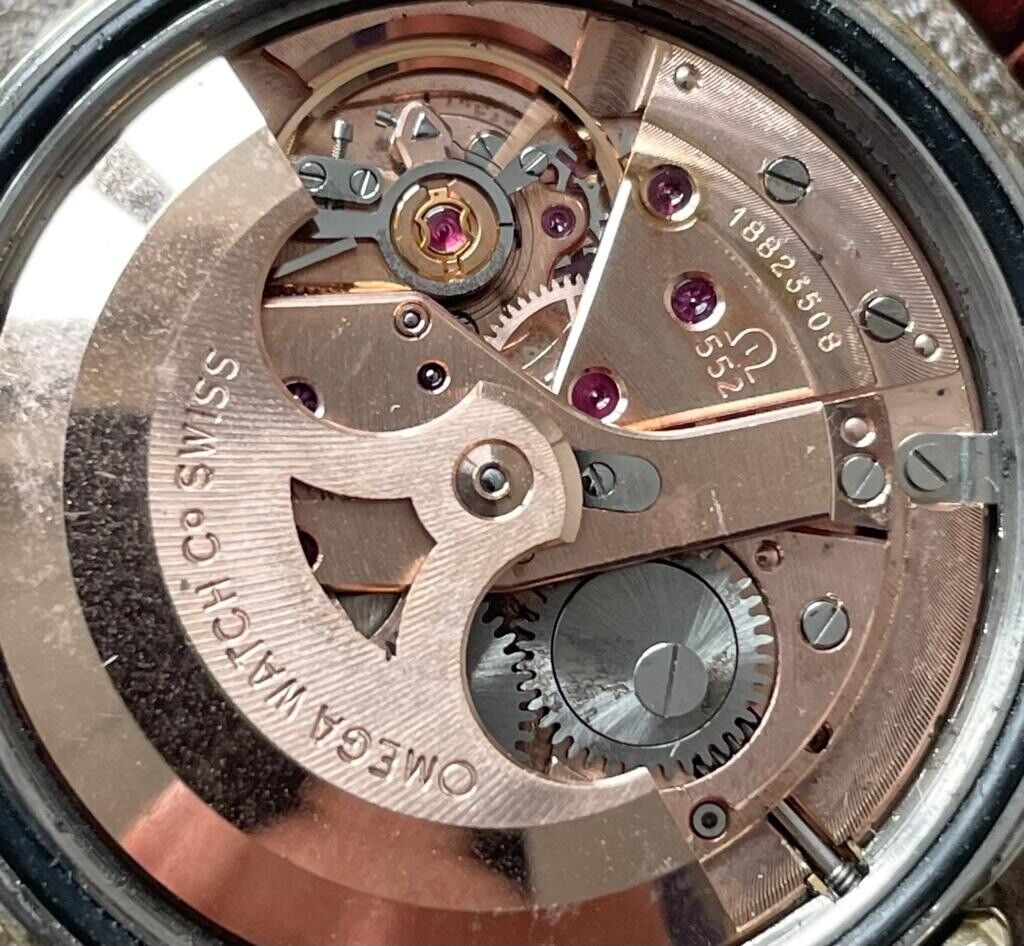

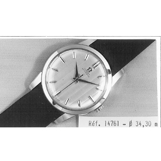

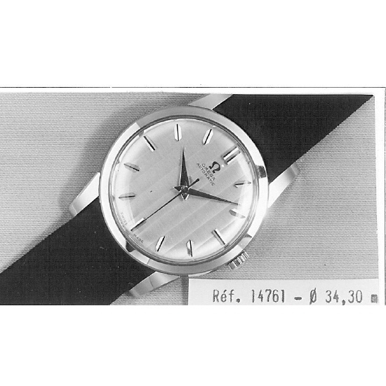

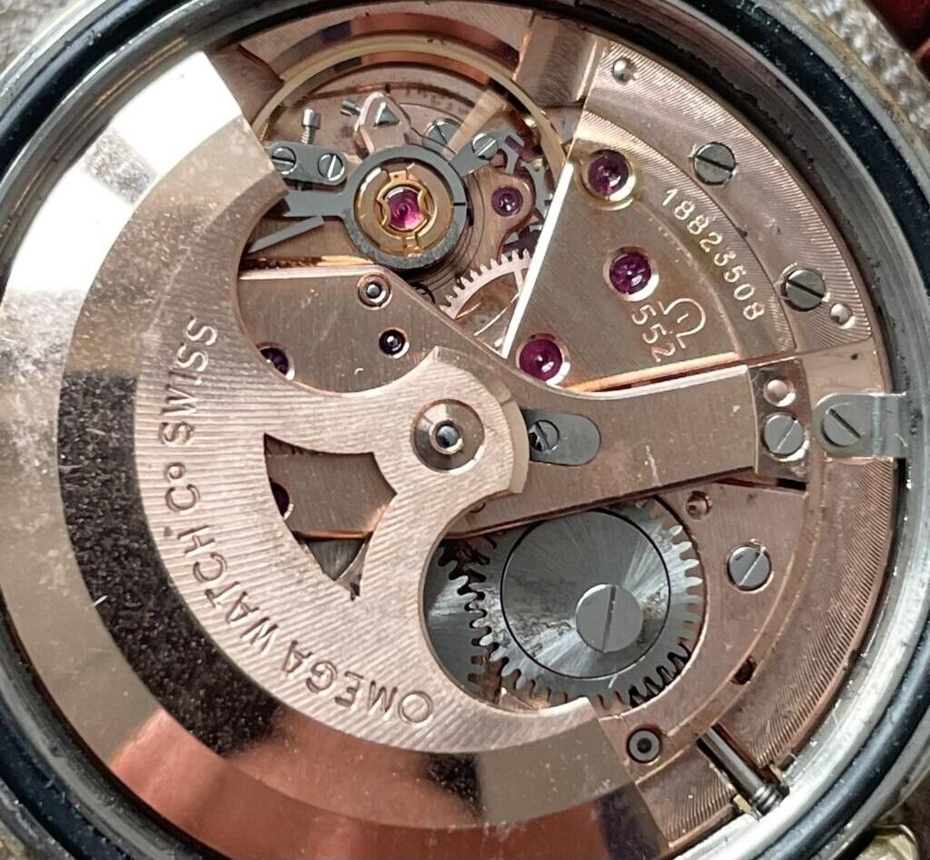

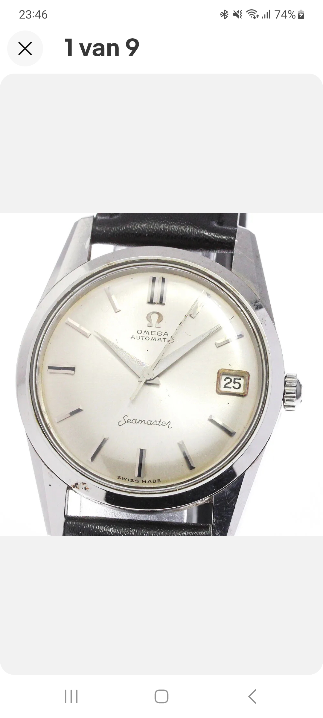

Unfortunately I don't know the exact reference number (the open back is a picture from when I purchased, I don't dare open the back myself). I presume it is something similar to reference 14761, as this also doesn't have the minute track:

Are you sure it's gold plated, I suspect it's gold-capped. Can you post a photo clearly showing the back of the lugs.
It is not a 14761. The case sort of looks like a 165.010, but I'm not sure the coat-hanger S would be consistent with that reference.
4
4
Sorry you are correct, it is in fact gold capped. The back of the lugs are steel.

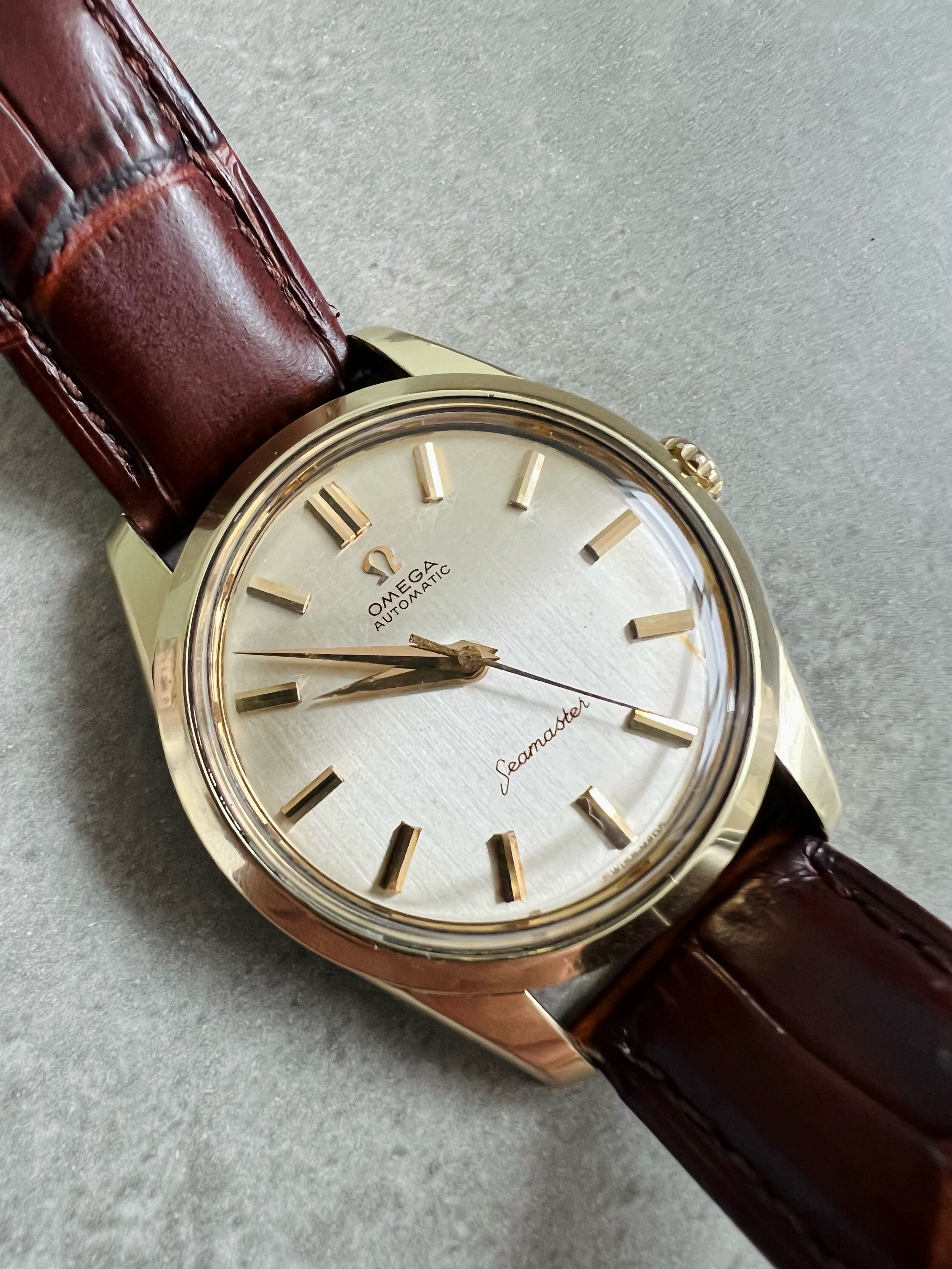

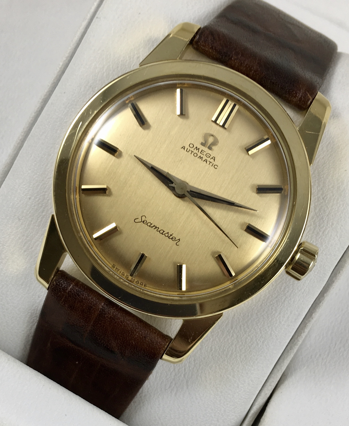

Incorrect. You forgot about the original genuine factory dials without minute markers. As an example, ALL diamond dials on ref. LL 6590-1 come without minute markers.
883
1,770

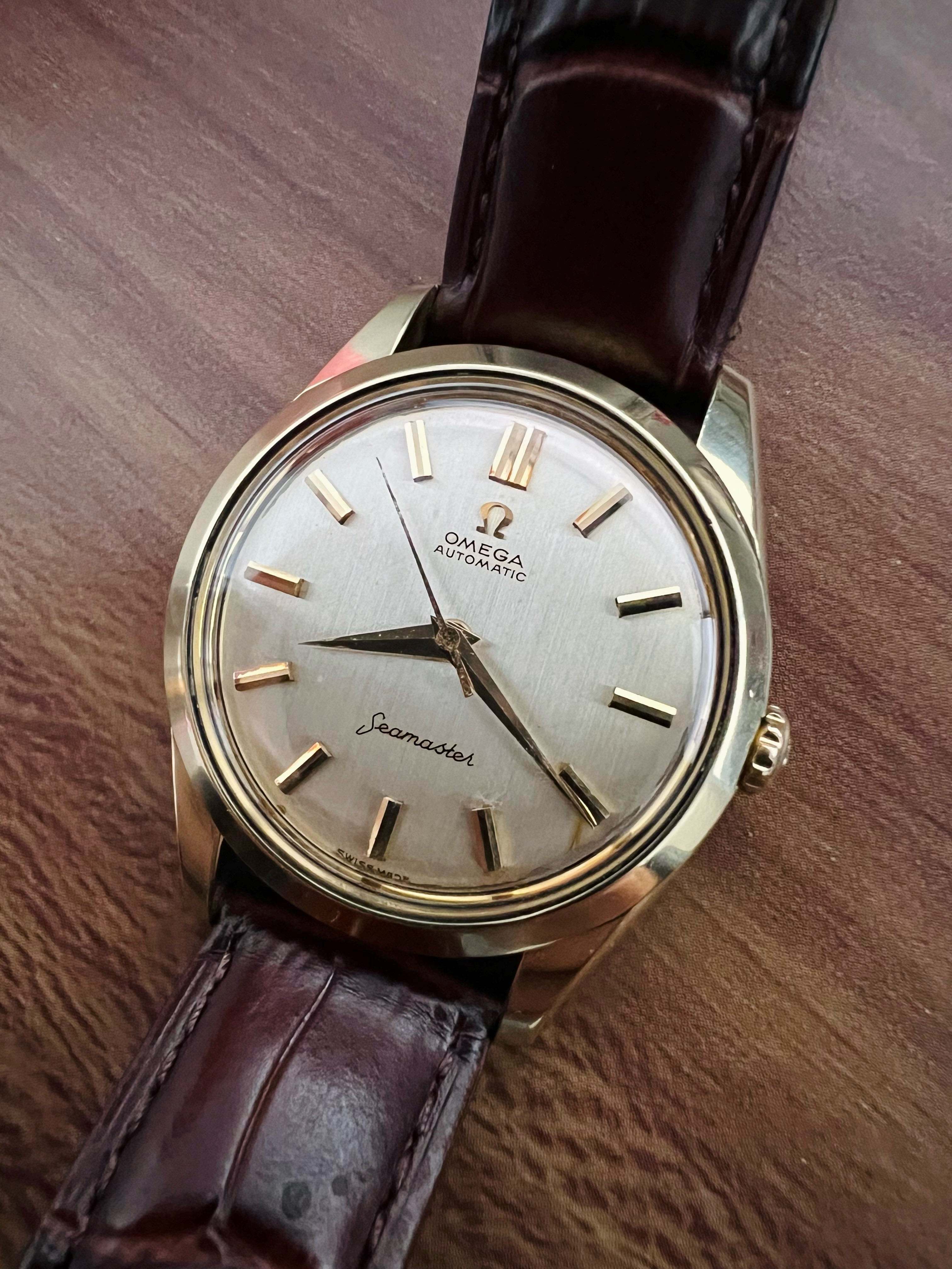

Thanks for the input, It’s good to know there are some originals out there without the minute markers (even if mine is potentially a redial)
I have no idea if yours is a redial. If it is indeed a redial, it's a very good one and I would need real close up shots of the inscriptions on the dial to decide if it's original or not. But one thing for sure: you can't rule out the originality of an Omega dial based on the absence of minute markers because some (fairly unusual) original dials had no minute markers.

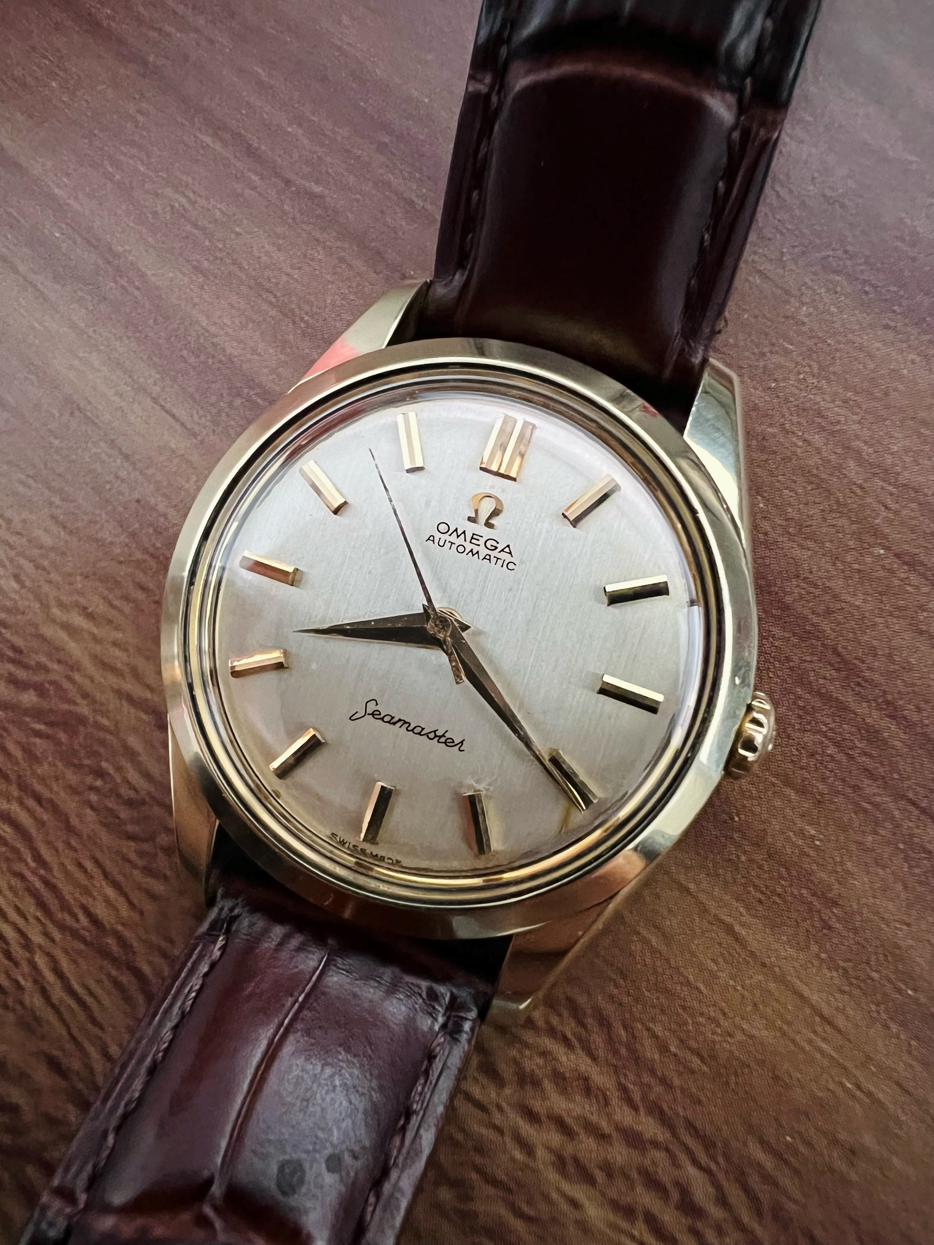

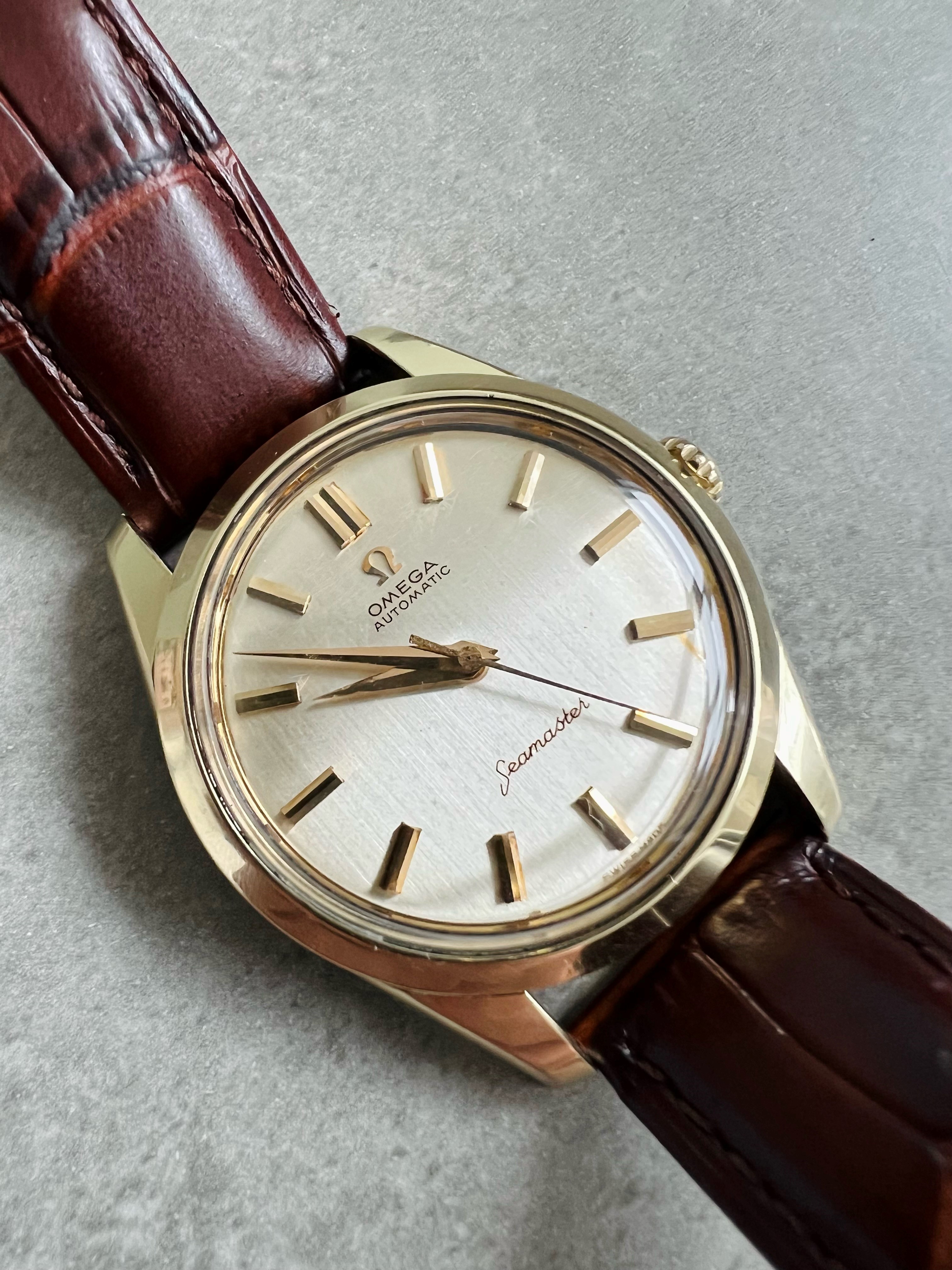

13,490
31,809
My vote is original for OPs watch.

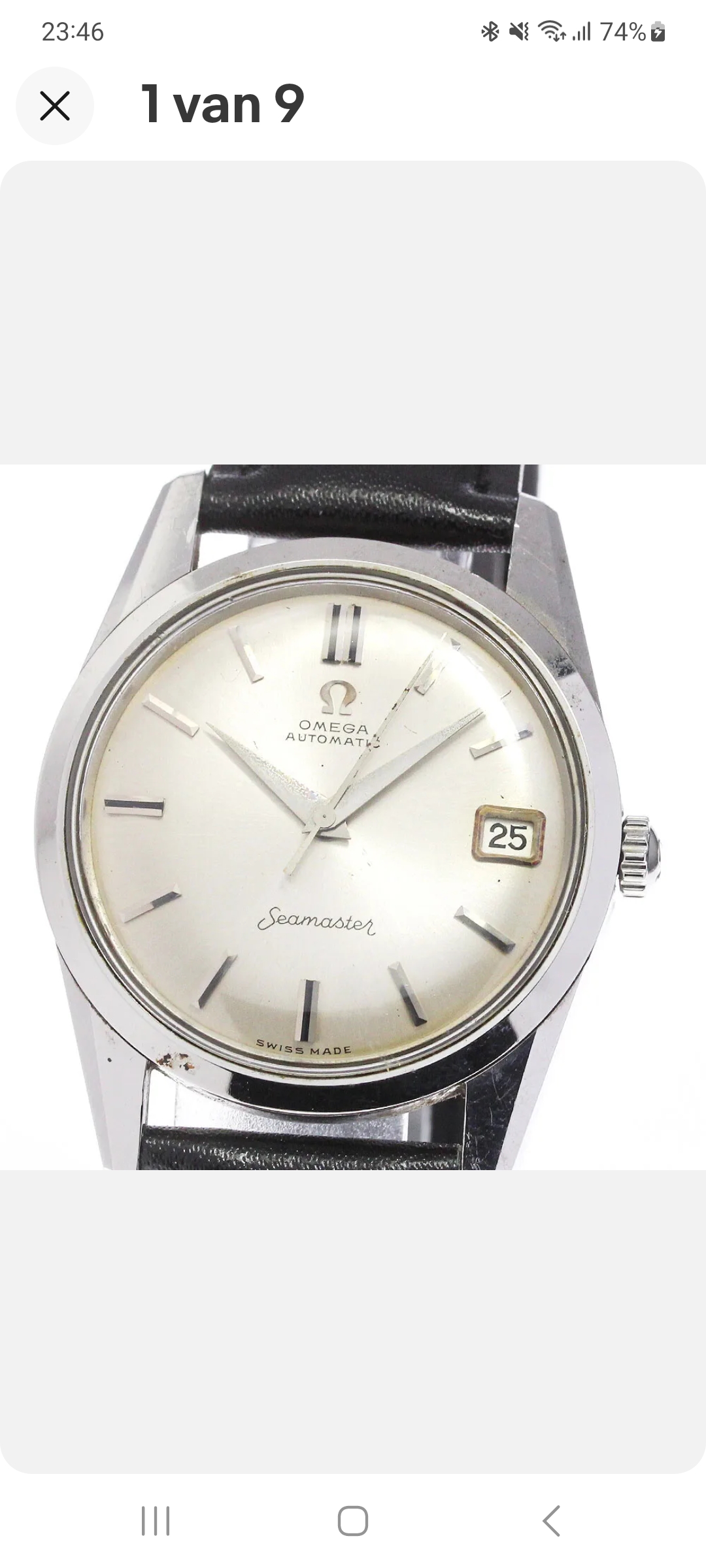

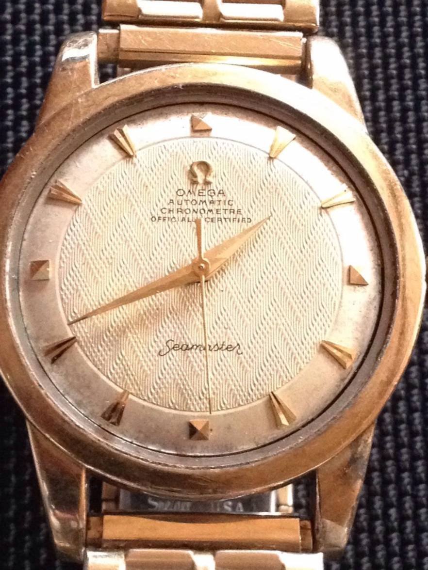

Minute indicators here, but added to exhibit the other markings. This one's from a year later, 1962.
