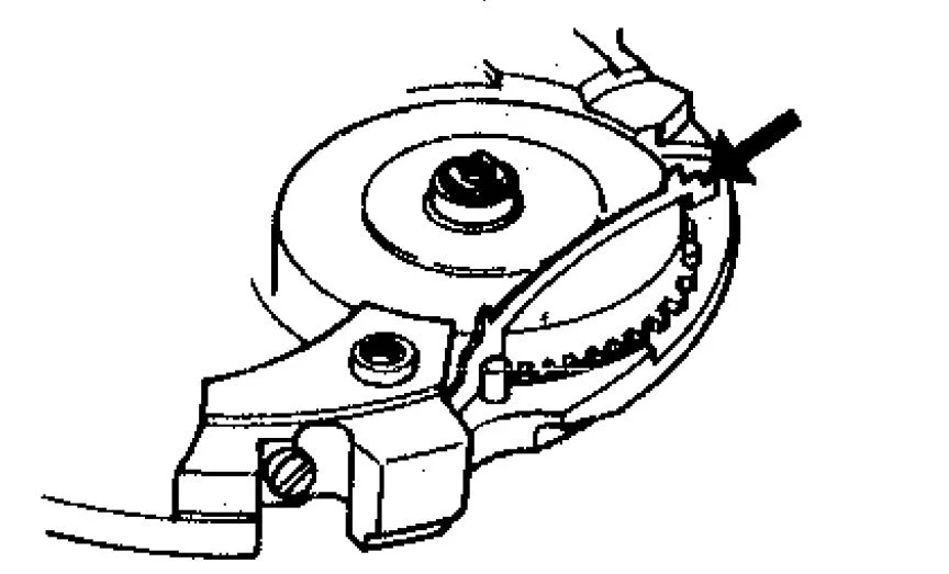

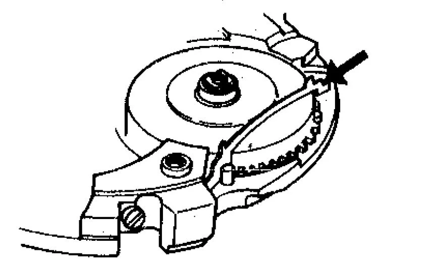

Thank you for illustrating this so clearly. My question is why some watches seem to demonstrate this more than others? I notice it quite a lot with vintage Grand Seiko
29,188
75,421
There are a few things that can affect how much the crown rebounds, or if it does at all.
If the seals inside the crown or case tube are new and tight, it may prevent the crown from turning backwards.
Second, the design of the click can have a big impact on how this works. The rotating style click like in the video, is more likely to cause this than say the type of click used on many Seikos, where it's essentially a piece of wire the gets pushed out of the way by the barrel teeth, so it has very little travel relative to the style in the video.
That style of click is shown in this illustration, with the arrow pointing to the click - the flat piece of metal:
Not all Seikos are like this, but it shows that this type of click acts very differently.
