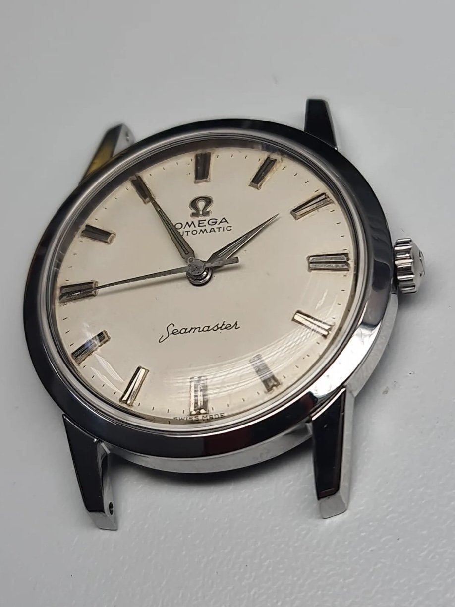

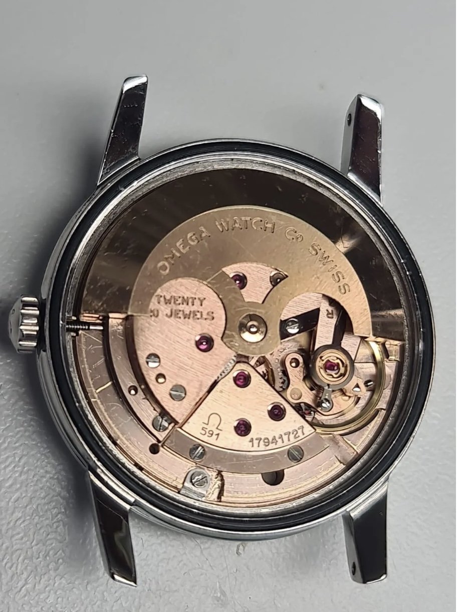

I’m very new to all this, what would you guys value this at? Considering purchasing my first omega watch. I usually wear Gshock as I’m a blue collar worker (HVAC/R Service Mechanic) and my wrists/hands can take a beating at times. I’m looking for something fairly stout, and not too bulky as I’m a fairly small guy that needs to squeeze into some small spaces. Something a little more valuable and vintage worth passing down to my very young sons one day, but not $1k+ as I’ll actually be wearing it.
I found this on eBay, and was wondering if it’s worth the $600ish asking? Or if you guys have one for sale in same price range/vintage, (I’m aiming for 1958 as it’s the year my father was born) in same stainless combo I’d be open to buying private party!
Thanks for any help/suggestions. Here’s an exerpt from the listing that’ll make more sense to you all than it does me. Based on the pics and a chart I found on here, I think it’s 1960? Can’t tell what’s original and what’s not or what impacts value, or if any of that matters since I just want a daily wearer. Thanks again!
OMEGA Seamaster men's wristwatch from the 1960s, measures approx. 34 mm in a stainless steel case.

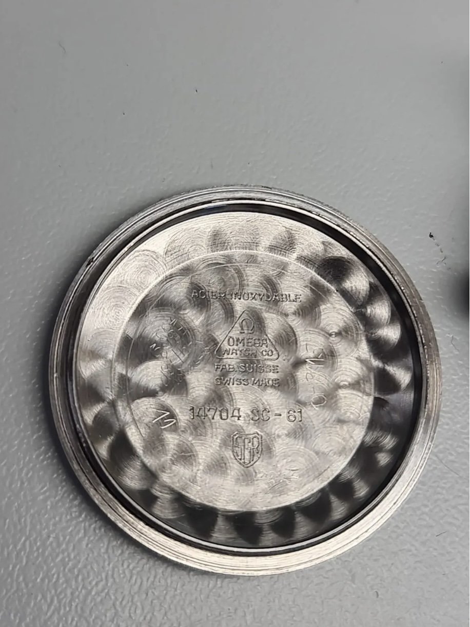

Reference 14704 SC-61.

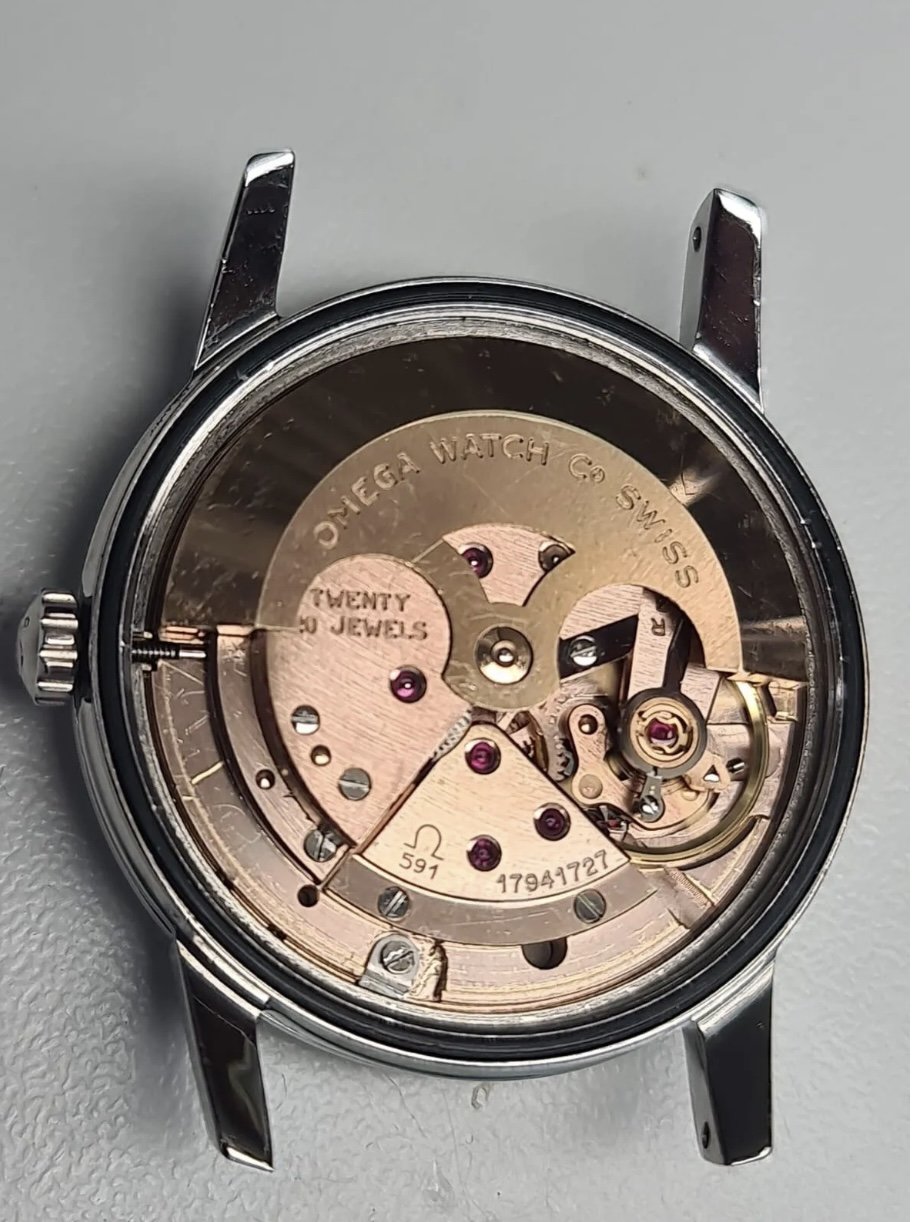

Omega automatic movement Caliber 591 works inside.
The movement working , Was recently Serviss @
Cal. 591 Ref. 14704-SC61 wristwatch.

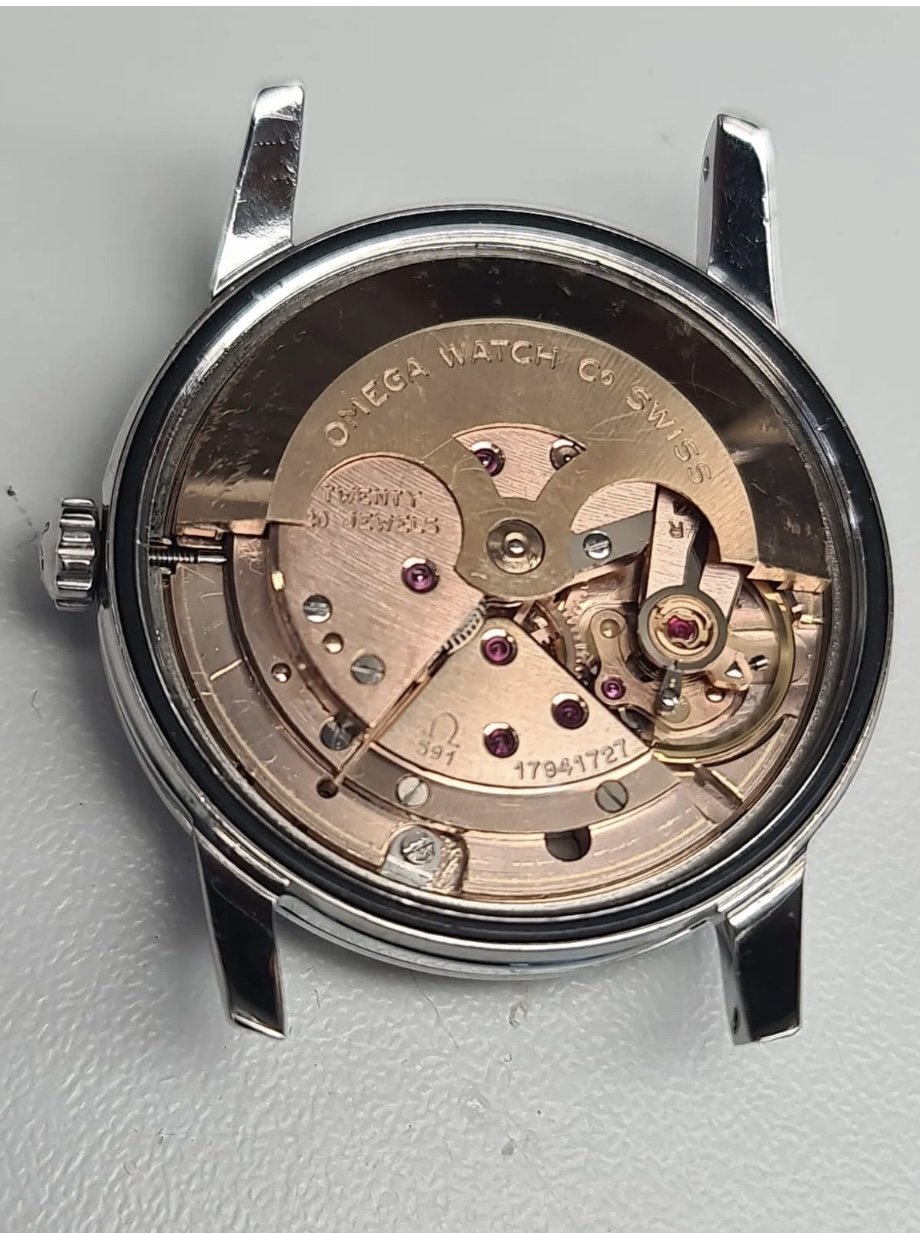

I'm feeling that the hands may have been changed out. Maybe wait for some other opinions. The rotor and inside of the case-back are showing significant wear from rubbing, which often means repairs will be needed.
After a little poking around, I think the hands are ok. Probably there were originally small dots of luminous material at the ends of the dial markers, but they have fallen out or been removed. If there is luminous in the hands, there is usually luminous material on the dial, which was what originally captured my attention.
Also, I just noticed that you said the listing mentioned a recent service. If so, it's possible that the issue leading to the rotor rub was addressed, but that usually requires replacing some parts. Not just a service.

I could see the hand thing too, glad to clear that up. Fingers crossed, I could only find one watch repair place within a couple hours of me that even touches automatics, and his English wasn’t the best. He said $250 for a service and $30 to look it over. Hoping this doesn’t turn into another hobby I end up tinkering with, my wife would not appreciate another lol

I am not a huge fan of the case finishing or the build-up around the markers.
It wouldn't be bad as a first vintage watch, but know that you could probably find a nicer one if you wait.

FWIW, I think you found a pretty decent example for a reasonable price for someone starting out. Typically, a new member's first post is a total piece of junk for a ridiculous price.
Still, if you follow the eBay thread and the sales listings, you will probably find something a little better.
And once you buy the watch, it's yours to wear however you choose. 👍

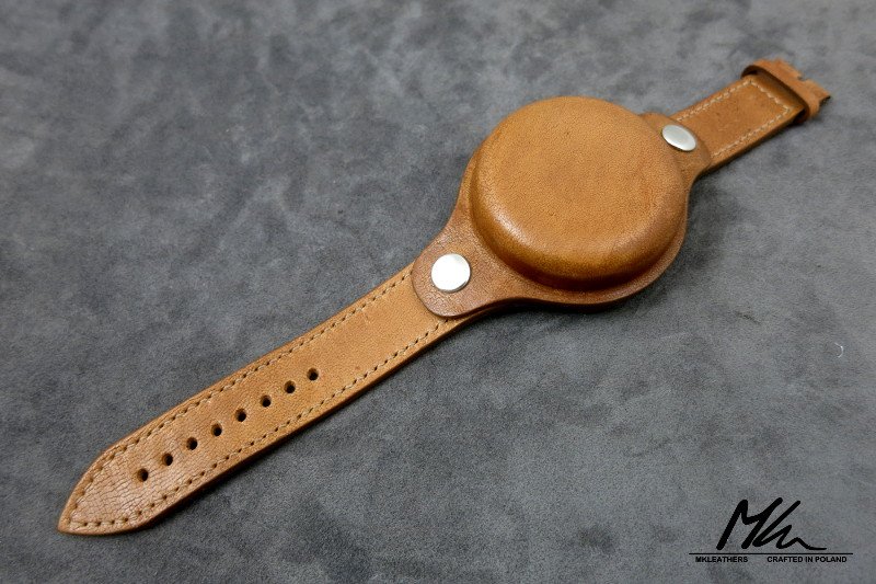

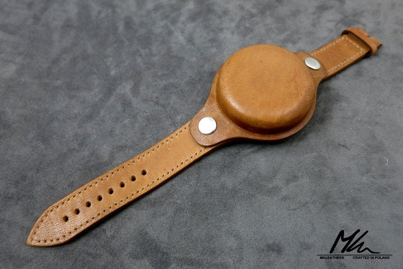

If you insist wearing a vintage watch to work, maybe a bund strap with cover is for you?
