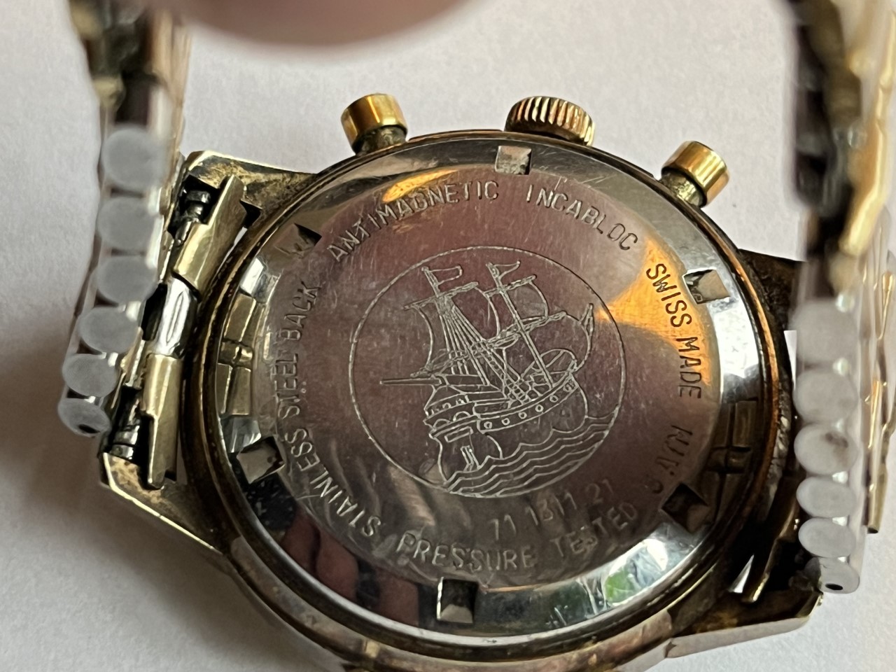

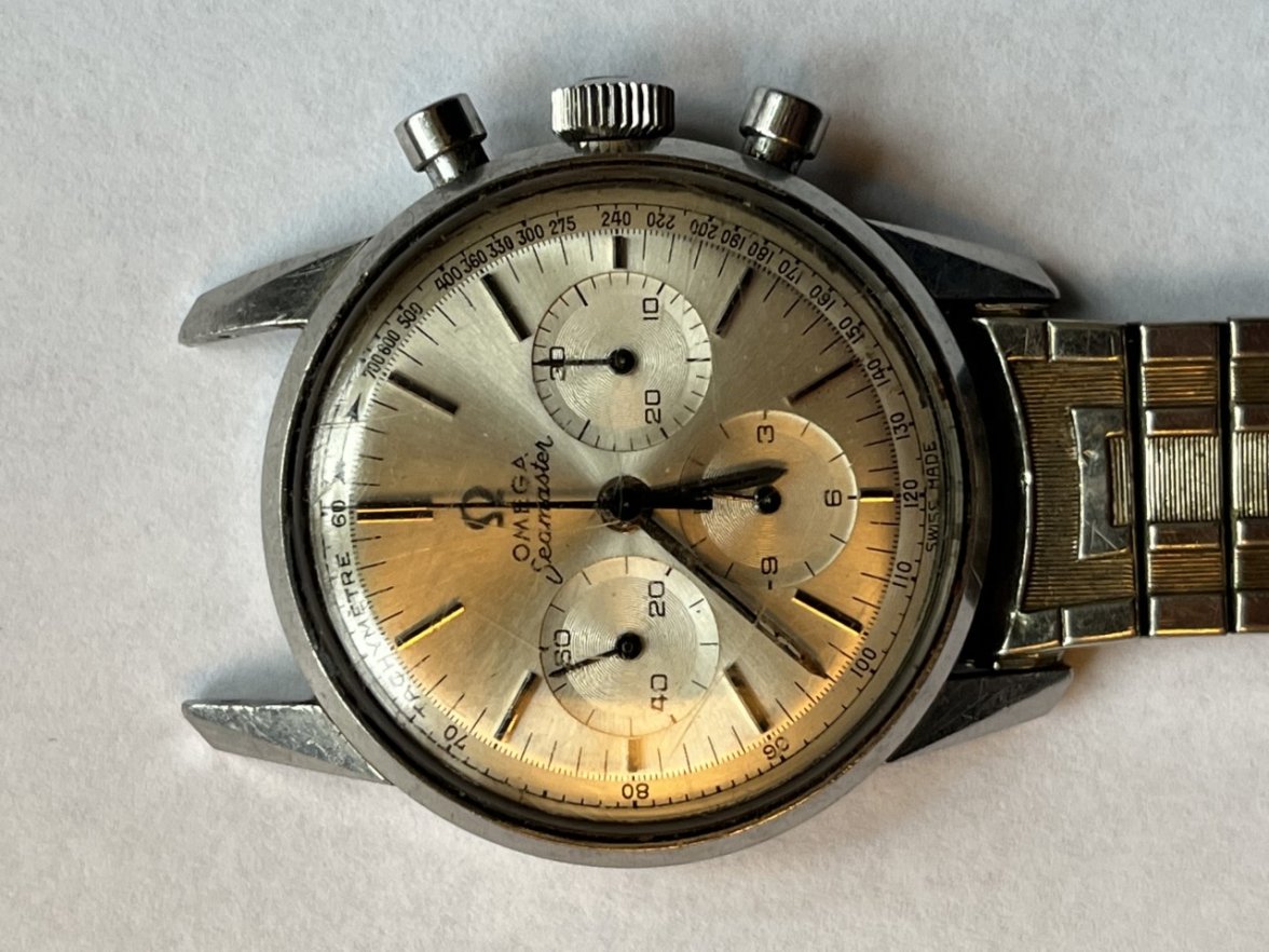

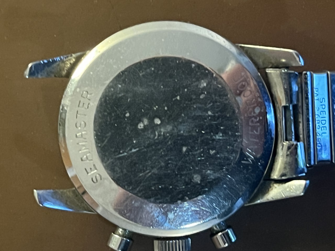

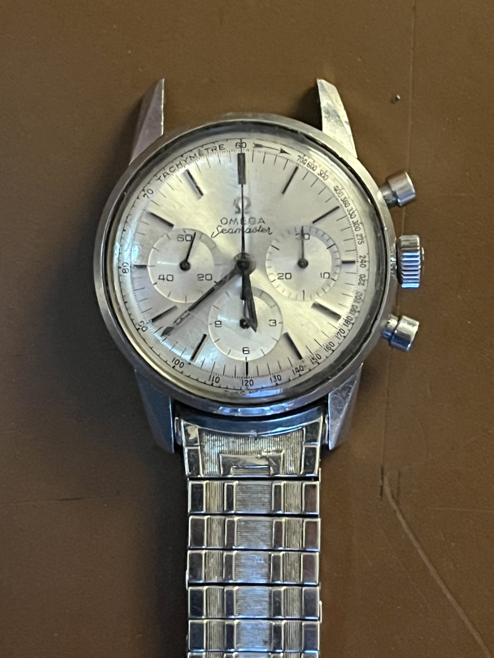

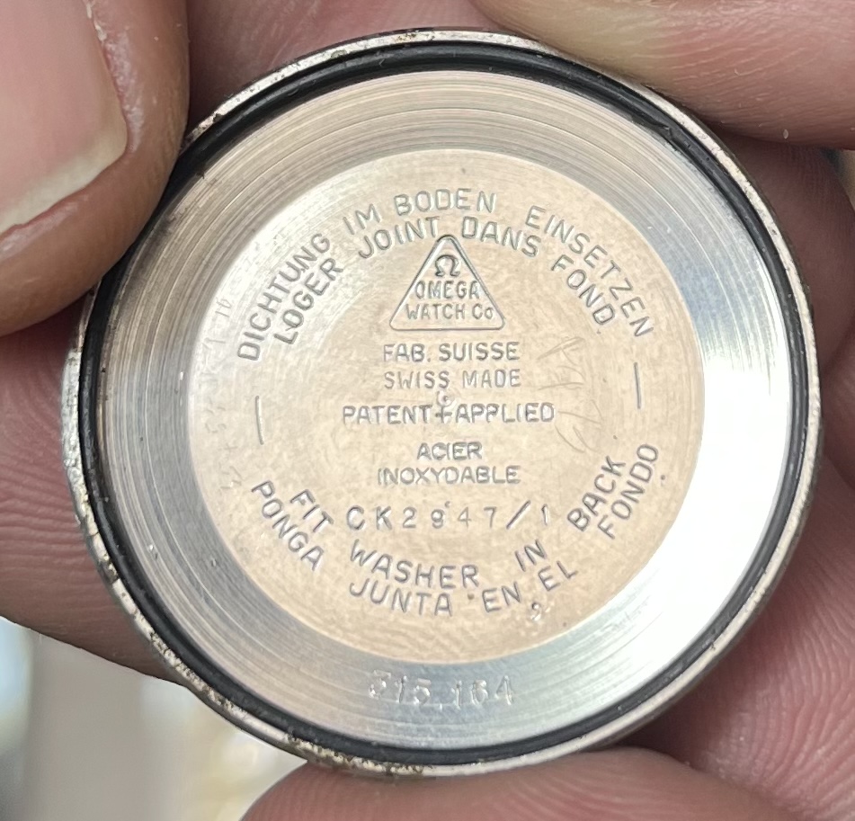

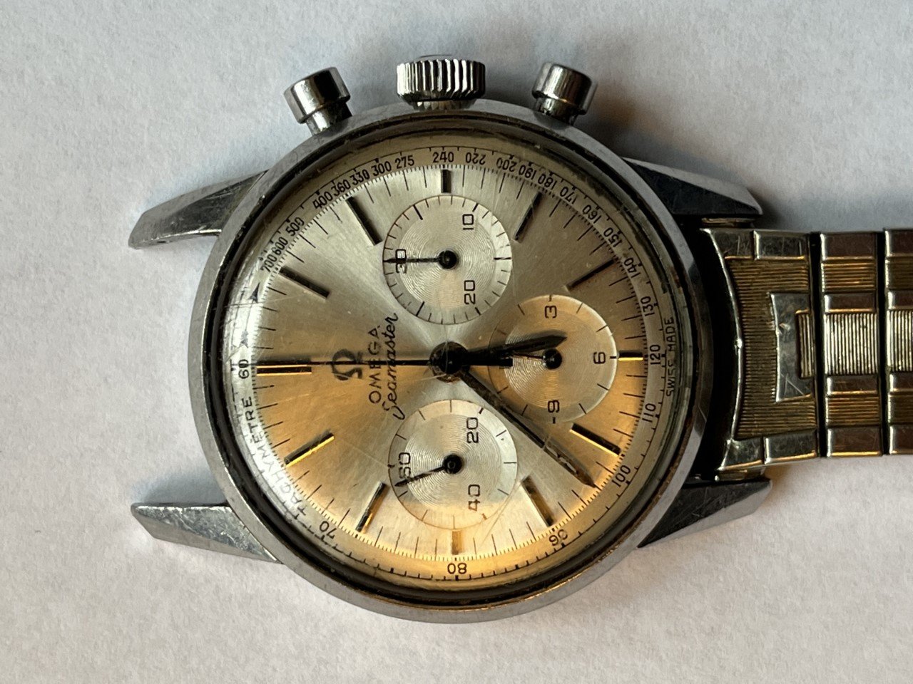

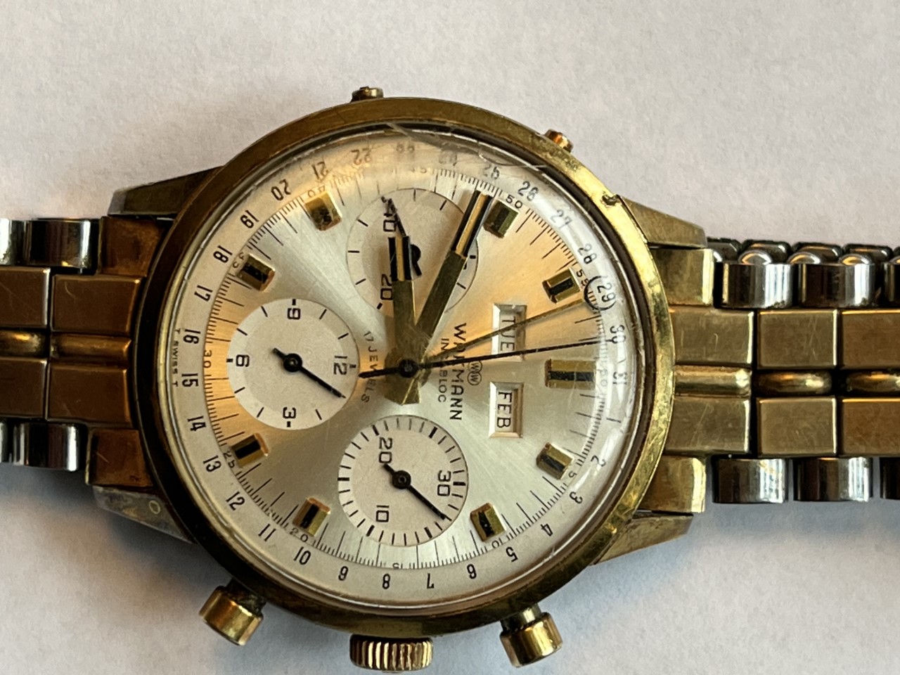

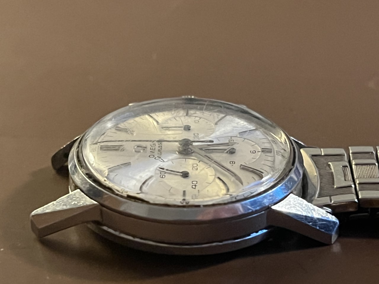

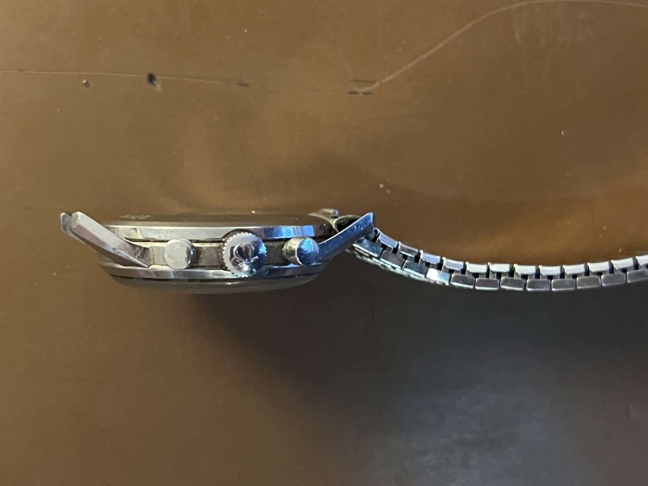

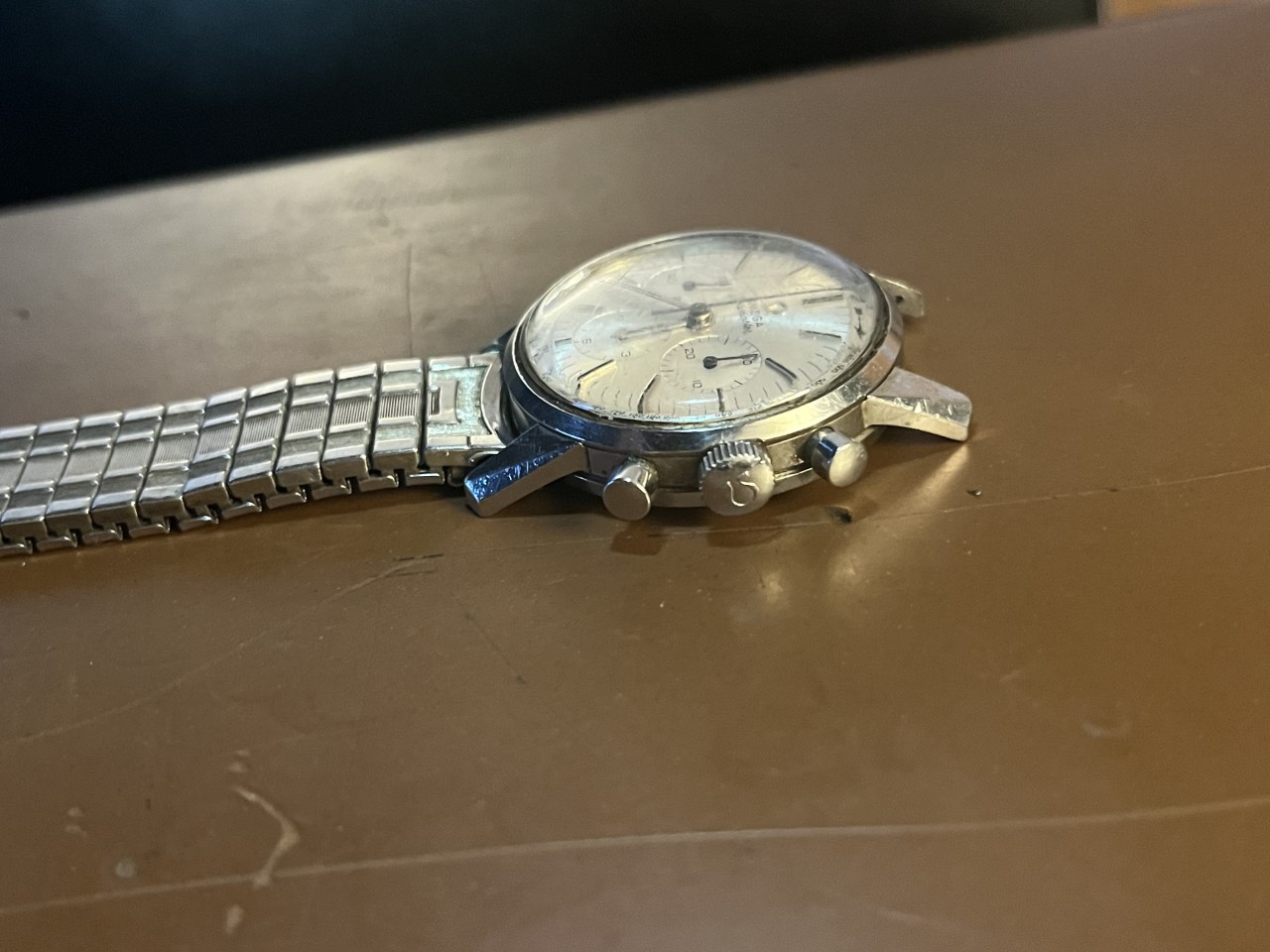

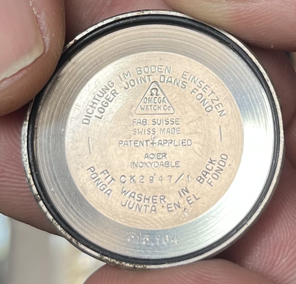

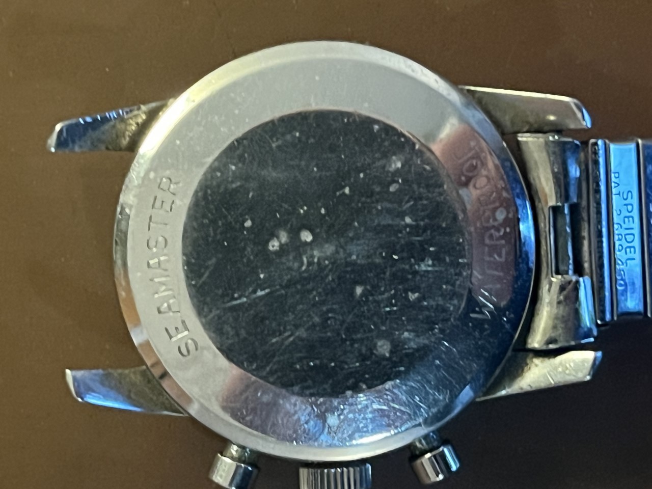

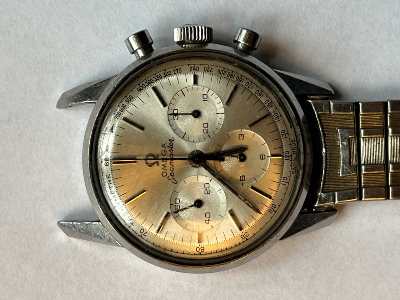

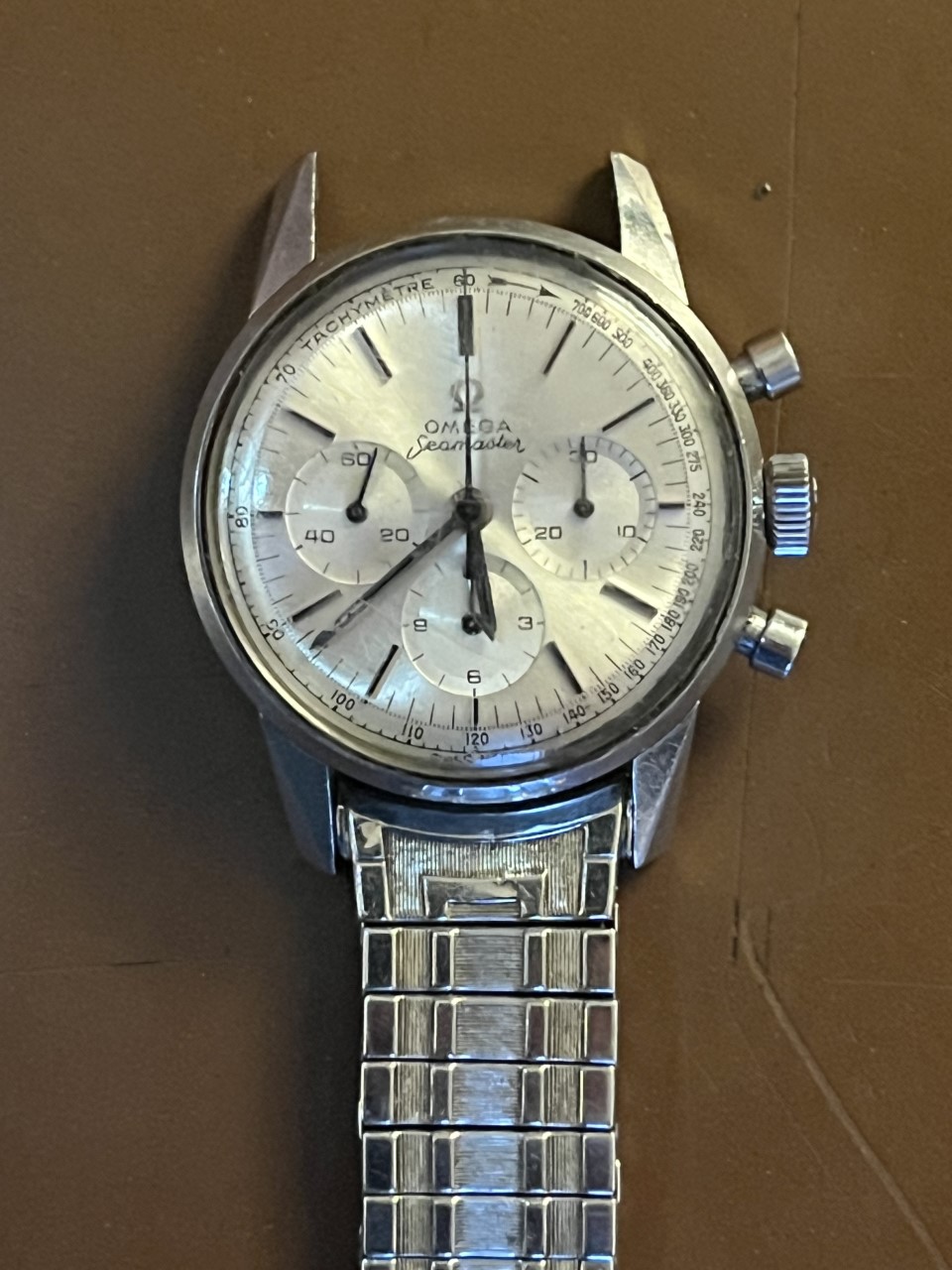

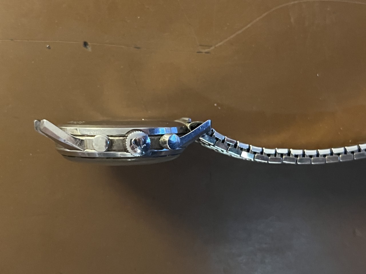

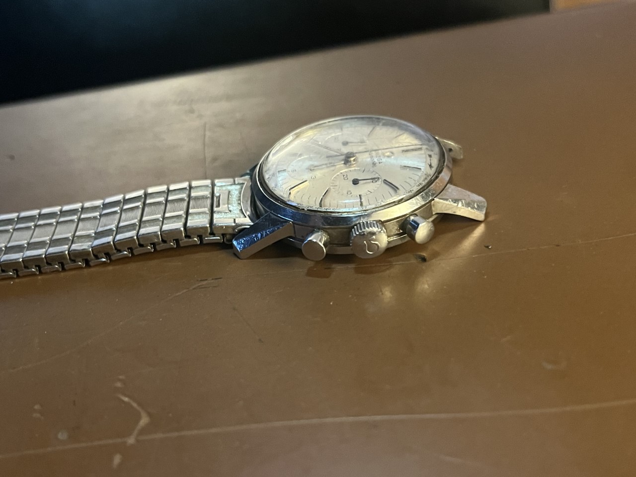

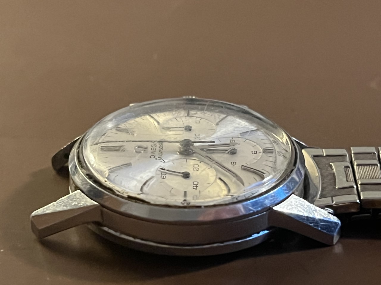

My wife's grandparents generously gifted me this watch. They knew that I was interested in watches and gifted me this (and a Wakmann Triple Date), along with several other 1960's watches for Christmas. I have visited a watchmaker and was told that for around $700 it could be made to look brand new. This watch maker is very professional and gets great reviews locally. He works on high end watches. He has special polishing wheels as to not degrade the facets during polishing. Any suggestions regarding polishing the case and the crystal? I'm really new to this and I don't want to ruin this watch. Also, I plan on keeping and wearing the watch. I just don't want to completely ruin it's value. Any help or suggestions are greatly appreciated. Neither the Omega or the Wakmann are currently working. As you can see in the last pic the caseback indicates that the ref # is 315.164 and CK2947/1
2,816
6,951
Thanks for sharing, it’s a nice watch.
I would highly suggest that you do not polish the watch as any polishing will decrease collector value, even with a “special polishing wheel”. You can always polish a watch later, but you cannot un-polish it. Crystal - polish away, that’s fine.
Just have the watch serviced, the case ultrasonically cleaned, the crystal polished, and that’s it.

Oh baby that's a nice Omega! As mentioned above please don't let anyone get near it with intent to polish. Also, welcome to the forum and please post pictures of the other watches so we can all get green with envy! 😁

You can replace that beat up crystal with no harm to the value, it may be too far gone for a polish.

There are some people who can actually refinish a watch case properly, but not many. I would tread very cautiously. I wonder if he could show you a few before and after photos.
13,999
54,300

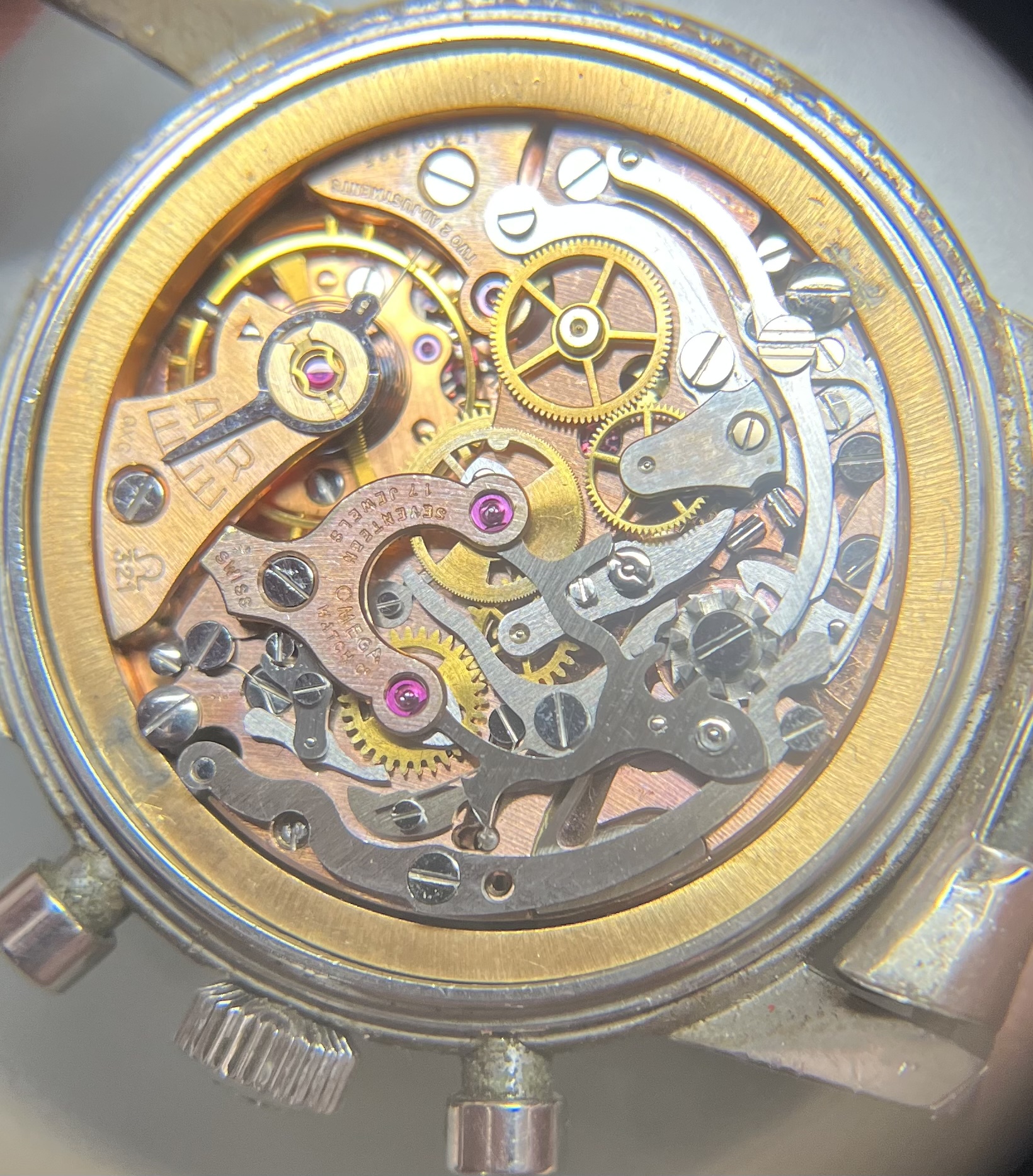

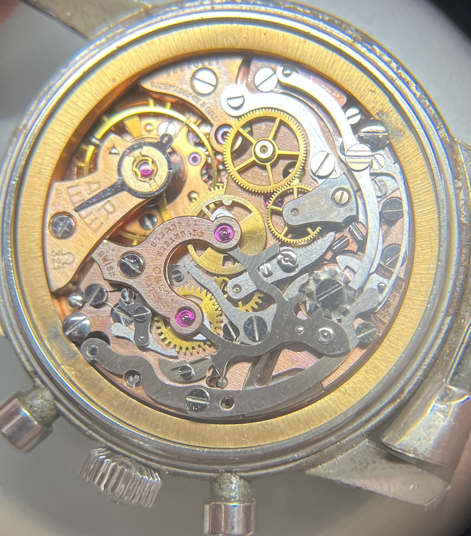

“Make it look like new” …..that would scare me. Movement only, perhaps a new crystal, no case work and stay the heck away from the dial. This should be the revered cal 321. Nice gift. Keep it real.

I love this watch!! any pictures of the movement?

Very nice catch. I'd recommend a service, perhaps a new plexi and a new bracelet. That's it. Nothing else.

Yes … get it off that horrid and abrasive Speidel.

Beautiful watch. A service, crystal polish and case clean is all you need here. Refinishing the case, even expertly, isn’t going to improve the watch. It will simply erase the history.

It's your watch, and if you intend to keep it, wear it regularly, and want it to look like new, go for it. I would highly recommend Tanner Morehouse.
Even if you change your mind down the road and decide to sell, refinishing the case may not significantly devalue the watch. It will certainly turn off hard-core collectors, but may attract others. It's a great piece, congrats!

Please do some research. Bringing back its beauty and “making it brand new” are two very different things.

Any good quality leather strap will look fine on your watch while you hunt. Definitely get rid of the bracelet that’s on it.
In my opinion, mechanical polishing of your watch case will utterly ruin it. Why anyone would want a vintage watch as good as that one to look “like new” is a complete mystery to me.

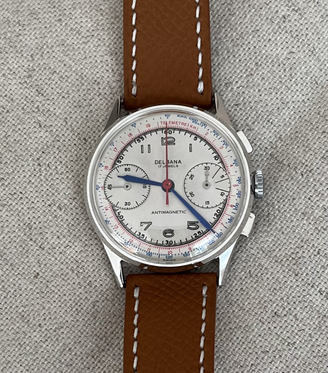

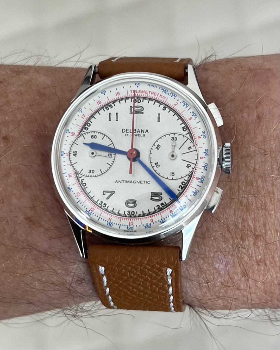

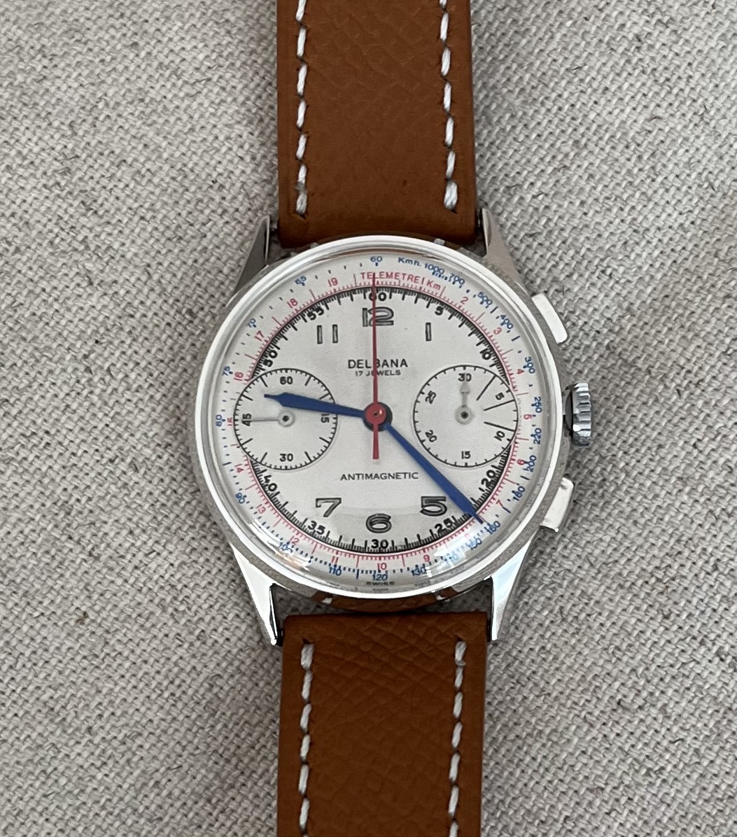

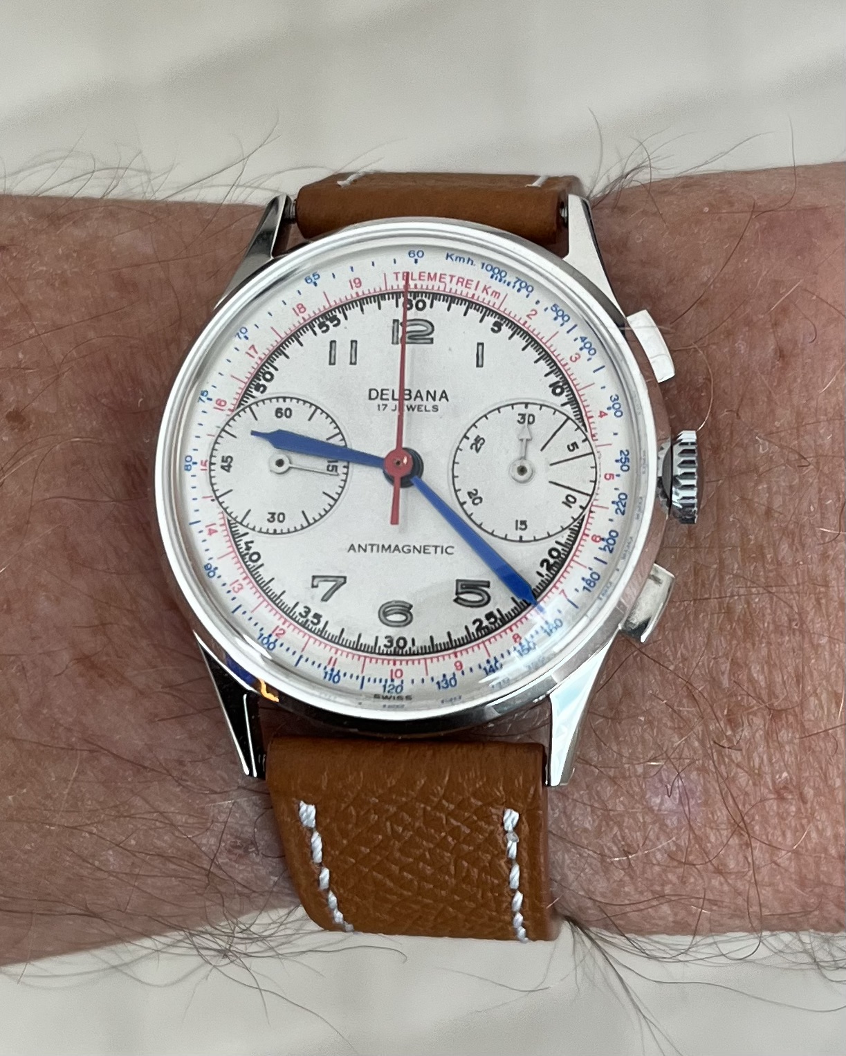

Beautiful Delbana! I recent got a very similar one. Is yours steel or chrome plated?
Thank you. It's steel, not plated. The dial and hands, btw, are almost certainly not original. But considering how little I paid for the watch, that doesn't bother me.

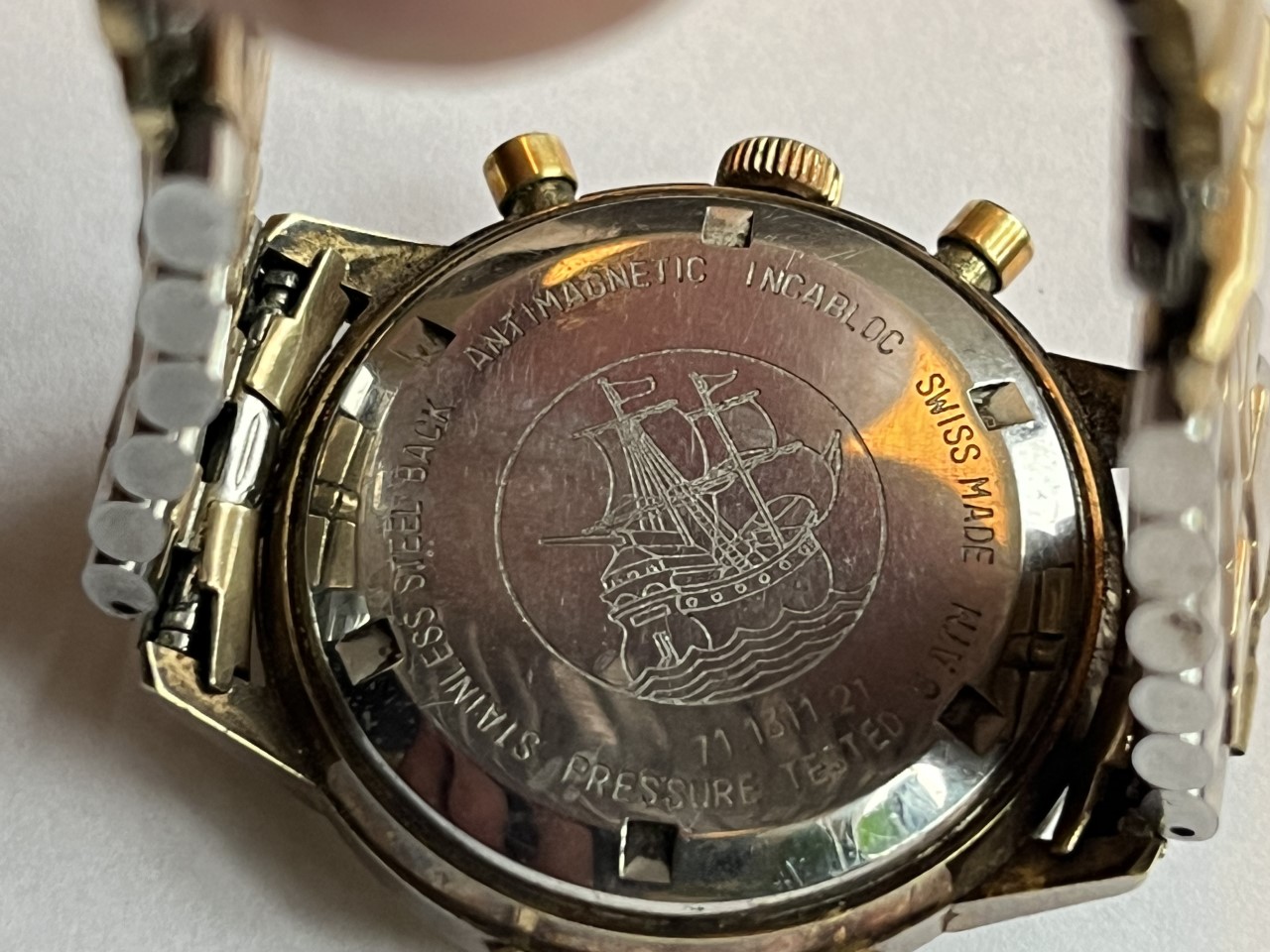

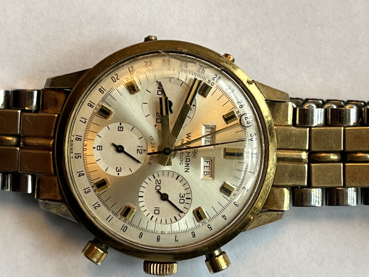

Thank you! It was an incredibly generous gift from them and I am grateful. I have always had a passion for watches and at 43 years old I have realized that I need a good hobby. I have found it. I now have a few tools to start slowly learning the hobby (of course I would never work on my own omega or other vintage or otherwise valuable watch). I'm just fascinated with mechanical movements and I appreciate the engineering and style of older watches in particular. Here are a couple pics of one other watch in the ziplock bag that they gave me that I know is special:
