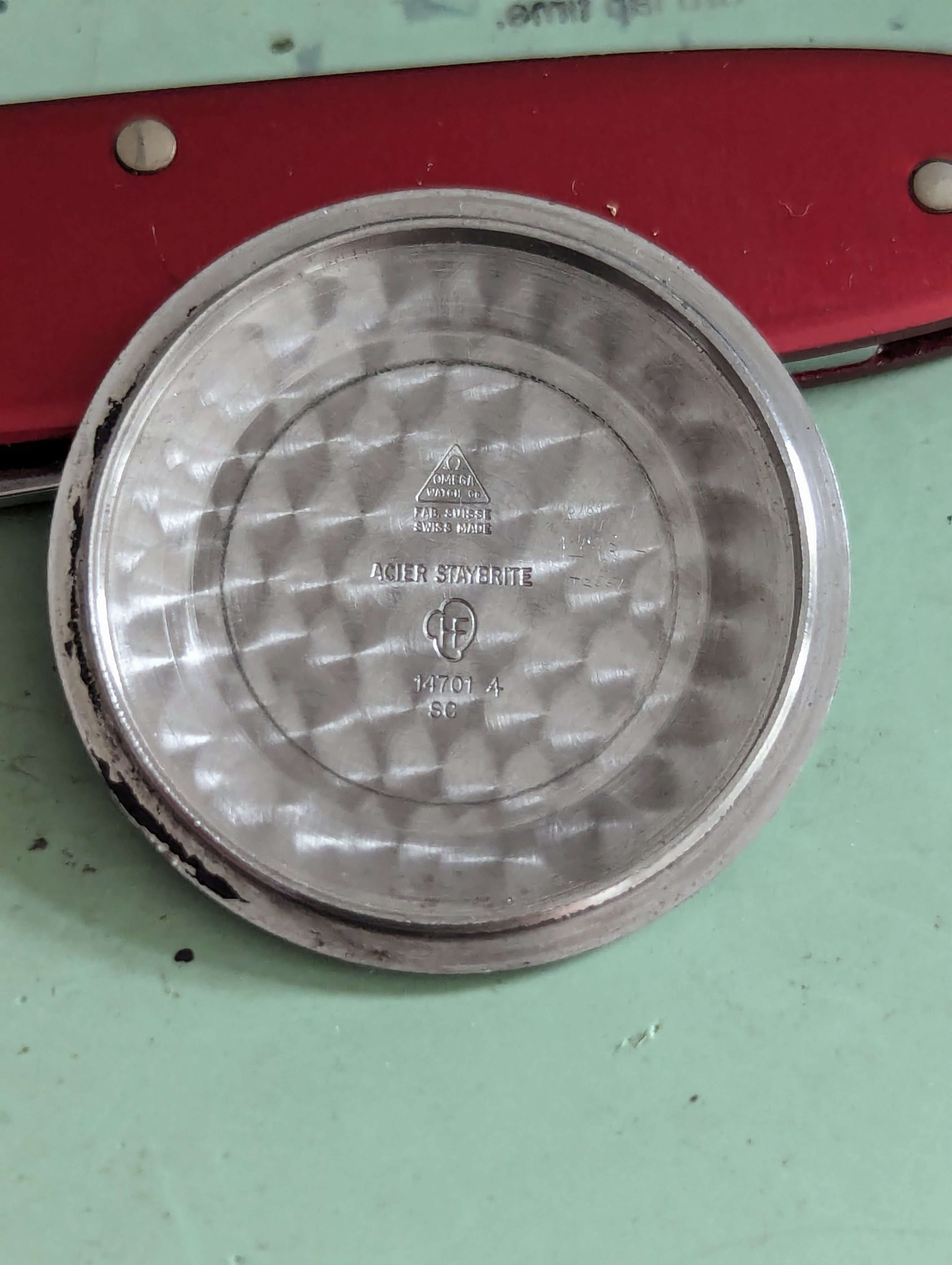

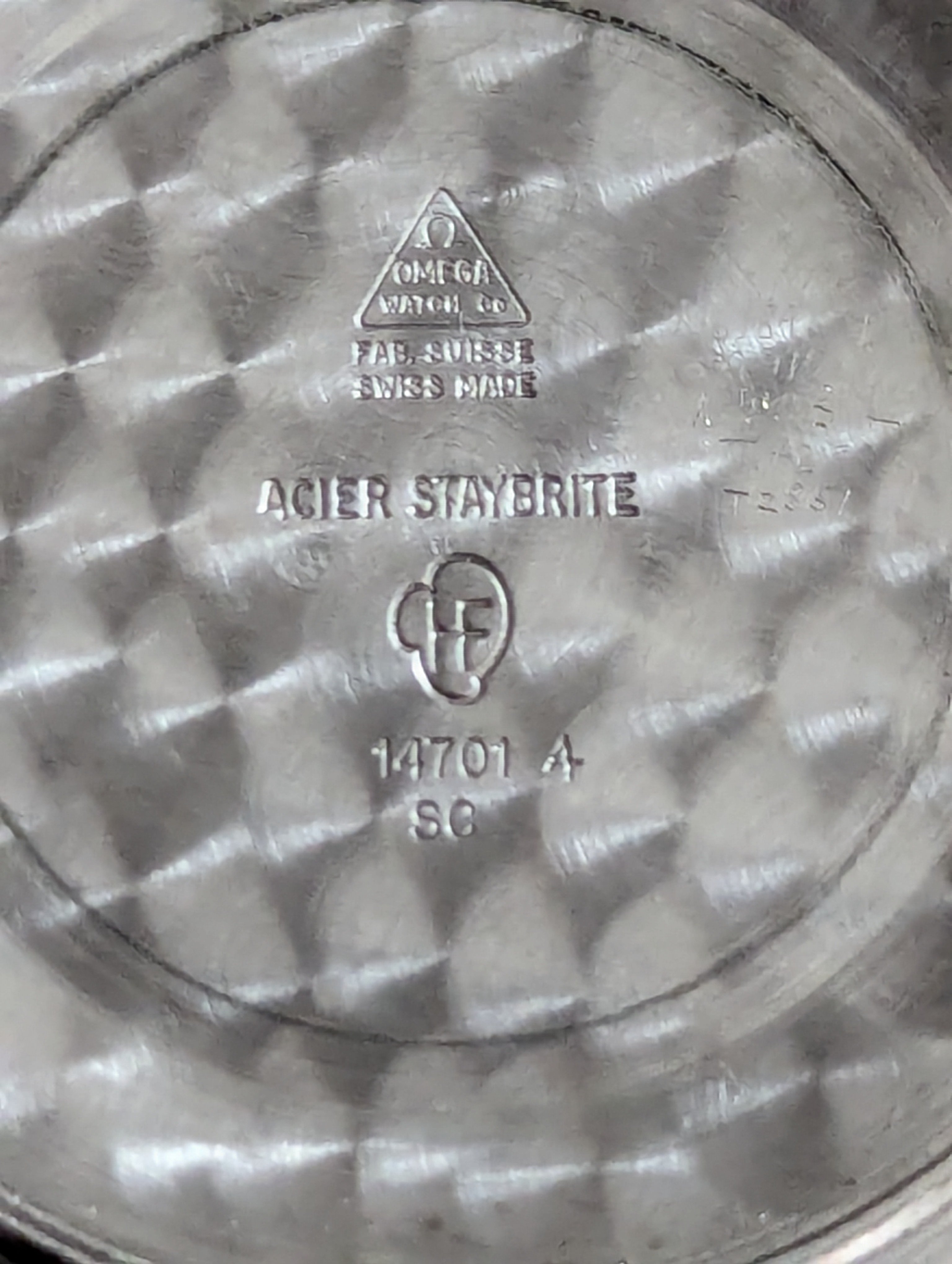

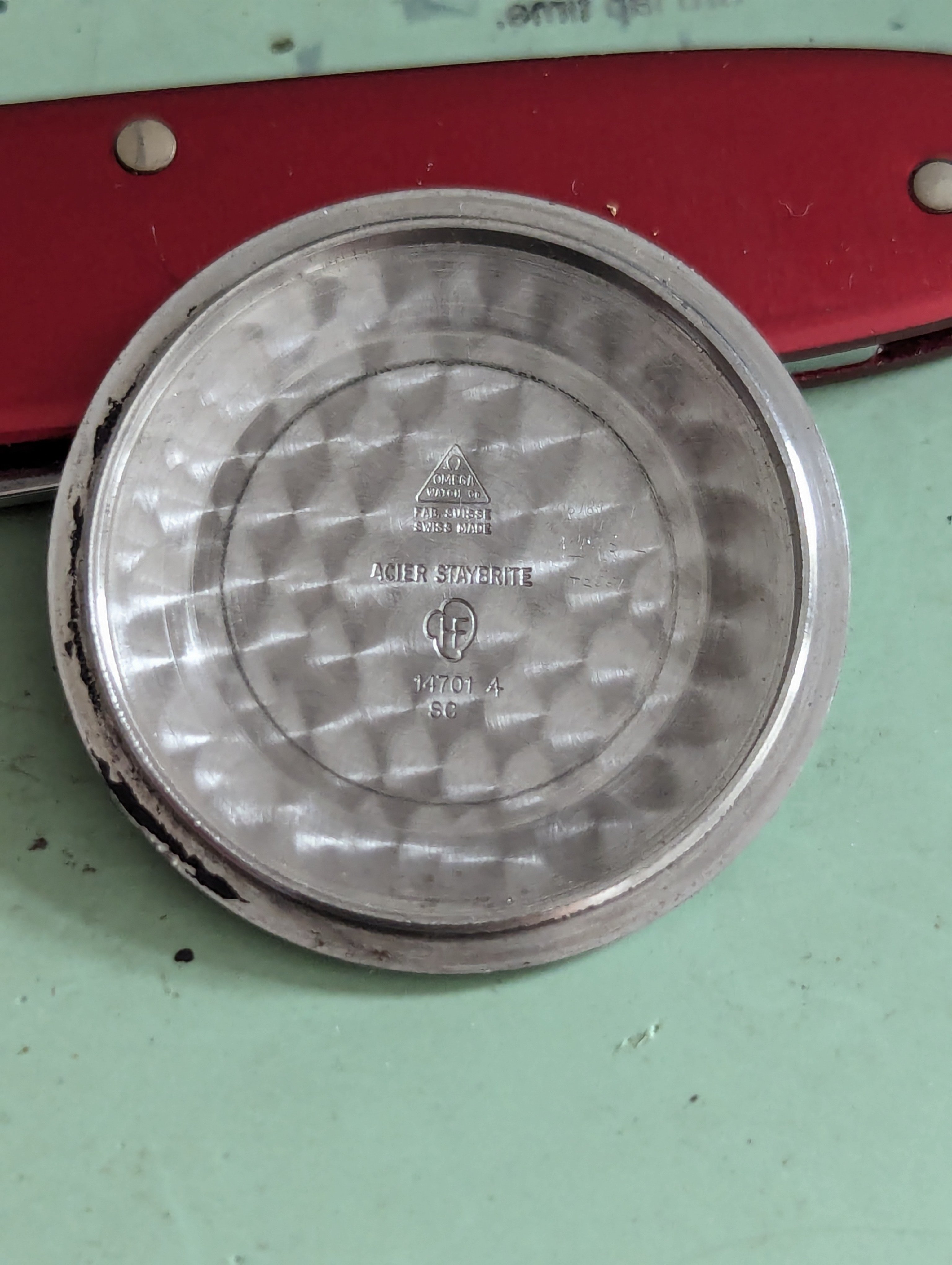

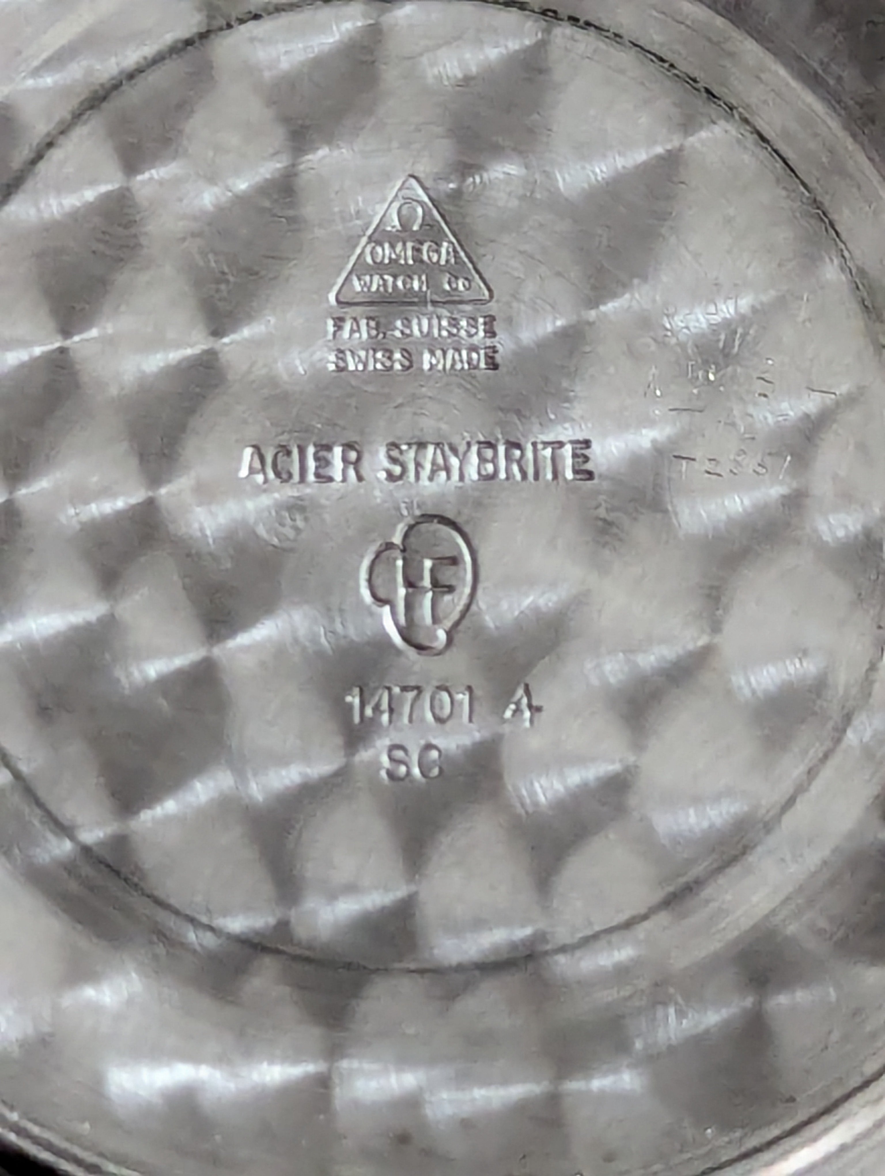

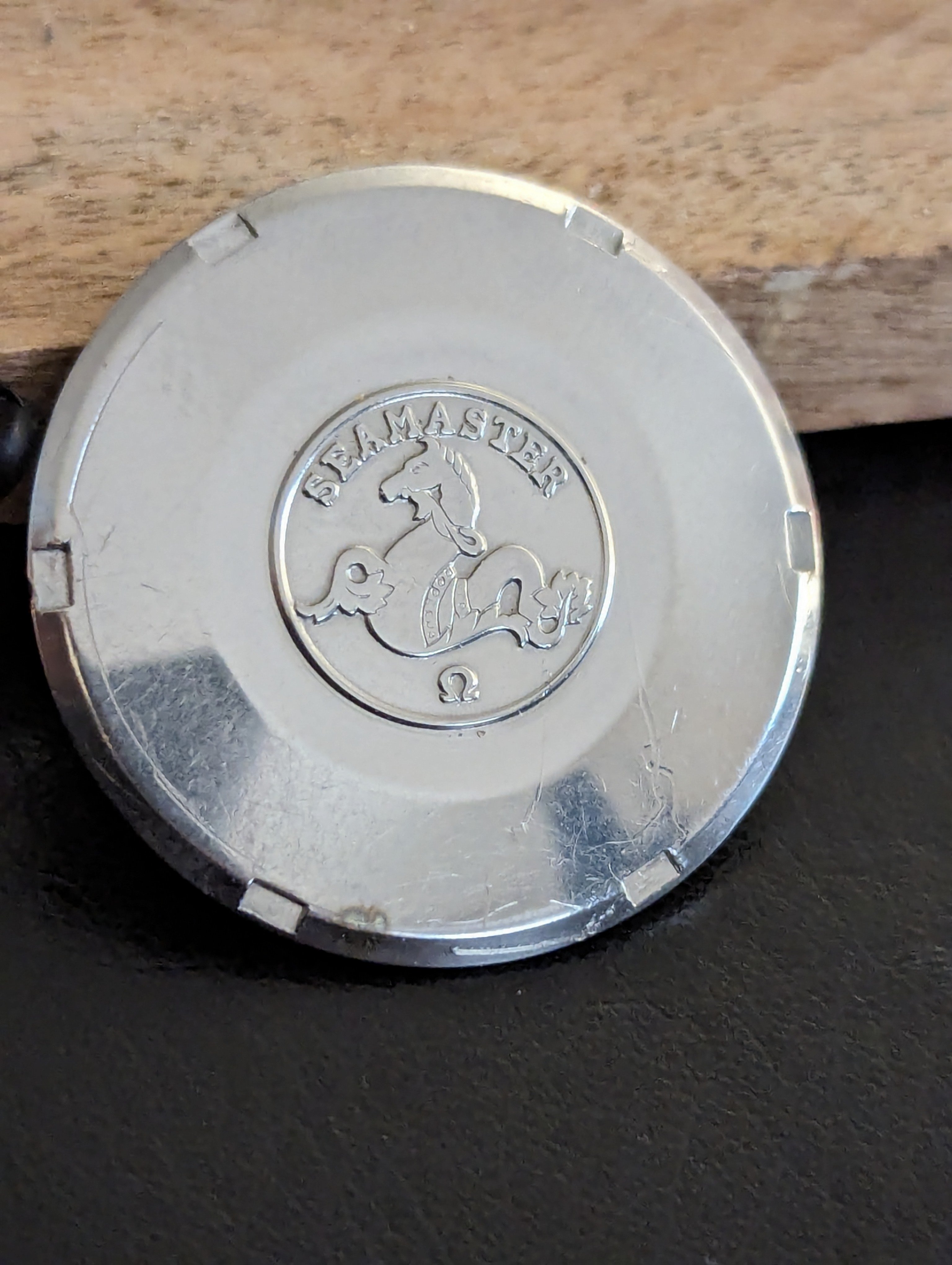

At the time of that thread, I was unable to open the back as it was seized to the case and I didn't want to damage it any. I had the tools but if I had done anything to it I would have been mortified! I had asked back then whether it was a genuine Seamaster or just an Omega with a Seamaster screwback fitted.
It's since been off to a watchmaker for a service and to confirm it's originality. I got it back yesterday but unfortunately nothing was done to it apart from them getting the back off and confirming it was genuine.

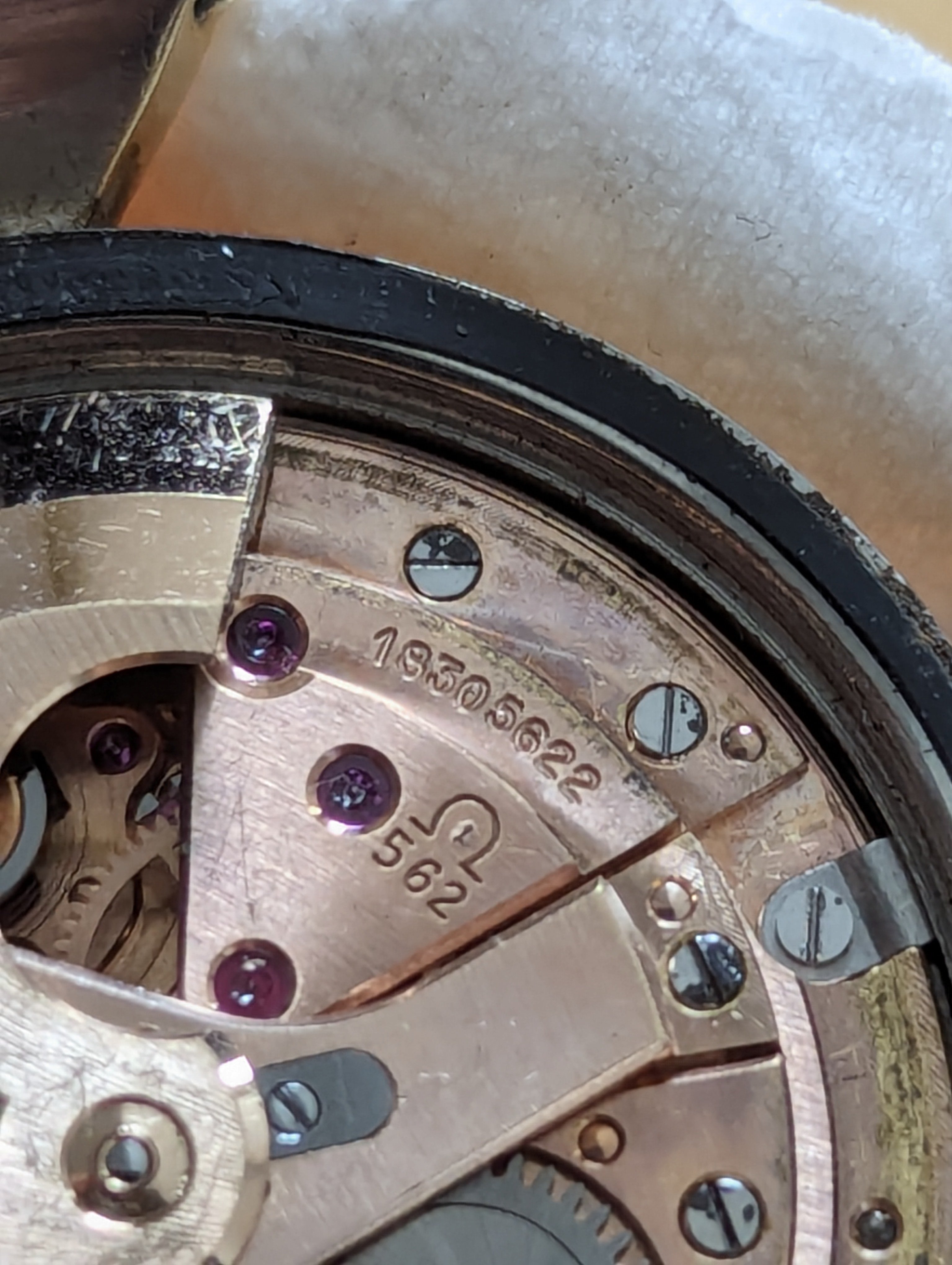

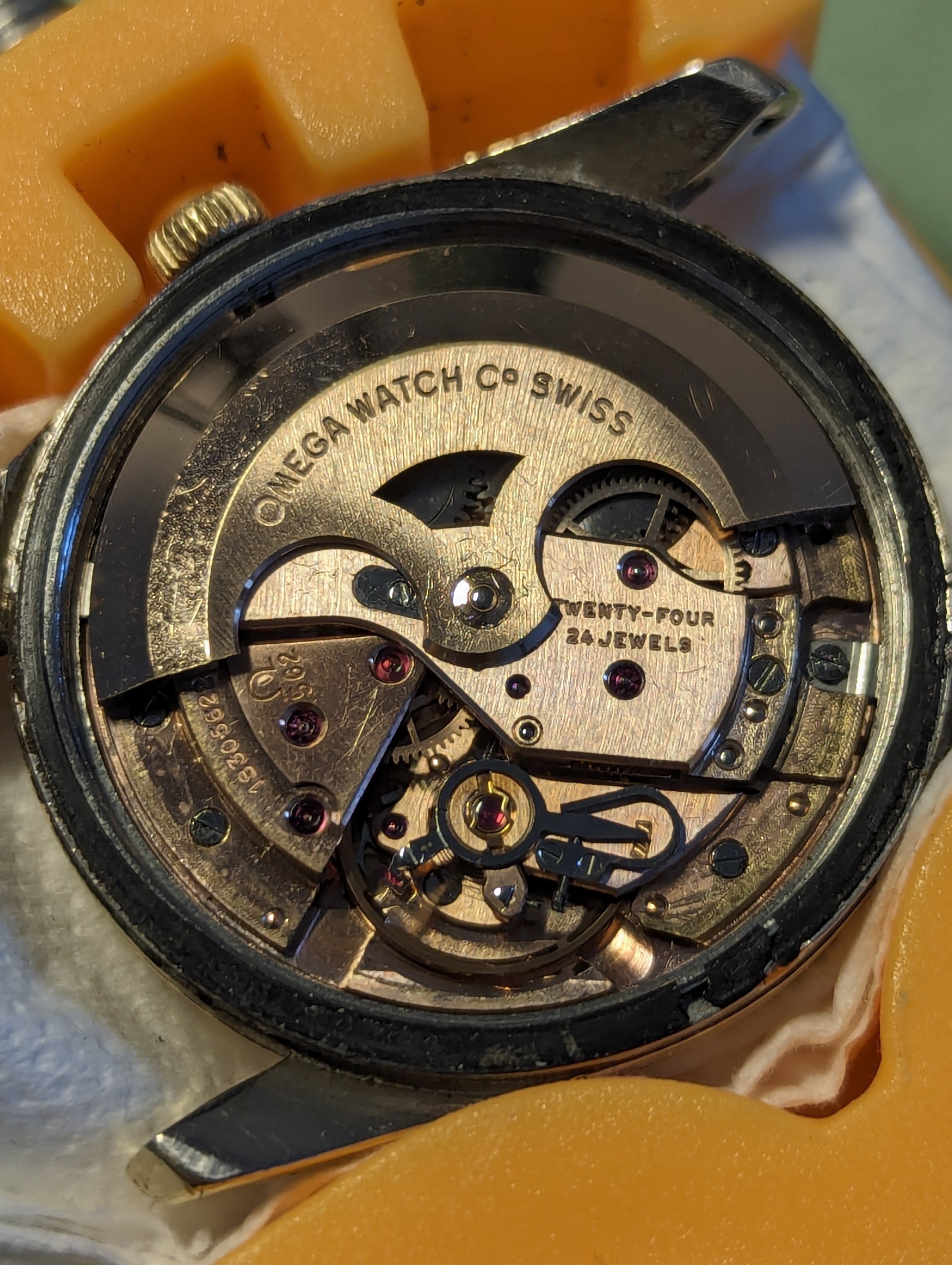

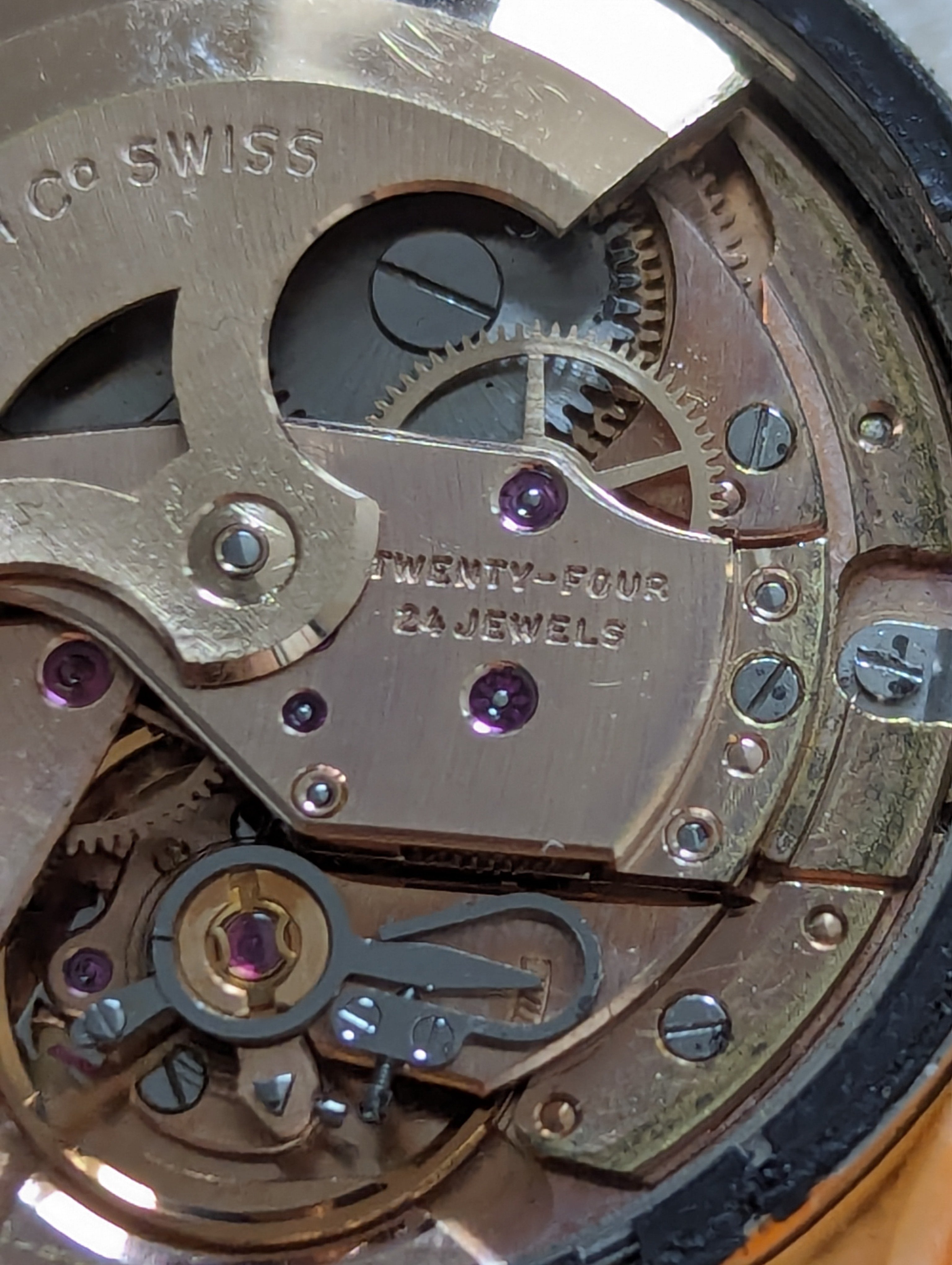

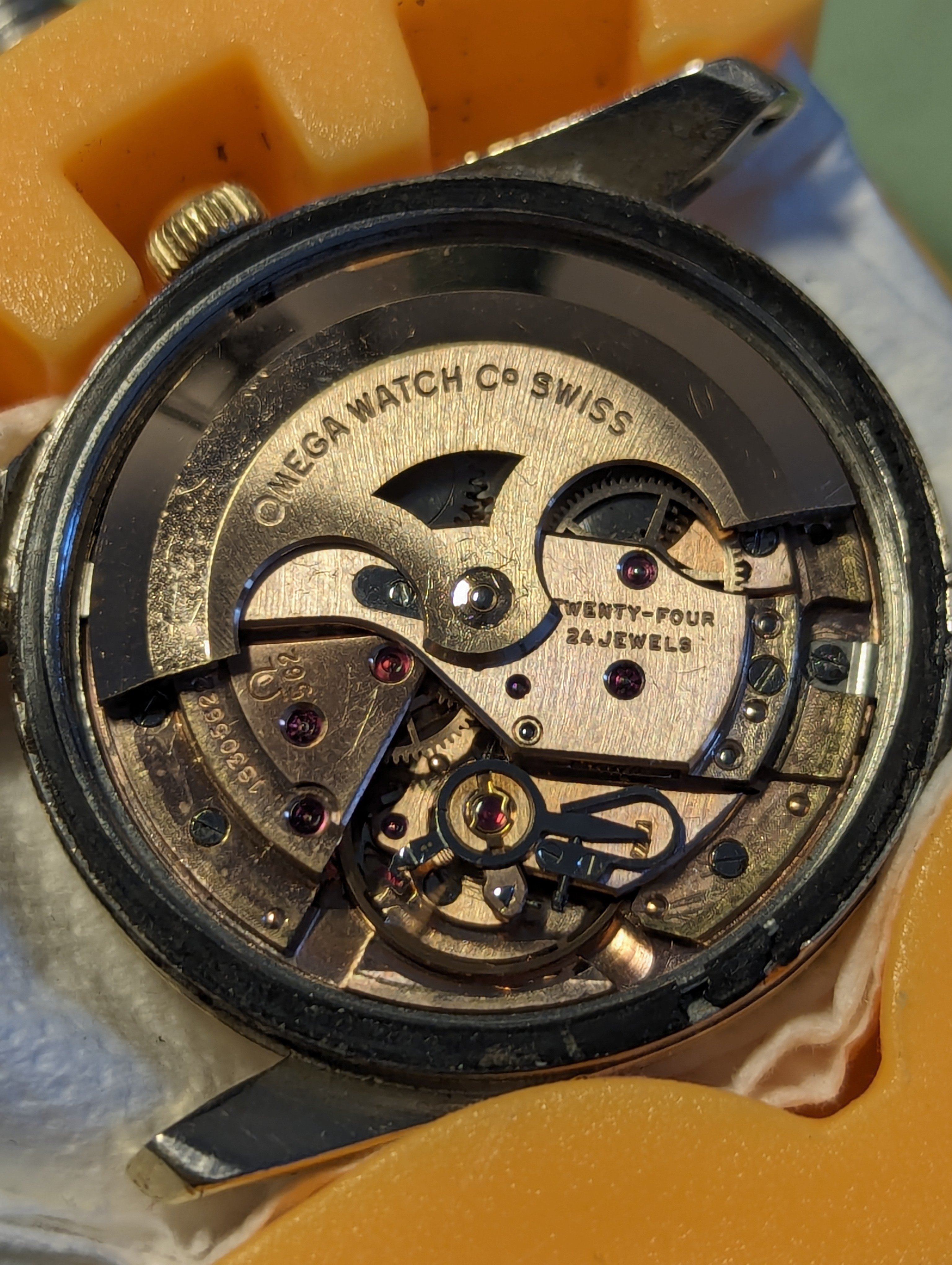

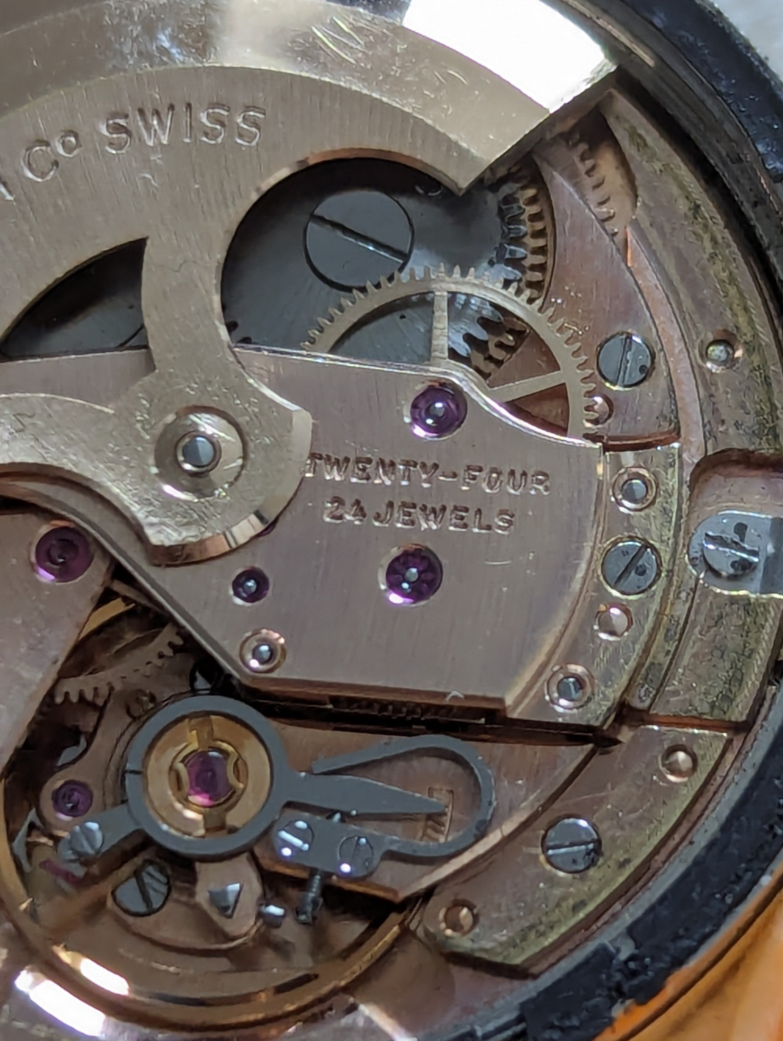

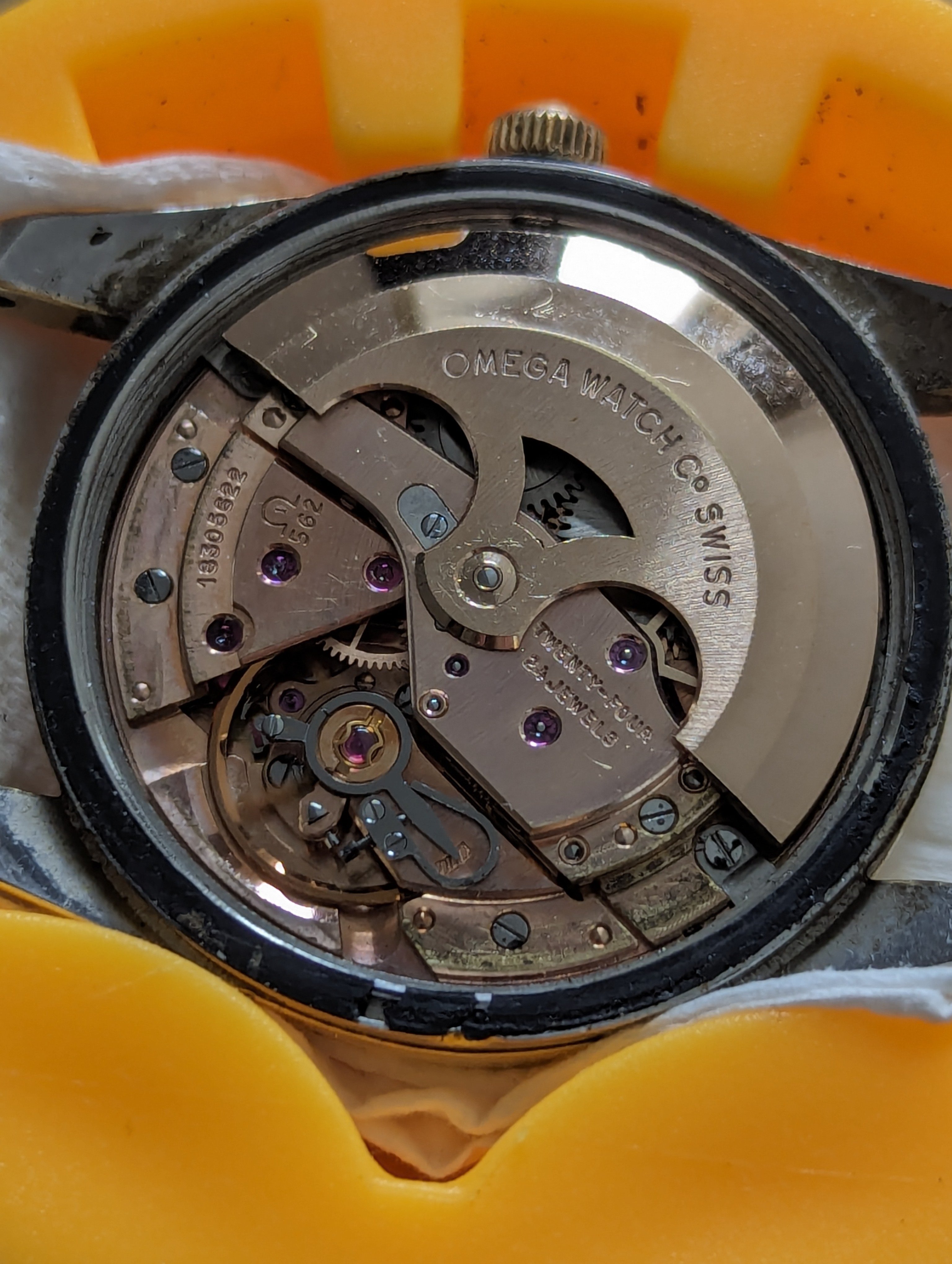

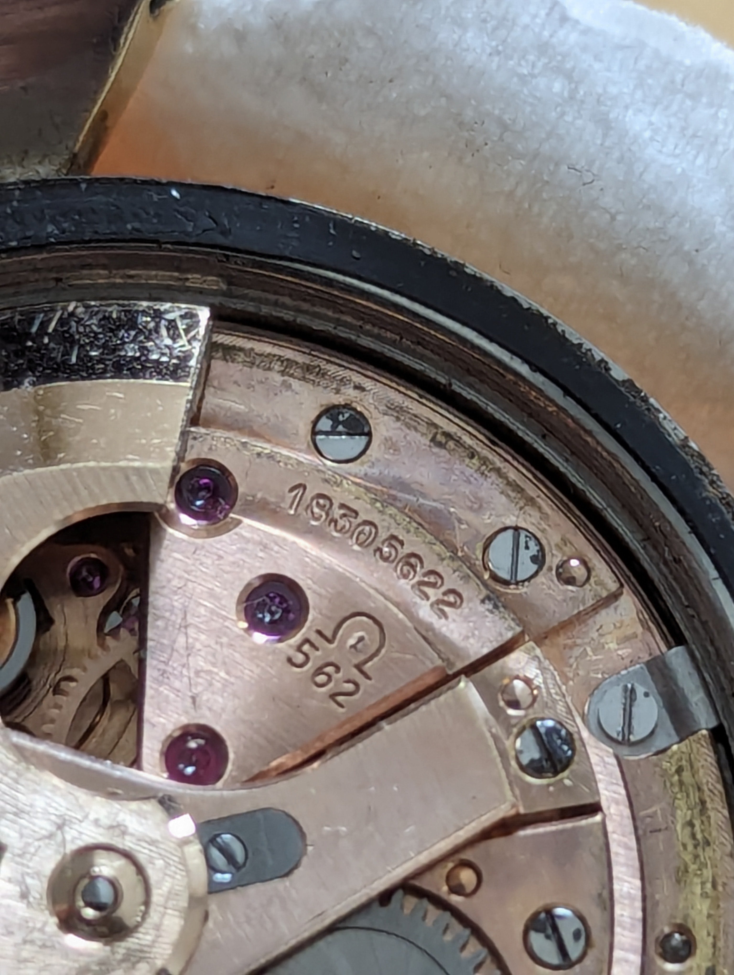

1. The reason the watchmaker returned it without any work done was because on investigation of the movement they found the auto reverser was faulty and couldn't source the part/s to sort it. To confirm to you guys, when the crown is pulled and turned, the seconds hand kind of catches and moves with the hands when going anti-clockwise. Clockwise it's all good. I can wind it in my hand clockwise and it runs fine, if a little out on timing and the date wheel changes at 12 with no issues. It's got the 562 cal, 24 Jewel movement. Was the watchmaker right in not servicing it with the mentioned problem? Is it possible to service it in it's current state? What's involved in this sort of repair?
2. The other things that need doing is a new gasket and crystal, which should be easy to sort I guess? The existing gasket seems like plastic and is broken. Also I can't get it out, it seems wedged in the channel? Weirdly I have a gasket of the same material from a 1977 Seiko which randomly appears at a quick look to be at least the same diameter as this watch's channel, it's a match when laid loosely on top. Do you think I can do a swap or will I need an Omega specific one?

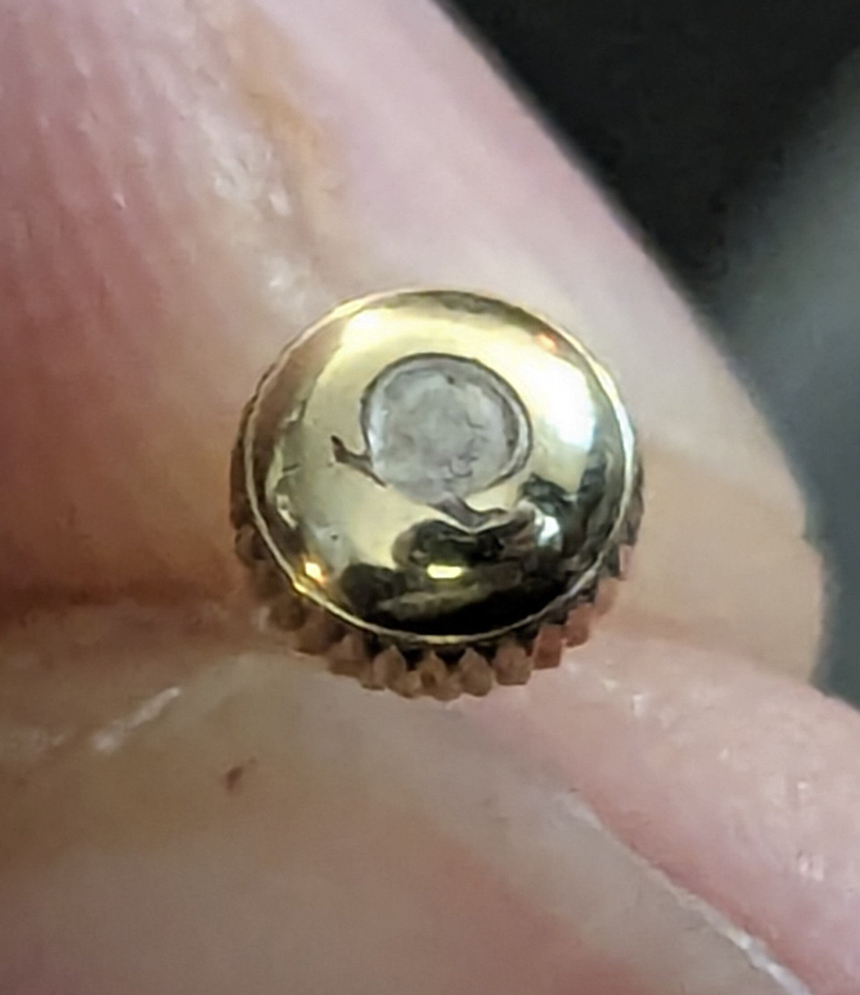

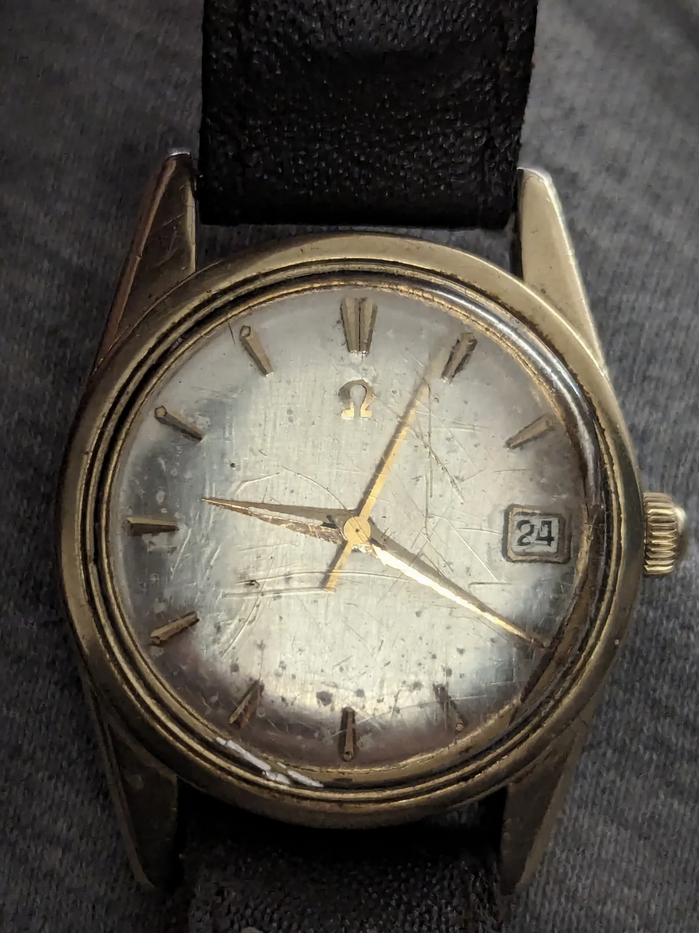

Some internal pics from today and an older one of the front. The crystal makes it hard to see the exact condition of the dial:

Nothing you mention should be difficult for a qualified watchmaker to sort, sounds like you need to find a better watchmaker, preferably with an Omega parts account.
2,348
1,476
Reverser wheel is available and used in a number of Omega movements of the same time frame, so maybe just didn't want to.
There is a tool to open them up to clean
Hand moving backwards. Happens, but doesn't damage the movement
Company in Ontario, Canada called Dialcraft which is reasonable for dial refinishing. Do a search on the reference number (inside case back) and find a dial similar to yours and print it out.

For the movement. Can email or call Simon Freese He will find a new crystal and if you want. Could ask for a generic one. Will save quite a bit of money
Maybe show the dial

If you show photos of the rest of the watch, including the dial, we can probably give you more comprehensive advice. Also, it might be helpful to give us some idea of your goals with this watch. How much sentimental value does it have? There are many options. You could do nothing, and enjoy it as an artifact. You could have the mechanism restored, and enjoy it as a functional watch that is cosmetically identical to how the previous owner used it. You could have the movement repaired, dial repainted in a relatively economical way, and other cosmetic parts (e.g. the crown) replaced with period-correct parts. Or you could send it to the manufacturer for a comprehensive restoration. The prices for this range from zero to thousands of dollars.

I just ordered a 552 off ebay. Similar to this watch. I have had a dial for decades for which I wanted a case and movement.
So I have been researching the so called 500 family of watches. The 562 is a base caliber, so the earlier parts are not compatible.
So far my parts searching has been productive. They made a lot of these watches and there are still quite a few spares in the pipeline. In some ways this is where the quality started to roll off in the early 1960s. OR These were some of the best watches ever made.
That must have been an exiting time in the industry. There were constant 'improvements' to the winding setups. New materials tried Wearing surfaces adjusted for improved reliability. Early use of computer analysis.
The UK still has a lot more of the traditional craft. So you are fortunate to be there, where there are at least a half dozen or more whom to choose from.

@Dan S I would like to get the movement out so I can see the dial without the crystal obscuring the view, but I'm not 100% sure on how to. The crown/stem was easy, but the movement seems secured in by a couple of screws & "brackets" for want of a better word. I'm worried about trying in case something goes wrong!

Regarding the two specific questions in your post:
- A simple service (disassemble, clean, lubricate) is not likely to return the watch to good operating condition. Obviously the auto-winding will not work properly and there may be other issues. However, if you are on a very tight budget, you could simply remove most of the auto-winding mechanism and use the watch as a hand-winder after a service. Even bringing the base movement back to good working order might involve repairs and/or replacement parts, but it might be less expensive.
- A generic case-back seal is fine.
As for the un-asked question, the dial is indeed ruined. Your options are the ones I already gave you in my previous post.
