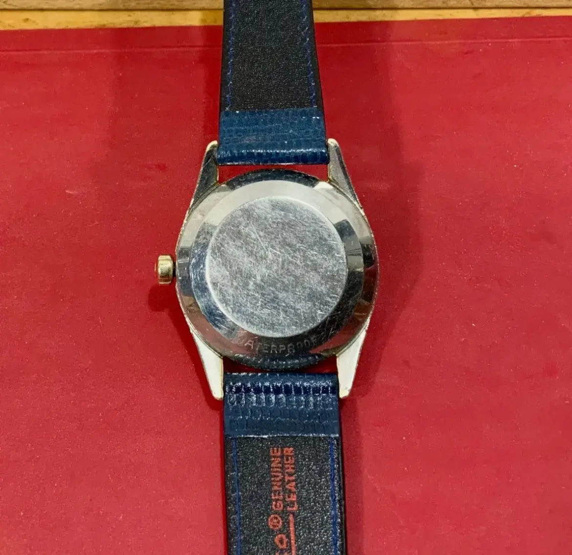

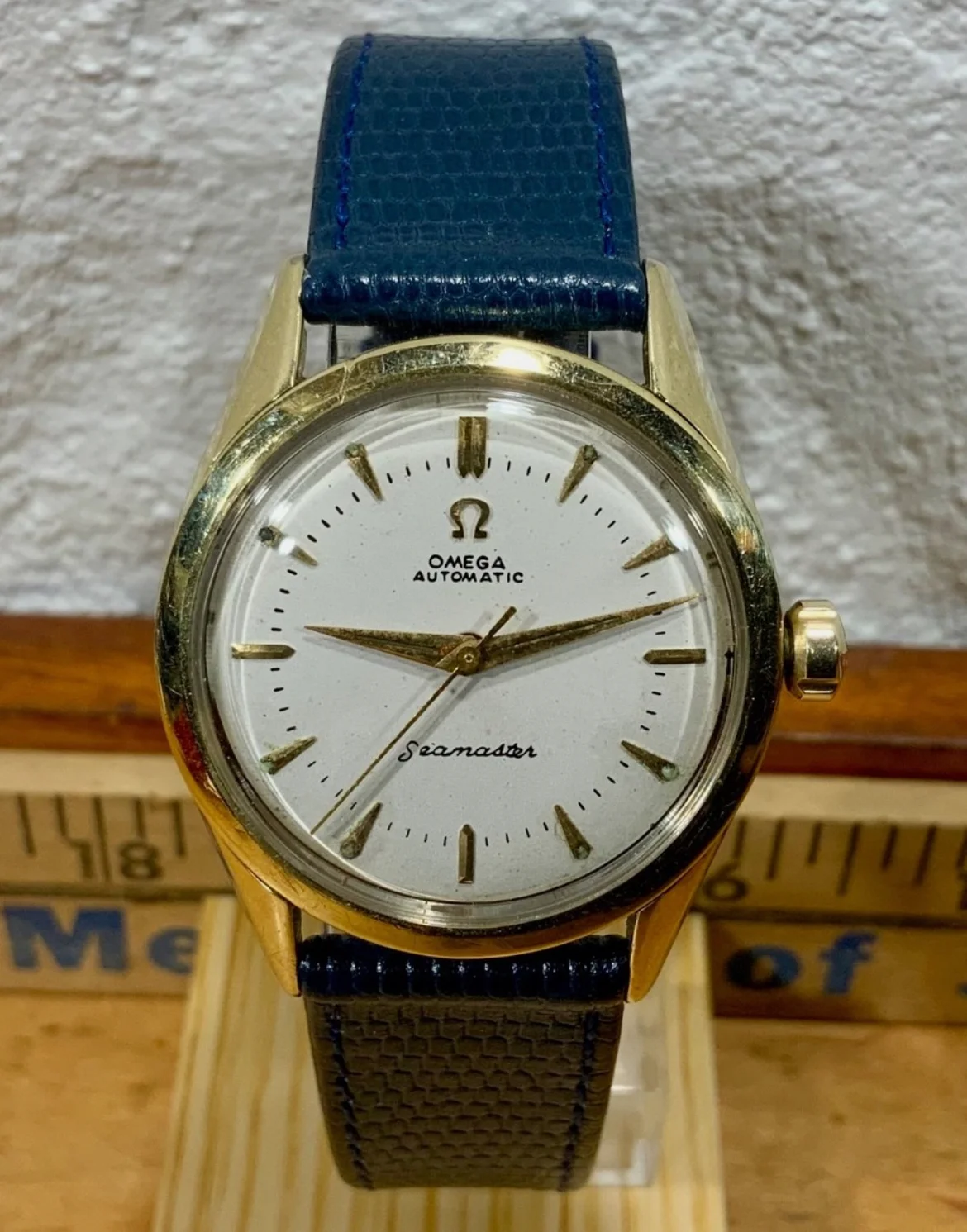

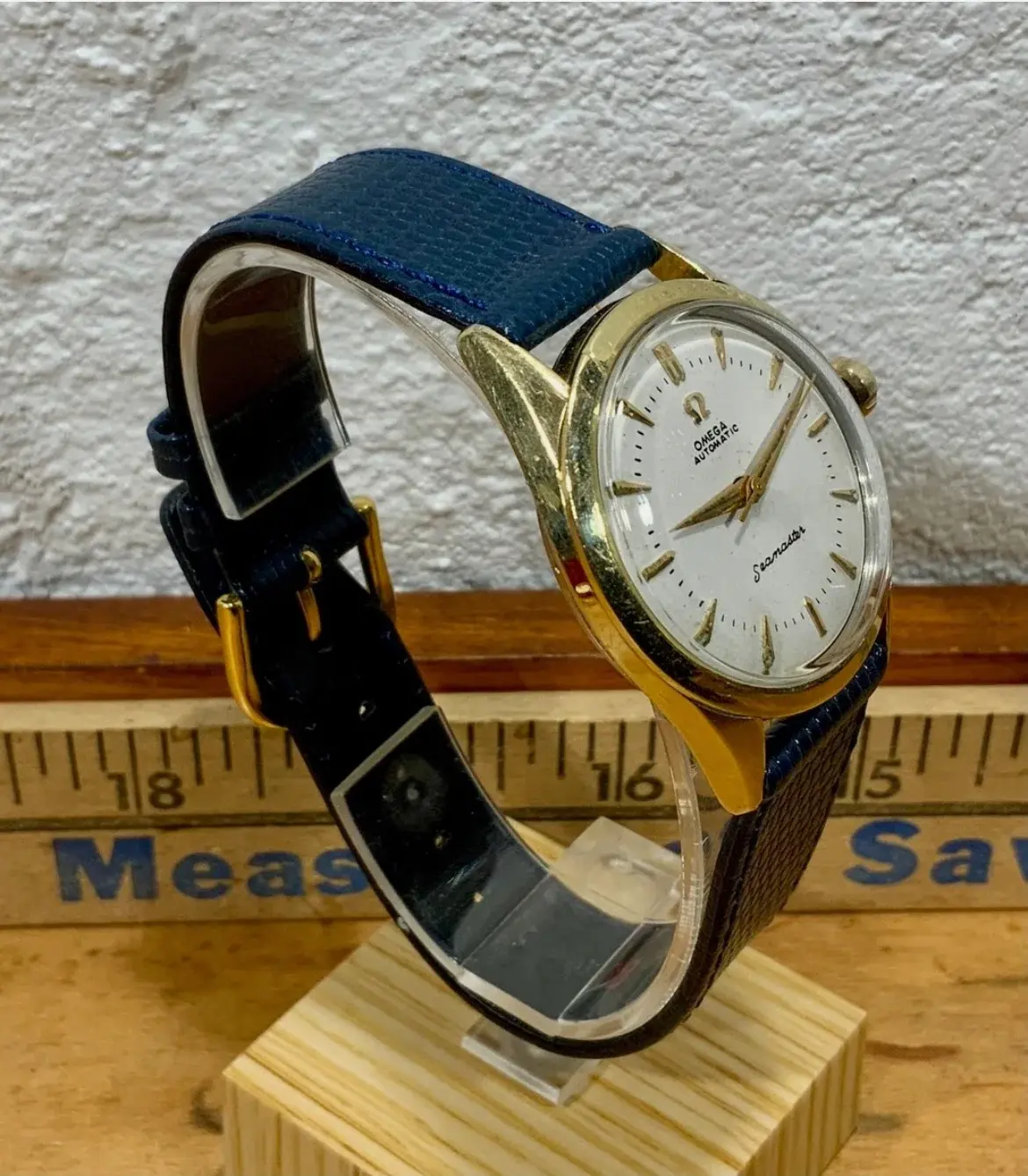

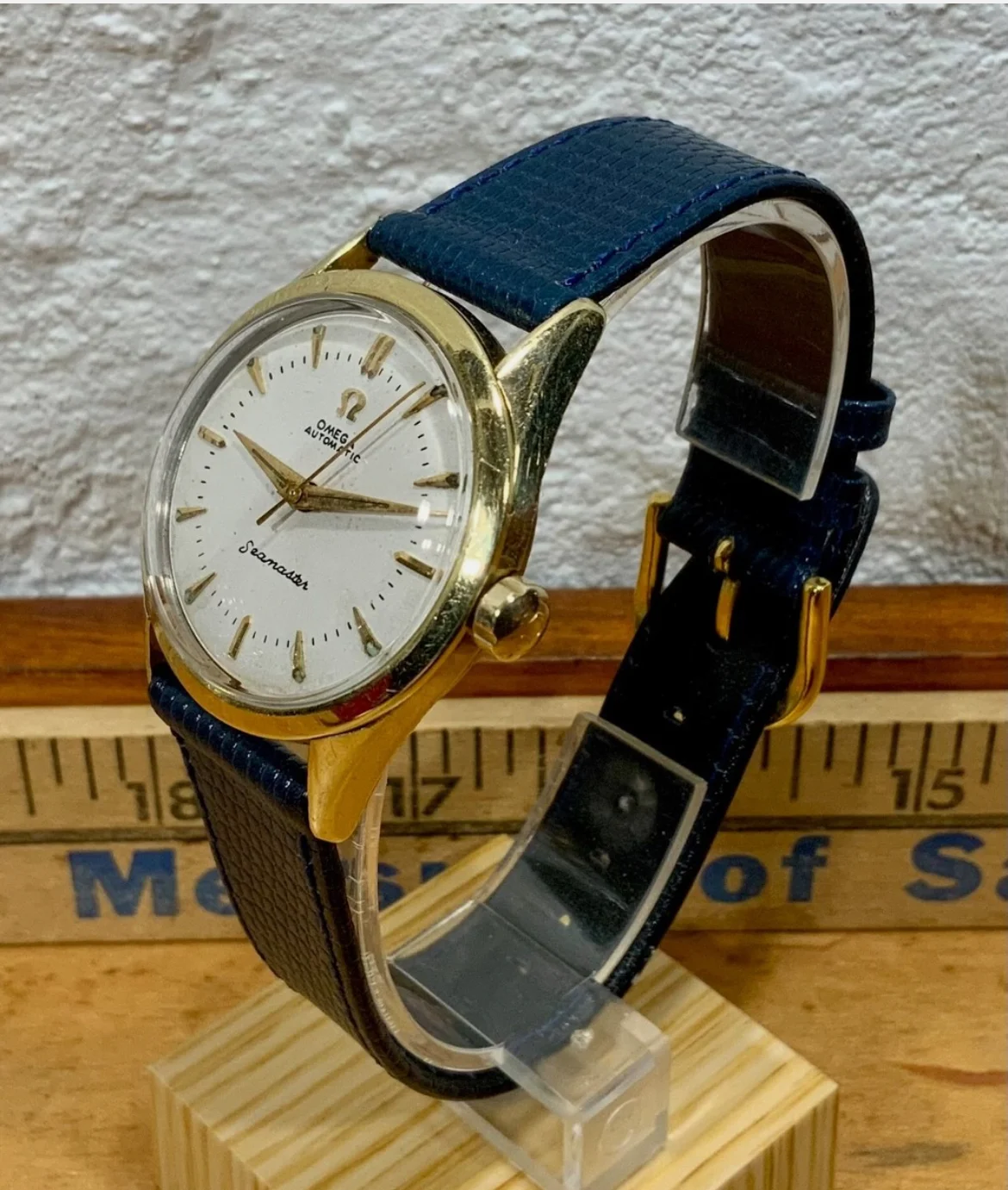

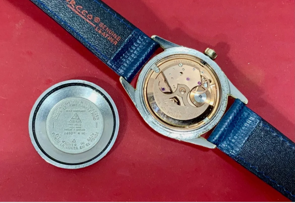

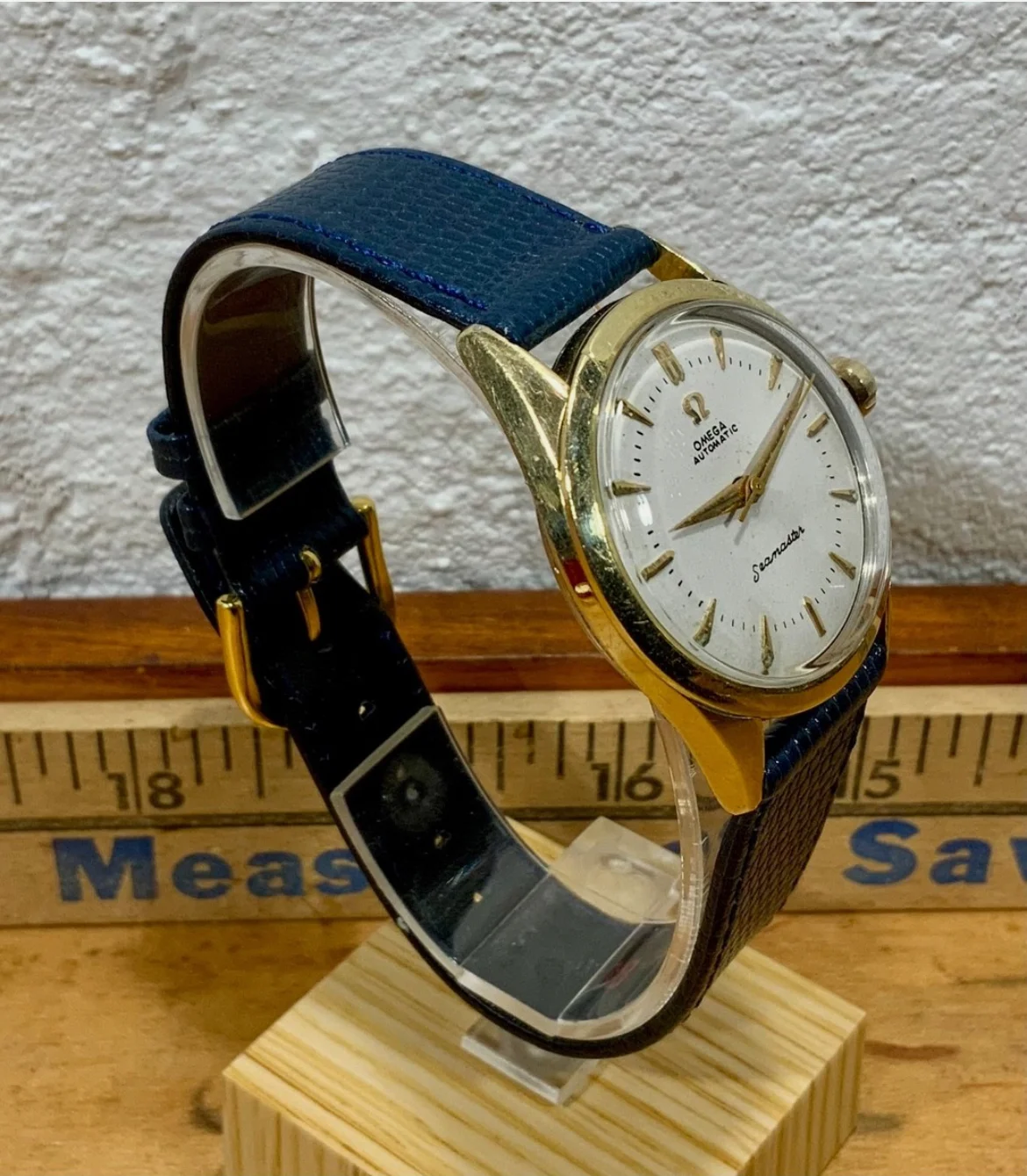

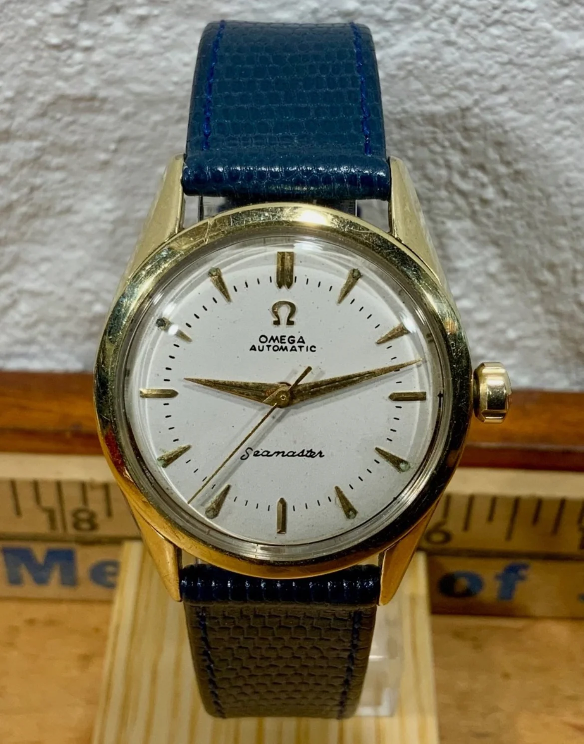

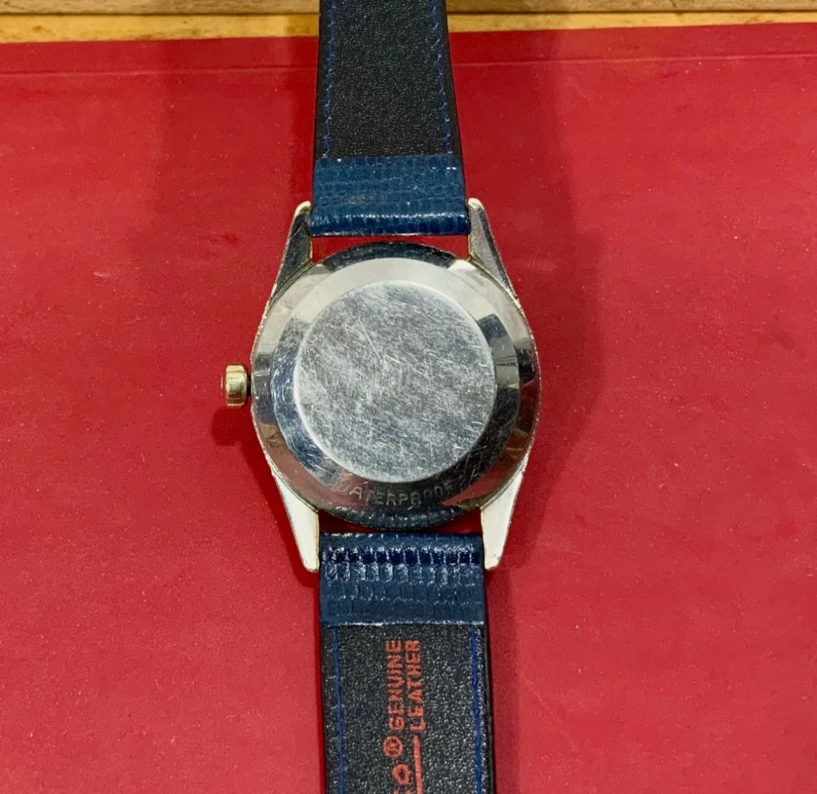

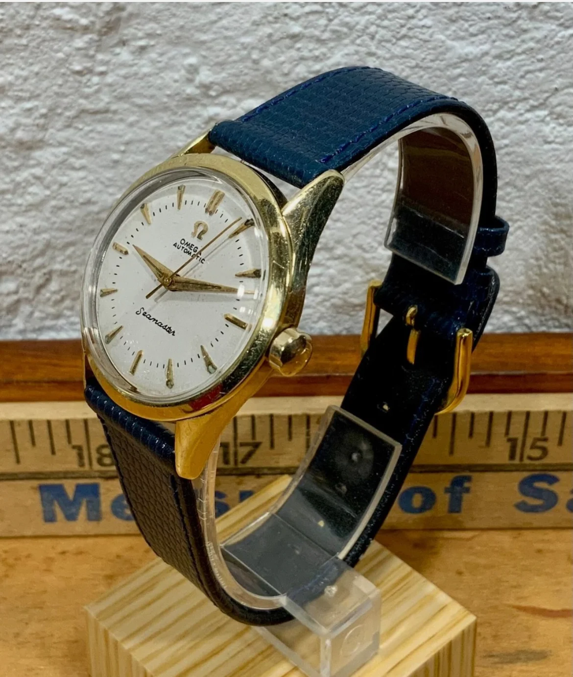

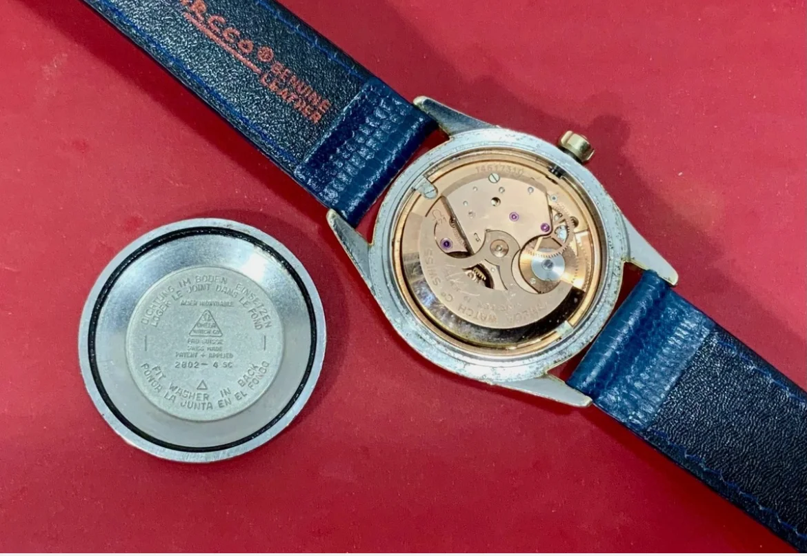

I just bought a vintage Seamaster and I'm wondering about the authenticity/originality
of the watch - what do you think?

Authentic - yes.
Poor redial - yes
Heavily polished case - yes

Thank you 🙏🏻 - anyone else thinking the same / different?

One of the worst redials you will see. In fact, I am adding it to my comic library.

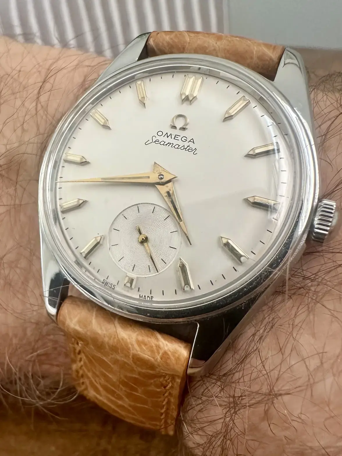

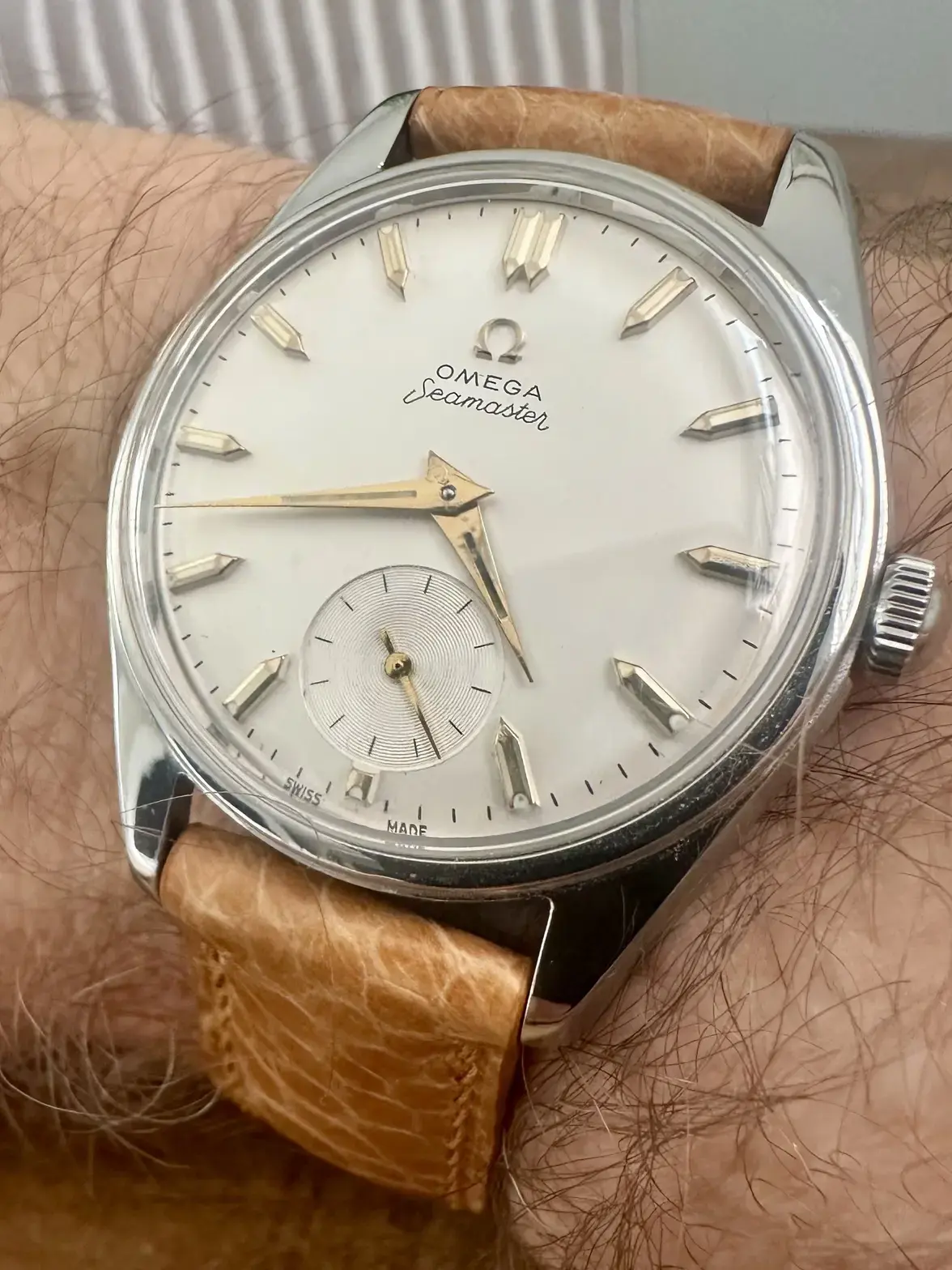

Here’s a 1950’s Omega Seamaster from my collection (not a 2802’s). Look at it carefully, especially the dial, and then look at your dial. You should be able to distinguish why your watch is a redial.

Sorry but that’s a terrible watch. The dial is horribly, horribly repainted and the case is in poor, heavily polished condition.

Unless you got that REAL cheap (like $200), you got scammed. If you can get a refund, you should. Else, hopefully a lesson.
