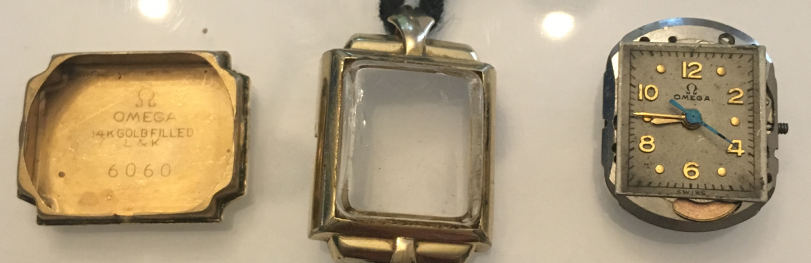

    I picked this up for $11 the other day and was hoping to find a crown that might work with it. I wasn't sure if I would be able to track down a crown and expect it to fit the threads or if I need to find a whole replacement stem+crown.
    At $11 I'm not really concerned if it never runs again but I think it's an interesting piece and I'm a sucker for the blue second hand so I'd like to give it a shot.
    Does anyone know what movement this actually is, I was hoping for the standard 3 characters to go by but all I see is OX6 and that didn't come up with many results.
    I know there aren't many posts for women's watches so it might be a long shot.
    Thanks in advance for any help.

    Why don´t you measure the stem an seek for a non branded crown which matches the thread and the colour of the case?

    Yeah, I'll probably grab a generic one for now and try and track down a branded one in time. Trying to figure out what to look for on ebay is where I'm hitting a road block now.

    Going by the movement serial number I am quite confident that the watch originally had an unbranded(=smooth) crown
    And it seems to be a US cased example - so I would not bother too much about the crown...

    The movement looks like the 240, 250 family, or even R13.5SC, but fitted with an indirect center second complication.

    It's either a 250 or 251 - the 252 has Incabloc...

    "Does anyone know what movement this actually is, I was hoping for the standard 3 characters to go by but all I see is OX6 and that didn't come up with many results."
    FYI - That is actually OXG, the US import code for movements imported by Norman Morris, the US importer for Omega products at the time. As already noted by @mac_omega, this is a US cased watch.
