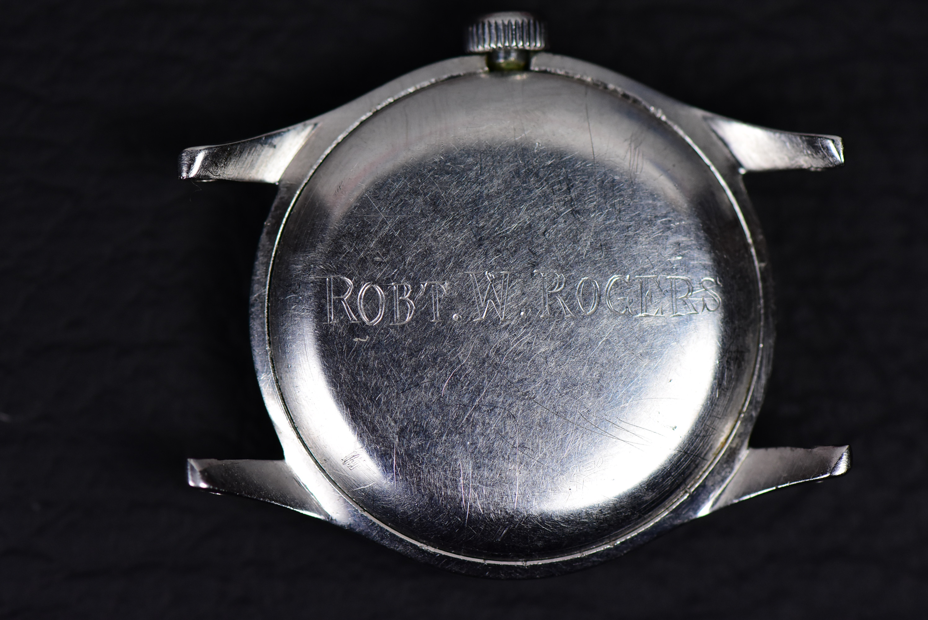

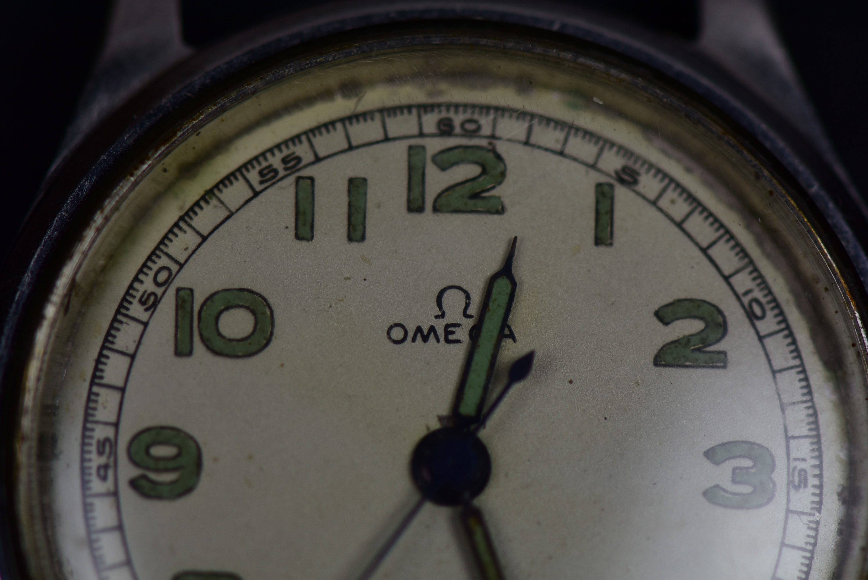

I own this watch, inherited from my grandfather 10 years ago. His name is engraved on the case back (Robert W. Rogers). This was a one-owner watch, with no known service record but my grandfather did not have much money to support upgrades or modifications. This was a prized possession.

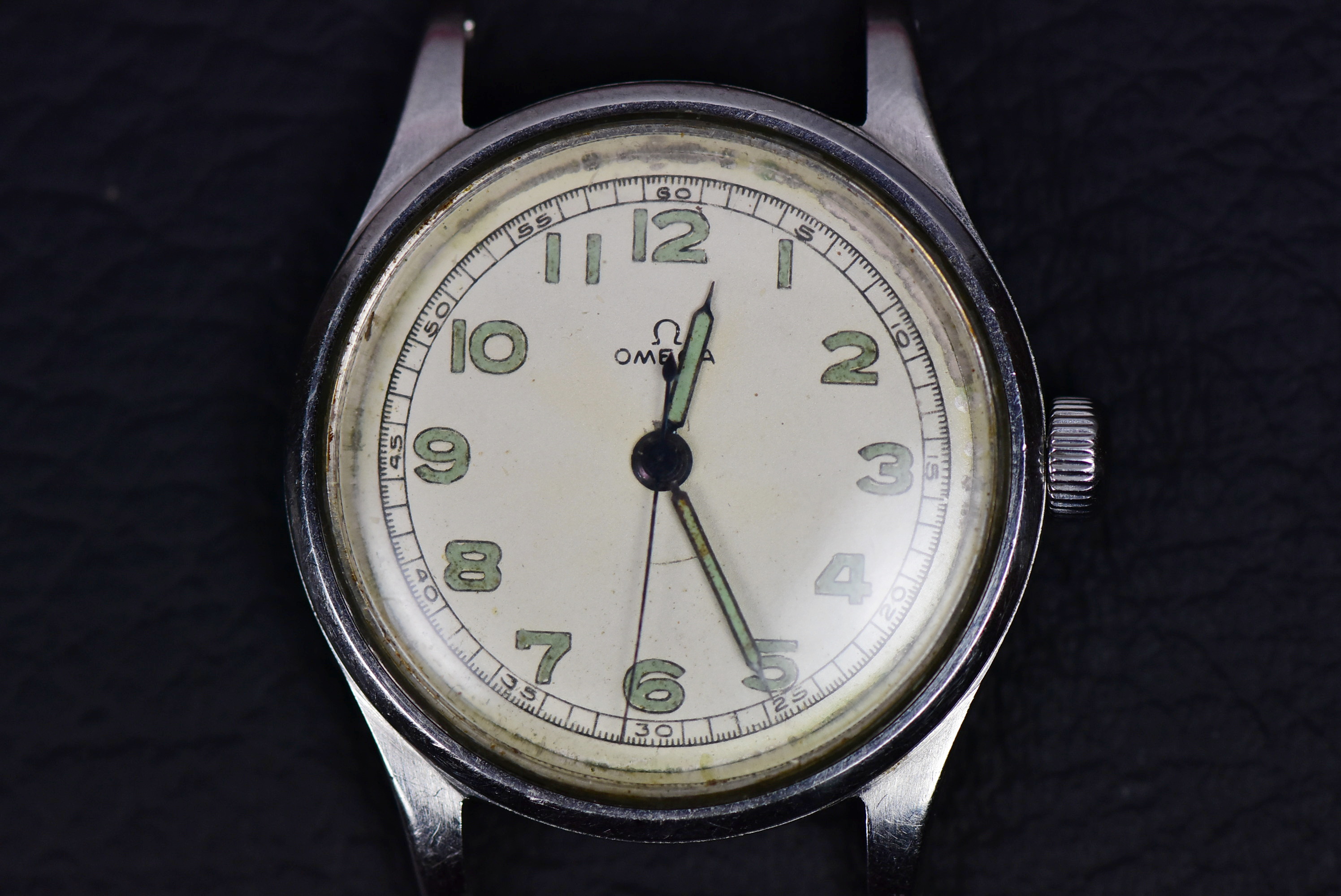

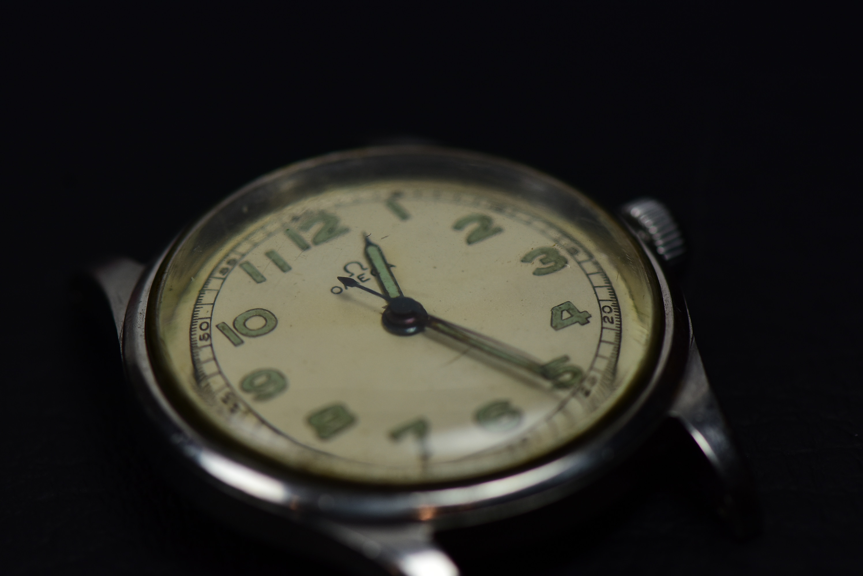

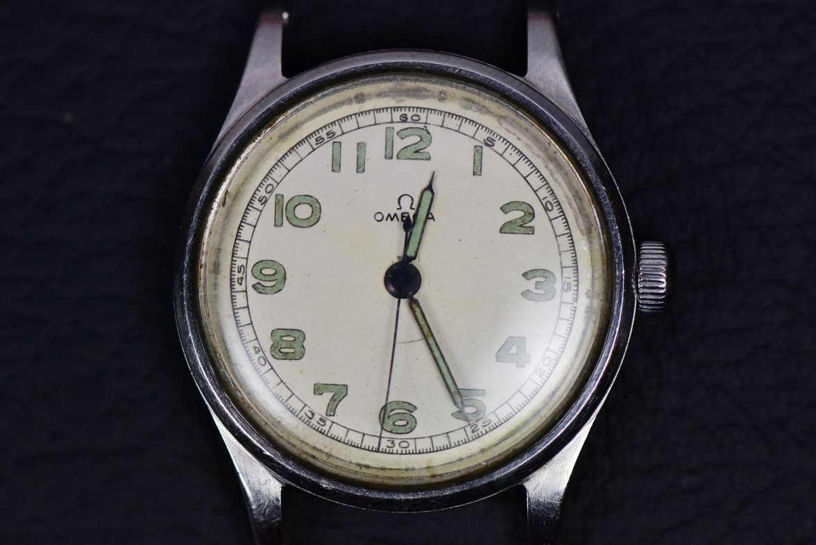

Believe this to be an Omega 2384-8 30T2 SC PC in 30mm from the 40's, but am looking for verification. My grandfather served in WWII as an Army Air Corps Navigator, but this does not have any iteration of the U.S.ARMY stamping, as shown. No signed crown. Possible this was a private acquisition during the era and just coincides with issued pieces?

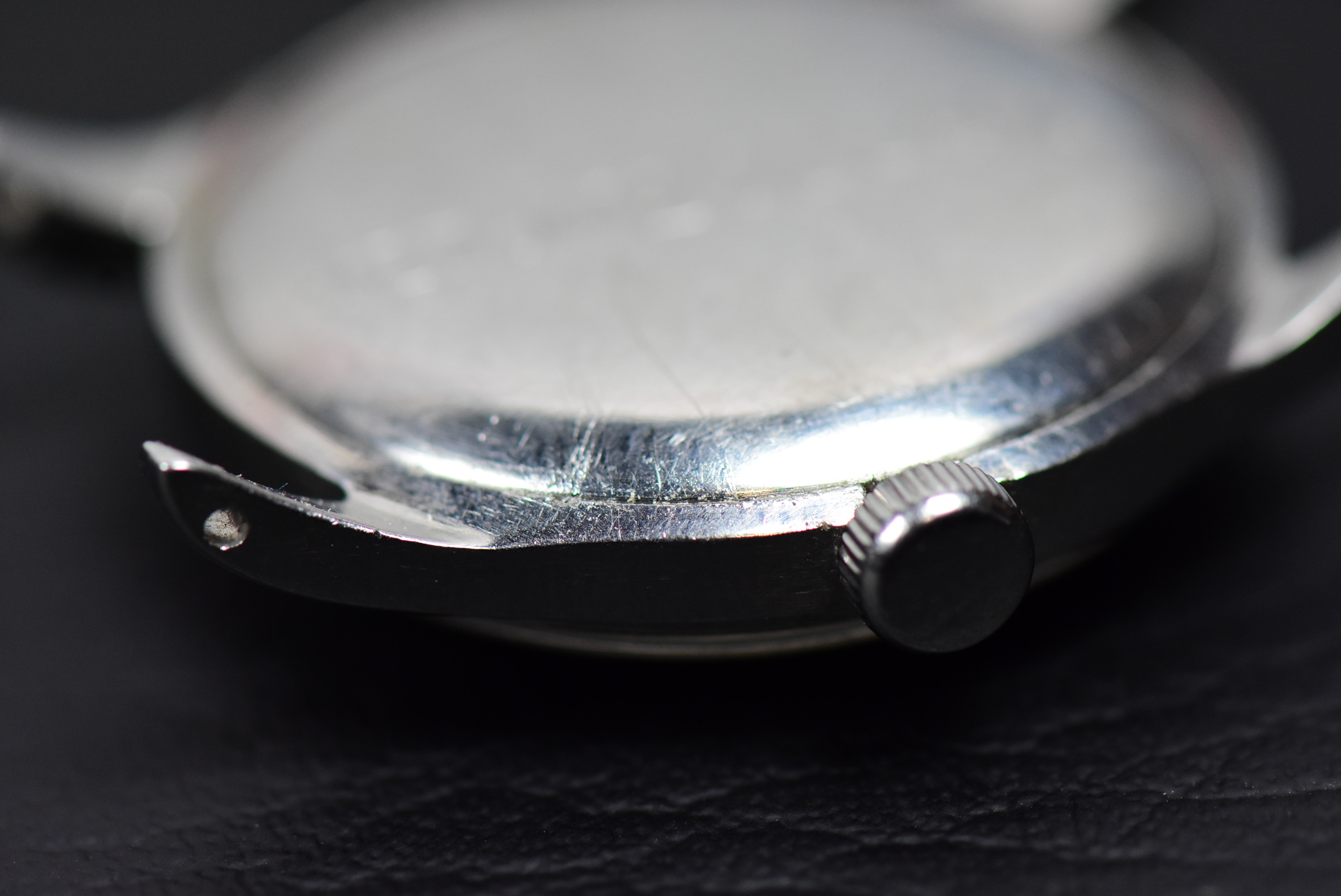

I cannot easily open the case as there is no typical lip/gap to pry off the case back, and I don't want to scratch it up further. Took it to the local jeweler and he wouldn't touch it as removal is not obvious. I'll take it to a watchmaker in the city, but looking for your expert interpretations here in the mean time. Any concerns with radium from this period?
Thanks for all your input.
5,727
9,513

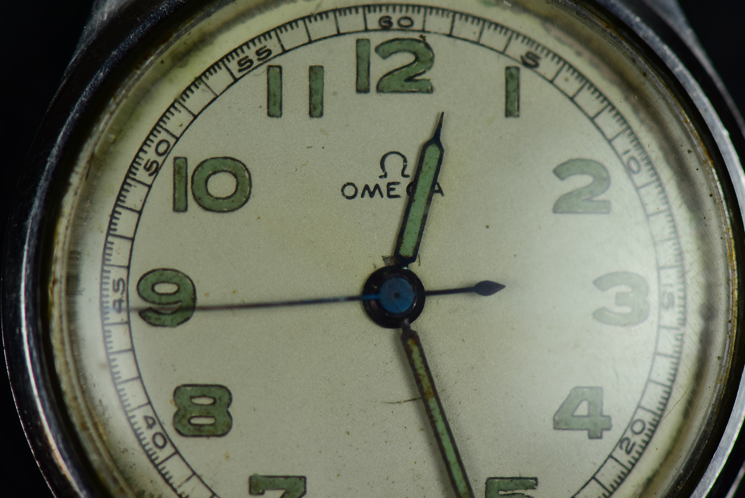

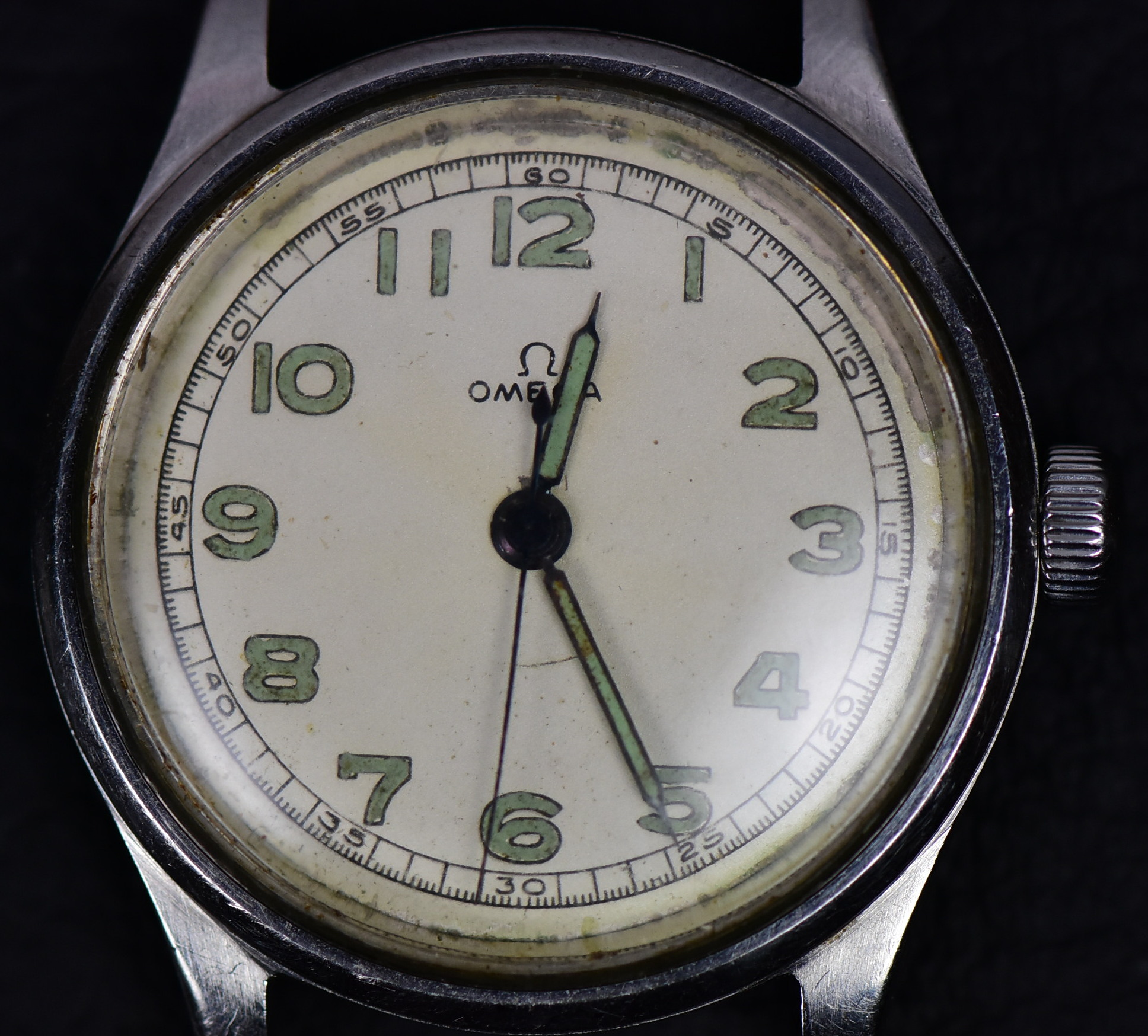

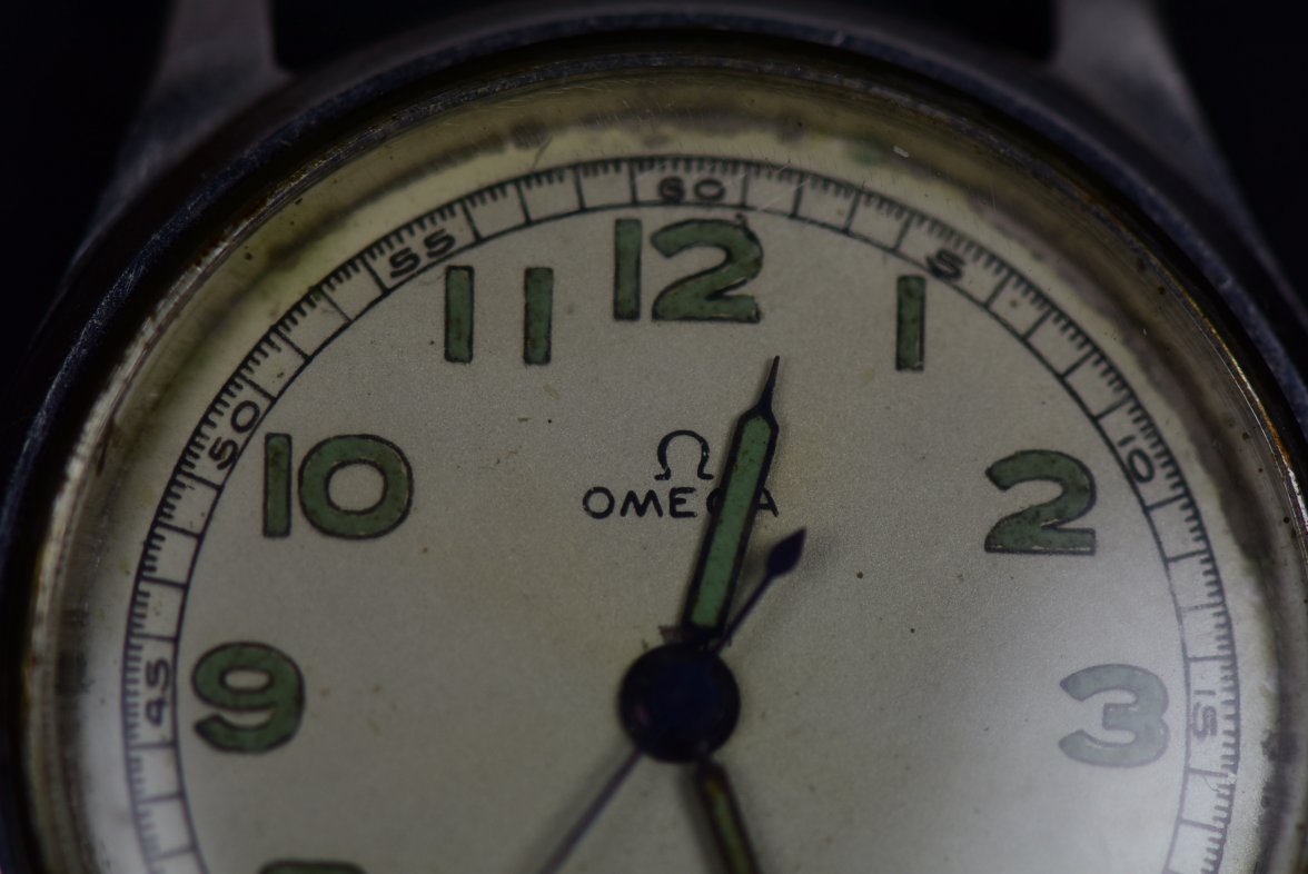

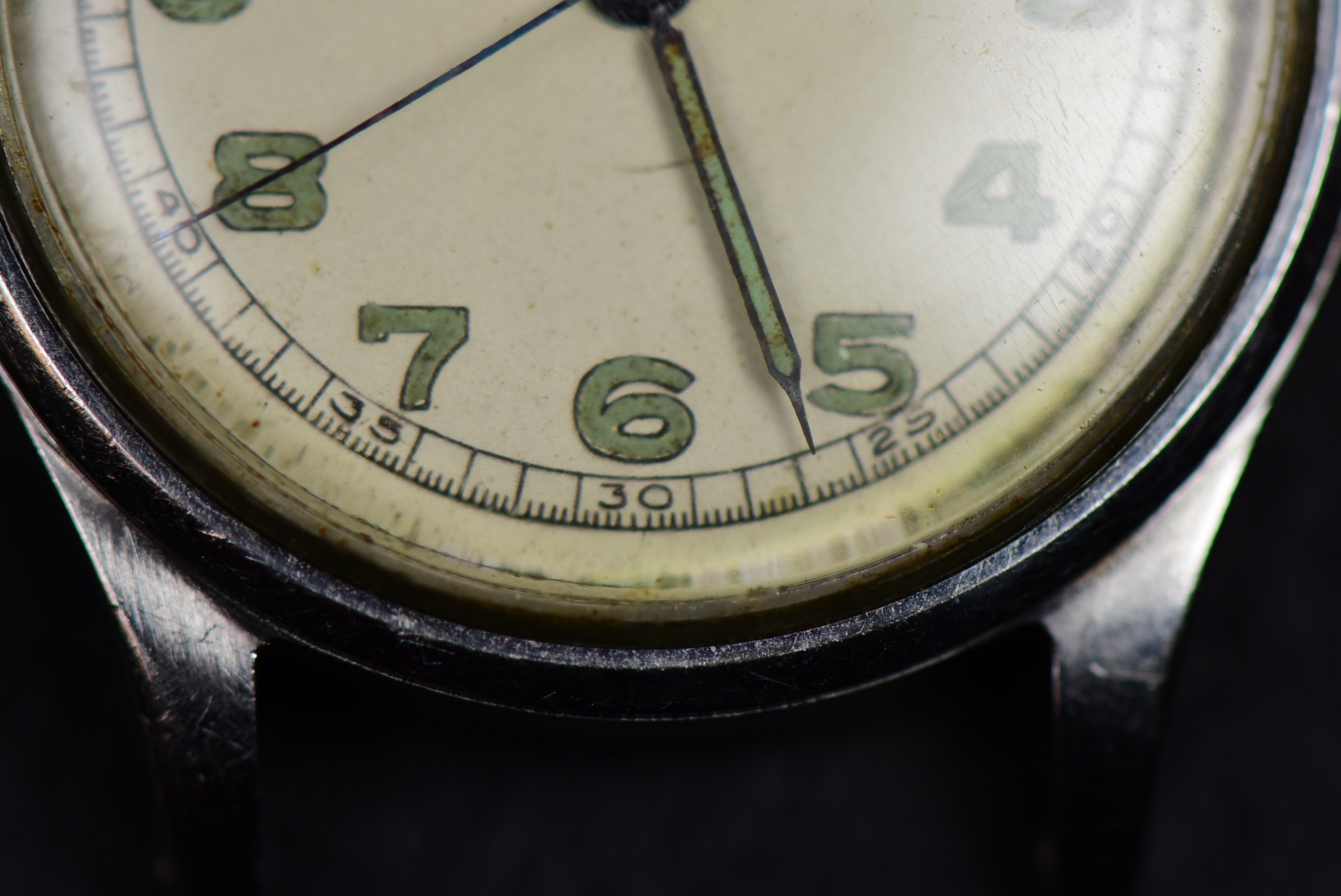

Looks like your Grandfather had some money invested in that watch. Has a badly repainted dial. And therefore no Radium on dial and hands. Has the typical green Lume from the mid 60's. The rest is speculation. If the case is an Omega case, the Info is inside your case back.
3,653
7,770
This is not a reference 2384 which should have a screw-down caseback.
What do you mean with "in 30mm" ? Do you mean the diameter of the case? Or do you mean that it contains a movement of 30mm?
If it was the diameter of the case it can´t house a cal. 30 T2 SC PC as the movement has already a diameter of 30 mm itself.
The info will be found inside, all other statements would be just speculation...
The dial is an old reprint for sure. Other than Achim I would not rule out Radium - depends on the date when the dial had been restored.

R17.8 inside. 30mm case diameter. Often found with repainted dial, probably a model with weak original dial laquer.
The case is quite specific of this period with a monocoque like caseback that fits in an upper case, similar to those later used for some Seamaster Cosmic
