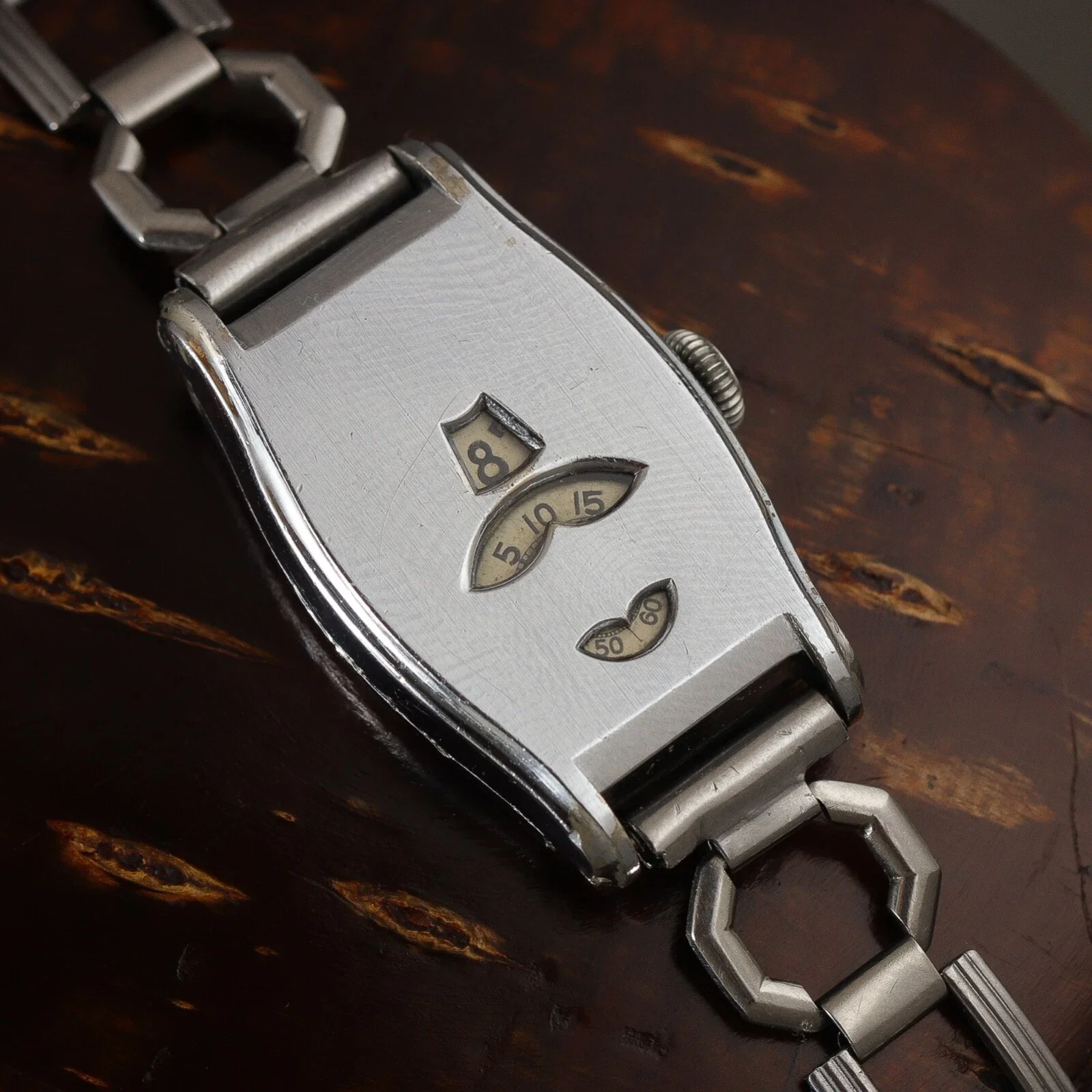

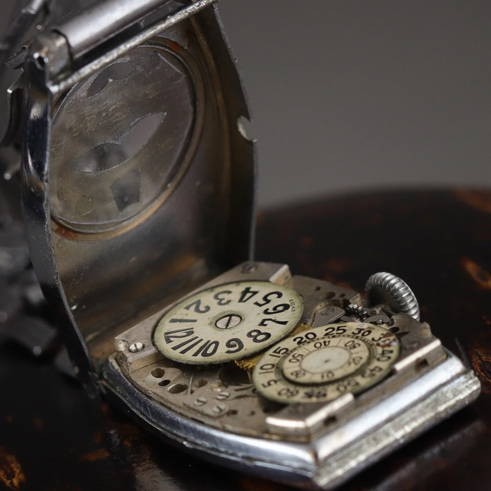

I noticed this watch at the current online auction and am just want to identify the Eterna model. It seems fine and only AI search shows it is correct from outside, but what should you look for when you buy one in the future? Which brands are well-known for their quality jump hours, and do those timepieces offer hassle-free servicing or not due to their rarity. Finally, do you think big brands will bring these style back, or are they a thing of the past?

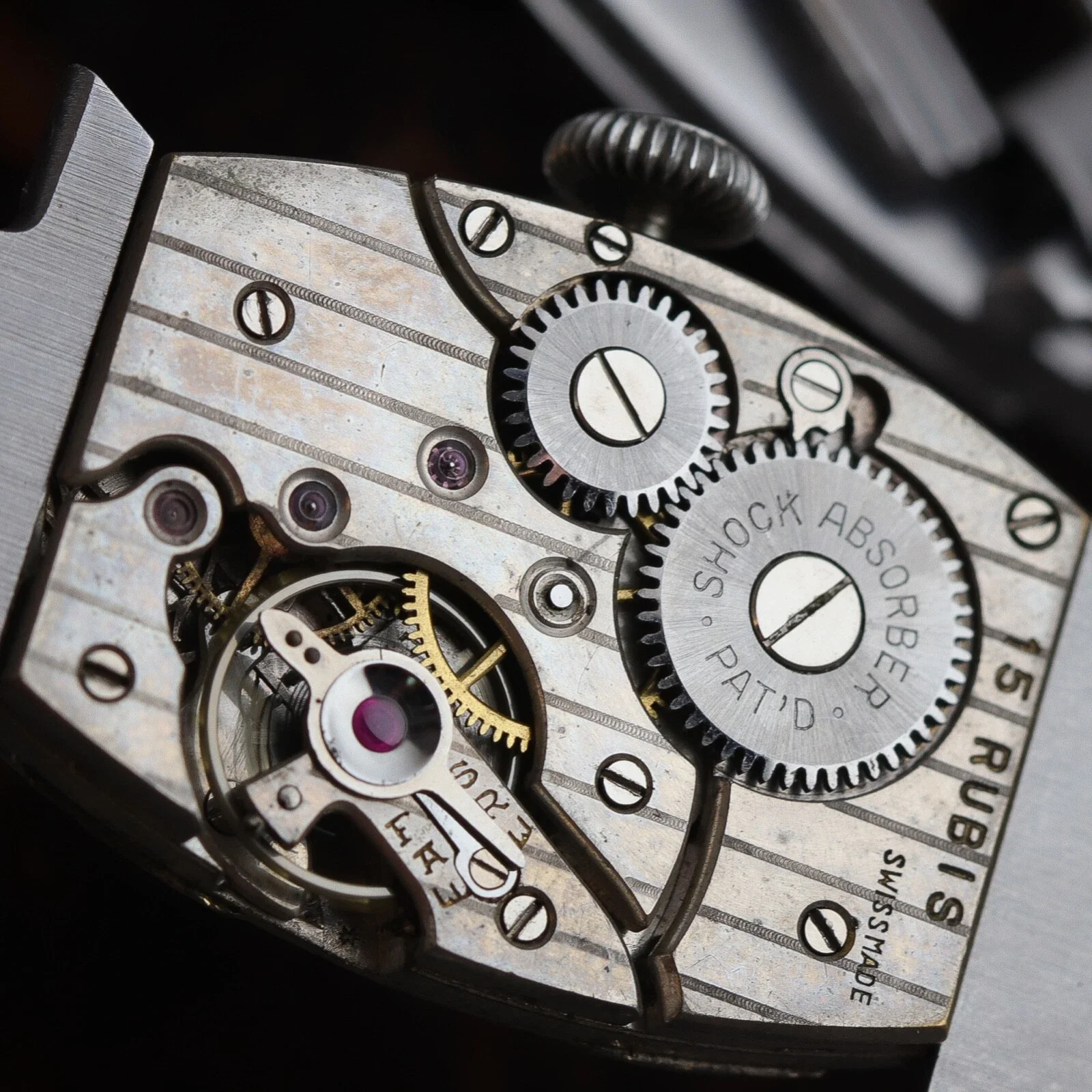

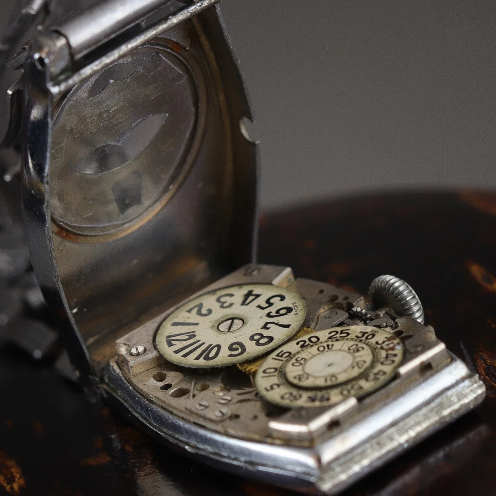

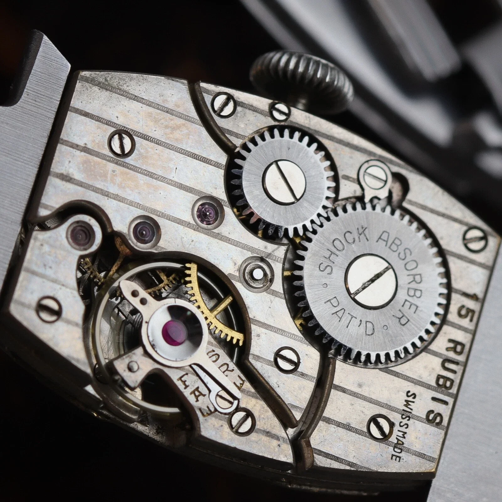

You've identify the maker correctly, it is an Eterna movement. More accurately, it's an ETA one. The base movement is an ETA-717 specifically, and it's the typical digital module retrofitted to it. There's a more rare module with the "smiling" aperture pattern commonly found in round movement footprint 1930's jump hours.
Now the secondary and more urgent reason I joined, did you by any chance find that watch being sold on the bay by a user going by RarityNY? Am asking because that seller is definitively a conman. They are either selling watches they do not own with stolen pictures, or are, best case scenario, endlessly fraudulently cancelling legitimate winning bids chasing some mythical final price. How do I know this? They've been selling the same handful of watches over and over for years.

As per your other questions. The FHF-29 "Digital" is easily my favorite early jump hour movement, extensively overbuilt and has an interesting and unique jumper mechanism with an indexing "hammer". You can find it in all sorts of grades, but the 15 Jewel workhorse, which is also the most common, is of decent quality already. Bulova has a more polished licensed version of it, cal. 13AT. An example of a higher grade one would be a Helvetia 75A version of it, but that one also has a proprietary module and not the FHF "Digital" one. the Helvetia module has the best hour switch I've seen on an early jump hour (a smooth non-jittery quick swap, blink and you'll miss it fast), however it's also a very fragile design with.
Servicing these can be very fiddly, to a point of a nightmare, and if the module parts are broken, a random watchmakler is not likely to have them. I like these very flawed watches which is how I ended up finding your post. Every now and then I'll do an image search, to see if something interesting (a previously unknown design, a caliber I'm still looking for or the precious random spare parts/sacrificial movements). The anti-lashback springs in the module are the common parts that fail, and then the second most common are severely damaged or missing discs. I've encountered spare discs being sold on a rare occasion, but never the springs. So, again, your best bet is buying a movement wrecked thoroughly enough to be cheap, but with the specific part you need replaced. If something on the base movement's end is broken, however, replacing that is easy all things considered. The balance from a base ETA-717 (or any of its many branches that have a compatible balance) for example works just fine. TLDR, If something on the front is wrecked, it might take a while to find parts to repair it. If it's a thing on the back end, a quick and easy fix.
They're likely a thing of the past when it comes to any large scale adoption. Unless we are talking really expensive high end watches, the common gimmick for the midrange is for them to make a lazy central hour wheel jump hour module equivalent to what can be found in the 70's dollar watches and sell it for way too much.

Thank you very much for your comment. Yes, you are quite right; this is the seller's name who auctioned this watch, and I observed that the auction shows ended, thus it shows something off with this seller. Thank you again for alerting us regarding this seller.

I did botch a couple sentences, by getting distracted and finishing them abruptly omitting key stuff. For example, did not finish the part about the Helvetia 75A using two anti-backlash springs and two 12 pointed star gears instead of the usual single set you'll find on a jump hour watch. The ETA-717 (or 716 as you've noted in the title, didn't even see the title the first time around since I came from an image search. All up to 735 or something like that they're very much the same thing) has the one spring you can see to the left and the star is on the hour disc.
