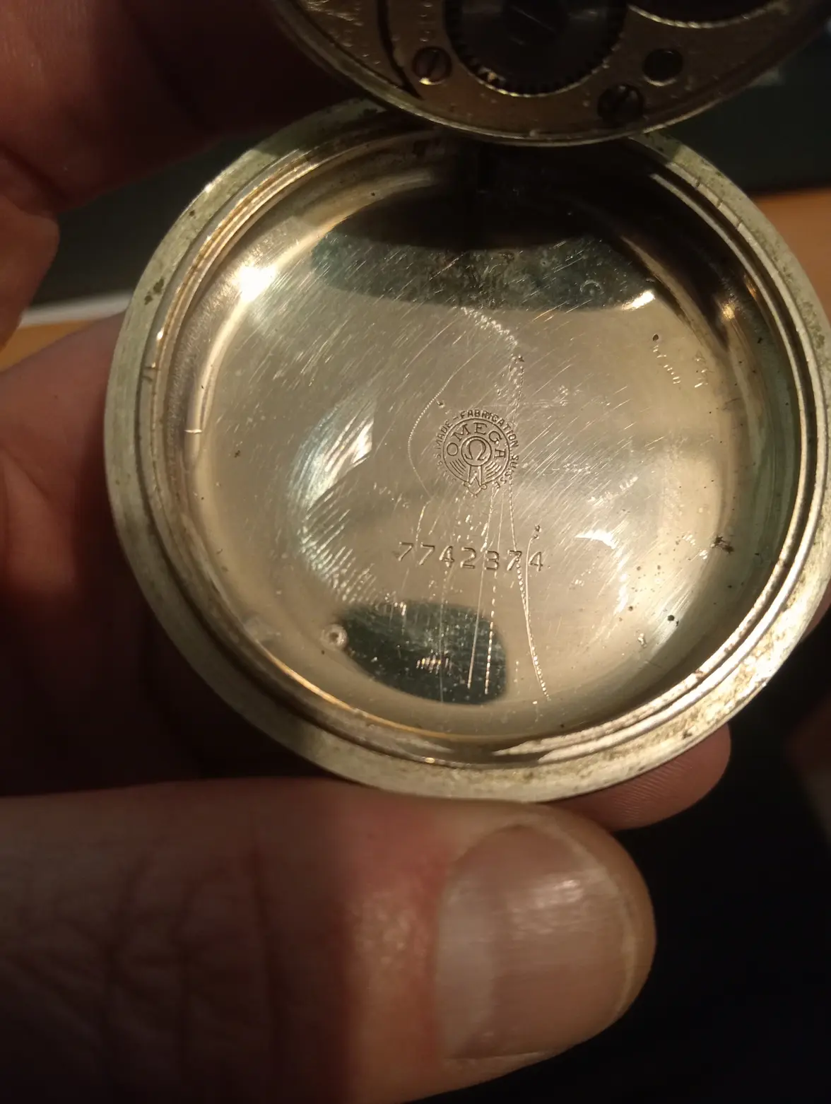

Greetings from Christchurch New Zealand.

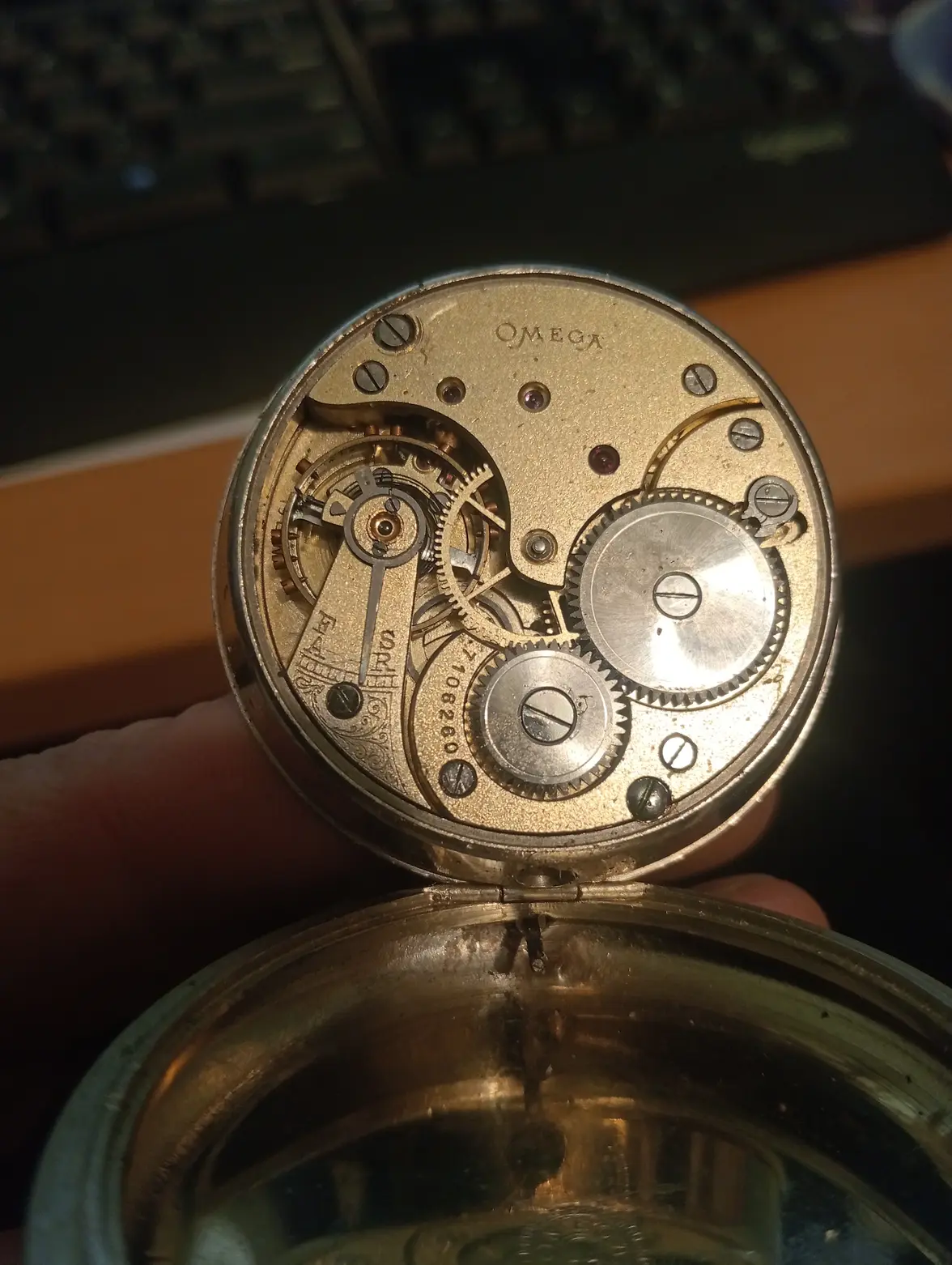

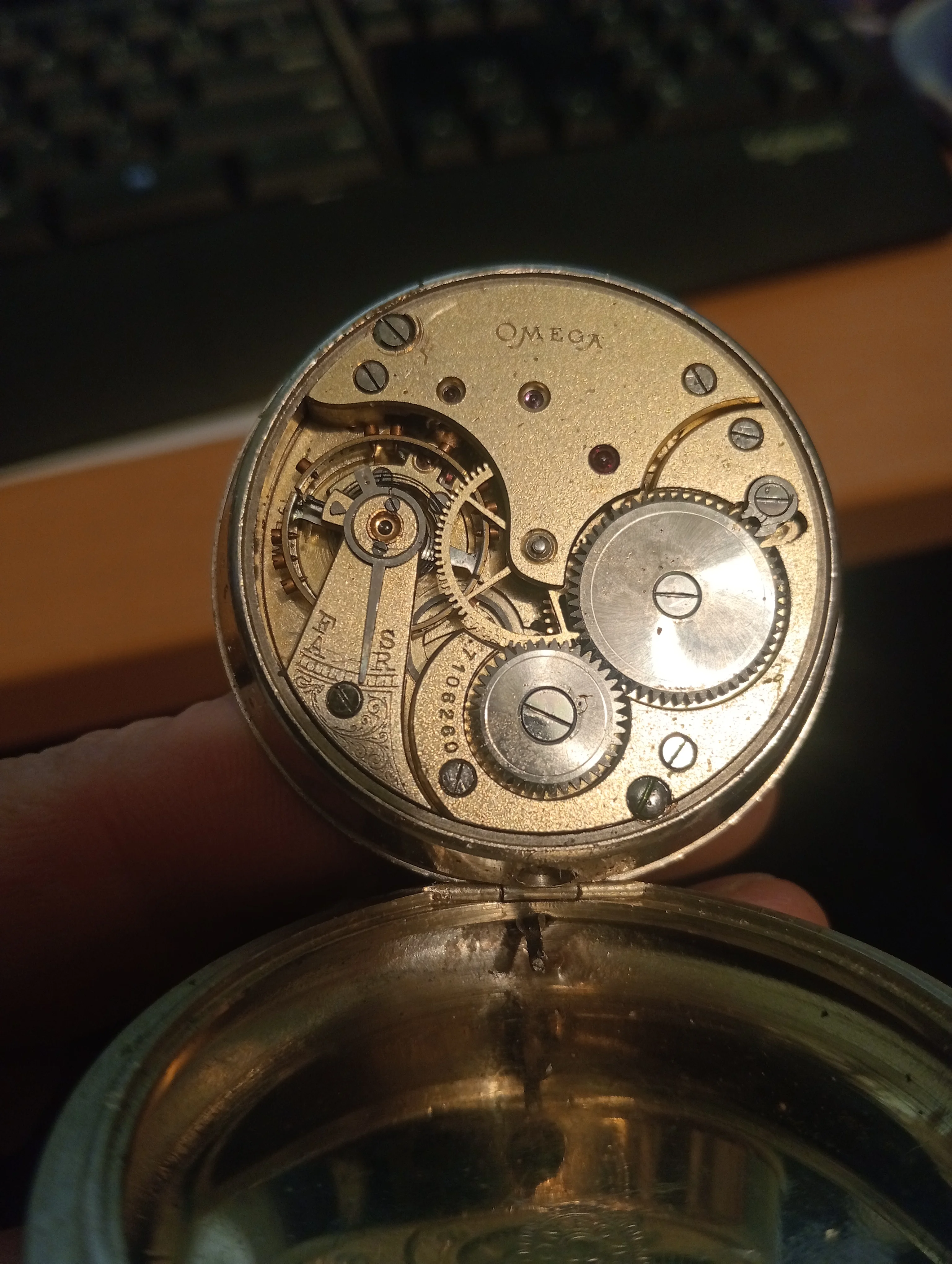

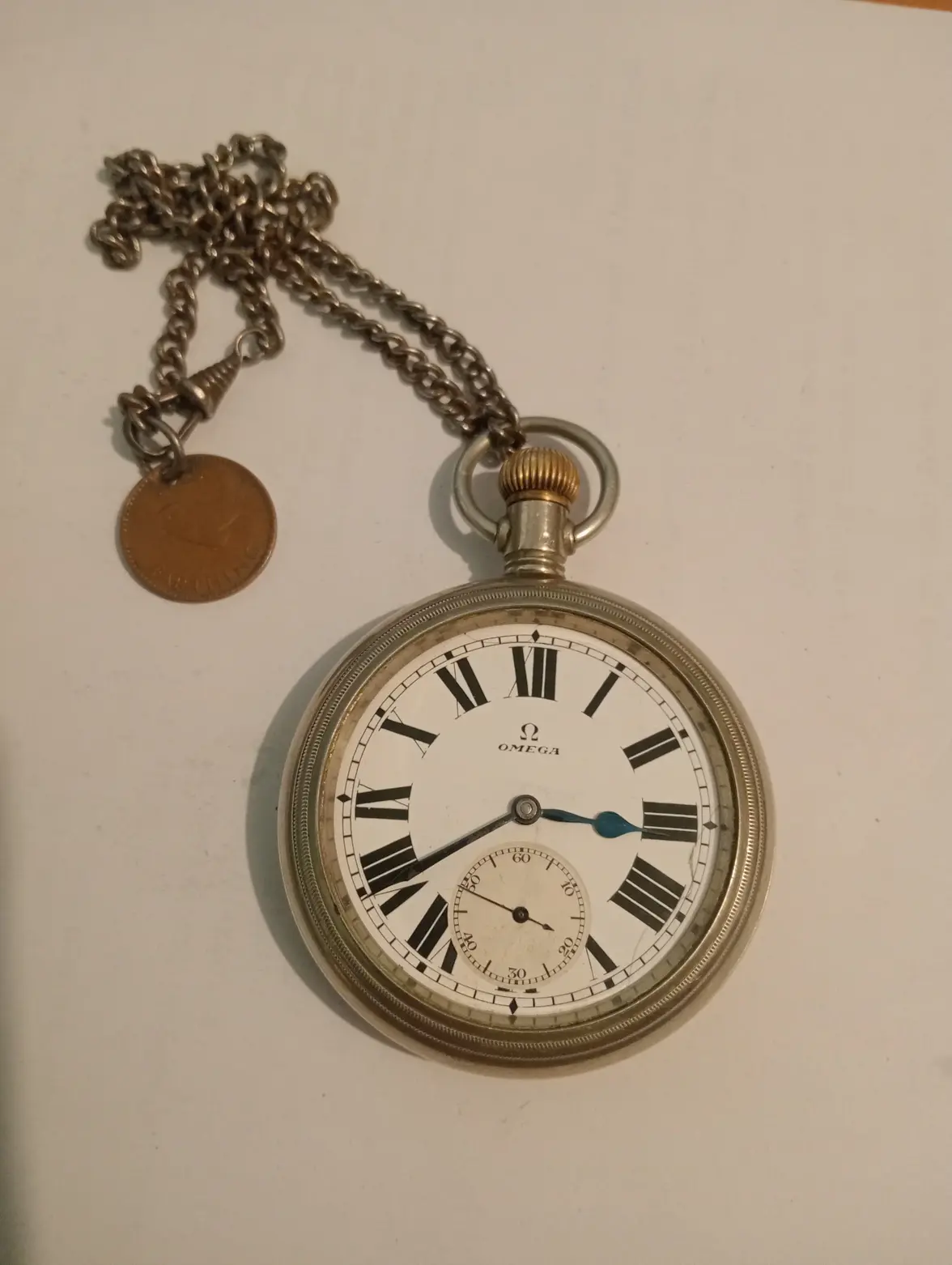

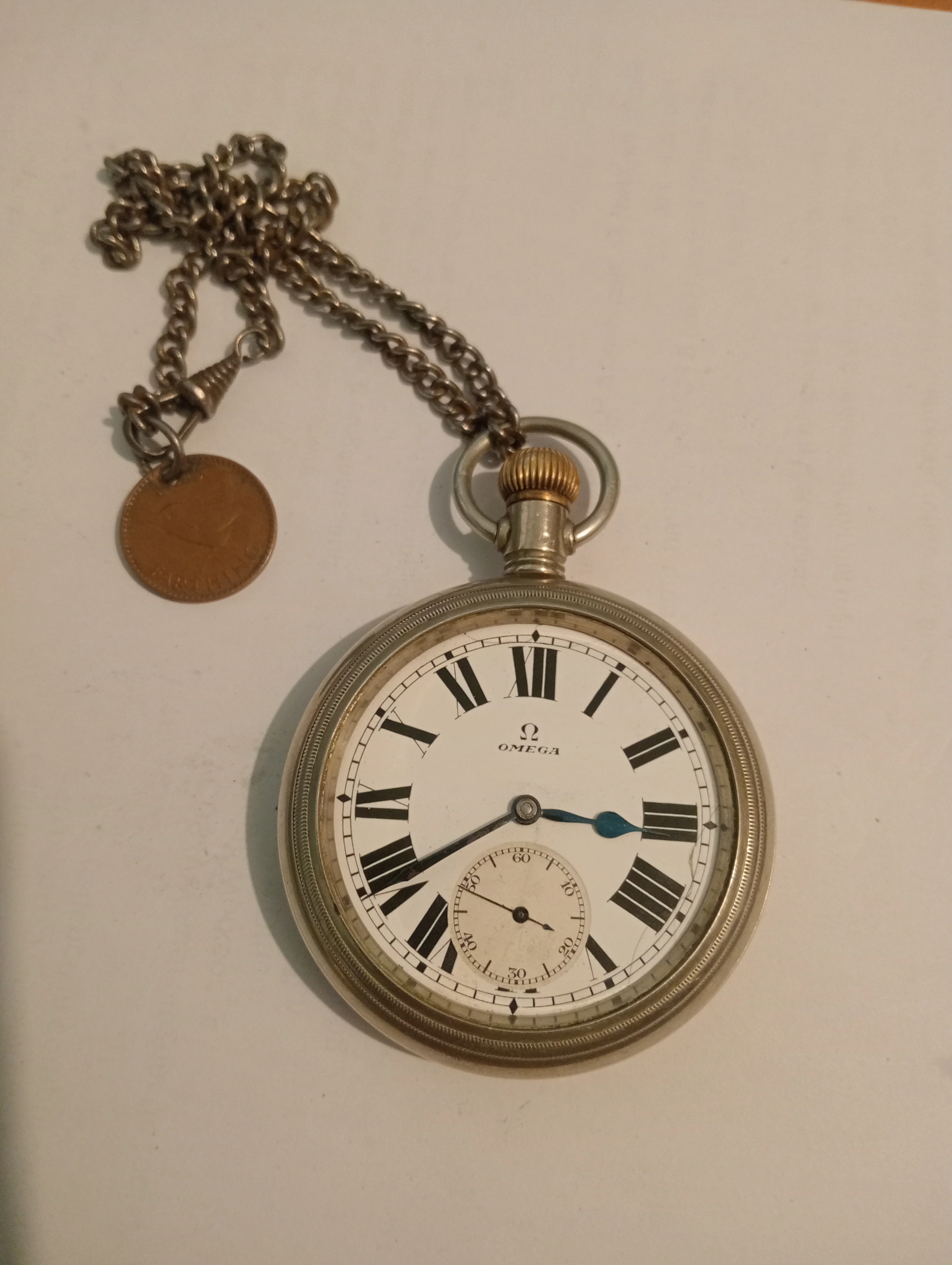

I have come into possession of my Grandad's Omega Pocket Watch, circa 1917.
He would have bought it as a young lad in the 1920's
Can anyone weigh in with any observations/ information
Currently does not work, and the crystal has gone from the face. But I would love to restore it and keep using it.
Ai agent has this to say:
"Model/Style: Omega Open-Face Lever Pocket Watch, circa 1917
  • Style: Open-face (Lépine configuration) - no hunter cover over the dial
  • Movement: Anchor lever escapement - a club foot lever escapement with compensation balance wheel, which is exactly what's visible in your movement photo
  • Jewels: Likely 15 jewels - standard for Omega's quality grade of this era

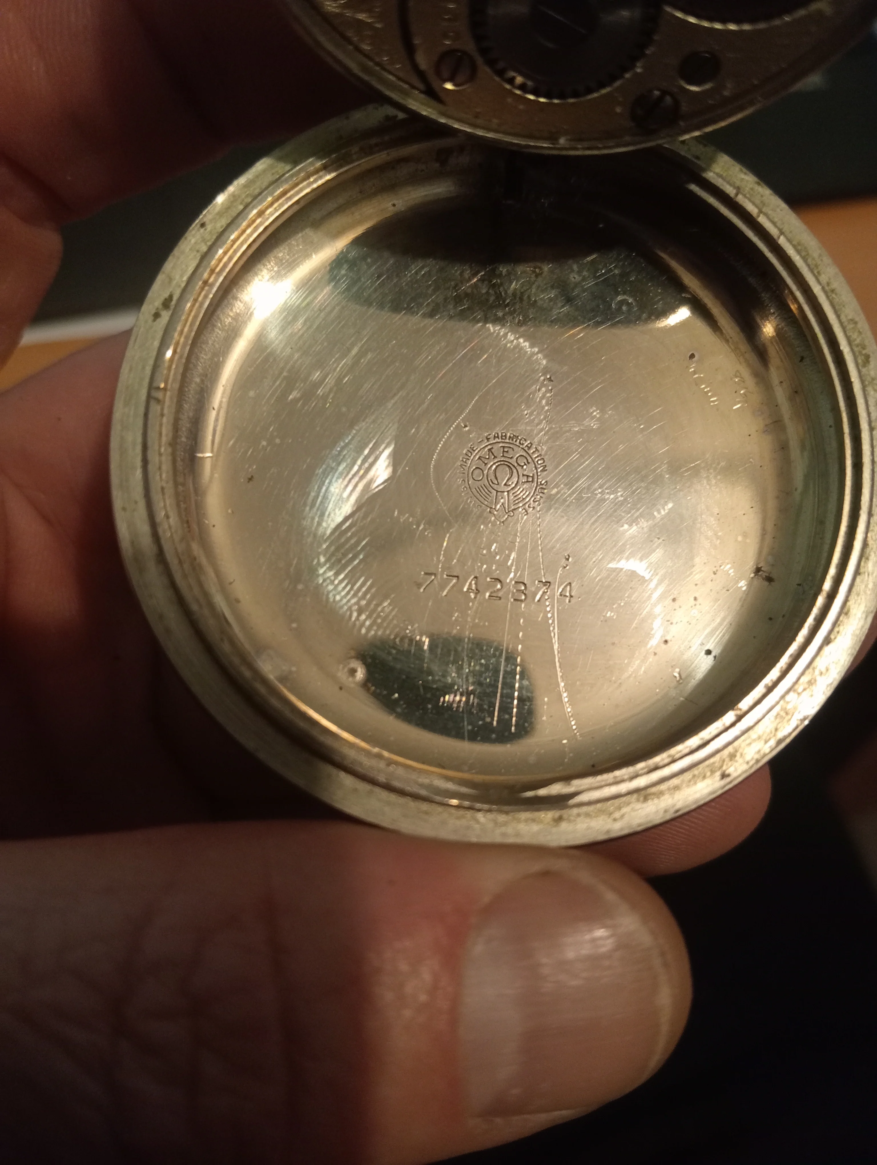

  • Case material: Nickel silver (the "Fabrication Suisse" stamp inside confirms Swiss manufacture - your case is not marked 0.800 silver so it's almost certainly nickel)
  • Dial: White enamel with Roman numerals and subsidiary seconds - a slightly more formal/dressy configuration than the Arabic numeral versions of the same era
  • Size: Approximately 50–52mm diameter, typical for men's pocket watches of the period
Movement serial 17108260
Case number 7742374
13,475
18,720
Based on both the case and movement serial number, I would say that the watch dates from the very early 1930’s.
https://www.emmywatch.com/db/serial/omega/?num=7106260
The caliber of the movement is engraved under the balance wheel. From the picture you provided I can see a “19L”, but there may be more there that is hidden by the wheel.

Awesome!!
I will try and get a better look at the calibre stamping.
Cheers again!
