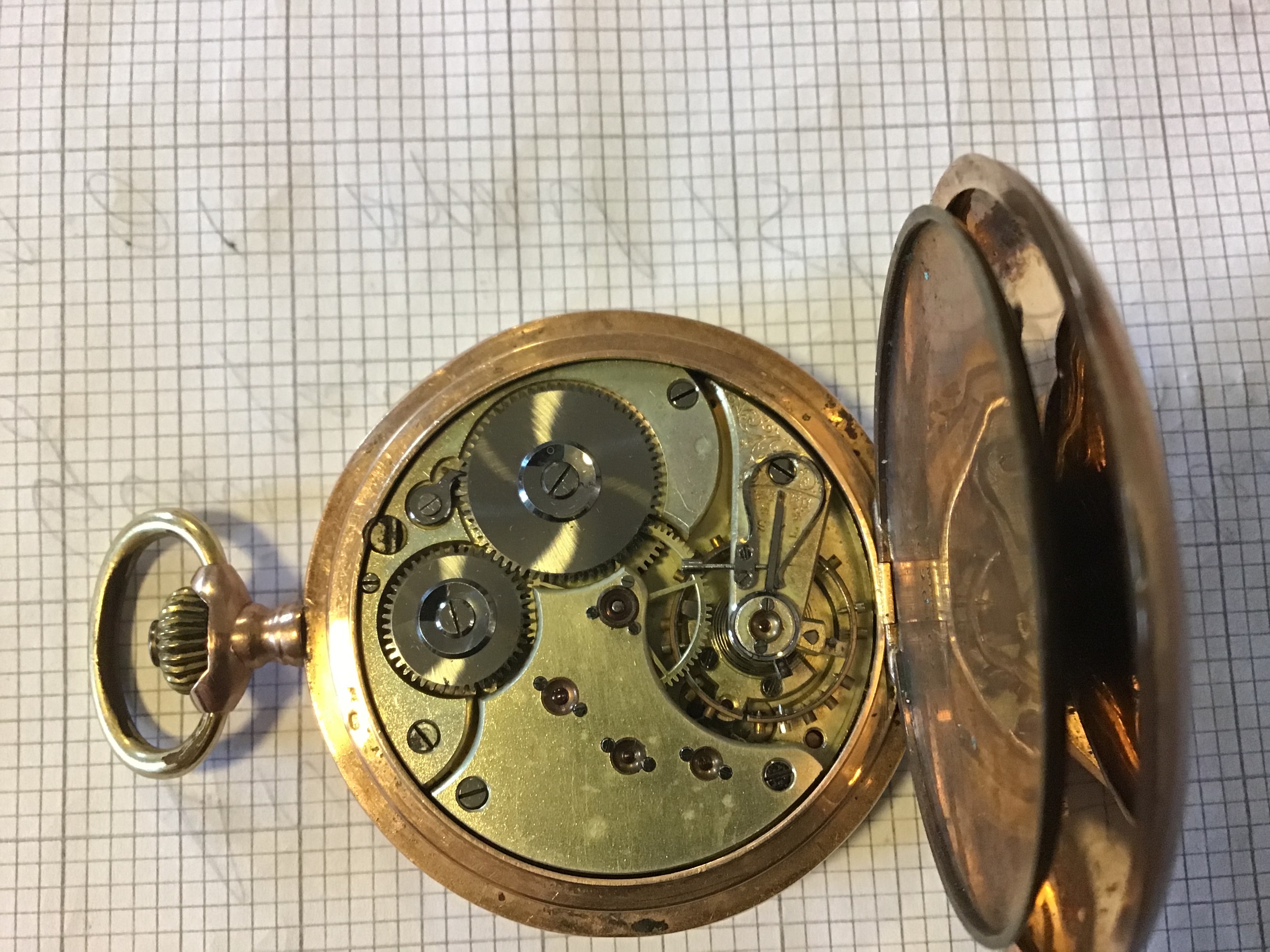

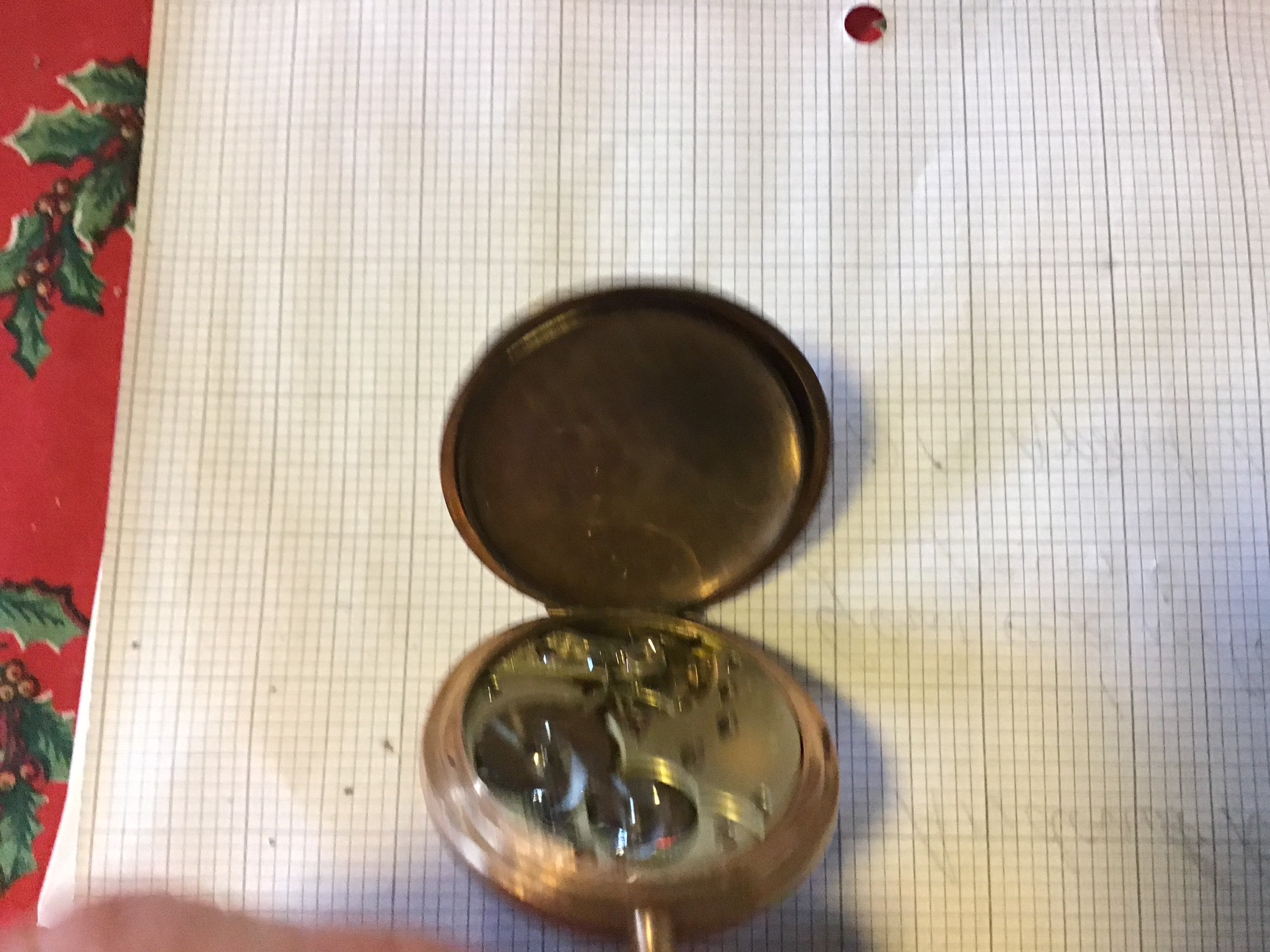

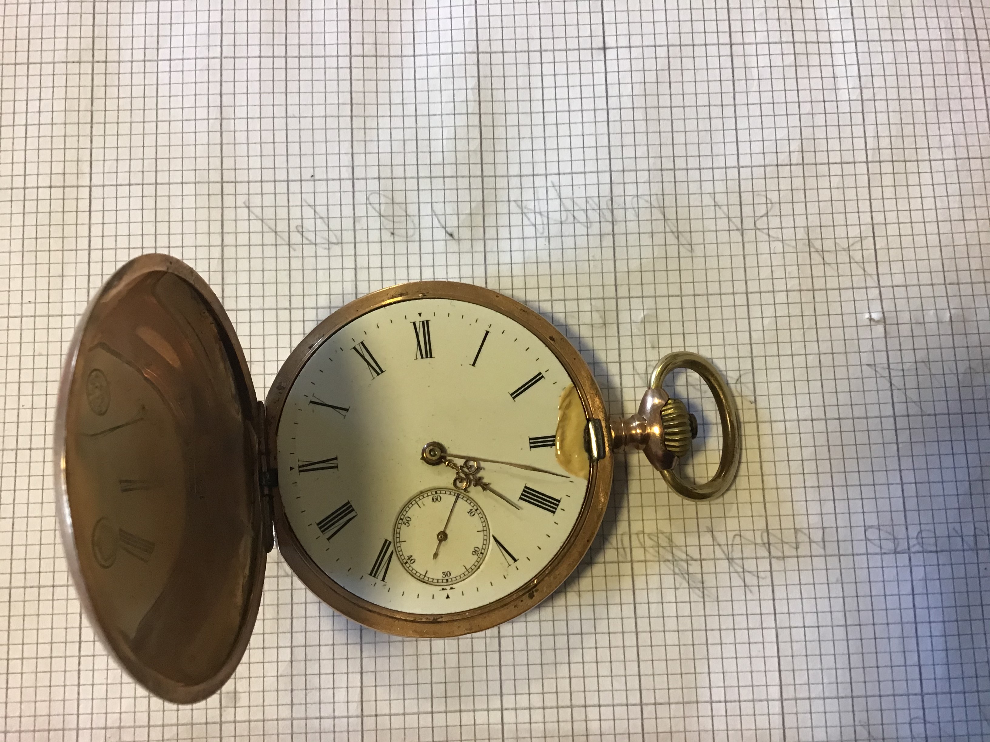

Thanks for your reply Chris. Photos below

As Chris said, if it has sentimental value, then go for it. Maybe @Canuck can tell you if yours is of any significance, quality-wise
Otherwise, check the eBay sold listings, and you can see that c1900 Omega pocket watches with nice dials do not cost a tremendous amount, and might be better candidates for investing in a service.
The American made pocket watches tend to be of higher quality, so if you are looking to become a fellow pocket watch dweeb, and you want just one pocket watch, I’d suggest getting a US made railroad grade model.
8,855
28,095

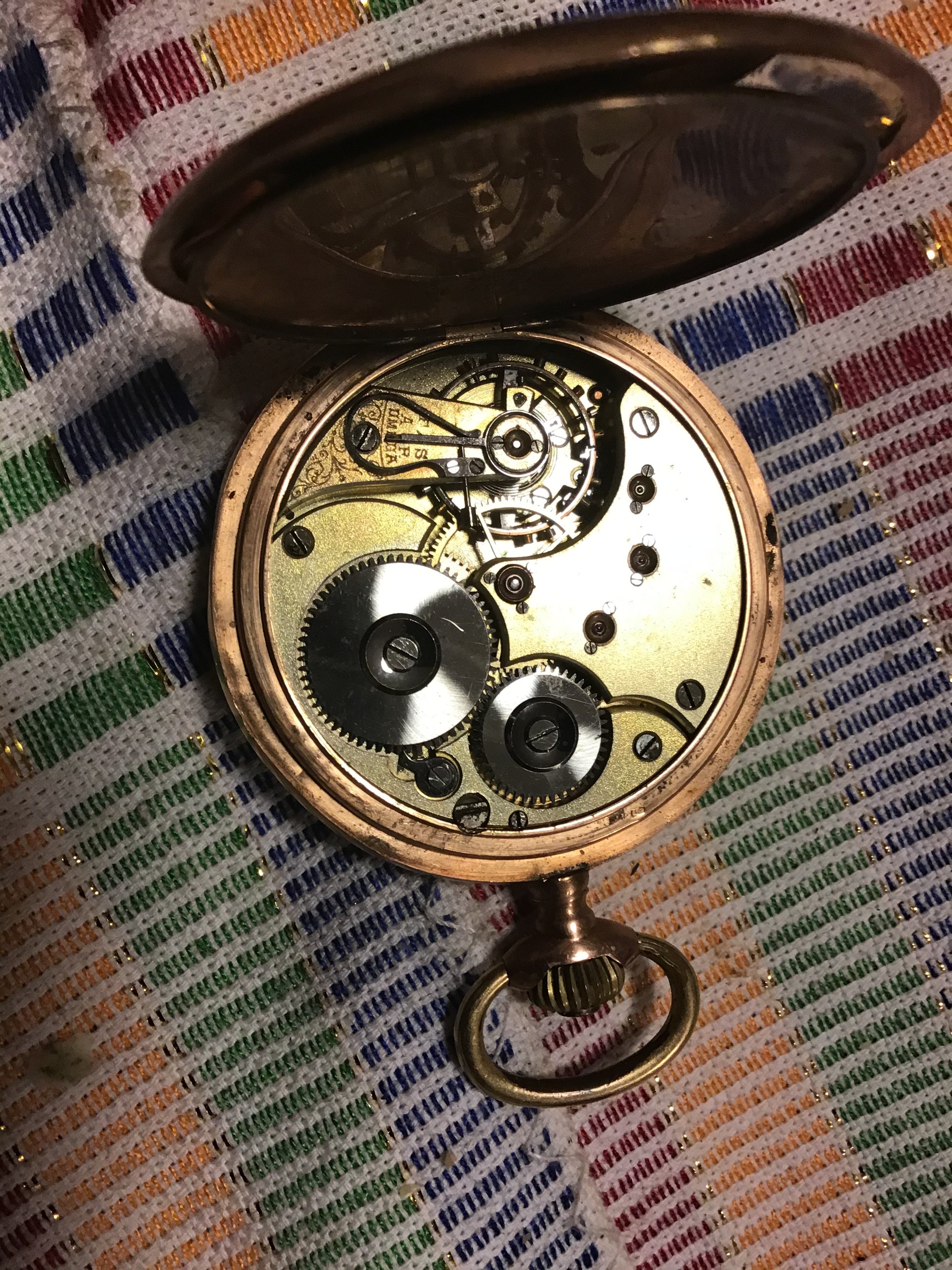

Looks like one of the higher grade 19’’’ movements from the screwed in chatons(sp?) for the jewels.
Are there any hallmarks or makers marks anywhere on the case @Droberts?

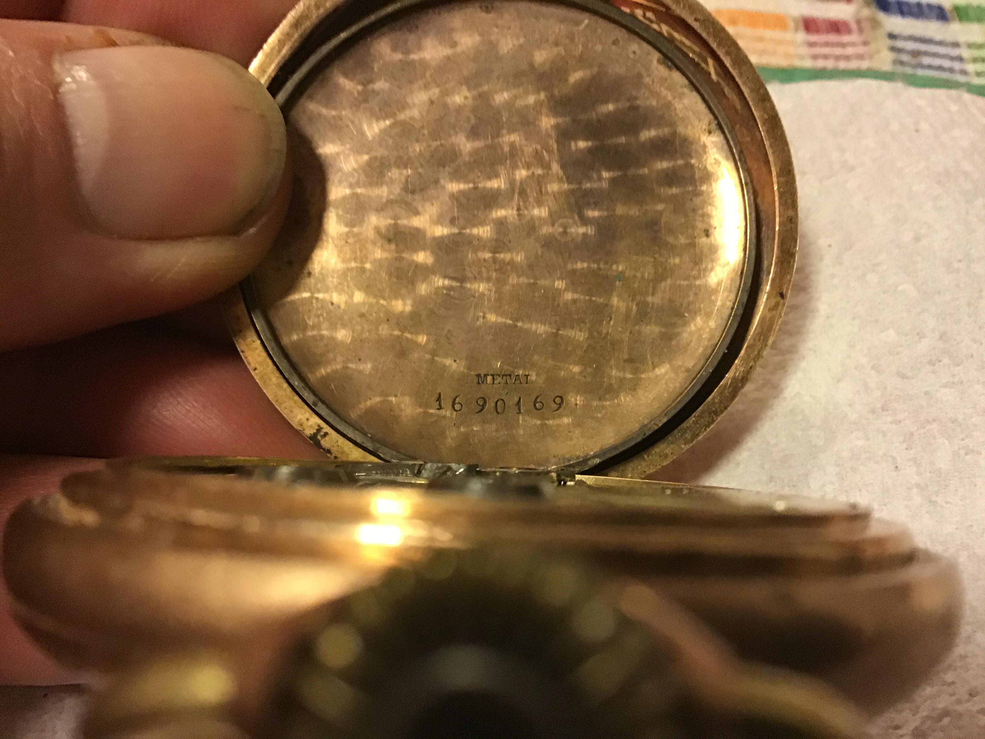

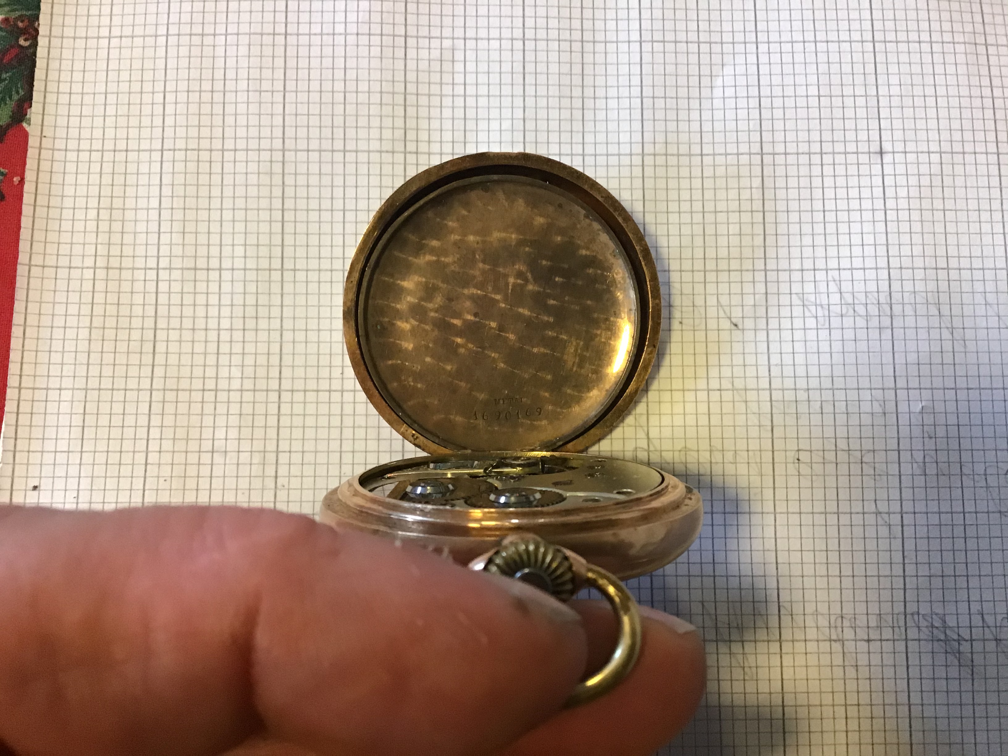

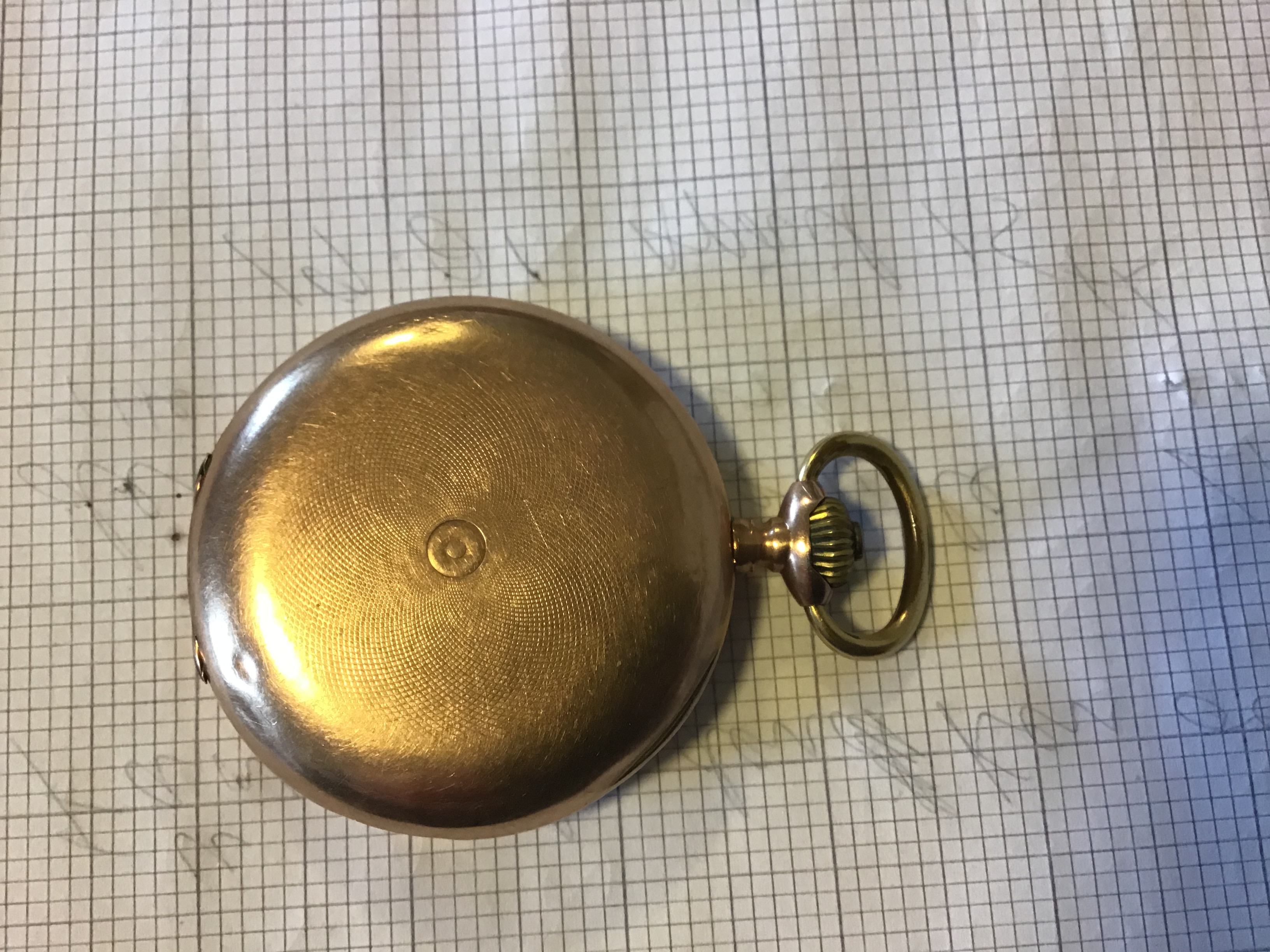

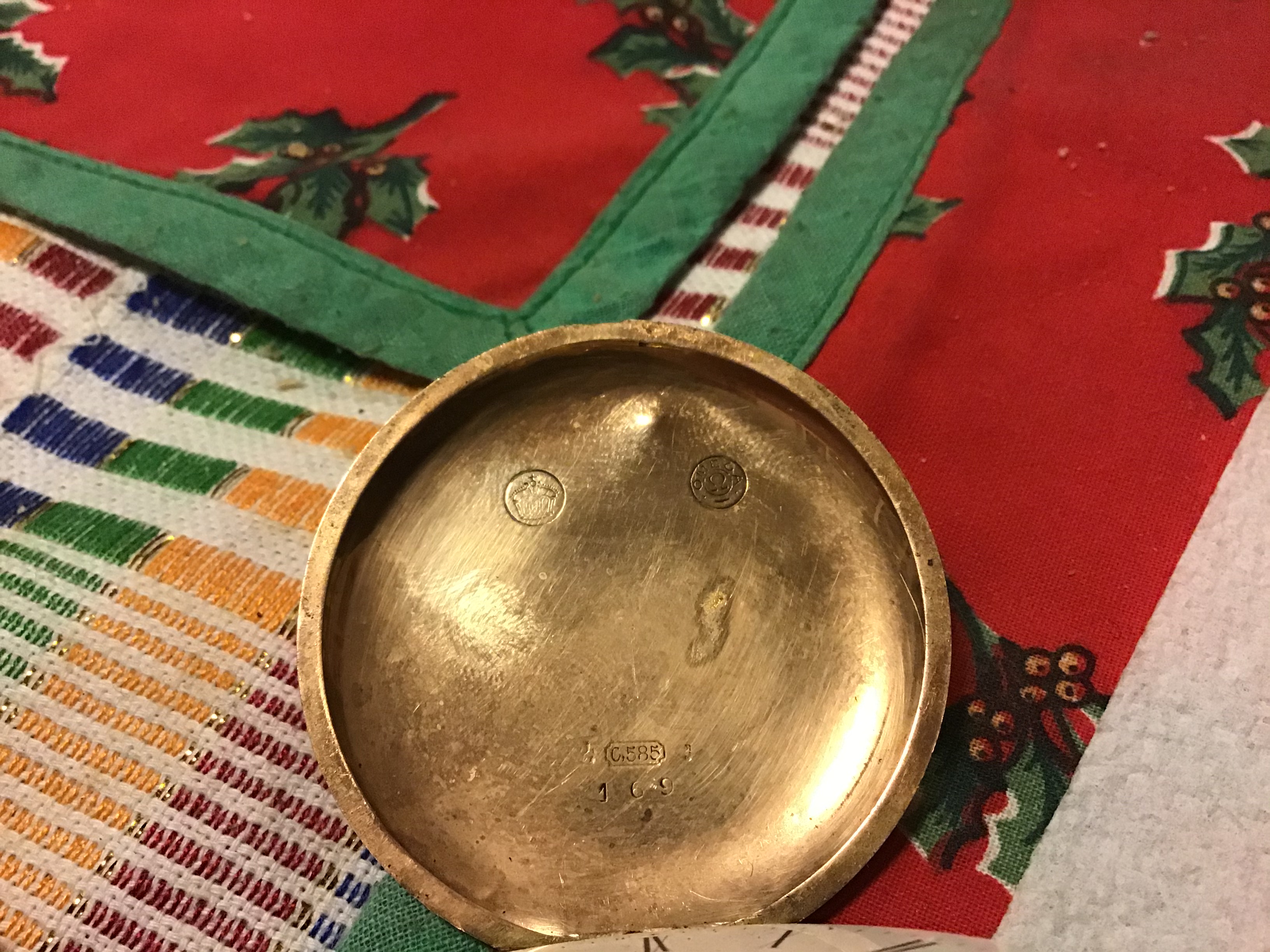

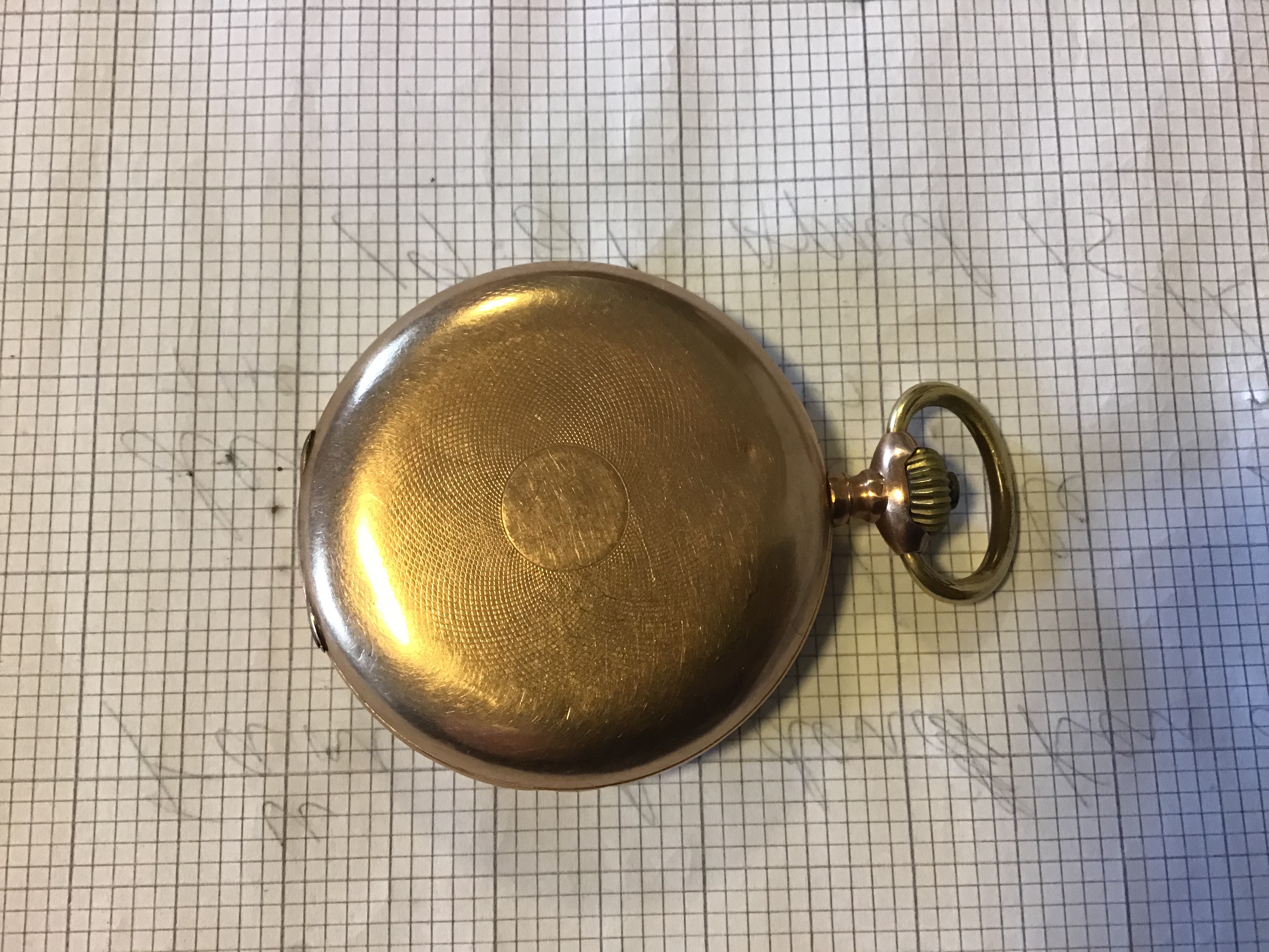

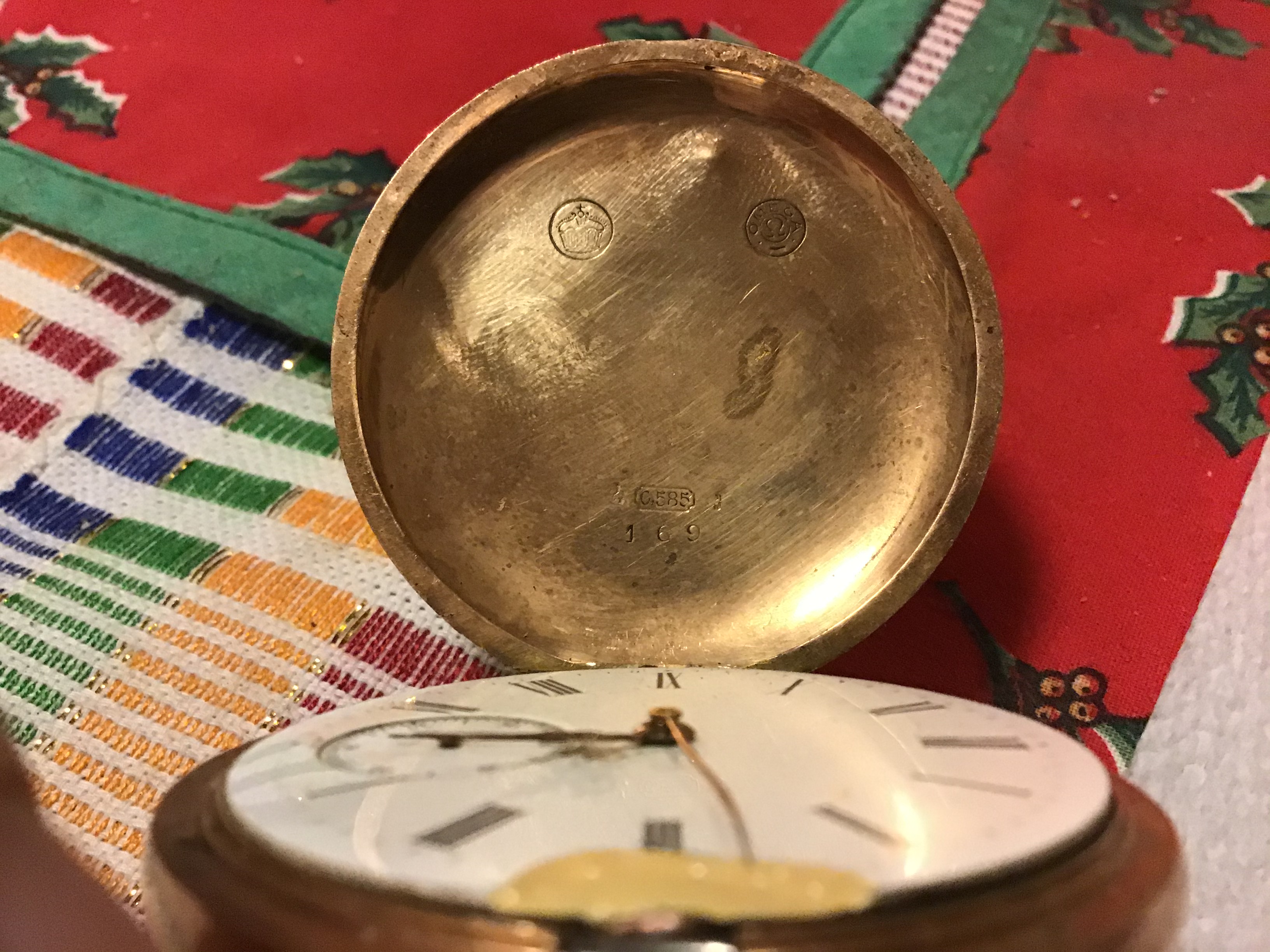

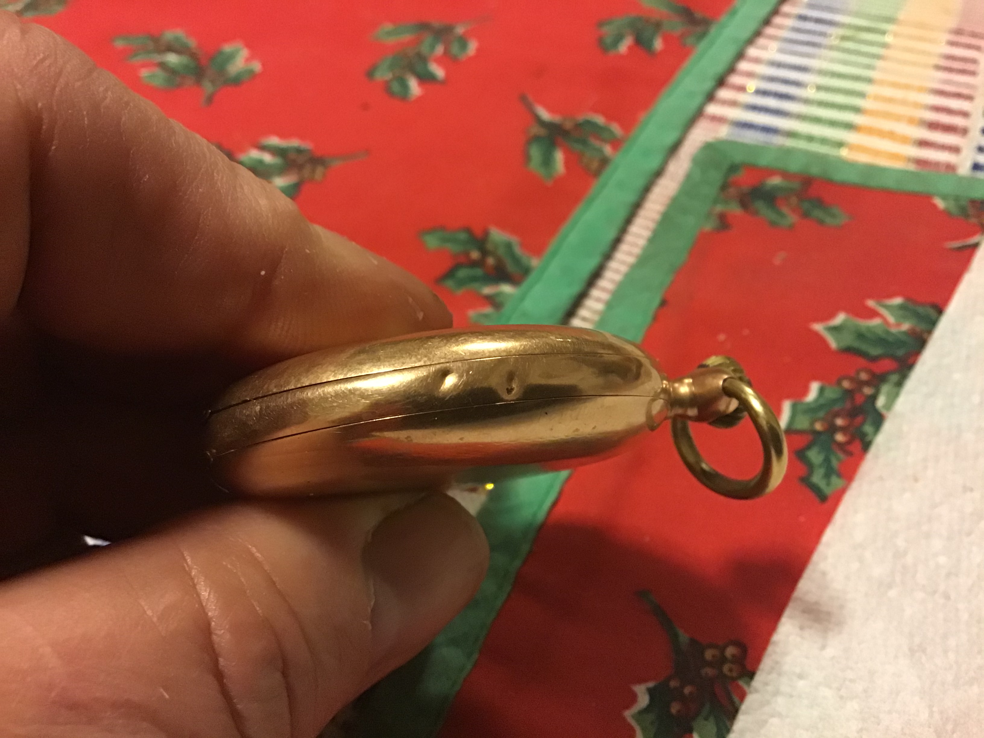

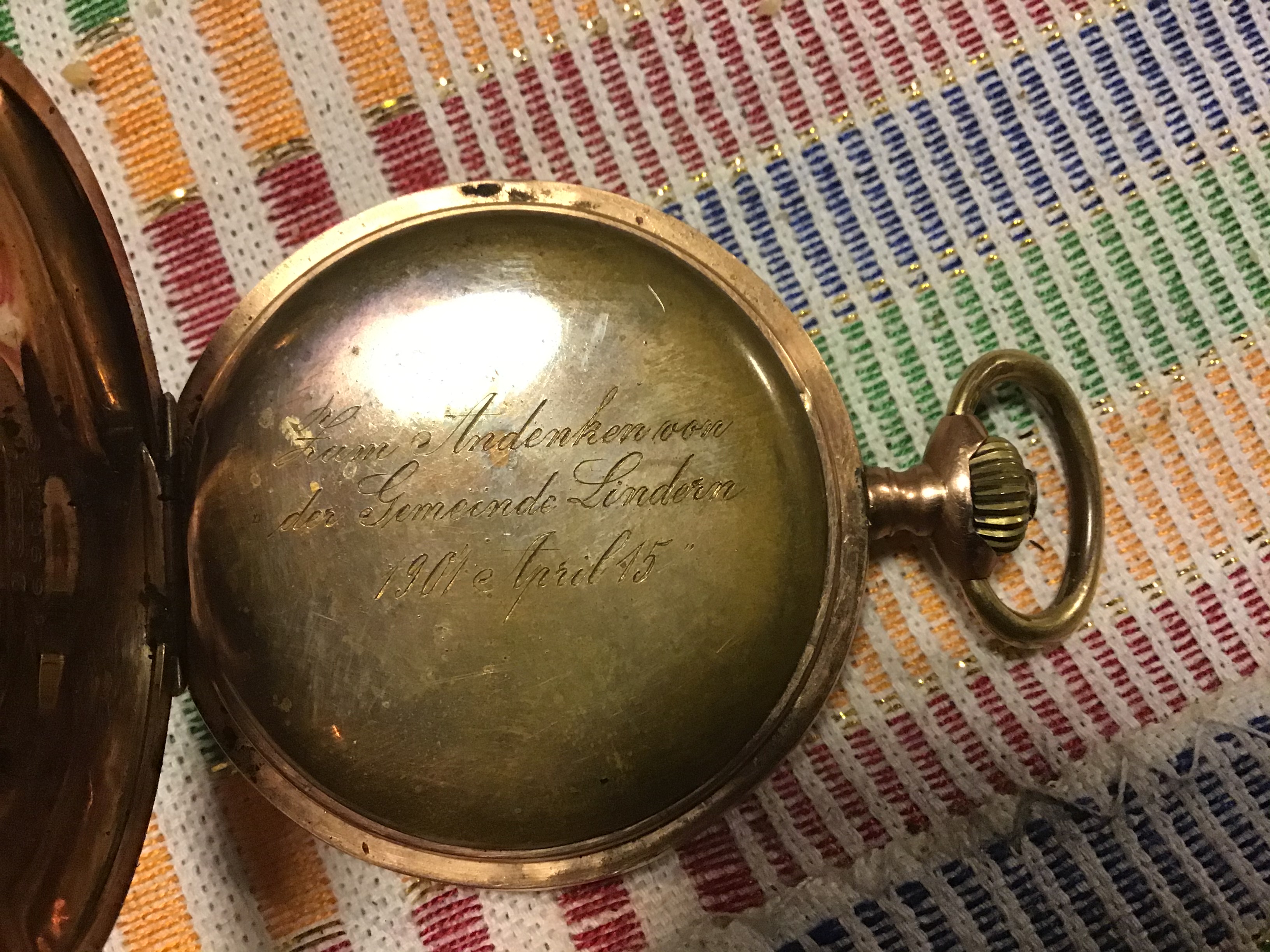

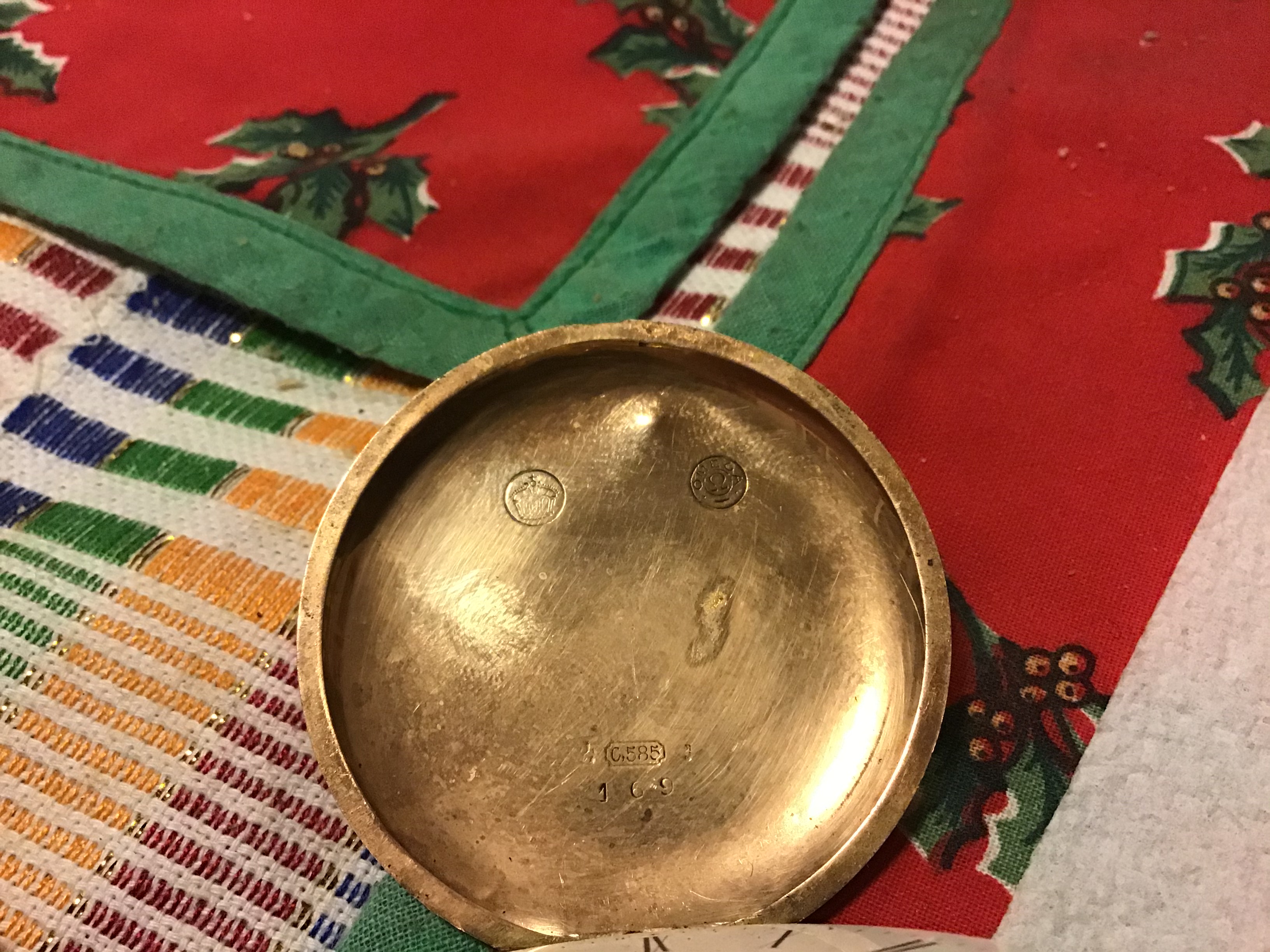

here are some more pictures of the markings. I have one more of the inscription which I will post shortly.
7
The inscription seems to commemorate a municipal retirement in Lindern. Am I correct? Thanking you. David

0,585 is 14ct gold - so if you know the weight of the gold, you can see what the scrap value of that would be.
The movement is one of the higher grade variants - and should run nicely if serviced.

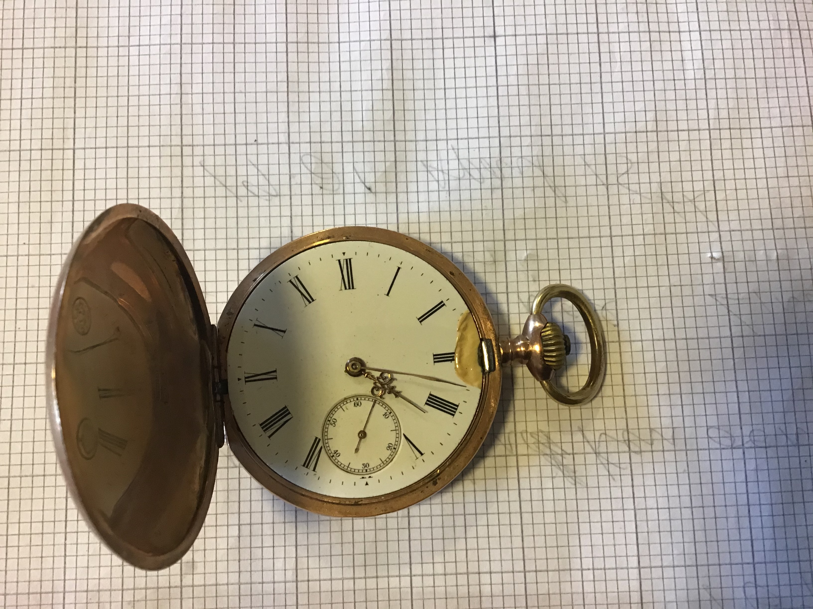

The damage to the dial is less than great - if I was thinking of this as a restoration project, I'd be hunting for a replacement that's close.
It's worth being aware that bringing this back to its former glory will cost you more than it is likely worth.

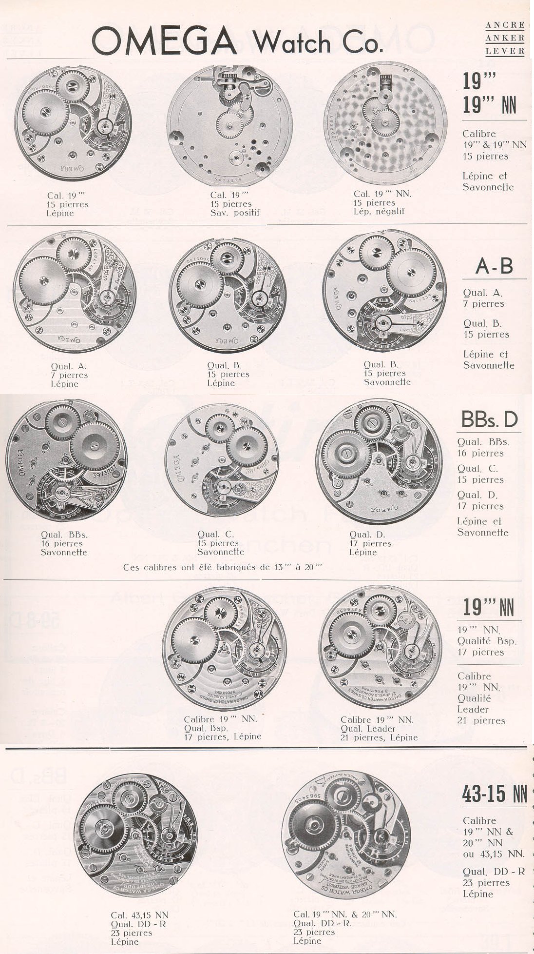

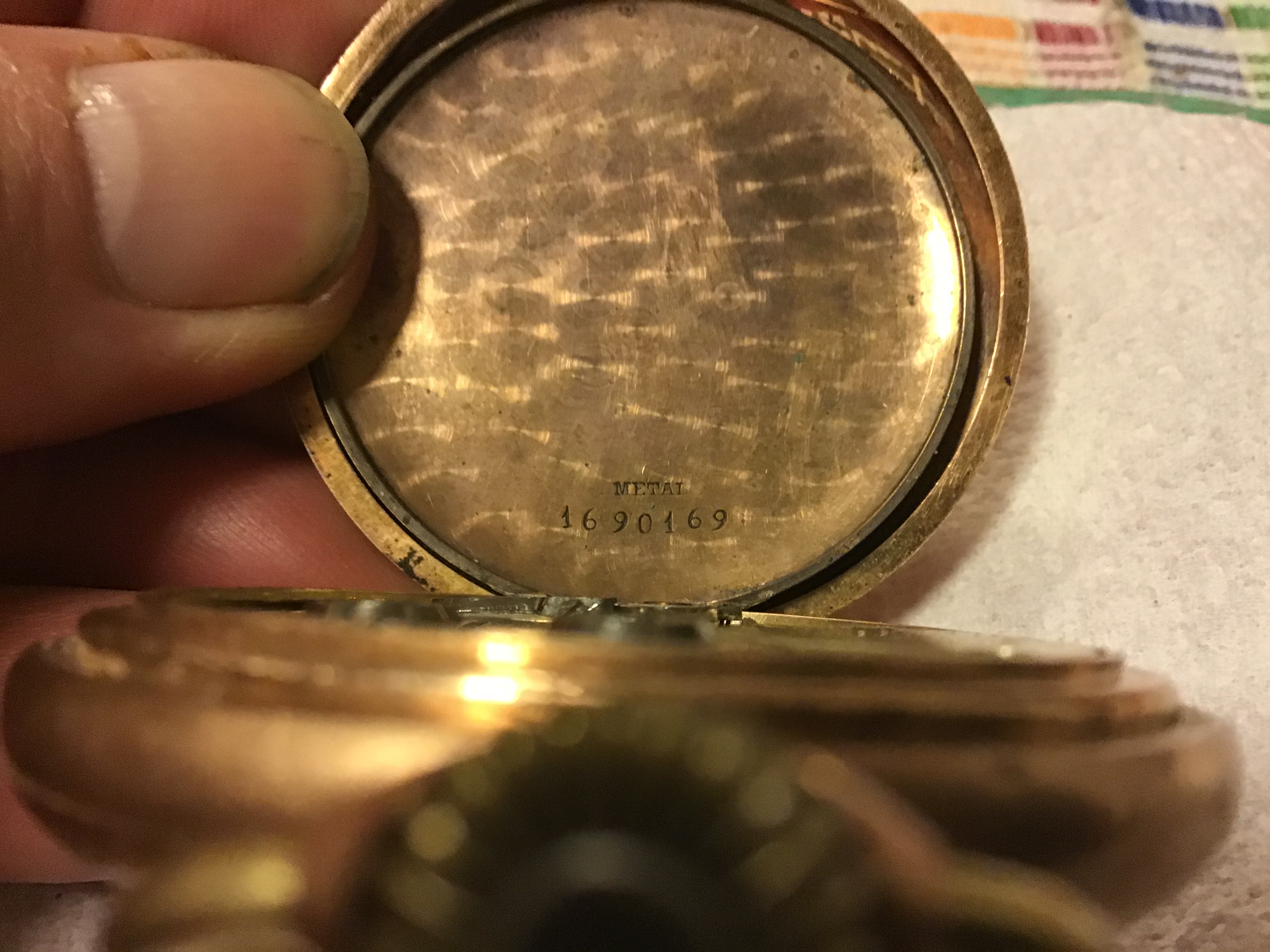

Thanks very much for your advice. It is a beautiful object. Does the number have any significance 1690169. ? On one part it only shows 169. The sheet showing the movement types shows part numbers on each one but this watch has no part numbers on the movement. Is that common? Thank you
18,836
39,175
The hallmarks inside the case indicate a locally produced German case with an Omega movement, or possibly a Swiss case for export to Germany. I'd have to refresh my knowledge of early 20th century hallmarks to confirm though.
Early calibers were marked with serial numbers on the dial side of the plate (i.e.: under the dial), so your watchmaker can provide the details.

You shouldn’t have too much of a problem finding a replacement dial on ebay if you look about. Sometimes i see what at first glance appears to be a lovely vintage Omega dial for sale only to read to measurements and be dissapointed (being a collector of wristwatches).
