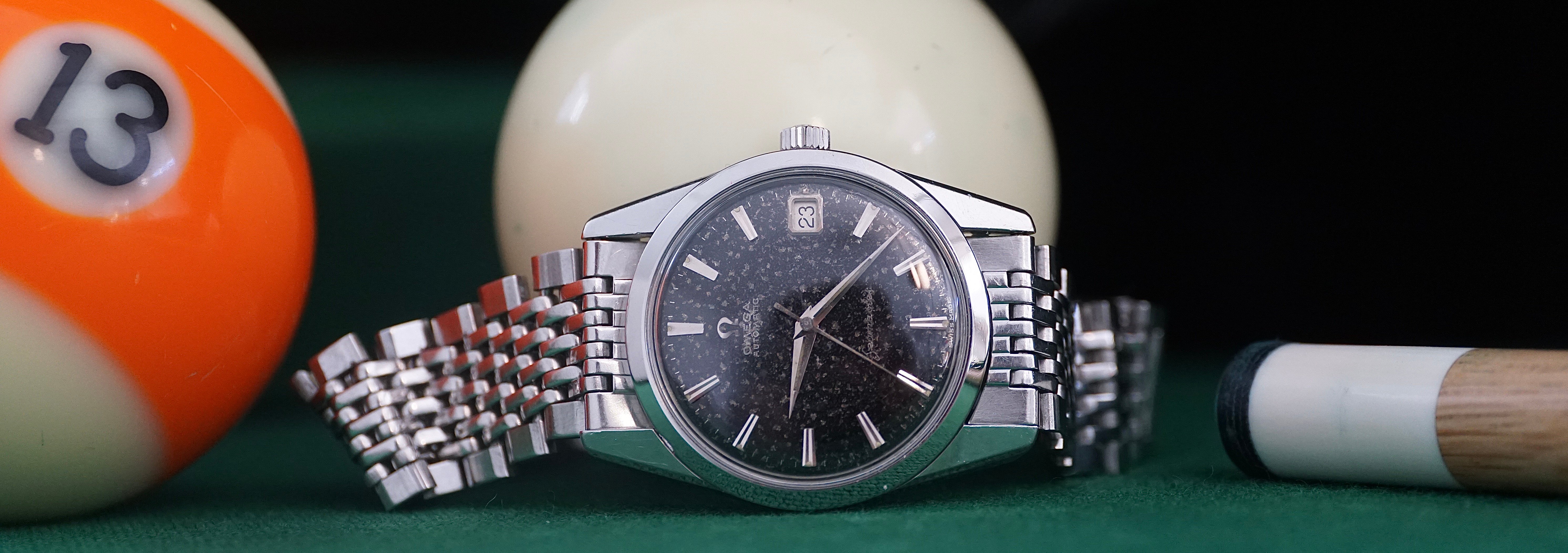

If you want the 5-row as in the picture, call Omega and order 3010/511 for $450.

Pic of my 14701 with the 1503 bracelet that came with it:
The watch was found after sitting in a drawer for 20+ years according to the seller, so there's a fair shot the bracelet's original to the watch.

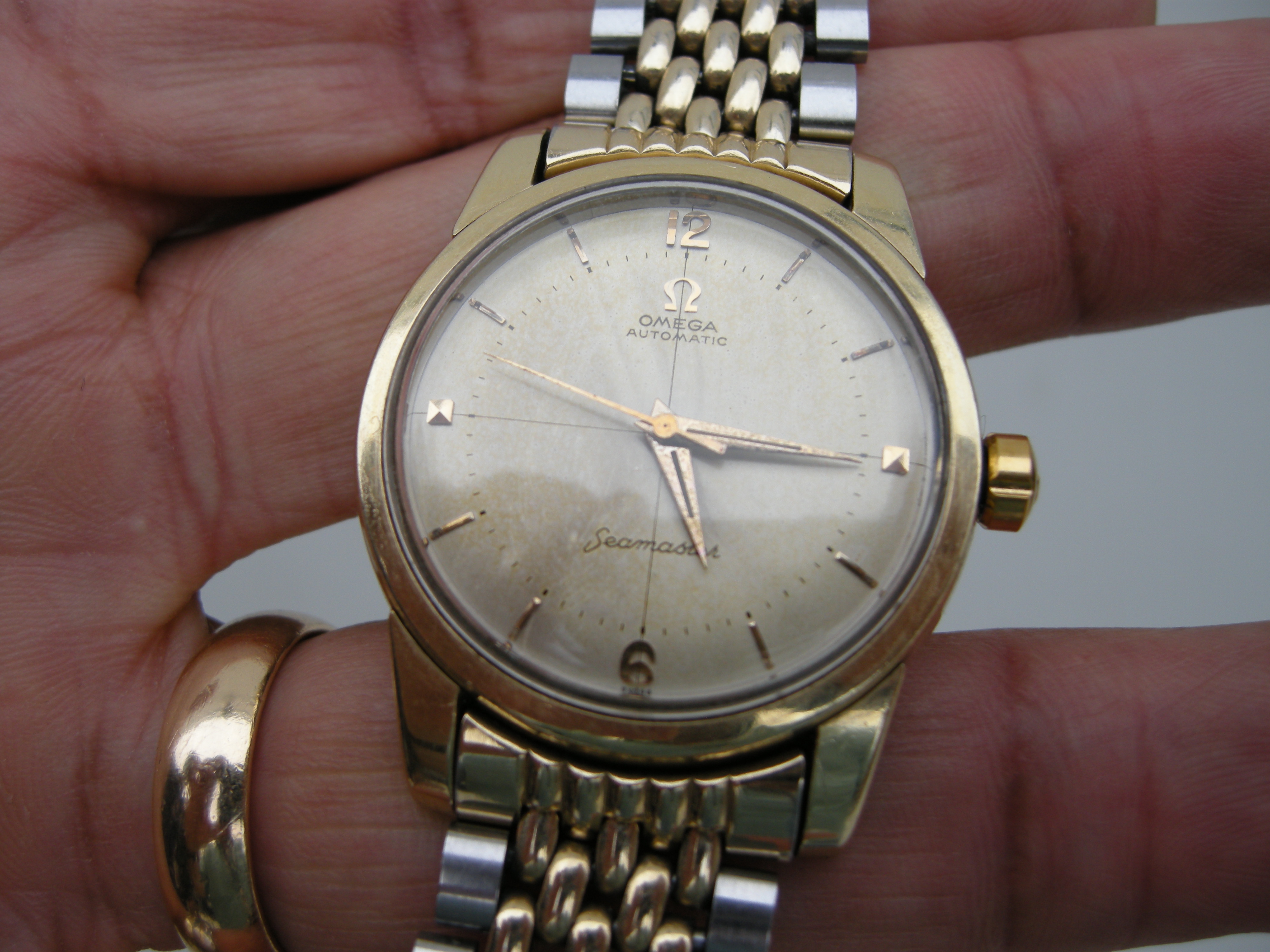

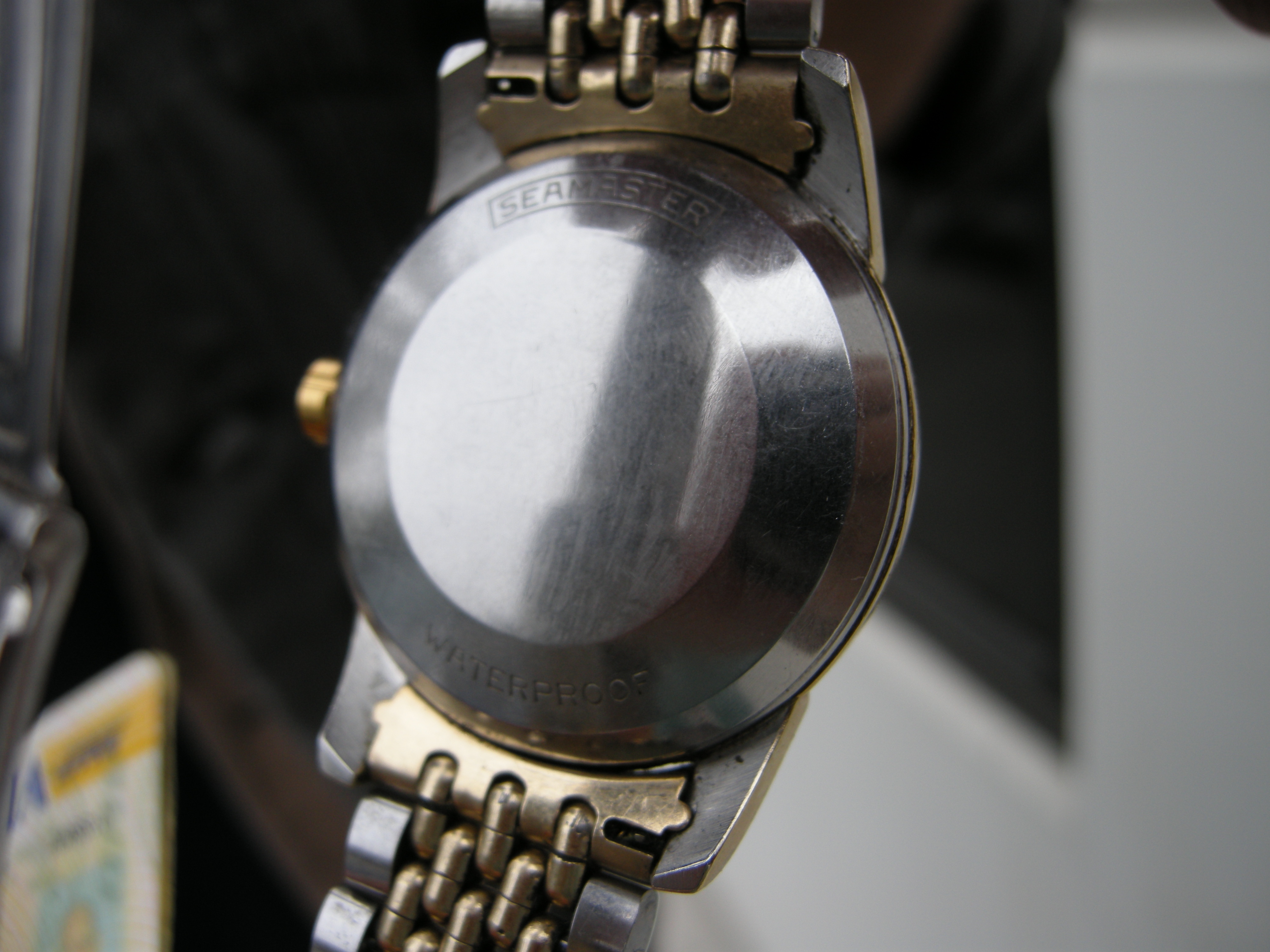

I would like to submit also that none of these bracelets in these pictures are "a good fit". They all need the end links adjusted or replaced. You should be able to fit those so the topside is flush with the lugs.

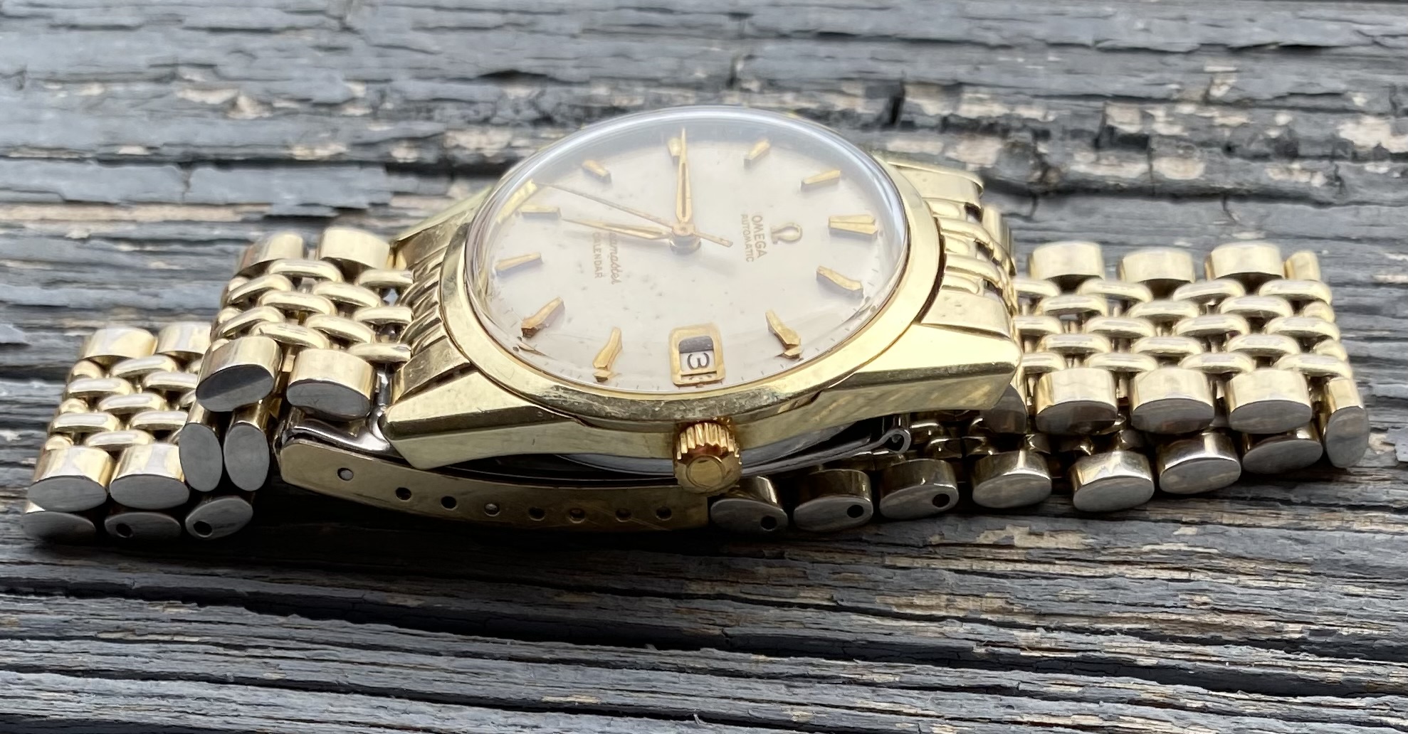

Sorry to revive an old thread but the early glidelock BOR bracelets fits the 14700 very good, could they have been sold originaly to the watch?
My 14700 is from 1959

The timing is about right. Not sure about the rounded endlinks, though.

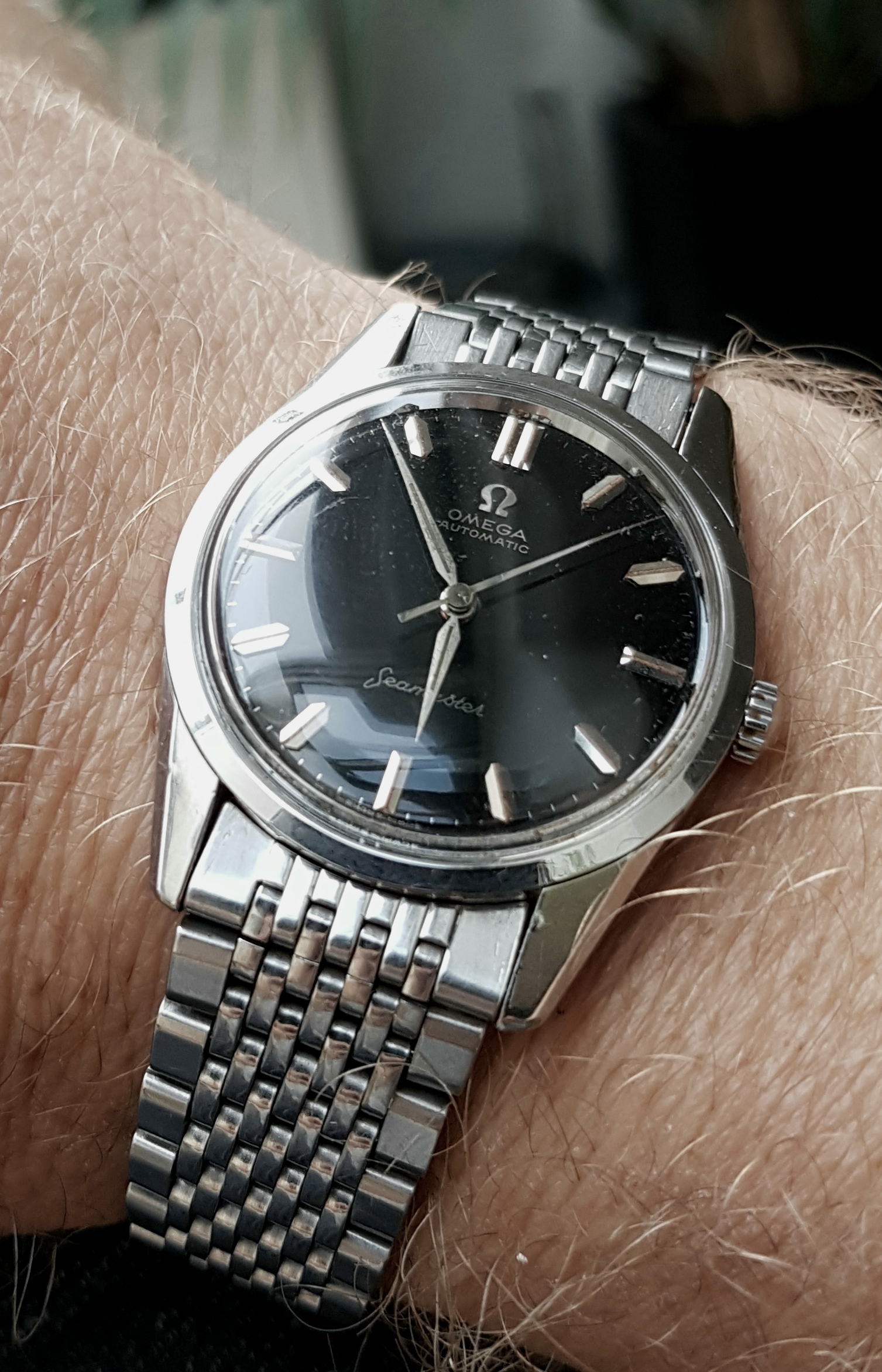

My 14701 uses 512.
do the 512 end links match with the 14700 flat lugs - trying to figure out the best end links? I have a gold plated 14700 so I could go either two tone or 100% plated

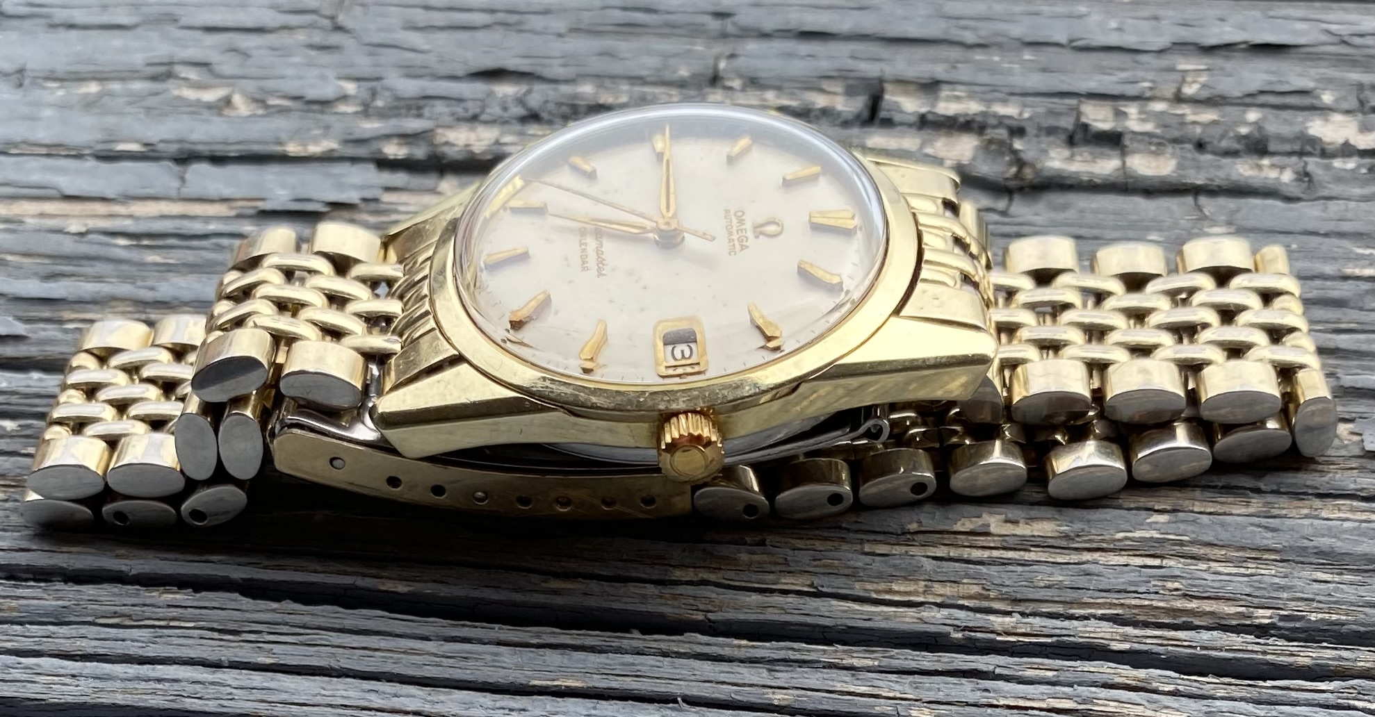

Near as I can tell from memory of owning a 14700 and now owning a 14701, 512 are the ones to get. Earlier version of the 14700 ( I had a dash-nothing case originally) are flat all the way up but the later 14700 and my 14701, there's a bit of a flare towards the tips, to more easily accommodate.
I hope this picture helps some. These end links are not professionally adjusted, so take that into account!
Edited to add: the 14700 had a seven-row bracelet and links, and I don't remember what they were and at the time I didn't much care! They fit!

This looks great, very similar to mine as well. I have the 14700-11 so it is time to start the hunt.
