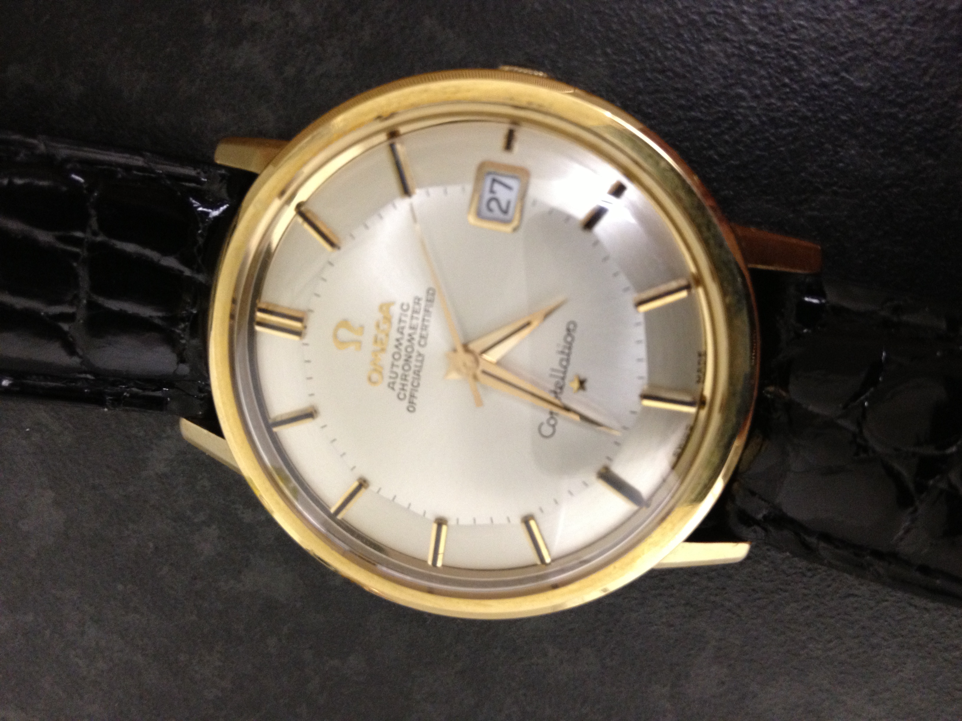

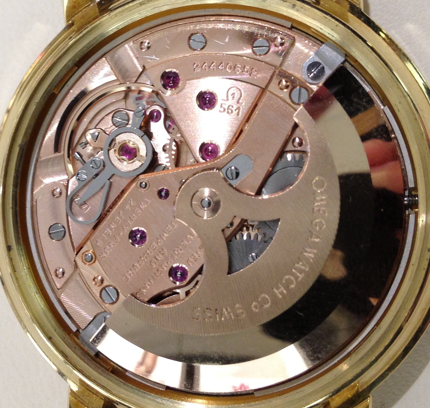

Hi alle,
Bought it a couple a month ago. Seller wasnt able to open it, but I took the chance anyway. Box is so so, no certificate, original bill of sale (December 8, 1965). It came with original leather band. My local vintage watch guy gave it a service + a new Omega leather band. No polishing. He was pretty impressed about it and was sure, it hasn鈥檛 been messed with. After following you guys here for a while, seeing time after time, what you can determine from just a few pics, I鈥檇 like to hear, if you agree with him? 馃 Obviously I hope you agree with him (dial looks almost too good for all these years, but what do I know........). If not, be gently, please馃槈
Pics (Iphone) are from after the service.........
An estimated market price welcome too 馃榾
Thanks,
Paul

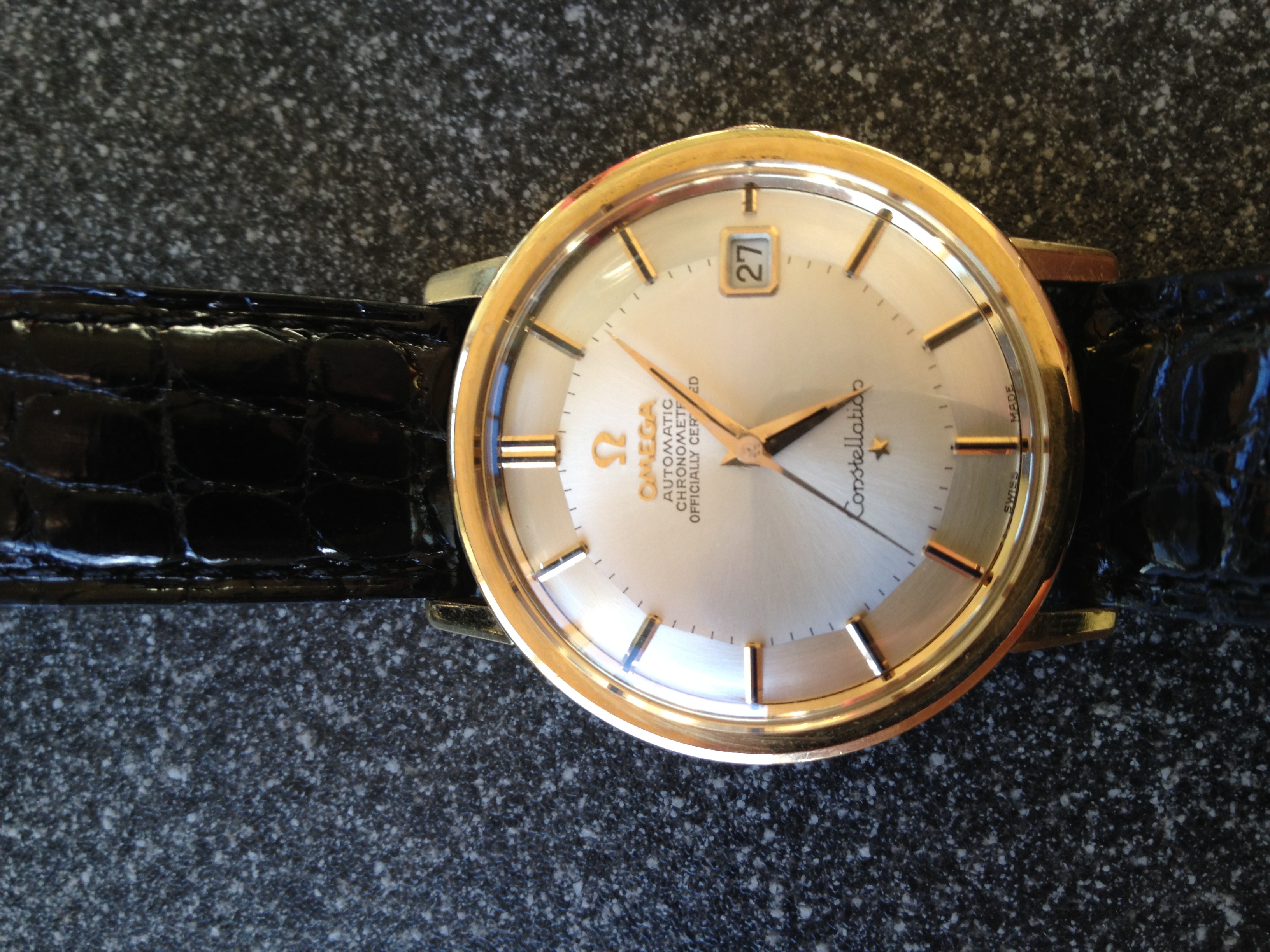

Looks perfectly fine to me. It is not at all unheard of to have a nice dial on a good condition watches such as this.

Hi Pahawi,
Congrats to this nice Connie.
I think , it`s an original Pie Pan dial in very good condition.
Also the movement.

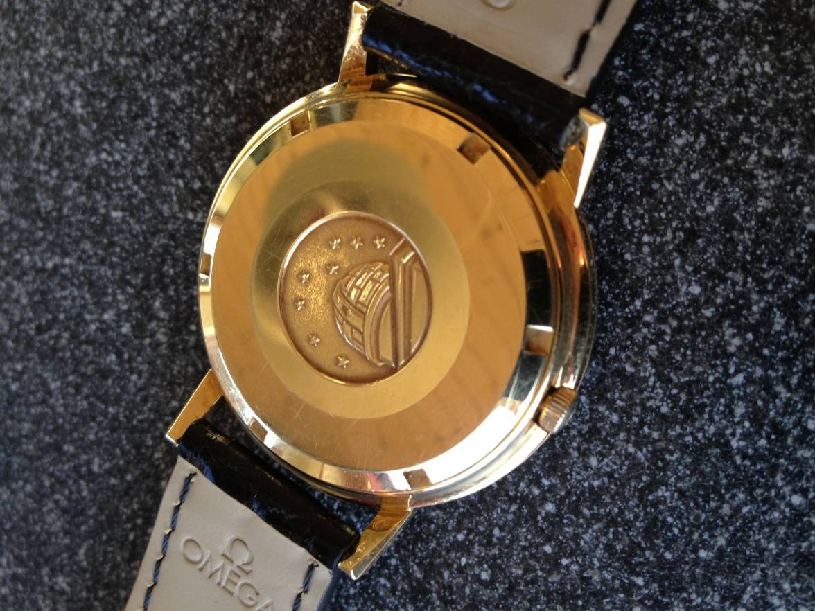

The caseback shows, that it has not been very much polished.
The conturs are crisp, the 8 stars of the medaillon can be seen clearly.

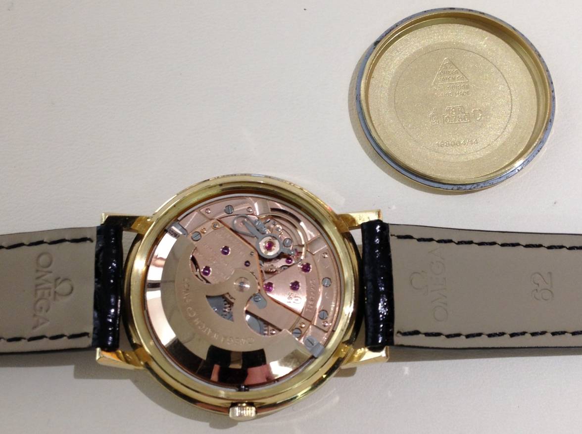

The Ref. 168.004/14 in the inner caseback shows, that those gold hidden crown cases were also taken for the de Luxe version with solid gold dial(168.014).
The strap with the "Kehrer Buckle" was often used for the de Ville models. I don`t know, that they fitted also Connies.

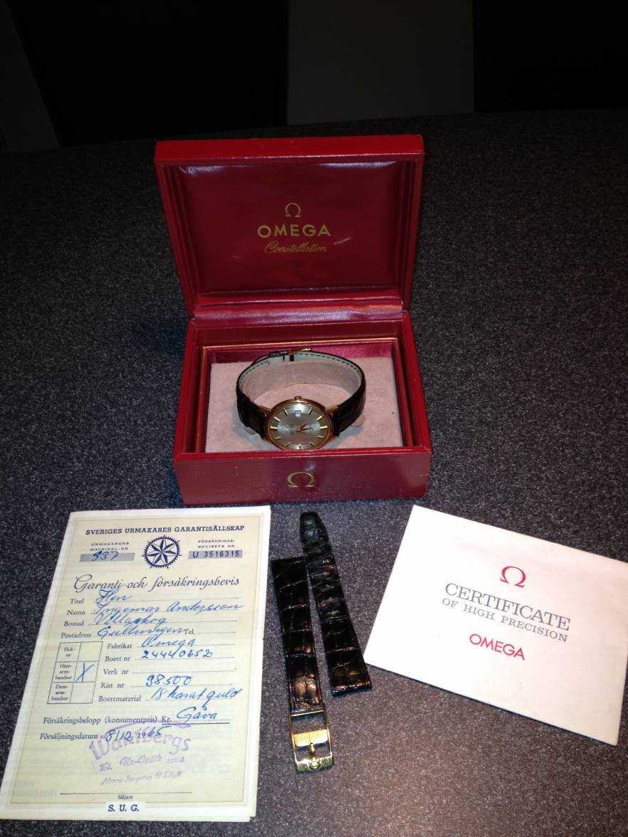

The papers and the original bill are a plus also.
Very nice model, enjoy it!馃憤

Unpolished hidden crown connie with very clean dial and movement. Box and papers are a bonus. I think you did very well with this one.

One of the finest examples of this reference I have seen, along with the full accessory package including original box and buckle.
You've done well.

As mentioned earlier, the certificate is missing in the envelope - there鈥檚 no chance Omega is holding records of some kind on those consecutives and offer certificates based from it?
Sorry for my ignorance.
13,100
17,958
No, but if you read Desmond's article, there are letters to Omega certifying the serial numbers of the movements tested.
That should be sufficient for provenance, I think.
