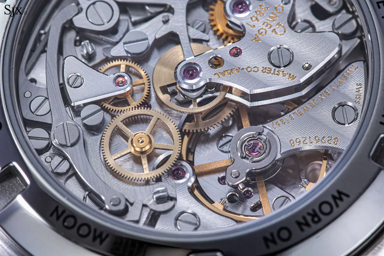

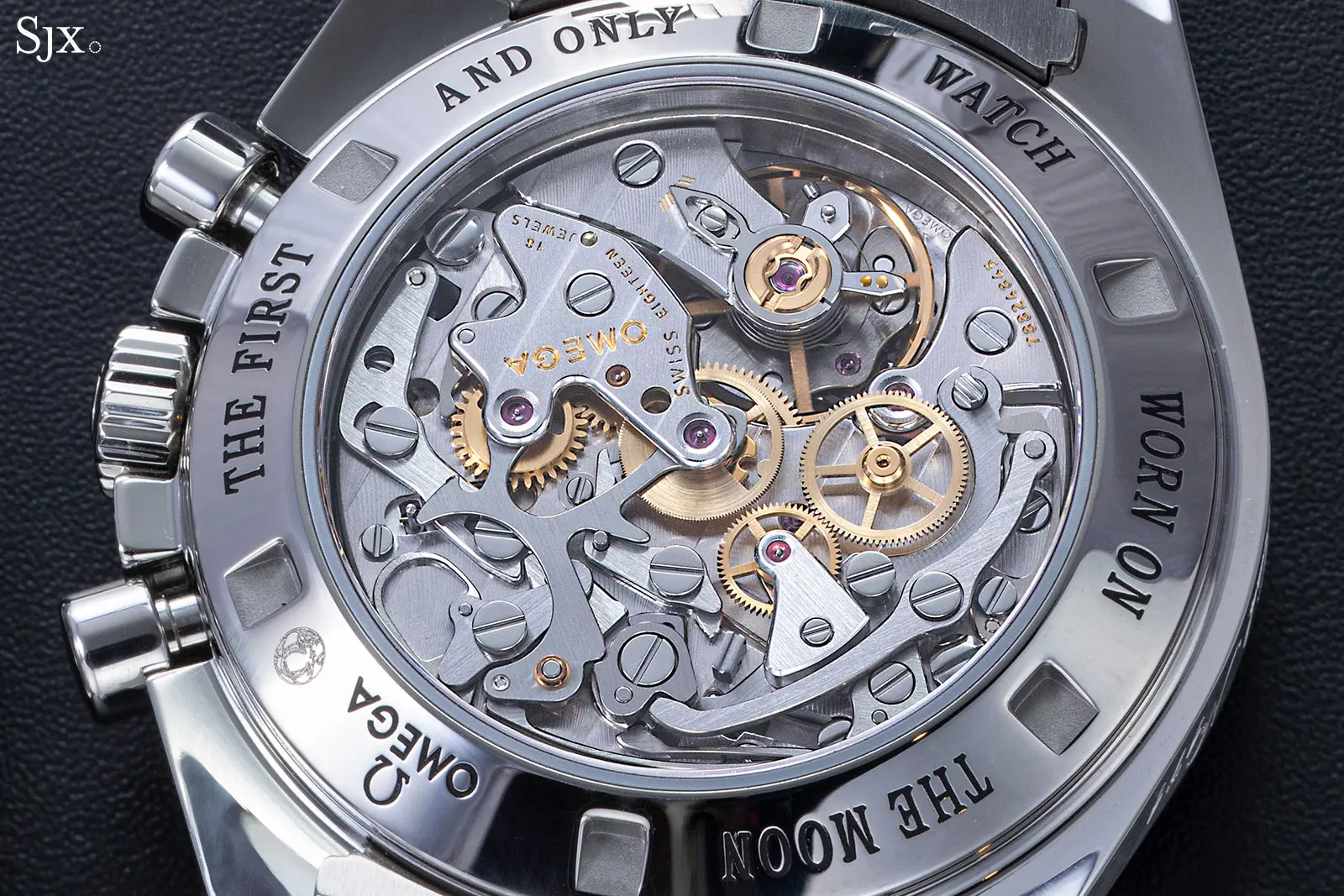

I have run into several written and video sources reporting that 3861 is entirely machine finished, and 1863 actually had some hand finishing (particularly the beveling).

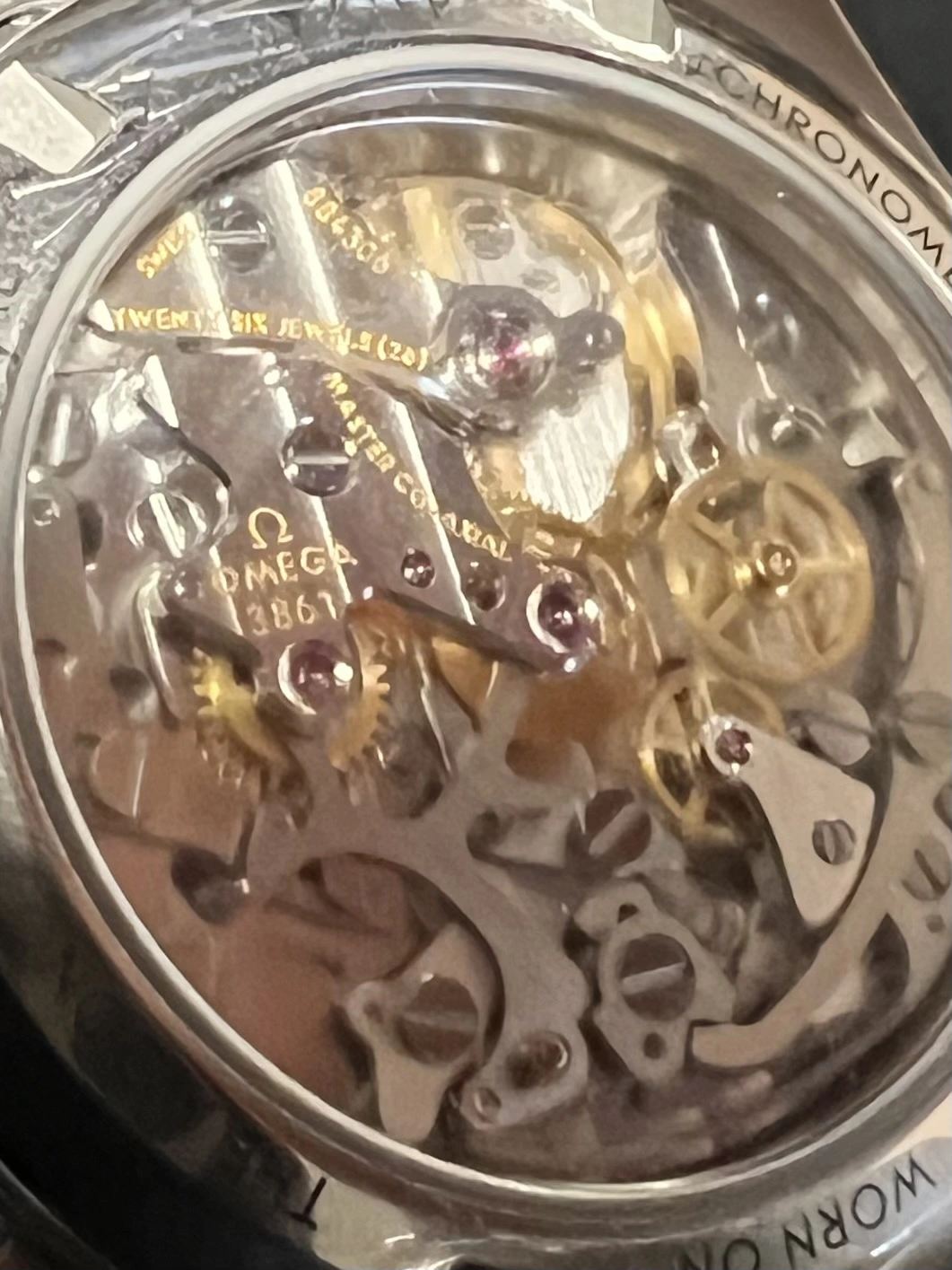

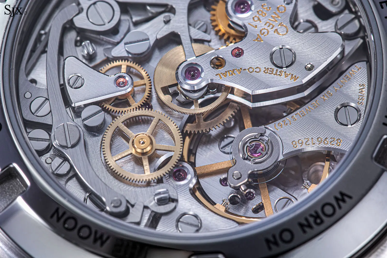

The 3861 being machine finished is quite obvious, as the tool marks are visible on macros.
Is there any evidence that 1863 was hand finished?
In this day and age where even the Holy Trinity are leaning more on machine finishing, I am surprised that the ol' 1863 actually contain more manual work than Vacheron Fiftysix.

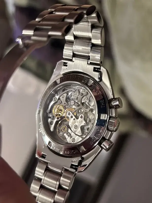

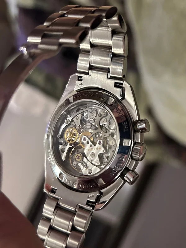

Everything I could find said they were the last of the hand finished, here's mine. Took me a while to find one serviced, but I finally did at Swiss Watch Expo.

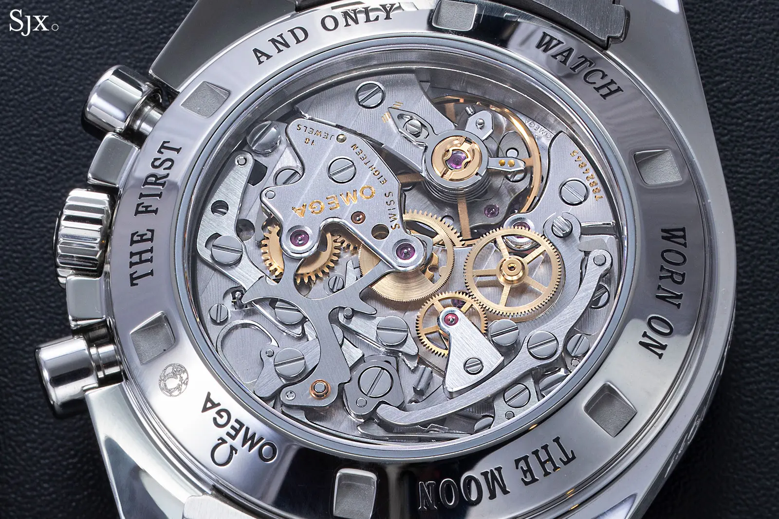

In the photos above, 1861 is suspected to be finished by hand and has a finer finish because it doesn't have tool marks on the bevels. It is more polished, but the edges are rounder. The levels on the 3861 are sharper. Depending on what a person might prefer, but the sharper edges on the bevel produced by the machine seem to me to indicate that the machine can produce a higher standard of quality.

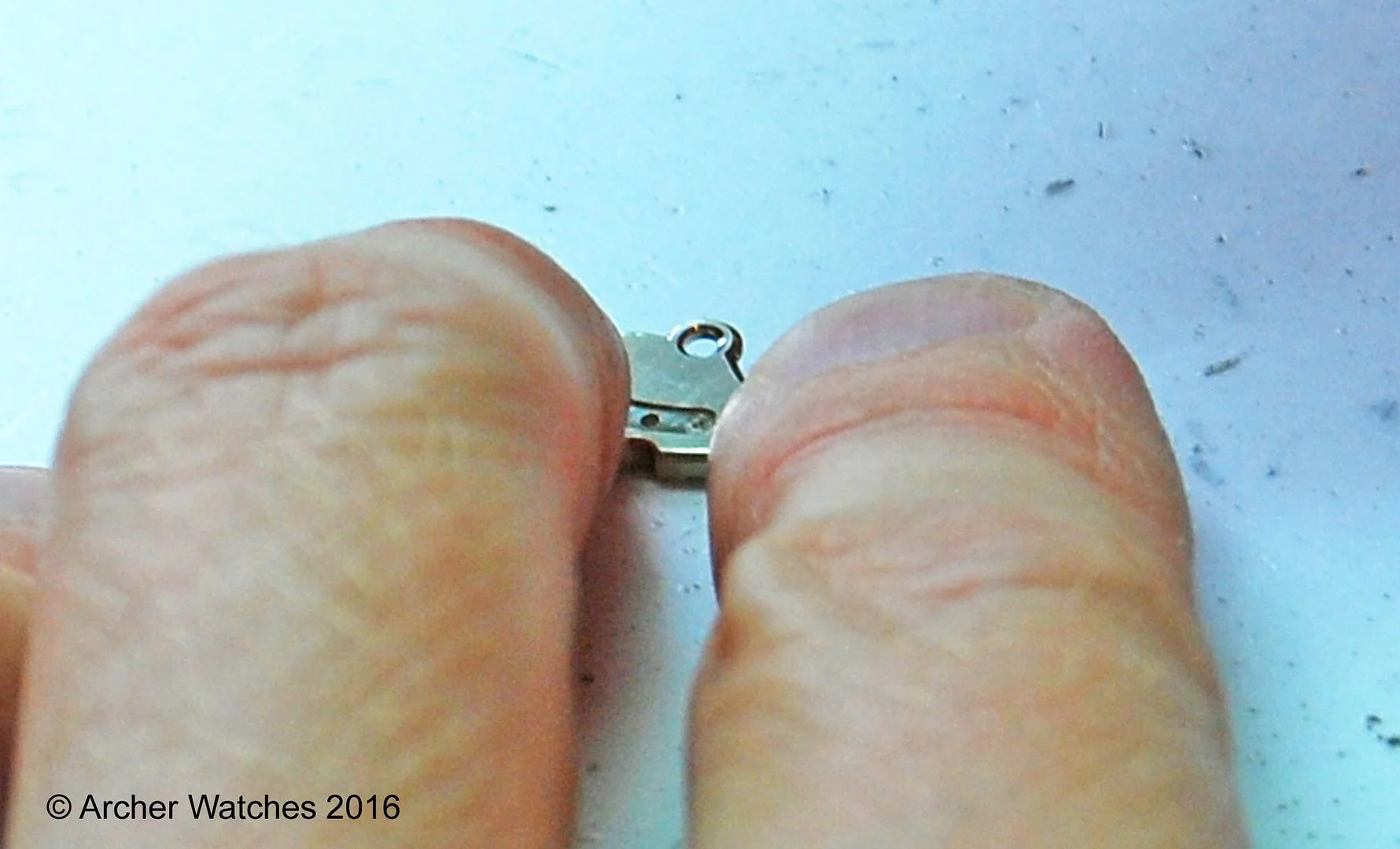

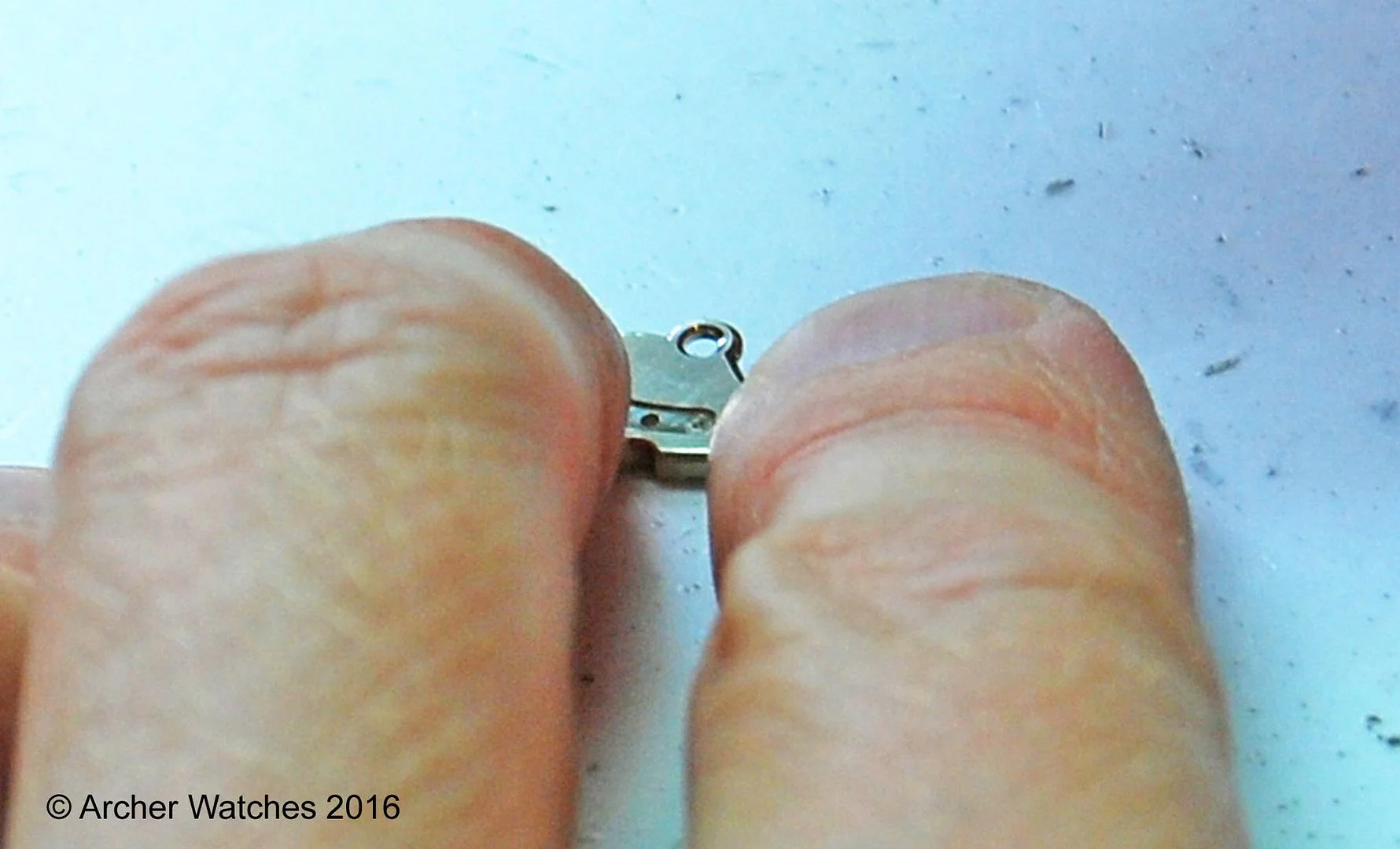

Very high quality finishing in very high end watches is almost always done by hand - not big brands, but more the realm of the very skilled and traditional independents. Machines can get close certainly, but here's an example...back in the day I spent some time in the shop of Philippe Dufour. He was busy making his Simplicity model, and he had a couple of watchmakers in the shop helping with that. I took a very short video of one who was polishing countersinks...here is the part and the countersink:
Here is the video:
In speaking with the watchmakers that were doing this, using a ebony stick with very fine abrasive powder, rotating it with a bow as you see in the video, it was clear that determination of the final polish being done was as much about how the process felt in his hands, as it was about how the part looked. He said the resistance of the process changed when it was finally done.

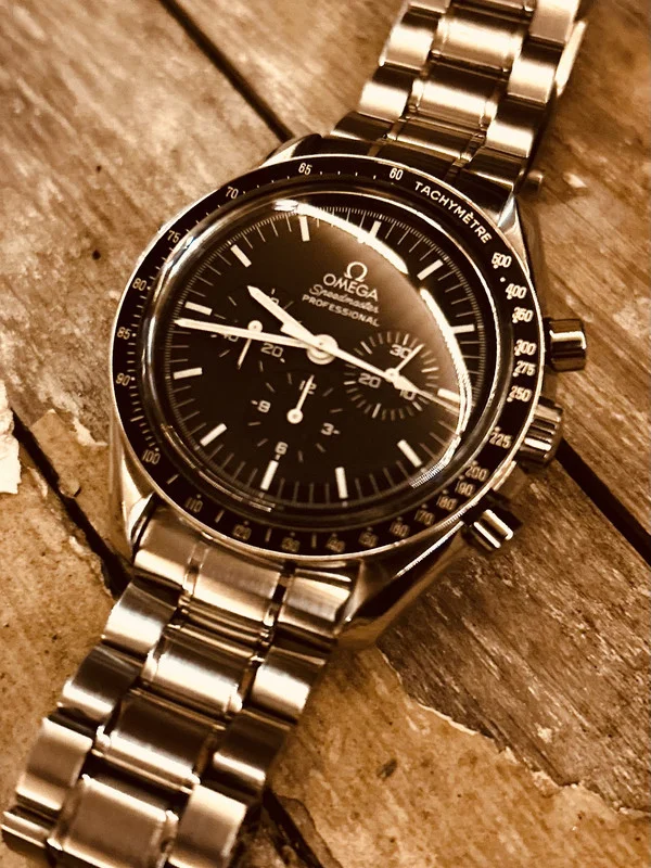

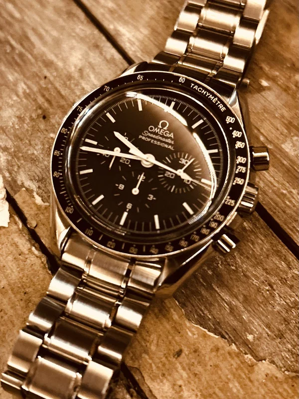

Not the best picture since the bracelet is on, but it looks pretty nice to me.

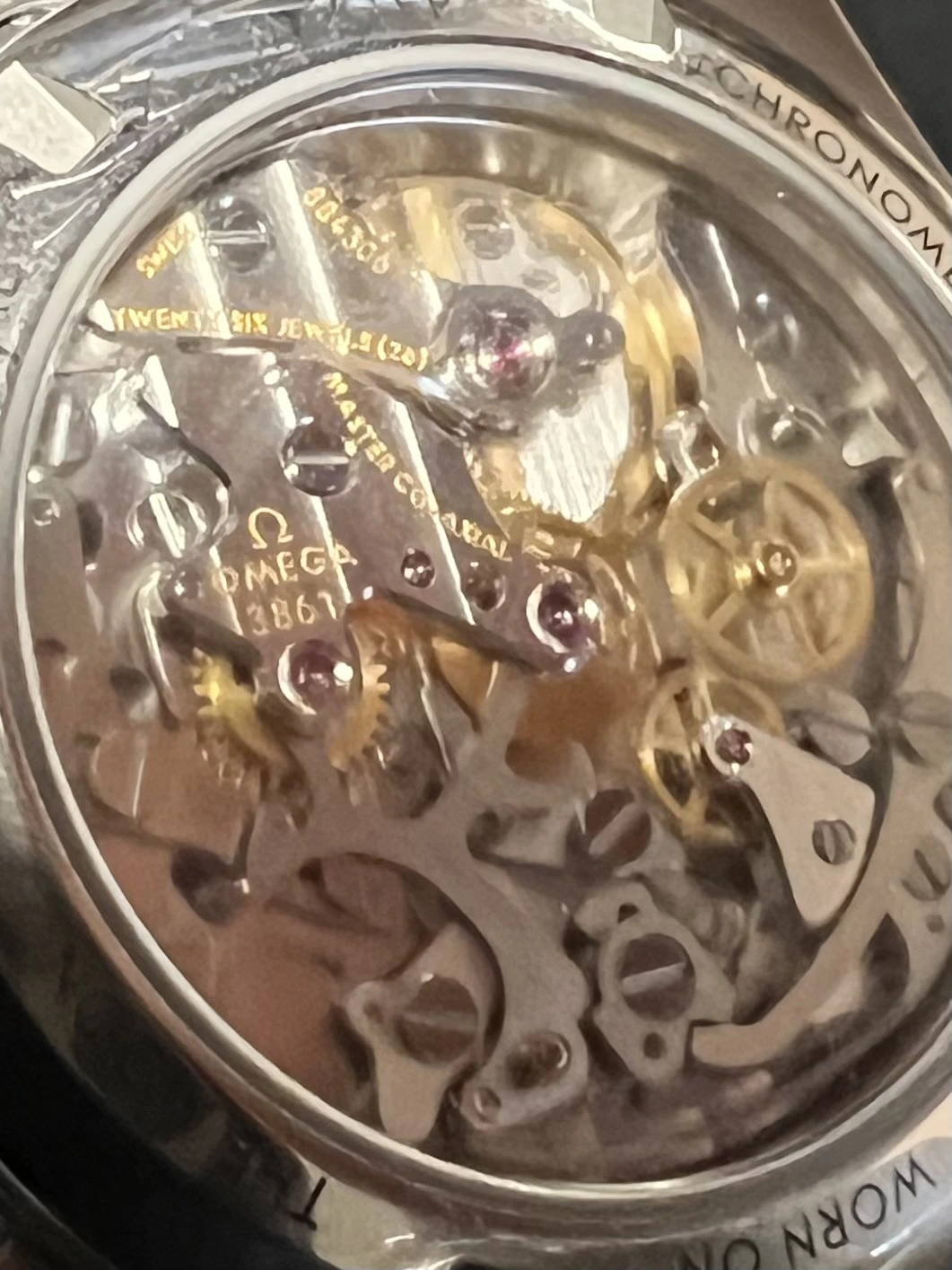

I guess we have to define "hand finished", the only thing I could find is that it's partially hand finished. Compared to a Patek or their like I guess not at all, but it seems there is some hand finishing involved. it certainly doesn't appear all machined finished so I guess it having some qualifies it on the open market enough to make this statement?
On line it says...
"Yes, the Omega Calibre 1863 movement is partially hand-finished, but not to the same degree as some high-end movements. While the movement's parts are precisely machined, some components are hand-finished, particularly those that are more visible, such as the bridge and the dial-side, to achieve a higher level of aesthetic appeal."
It's certainly pretty to look at.
