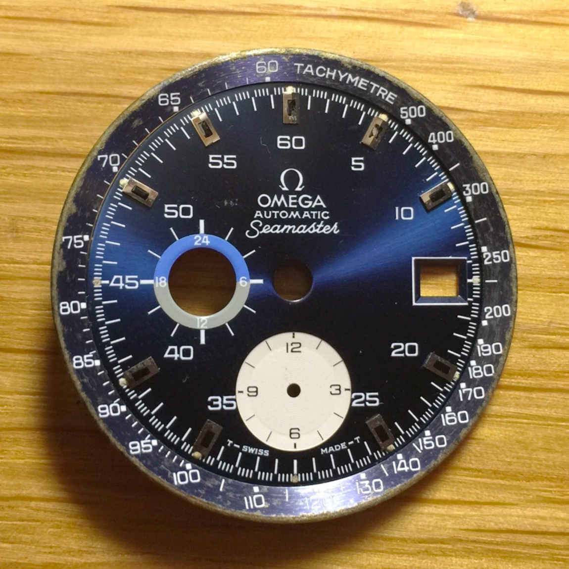

The four different blue 007 bezels were especially interesting to me, since mine is different still. It's glossy like three of yours, but perhaps darker (maybe even a hint of purple).
The most noticable differences are the size/position of the tachy text, and the position of the five minute markers relative to the numbers (mine has a square adjacent to the 'belly' of the 5 in 85, and a square adhacent to the middle of the 0 in 90 - neither of whic occur in any of your variants).
So many variants...no wonder I could never source one exactly like mine.
The blue bezel I had before changing to a white one was also close to purple in certain lights. It was shiny and I kind of felt this, along with the darker color, meant it didn't quite match the matte B dial. Definitely more suited to the satin A2 dial.
I thought the best thing to do was to go white. Here are a couple of shots showing the old one's "purpleness":
(strange seeing those old hands again! I've quickly gotten used to the "correct" ones)

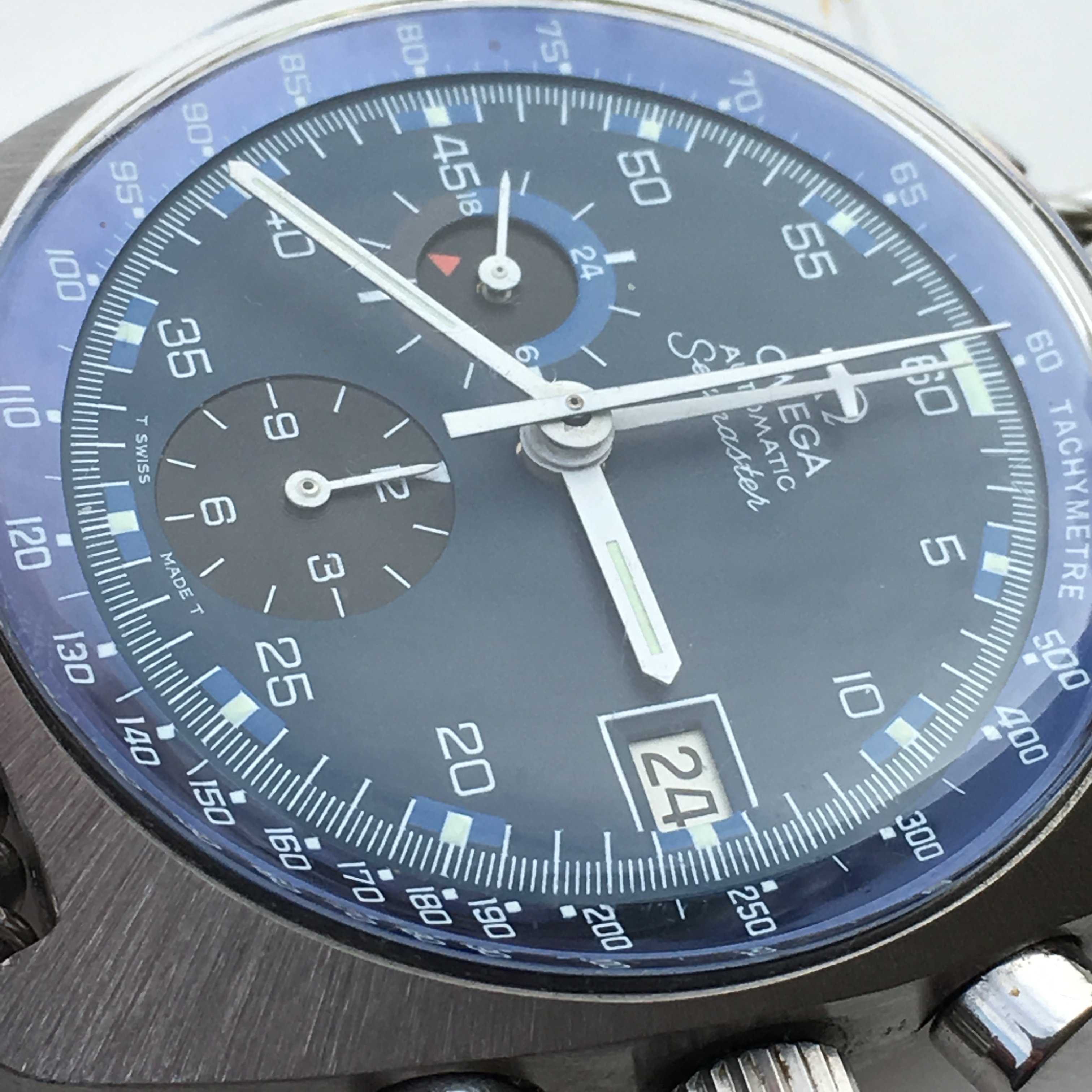

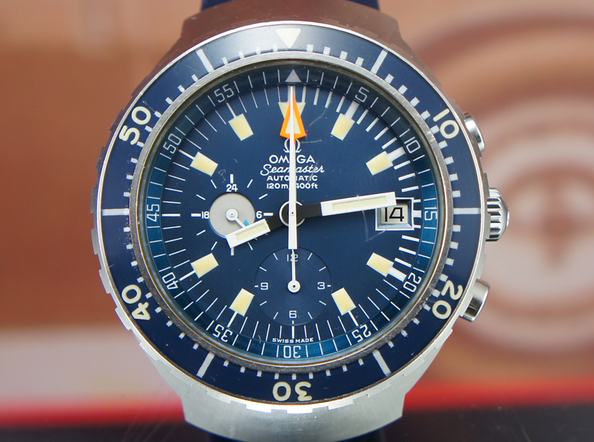

Since this seems to be the go-to thread for everything 1040 related and where the experts are gathered (in other words: a thread that @Andy K is watching ;-) I wanted to ask your opinions about the following Big Blue:
http://www.carsandwatches.com/2016/12/30/omega-seamaster-120-big-blue/
I have a few concerns:
1. it looks good. Does it look too good? The bezel seems a little scratched, as does the case. Same goes for the lume: discolored but lightly and very even. Could be consistent with a very carefully worn watch, but also with one that has been fully restored with service parts a few years back.
2. the grey subdial. Never saw that on a Big Blue before. Could it be indicative of work having been done on this? Does it cast a shadow of doubt on the originality of the rest of it?
3. the movement number. 409XXXX is exceedingly high from what I see on Andy's website - more in line with a Speedy Mark IV than anything else. I also learned there that it was common practice for these movements to have been swapped out during service back in the day. Or is this whole thing a watcho-like Big Blue?

1. I agree, it looks more like a watch that was fully restored rather than an untouched original. The scratches bother me less than the general "unused" look. I suppose it doesn't actually "bother" me other than this example is priced as if it were a mint all-original watch, which I suspect it is not.
2. The grey 24 hour disc is wrong - you're right for that to raise a red flag. If it were so well-preserved, why would the 24 hour disc have been replaced during a prior service?
3. The movement serial doesn't concern me so much. I need to update my site because I've since seen a few more serial numbers in the 40 million range.
I can't really draw any conclusions from those numbers. Yes it could be a swapped out movement, but I don't think the SN proves anything without ordering an extract.
The 40 million batch is a curious thing. My list, when sorted by serial number, leaps from 3829 all the way to 4032. I've yet to see a 1040 or 1041 with a 39 million serial. Omega liked to jump around - I've also seen no 33 million serials and only three 37 million serials.

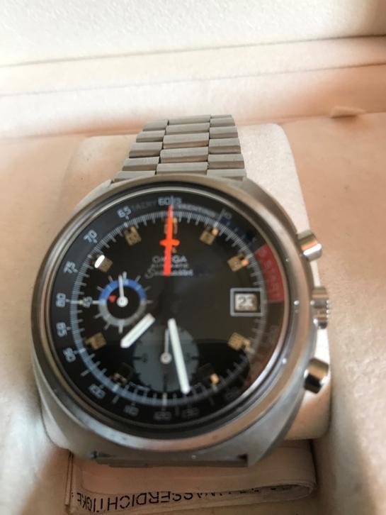

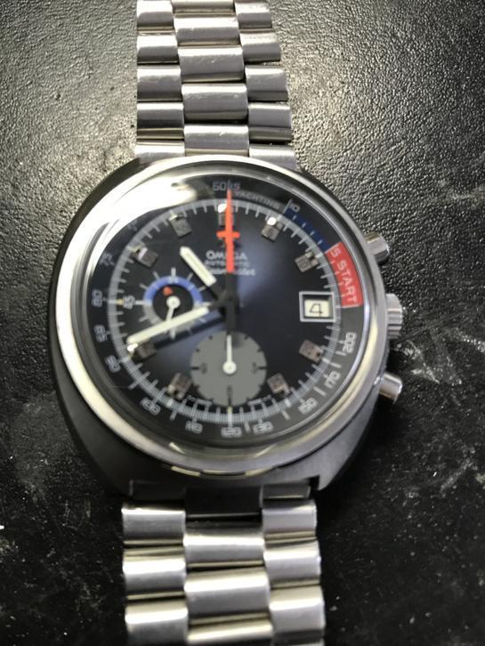

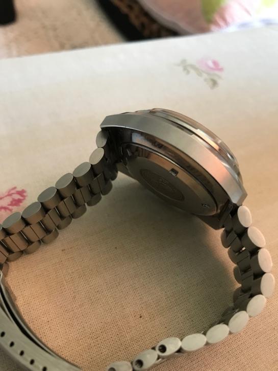

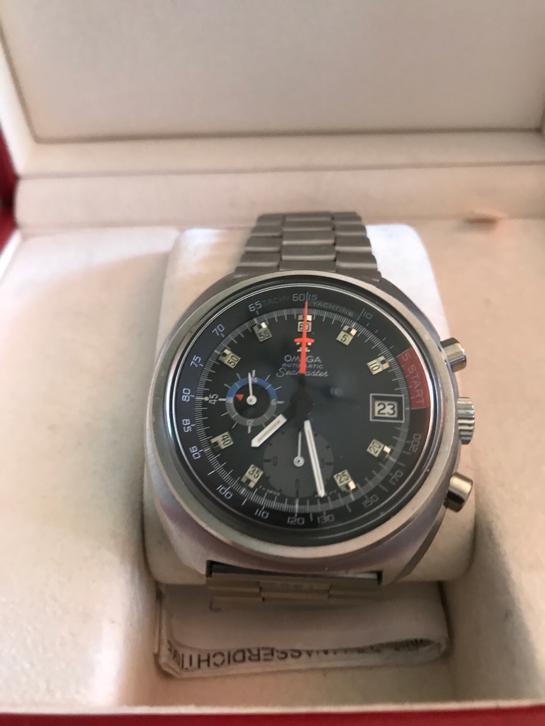

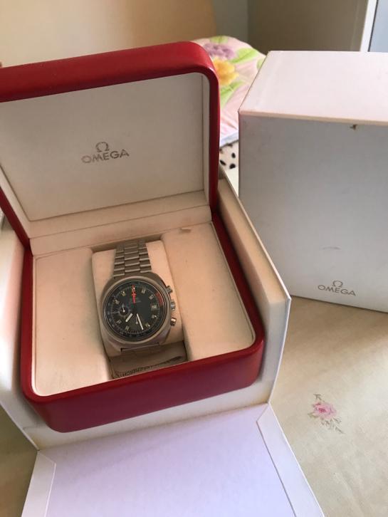

Since this seems to have become the go-to 1040 thread, I'd like to pick your collective brains regarding a Yachting I just found (...though not yet purchased).
The seller seems trustworthy (though certainly a dealer), and as he's Dutch, I could pick it up more or less locally. He claims to have the papers for a full service back in 2000 (which is where the incorrect box comes from). I've requested the serial number, better pics of the dial, and the movement. I guess we'll see if he can deliver these 馃榾
[EDIT] Just got an e-mail: no luck on better pics (still blurry) but the serial checks out (35601XXX). If nothing else, this one can be a data point in Andy's research (I can PM you the full serial if you want). Picture of the service receipt added. I think it says:

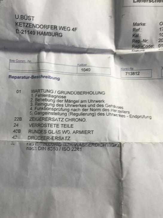

Full service
1. error diagnosis
2. fixing movement defects
3. cleaning movement/case
4. function test to manufacturer's standards
5. Regulating the movement - final test
- Hand replacement chrono
- Rusted parts
- Round crystal waterproofed
- Pushers replaced
- Testing waterproofing to some ISO standard
Other than the out-of-focus pictures, nothing really jumps out at me as being particularly worrisome. The hands maybe look too new, but if I read the receipt correctly, only the chrono hand has been replaced. Or am I missing something obvious here?
Full service
1. error diagnosis
- Rusted parts
- Pushers replaced
Looks correct to me, though I have the same concerns about the hands, they look far too clean and those pictures don't help. And I'm always in the market for full serial numbers!
