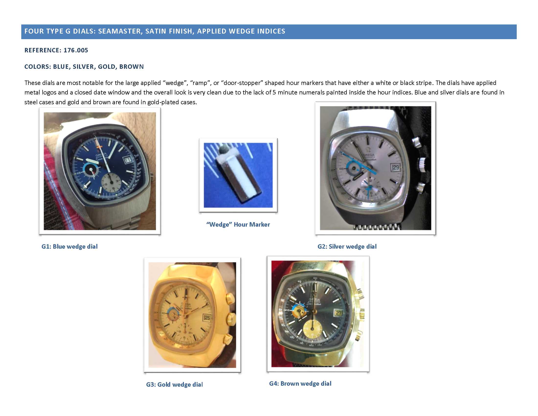

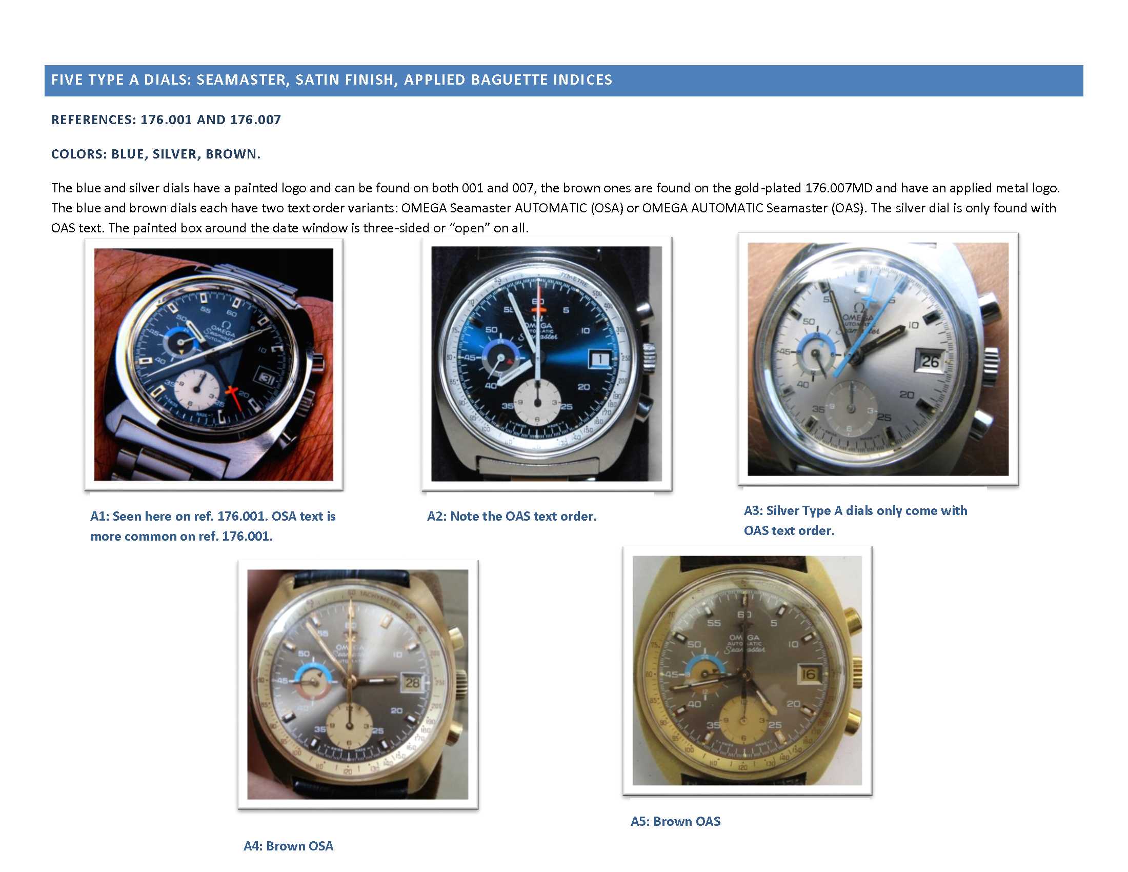

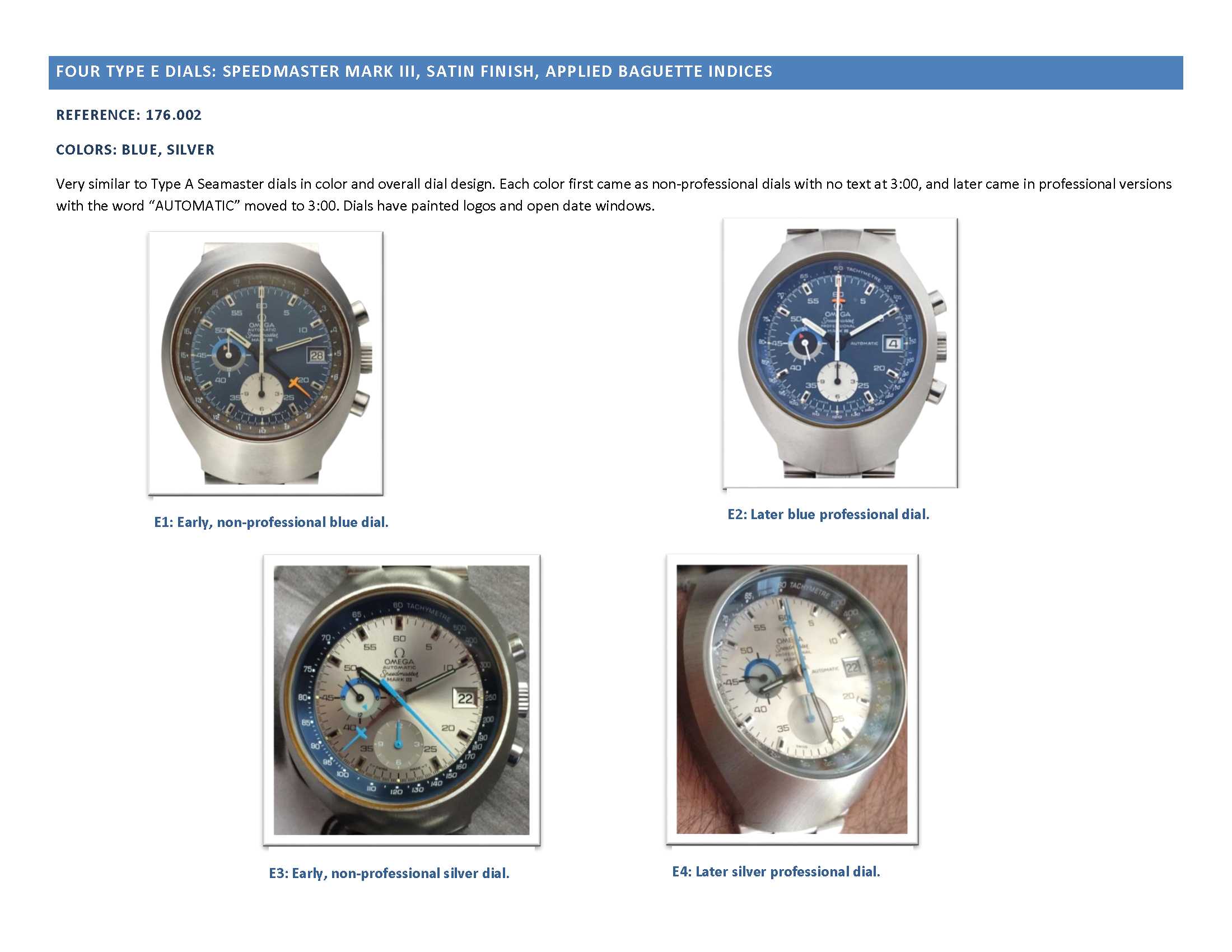

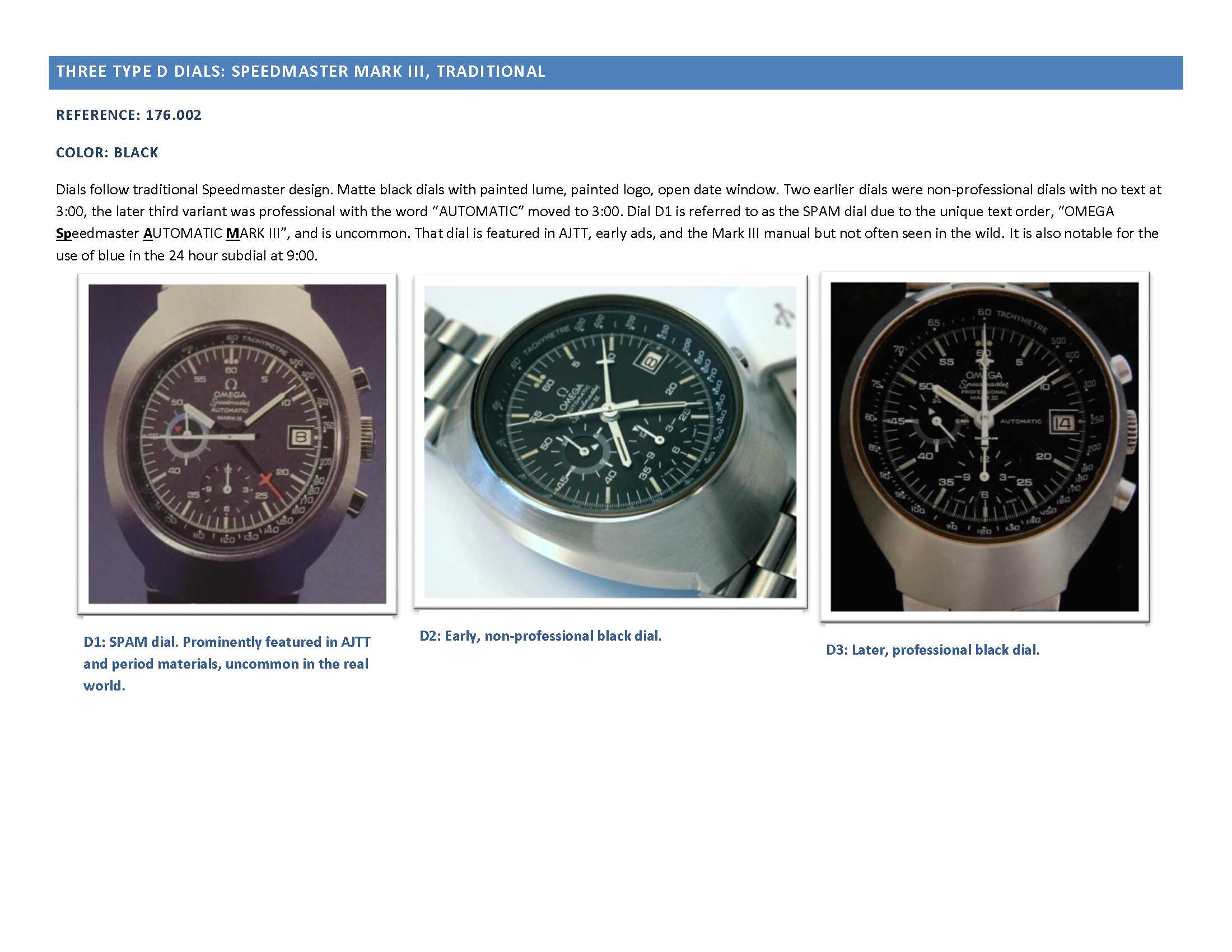

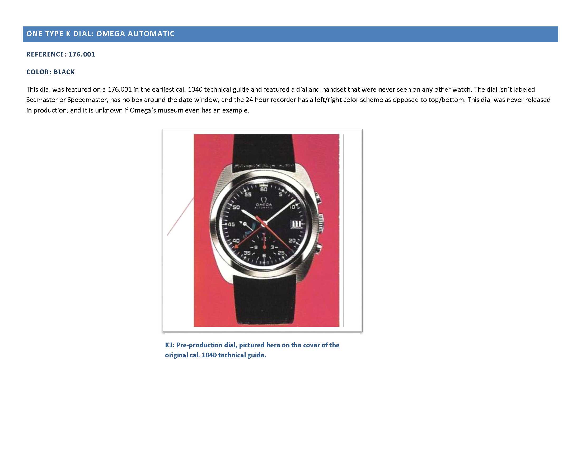

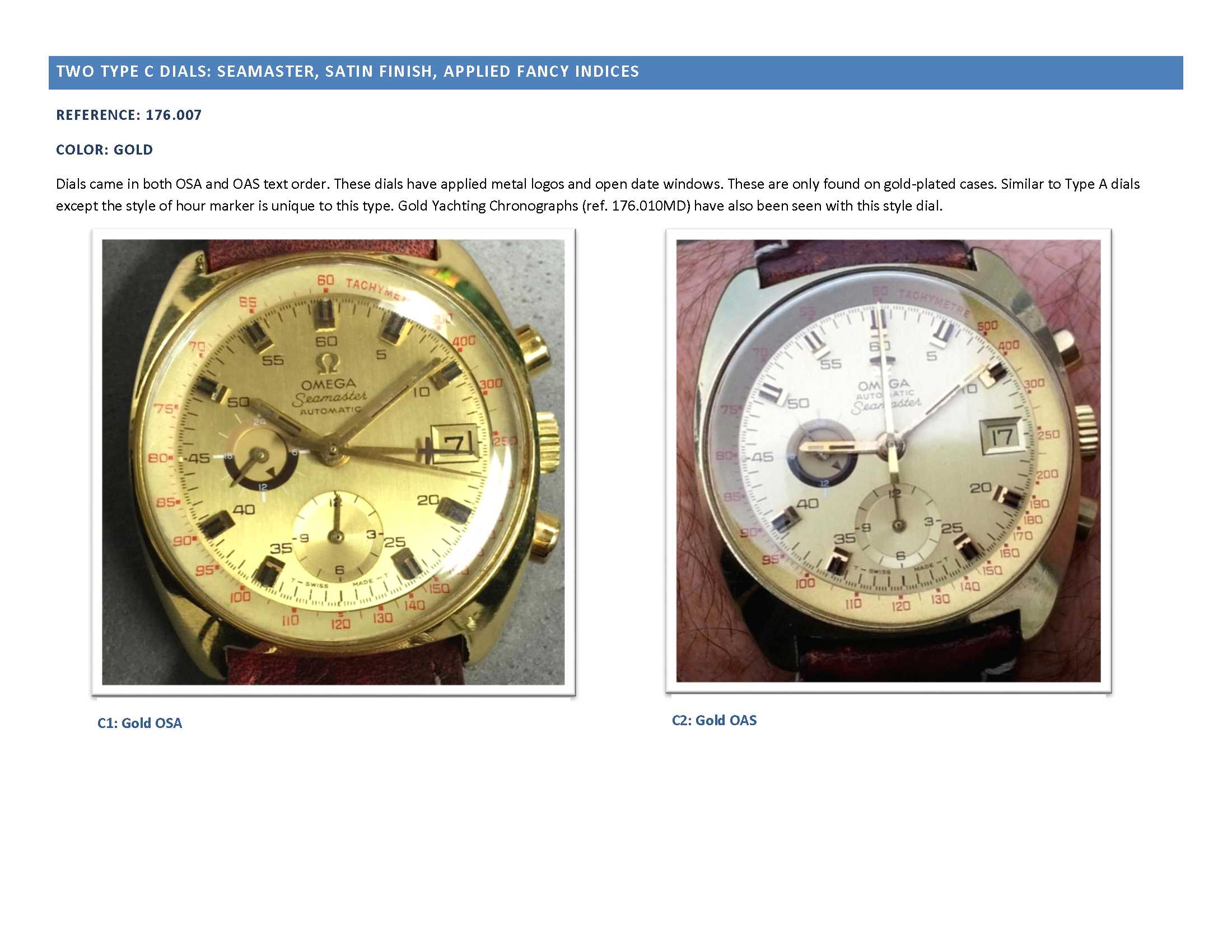

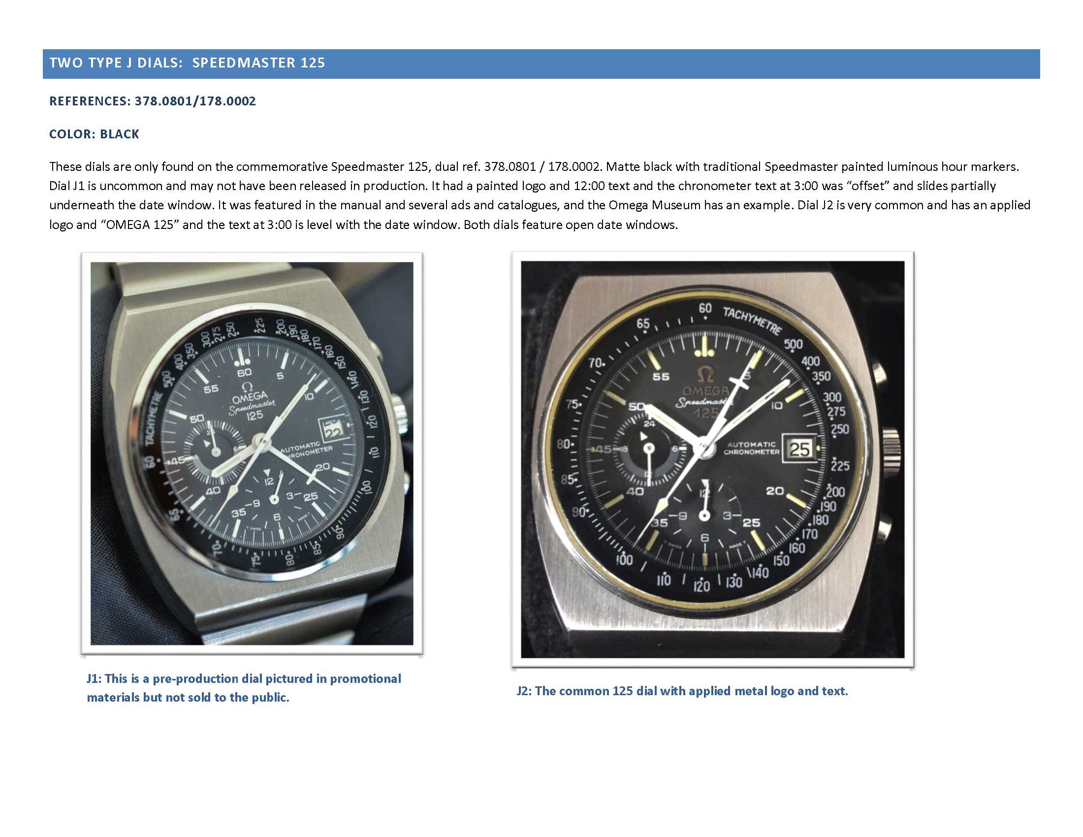

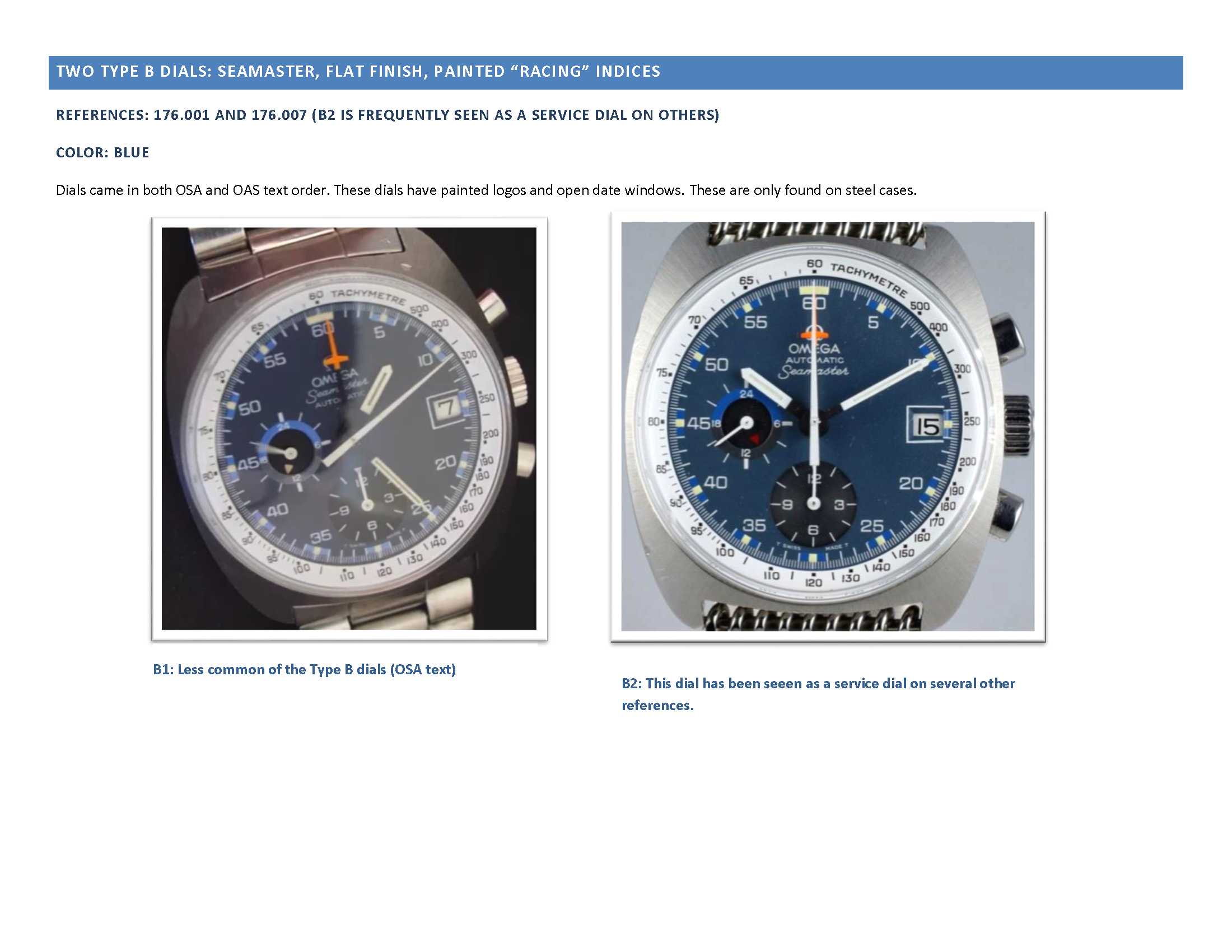

    One of the challenges with collecting cal. 1040 chronographs is that despite the fact that there were seven distinct case shapes (eight if you count cal. 1041) is that dials and hands were compatible across all references.
    Omega being Omega, they also released multiple dial options for each reference. Some variants were retired before sales to the general public began, some were retired and replaced during production. Others were created by Omega sometime after the entire family was retired and used as service dials.
    There are 28 distinct dials that could be found by diligent collectors, and two that seem to only live at the Omega museum. Of the 28 only nine remain available (hat tip to @Archer for confirming this via the Omega extranet) from Omega as service dials, so those remaining nine are now seen more commonly than the rest and often on unexpected cases.
    The following is an attempt to classify these legitimate dials by type for collectors and serve as a resource for many of the questions that we get from time to time along the lines of “how many dials were there for ref. 176.XXX?” This also should help make the seemingly endless variety a little more manageable, at least when it comes to dials. Hands, bezels, pushers crowns, and bracelets are another story.
    Photos were mostly snagged from the web, cropped and used for educational purposes. Through formatting some of the clarity of the photos was lost. I apologize for that but the photos should be good enough to convey the distinguishing characteristics.
    Click here to view, save, or download a pdf version of this encyclopedia.
    Click here for a thread from last year by @cvalue13 which is in my opinion the best and the most comprehensive repository of information and discussion on the cal. 1040 family.
    Dial Types_1.jpg Dial Types_2.jpg Dial Types_3.jpg Dial Types_4.jpg Dial Types_5.jpg Dial Types_6.jpg Dial Types_7.jpg Dial Types_8.jpg Dial Types_9.jpg Dial Types_10.jpg Dial Types_11.jpg

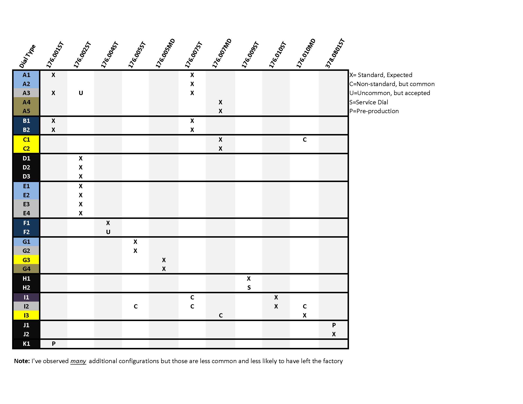

    I added a 12th page to the document (you can grab the updated version via the same link) to visually categorize the family tying each dial to a case reference or references. Here's the chart:
    Edited May 17, 2016
    Vulffi, Lou P, Lonestar and 1 other person like this.

    May I ask you to also add to the chart a column indicating which dials are still available?

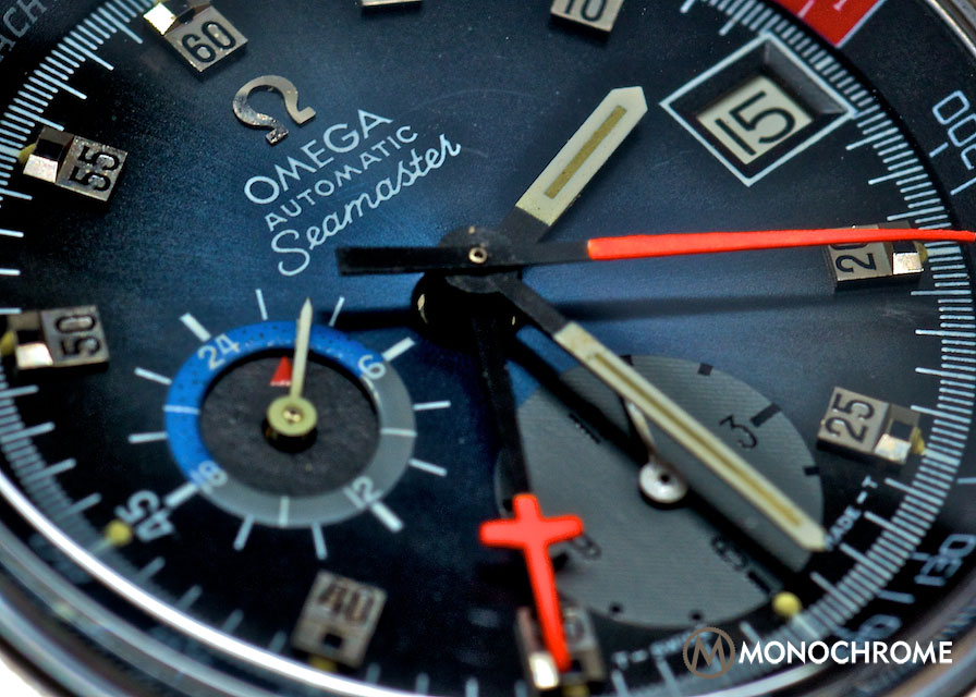

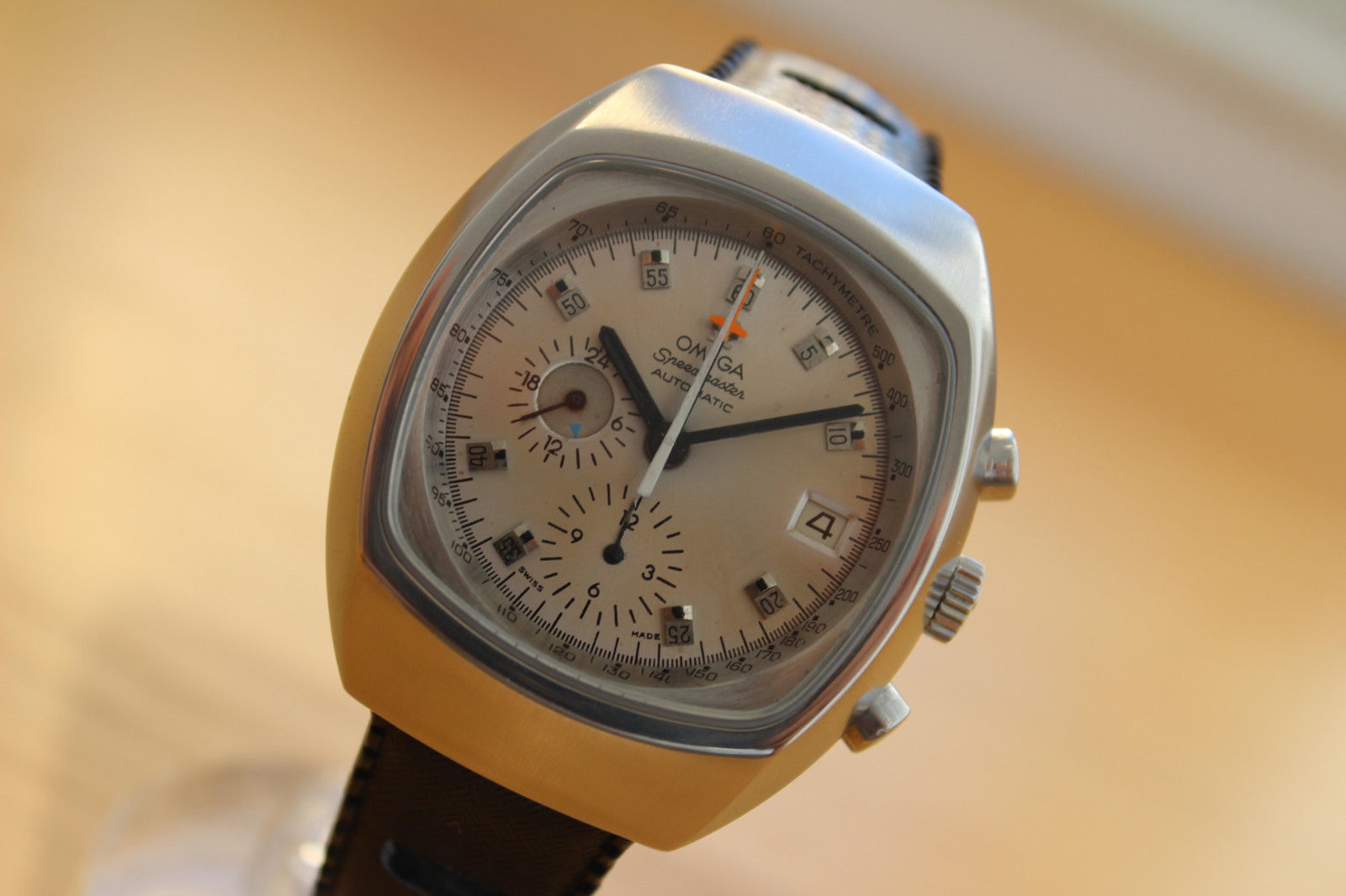

    About dial I3, I think it has one more difference to I1 & I2: the chrono hour sub-dial is sunken down a little bit, whereas that of the other two is flat and flush with the rest of the dial. In fact I1 & I2 are the only variants that have the flat sub-dial, while the rest all have a sunken sub-dial. I guess the physical difference is probably small and does not affect the clearance of the chrono hour hand, but I I'll have to look at them side by side to be sure.
    Found on the web:
    Andy K likes this.

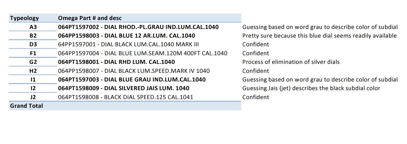

    I'd love to but I'm not 100% sure based on the part#/descriptions which dial is which. Here are the part numbers @Archer provided in a WUS thread along with my guesses as to which dial in my typeology it corresponds to:
    The ones in bold are guesses. And I initially guessed based on the thought that any use of RHD or RHOD meant silver, but maybe one or more is a gold or brown dial, as it makes sense that at least one of those should be kept in inventory as a suitable service dial for a GP 005, 007, or 0010.
    Great observation! I should have included that and will add it in the next revision. There are are two types of sunken subdials too, Type A for instance and the I3 dial pictured have two finishes within the subdial while a Big Blue (Type F) dial has a sunken subdial with a uniform finish. It never occurred to me that this may actually affect clearance of that hand, and consequentially the compatibility of the hour recorder parts.
    Edited Mar 10, 2016
    Lou P and TNTwatch like this.

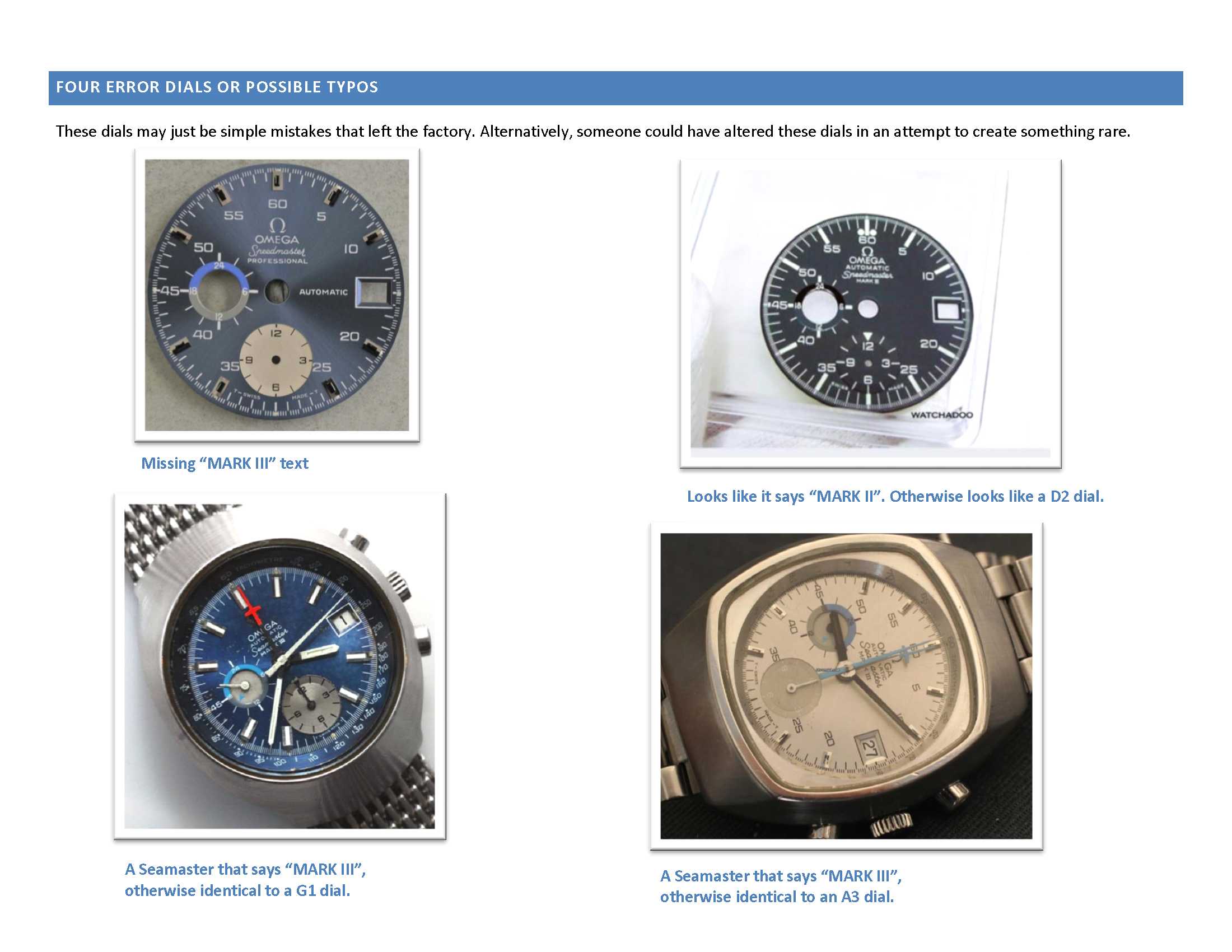

    In addition to the 30 legit dials I've listed above, I've got pics of 21 (and counting) other dials purporting to be cal. 1040 dials ranging from garbage fakes to sad redials to well-made ones like this one that might be plausible. One of these days I'll add them to the document.

    Well, here are two categories of dials that although I don’t consider them exactly correct or legitimate, they fall closer on the continuum to the legitimate dials than do most others.
    The first group may very well have come from the factory but if so I doubt it would have been intentional. The second group are ones that I personally believe to be non-Omega redialing but of higher quality than most.

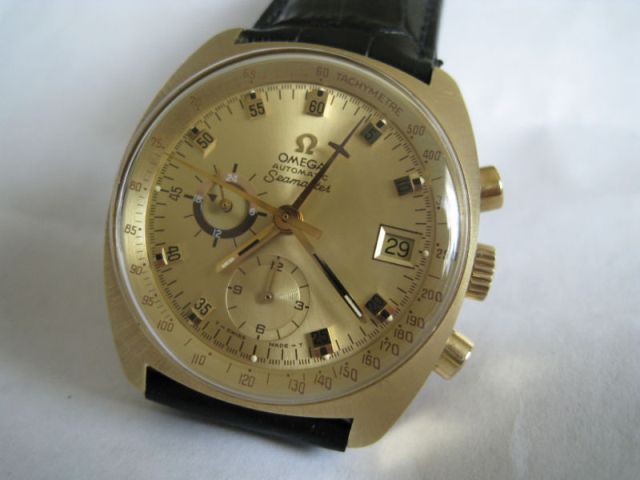

  20. incabloc Mar 29, 2016
    551
    1,716
    some time ago this one was on ebay... I dont know if its a rare genuine dial or not.
