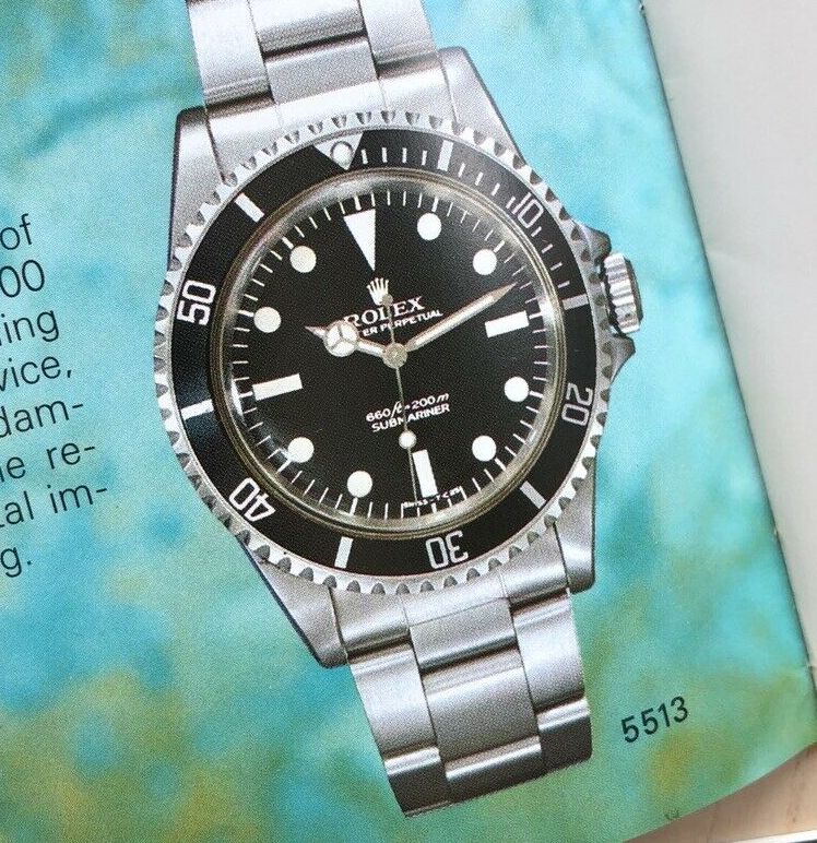

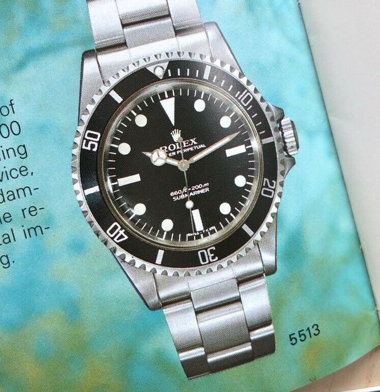

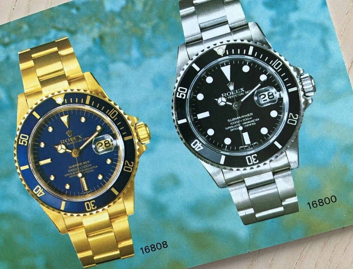

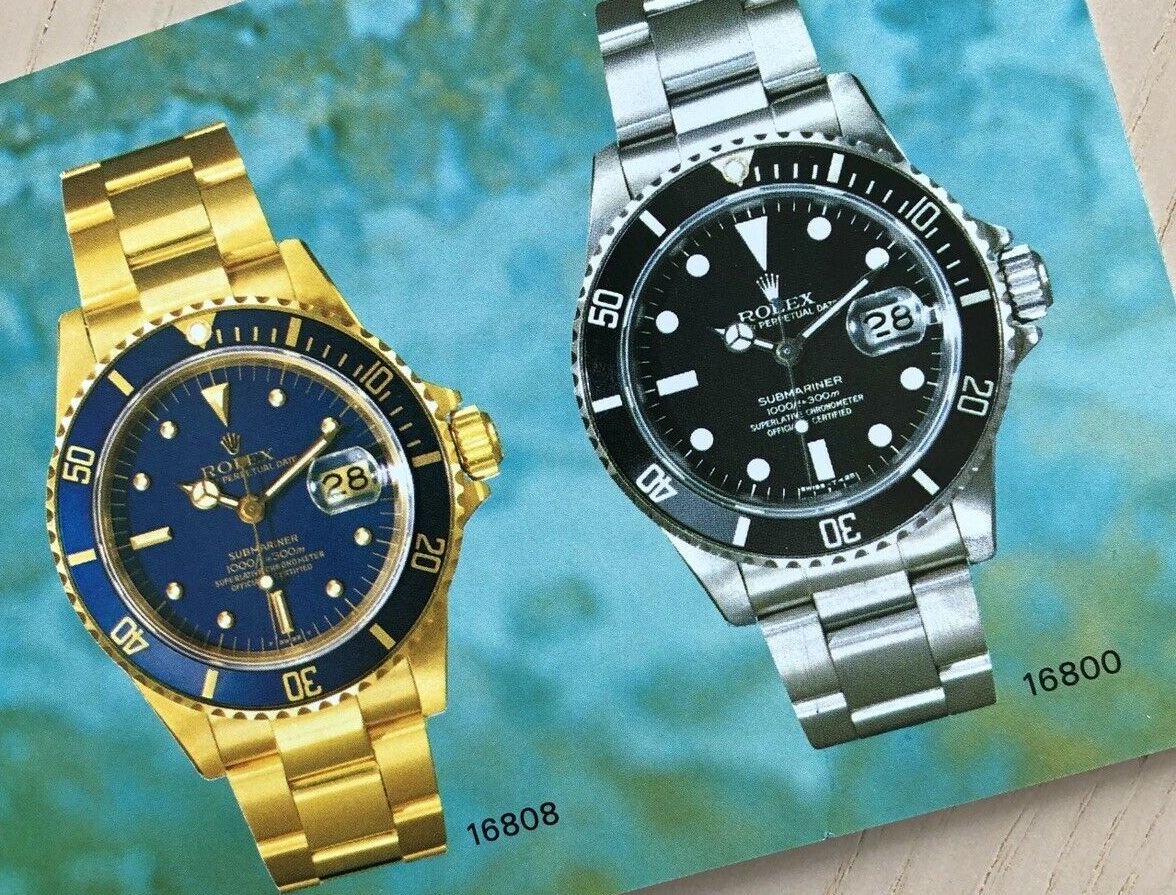

1981/82 Submariner booklet. Yellow and white metal surrounds on the appropriate inserts for 16808 and 16800, respectively. Extending outside the triangle. The 5513 illustration appears to show the pearl without surround, as expected, entirely within the triangle as you described.

I had initially made the same mistake in my original post. Much like Dan, out of curiosity I went to a few dealer sites and found all matte 16800’s with metal rings.
You are indeed correct and I am wrong. Apologies for the misdirection.

Yes, I am misinformed.
These are healthy debates, since it prompted me to make some extra effort and find those booklet photos. Now we have a record of it.
