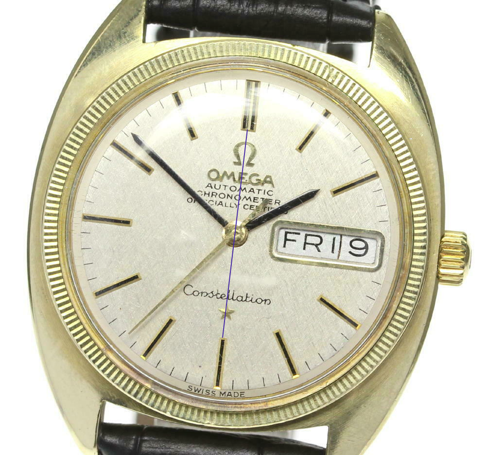

168.029 failing(?) MOY test - but looks genuine
2,681
3,161
This is the specimen: https://www.ebay.com/itm/OMEGA-Cons...l-751-YG-bezel-Mens-Watch-606036/254945071130
And funny thing is, while I was posting this, it assumably sold - tho the price was normal in my opinion
I guess my question is, is it genuine / how should I apply the MOY test from this perspective - I tried alternative cuts but none of them got it in line for me, but admittedly, I didn't spend much time on it
505
738
Hi,
Those C-case are known to have a lot of dial variation, and the MOY test does not always apply on this models.
You should focus on the font rather on MOY test
Do you have some other pics?
The word “Constellation” looks a bit weird to my eyes...

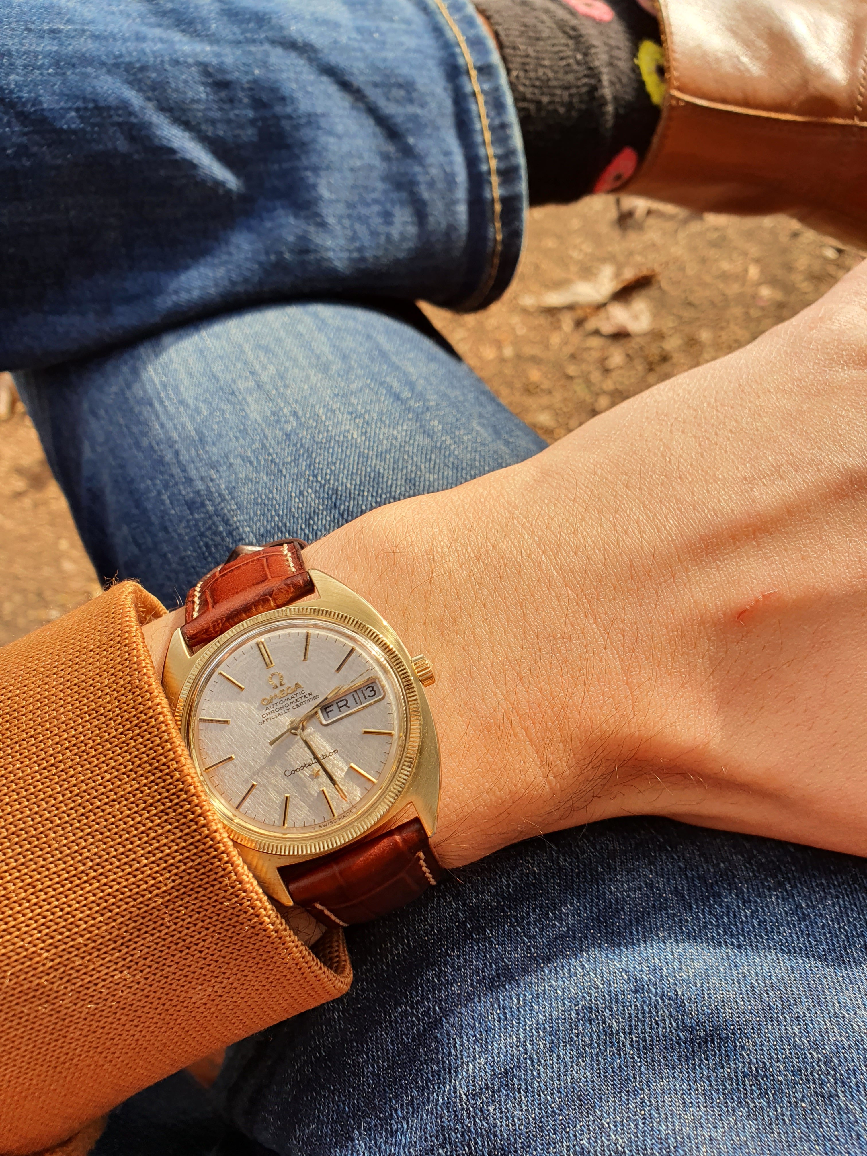

My own 168.029 day date does not pass the moy despite it beeing original factory finish. Hope it helps:

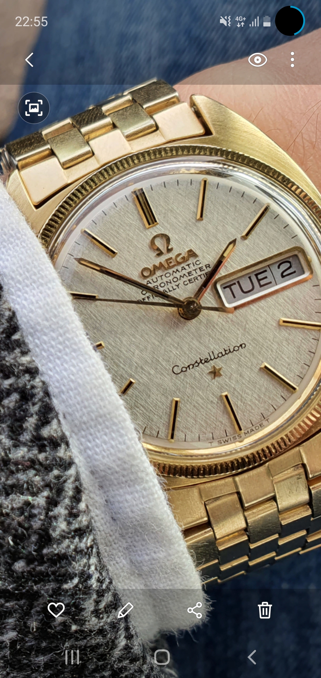

Found a better photo of it:
I agree with Gui13250 as I was able to find a lot of 168029/ 027 with original dial and moy fail.
