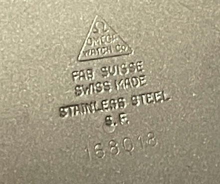

I opened the caseback and seems like the watch is a 168.018 with omega reference 564, @dsio

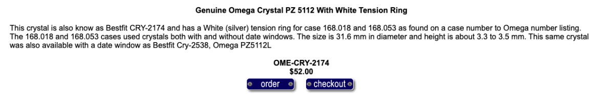

Also, since I was told the crystal is not original, I was looking at options to get an original crystal. I see there are two options - PX5112 (yellow ring), PZ5112 (white ring). Since this is a stainless steel watch with gold case/lugs, should I get the yellow or white one? I'm not entirely sure what the original crystal must have had. Ofrei has the white one (in screenshot below).
PX5112 with the yellow ring is available on ebay -
https://www.ebay.com/itm/1442339956...uid=2k1cchyHTwe&widget_ver=artemis&media=COPY
https://www.ebay.com/itm/2558122149...uid=2k1cchyHTwe&widget_ver=artemis&media=COPY
PZ5112 -
https://www.ofrei.com/page_168.html

I would get the white / silver one as that’s for steel, the other would be for gold cases.
PZ5112 -
168.018 makes more sense - and now you mention it, the dial does look flat and the unusual indices are more likely on a later .018 watch.
You can also see the radial brushing on the bezel.
The advice about 19mm straps still holds.
As it is a gold capped watch a crystal with a gold retaining ring would be correct for your watch.
