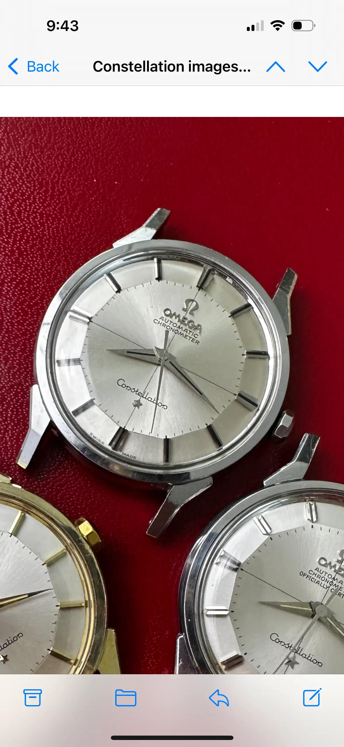

I have been looking for a 167.005 for some months now, been waiting for the right example. Studying, taking my time.
I have recently been offered a 14900. Is there any reason I wouldn't consider a 14900 over a 167.005?
I understand the 14900 is the earlier reference number, with no date, of the 167.005. Made for only a few years.
Although I expect to keep the watch indefinitely, I ask my question in terms of collectibility, resale value, etc.
Are they on par with each other? Does one ref command a higher price than the other? Is one preferred over the other in the collecting realm?
Thank you.

I wouldn't put much of a premium on the five-digit vs six-digit references. In your place, I would focus more on style (e.g. date vs. no-date) and condition. If you're ok with the dial (personal preference and price), it looks like a nice watch. The case looks much better than average based on that one angle.

Yeah I'm really in the fence here. Which means I'll likely pass. I'll get more pictures tomorrow but the age spots might be the deal breaker for me. And in a perfect world it would have gold furniture! I might be hunting a while longer. Thanks
Can be hard to tell from photos, but that case does look very good. The edges of the lugs appear nice and sharp. I don't think you'd notice those spots on the dial once you had it on the wrist, but it sounds like you're patient enough to wait for exactly what you want. Happy hunting!

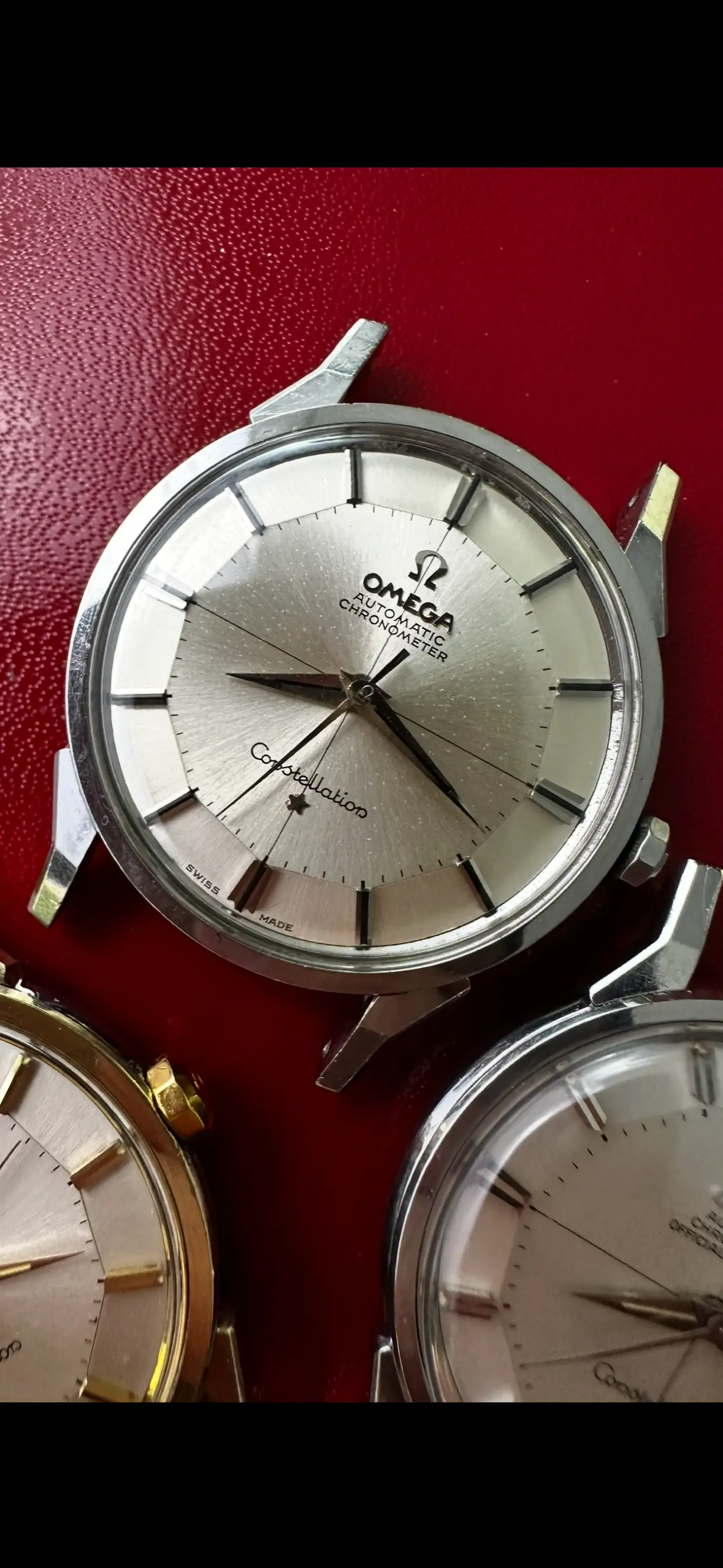

For the record, there is no fundamental difference between a 14900 and 167.005 or a 14902 and a 168.005 ( other than slight different case manufacturer variations perhaps)
The earlier references were produced from the release of the dogleg case in 1960 to the reference change in (officially) 1962.
You may find text differences on the dial ( like the ‘missing text’ dial you posted above)
You may find lumed versions without Ts.
There has never been a premium applied to one reference over the later version or vice versa.
One of the major problems with the earlier references is the amount of fakes that used to circulate but this is something to be wary of on all dogleg references.
Hope that helps.
