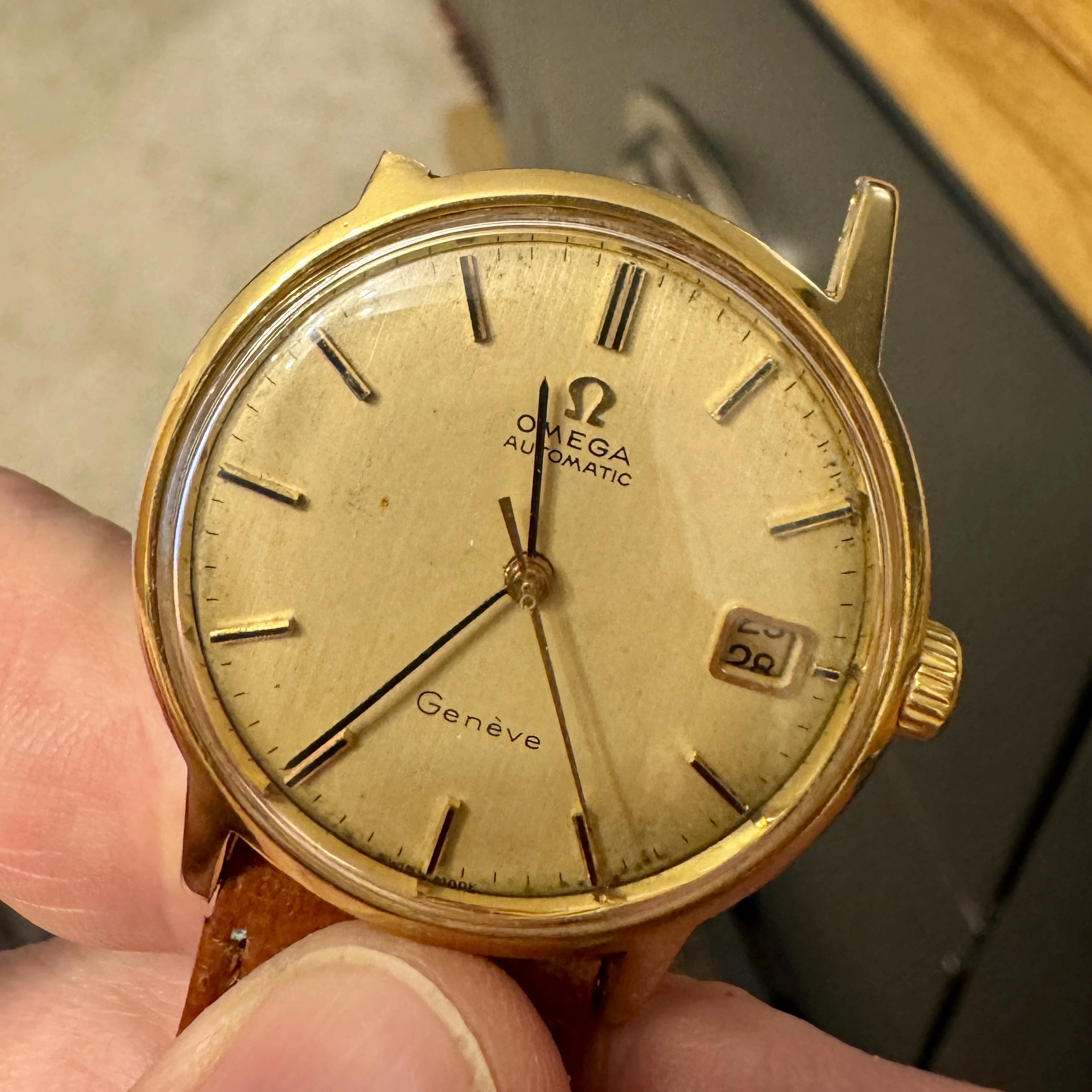

Hi there, First post here.
I have managed to break a lug off a 166.070 gold plated case (Geneve) and I am told that it's impossible to repair.
Couple of question have I been told rubbish here? can it be repaired and does anyone know a UK person that can do that?
If a no go - would anyone have for sale a case I could transplant the watch into
Many thanks in Advance
Steve

The cost would be more than a new watch would cost. And I mean 'new' watch. Repairing this would cost thousands or be a labor of love which would take months if not years of time, and the results would be less than satisfactory.
I speak from experience. I am a sucker for such basket cases, what I call rat watches. But they sell for less than the sum of the parts.

Without more context, it's hard to provide useful advice. When I look at a gold-plated Geneve with a dirty dial and a broken case, I see a donor for movement parts. Not something to restore.

if you are intrested in getting it restored you will need to look at lazer welding

Steve, hello.
If you don't mind, I'll offer you to replace the broken case with a steel one, which you can buy here: https://www.ebay.com/itm/235434286504?_skw=Omega+166,070&itmmeta=01JJZ1AZVQ8XG7K2XK5RT7GC1S&hash=item36d0fa1da8:g:dZYAAOSwidJlzzAT&itmprp=enc:AQAJAAAA0HoV3kP08IDx+KZ9MfhVJKlDl8v5M7EFOzV5uCWP5IvJHTKdiW9TOdX6CmcnLK8ep9jBDA7x9zdrNLirCta5x
This is not exactly the solution you asked for, but at least it is a solution you can use to resolve this situation.
